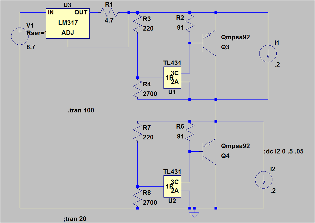

So took longer than it should have, but I implemented the attached circuit for my 5v battery charger.
It charges the first battery to 2.7v, and the pair to 5.4v
The two loads on the left are where the batteries connect.

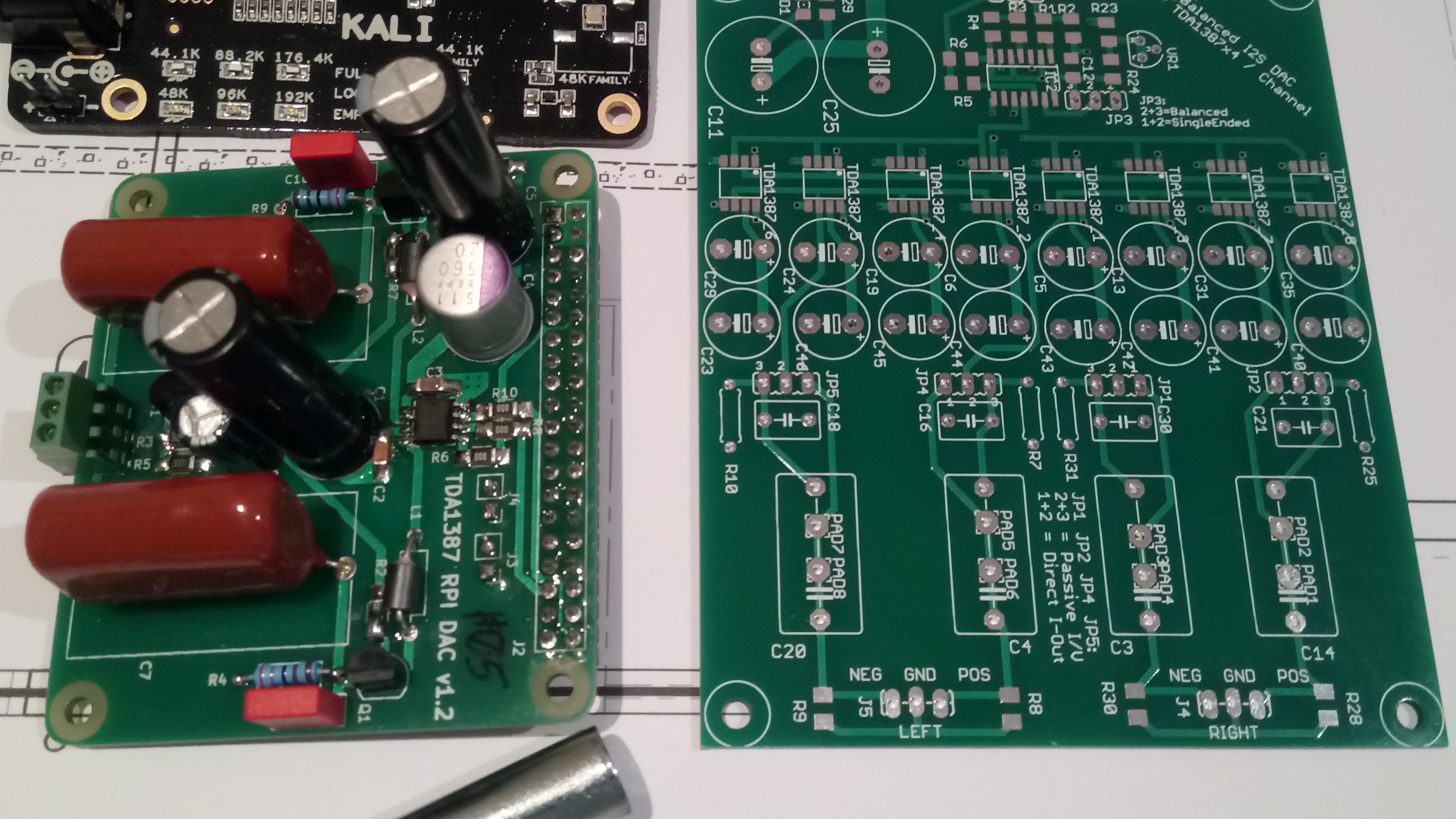

I was lucky enough to get one of Matt's boards. I am using it with a allo reclocker board, which does add to the cost, but I still think its a bargain for the sound quality of the DAC in that configuration.

Yosyos - also, I have a few spare unpopulated balanced boards. You can have a couple for free if you cover shipping. Definitely the quickest/easiest way to get boards if you're in the USA. But outside the USA, shipping can be expensive (probably at least $20 USD), so that's a harder call.

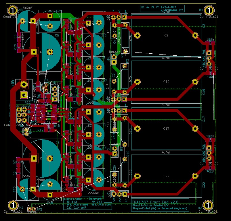

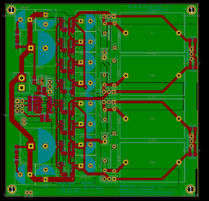

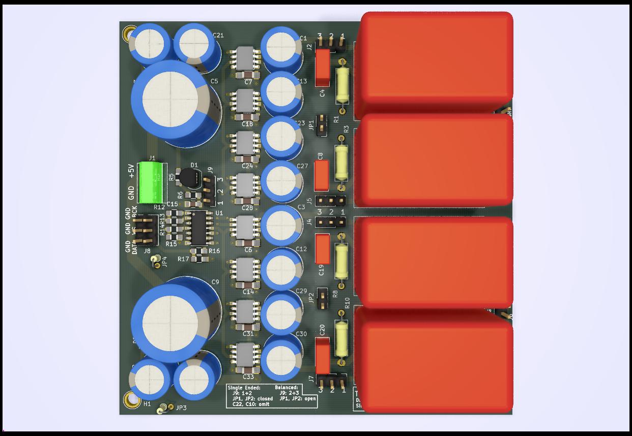

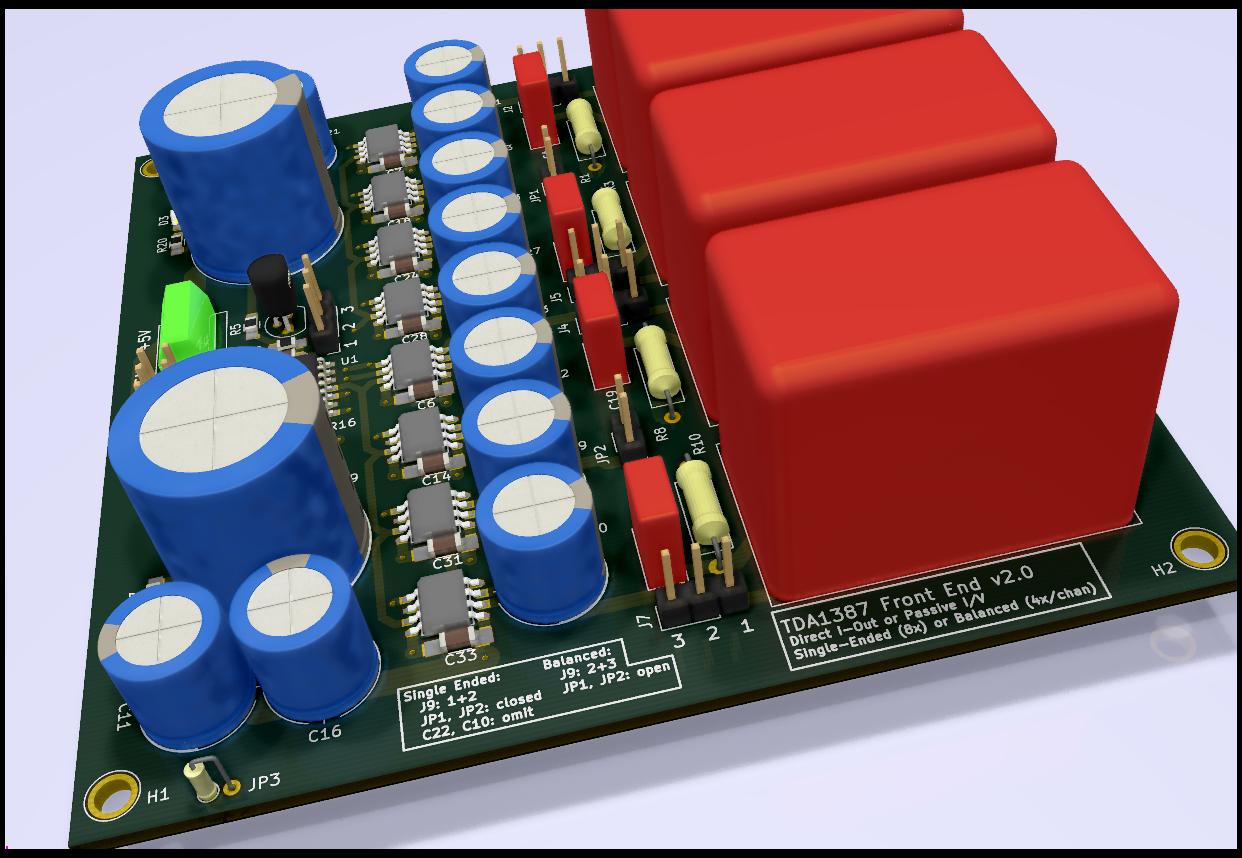

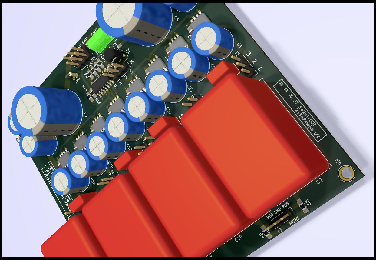

Front End v2.0 Files
Steering this thread back to the original topic for a second... 😉
A couple folks PM'ed me asking for the files for the version 2 front end. I want to revisit this design ("version 2.1" so to speak), as I think some things can be done better. But I don't know if I'm going to get around to this any time soon. So I'm posting the version 2 front end files as-is, for those who are brave, willing to debug my errors, and don't want to wait for v2.1. Please note: I have never had this design fabricated, so I can't vouch for its correctness. I repeat, this is an untested design!
Other than the images of the board, the attached files are as follows:
  • Schematic in PDF format
  • Gerber files generated by KiCad - I generated these the way I always generate Gerbers through KiCad, and it's always worked for Elecrow. But again, I haven't had this particular design fabbed. So I strongly recommend you sanity check these any way you can before paying to have them fabbed.
  • KiCad files (see note below)
  • BOM in CSV format. This was auto-generated by "KiCad_BOM_Wizard" and is very "barebones". Let me know if you need help with part selection.
Note on KiCad files: these files are unlikely to be usable without some effort. I started with the current stable production release of KiCad (v4.0.7). Then I did multiple in-place upgrades using the nightly builds (i.e. version 5 "beta"). Because of that, I am almost certain these files will not work with KiCad 4.0.7. Furthermore, on another PC, I did a fresh install of KiCad nightly builds (as opposed to an in-place upgrade). This made me realize that KiCad has completely re-vamped the symbol and PCB footprint libraries. The net result is files that are in the new version 5 format, but reference the old version 4 libraries. KiCad can mostly auto-correct the symbol libraries in the schematic, but as far as I can tell, the PCB footprints have to be manually corrected. And I've found in some cases the new footprints are every-so-slightly different, enough that routing sometimes has to be fixed. The long-term plan is to get all my designs to be "purely" version 5 compatible, but that could be a while. 🙂
So again, I am posting these files only for the adventurous, as this design has never been fabricated and is completely untested. I just wanted to make these available for the people who PM'ed me asking about them. As I said above, I do want to revisit this design, have it built, and test it. But that could be a while (probably months), so here's a stop gap if you're interested.
