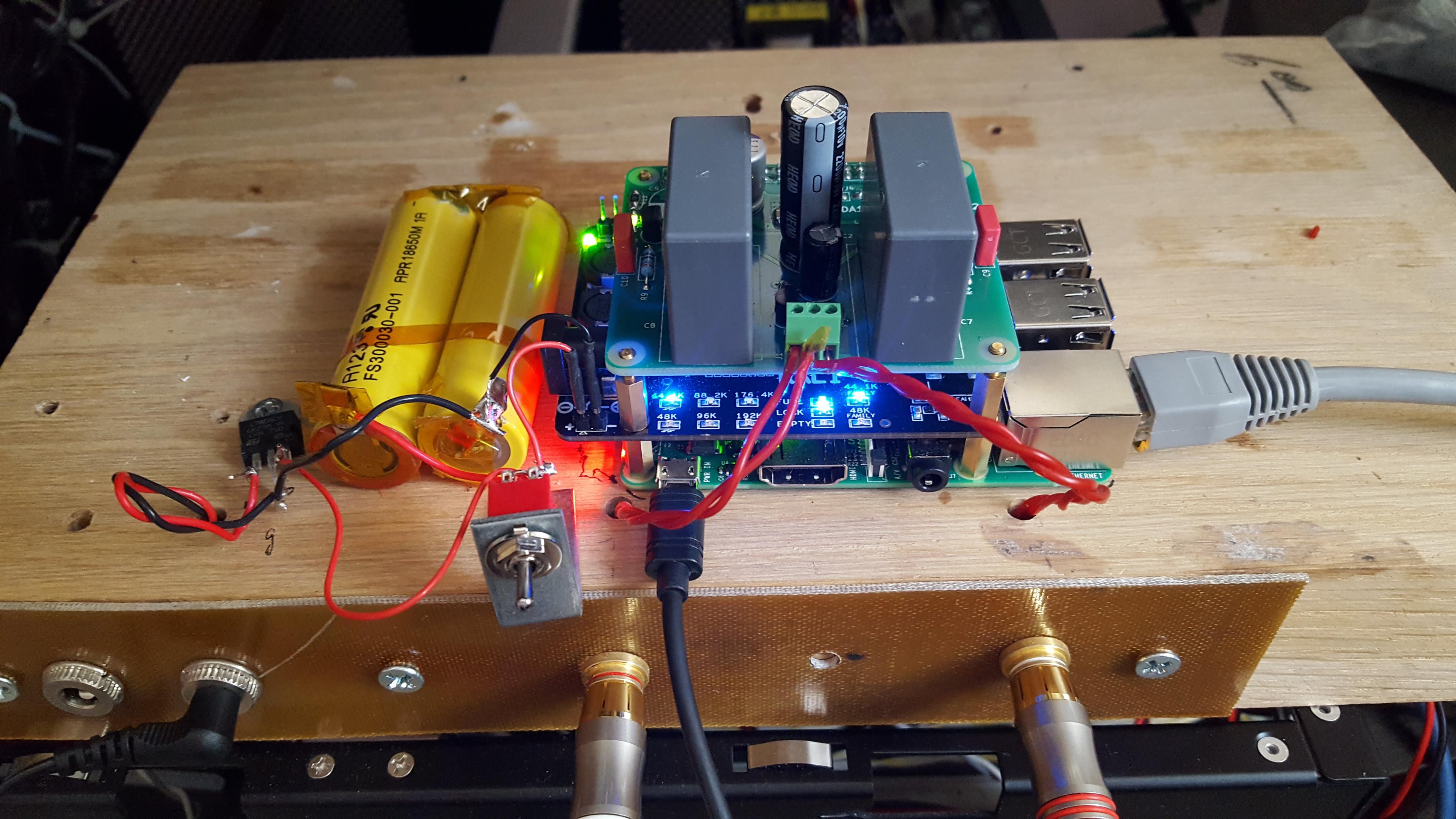

So I ended up just using one 5V reg and one pair of batteries to supply power to the allo reclocker and the dac board.
Took a headphone amp I was no longer using, and used the board for mounting the dac.
Letting it run in some, but initial impressions were good.
SW is PiCorePlayer audio version. I have LMS running on another pi.

If I had more than 2 in series, I'd worry about it more. I'll monitor them, and see how balanced they are over time. If they do go unbalanced, I can add 2 isolated PS's at that time. For now, this was a real quick and dirty way to get sound out of this card.
Listened some last night. Not sure if its broken in yet, and probably want to upgrade some caps, but it sounds good, much better than it should for the price. Didn't compare to my soekris yet, will give this some time to run in before I do that.

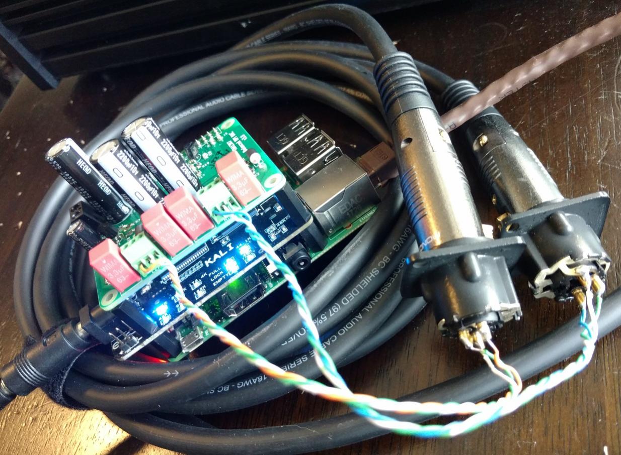

In other news I moved the balanced version from the test rig to my main rig. I feel like this smooths things out a bit (could be my imagination). But I did quite a bit of listening yesterday and was really happy with the sound. Shorter XLR cables are on order. 🙂

With floating PS mixed with mains connected PS it always gets complicated but it seems by touching the earth pin of the mains plug to the ground of the Pi DC input, you are providing a low impedance route for the noise (probably leakage current noise) back to earth which avoids it contaminating the signal ground. You can just do this directly without using the earth pin of the Mac or monitor - just use a wire between that point & mains earth.
been trying to guess about why the noise exists in the first place. Is it the DAC as I have assumed? Maybe I have a defective iPower instead.
I think @mmerrill99 probably has it right - your noise problem is most likely due to leakage currents being introduced by an offline switching power supply. The best way to deal with such an issue is to introduce just one mains earth at the source of the leakage currents. However this might be impractical as things like monitors have their own earth connection and having two mains earths might end up being worse😱
So I was wrong about the batteries, I hate when I'm wrong lol
One battery is at 3.3v, and other is around 1.7v.
So, now I need two 2.5V isolated supplies 🙁
Need a little dual secondary tranny, and then I'll rig something up.
