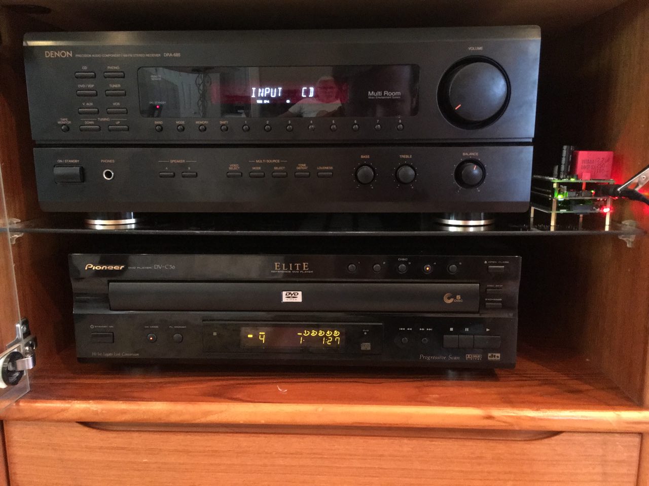

Testing the 1387 DAC Hat at my dad's house through his very nice stereo :)

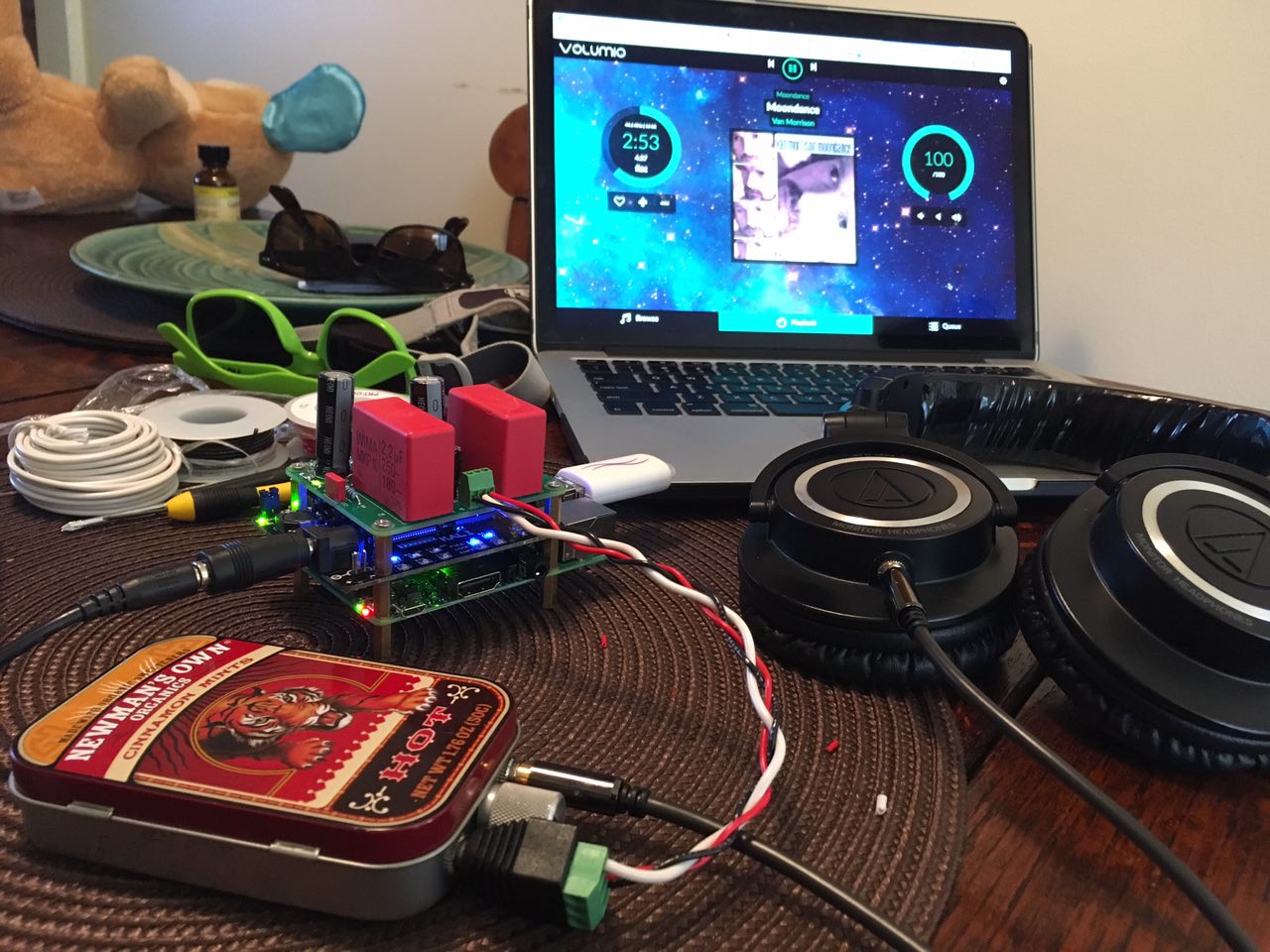

I began by testing the DAC with headphones, since I do a lot of "canned" listening at night while my family is sleeping. Once I grounded the iPower barrel properly (thanks to you all for the hand-holding there) the noise disappeared, and I really fell in love with the sound of the 1387.
Signal chain was:
1387 Hat -> Pocket Class A Headamp -> both Audio Technica M50 and the Fostex T50RP Mk3 w/ Mayflower v1 mod.
IMO it is tougher to achieve a truly satisfying listening experience through headphones than it is through loudspeakers. They are fraught with driver and housing resonances that often color the sound more dramatically than speakers, and their soundstaging abilities are inherently limited by their unnatural placement directly on the head. That said, they eliminate room reflections and thus can offer a very revealing, direct window into the sound of a music source. This DAC has given me more listening pleasure through both of my pairs of headphones than any other source I have owned. It has a somewhat narrower soundstage than I am used to, and it presents a very cohesive center image which brings the music together into a dynamic whole, rather than splitting it apart. This sounds more natural to me, over headphones especially.
The 1387 has a gentle transient attack and a slightly warm but wonderfully nuanced midrange texture. It also has an innately relaxed treble that is not just the result of classic NOS rolloff at the 44.1 sample rate; this softness persists with files sampled up to 192 kHz. Since most headphones (mine included) tend to have glaring frequency response spikes in the treble region, this softness fights treble harshness better than anything else I have yet encountered, making the headphone listening experience infinitely less fatiguing, more organic, and downright pleasurable. Especially over my incisively fast, detailed, and slightly bright Fostex planars, this DAC smooths the sharp edges just enough, and brings a tonal richness that makes these cans sing absolutely gorgeously. For the first time ever, I can listen to entire an entire album through these headphones with satisfaction instead of fatigue.

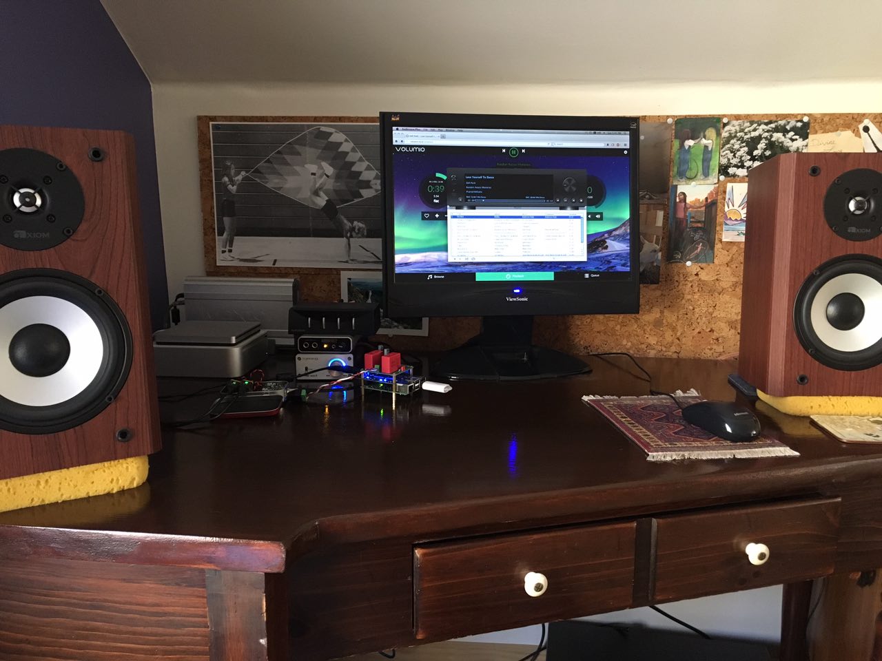

I also played this DAC over three speaker systems, both with and without my Pocket Class A in the chain as a humble but effective preamp. Since this DAC has a lowish output voltage, I believe it will shine brighter in any system when followed by a high quality dedicated preamp (better than the pocket amp I used).

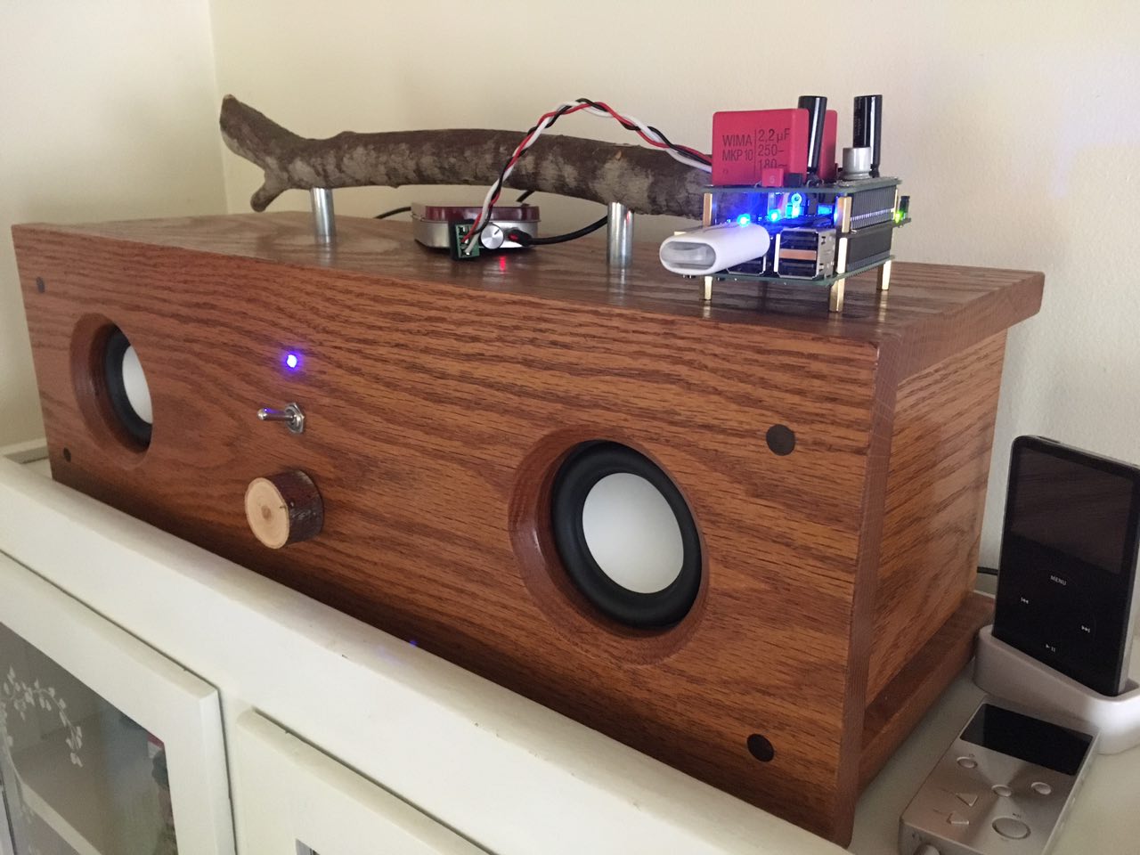

Sure AA-AB32155 (Tripath TA2024) -> Aura NS3 full-rangers (my Carmody “Sprite” Boombox)
Topping TP-20 (Tripath TA2020) -> Axiom M3 bookshelf 2-ways (my nearfield desktop system)

Through my Sure/Aura full-range boombox, I felt that the 1387 DAC hat was a clear step up from the source I usually pair with it—an xDuoo X3 DAP with a Cirrus chip inside. I have always found the X3 to lack midrange fullness and suffer from a metallic treble glare; the 1387 solved these issues handily, exuding a very smooth, sweet, and involving stereo image in the sweet spot. The only downside was that off-axis listening (already subpar because of the directional treble of these full-range drivers) became even warmer and duller than before.

In my Topping/Axiom desktop system, the 1387 surprised me by trouncing not just my X3 but also my Mac’s AKM-equipped Firewire soundcard. The sound was not just smoother, but also had a depth that really drew me into the music much more. The 1387 is as close to wince-free as I have heard. This system is normally quite revealing and analytical—rather lacking warmth and body— and the 1387 hat fleshed out vocals and other instruments with more natural tonal presence. It was over this system that I really noticed the imaging capabilities of the DAC. Voices and instruments seemed to each emerge from a much more distinct “point source” than with my other DACs, which threw a wider overall image but seemed to sort of smear each instrument out wider as well.
attachment.php
Once I my ears adjusted to the 1387, I found its center image much more convincing, and I found myself listening “in” to the music rather than just reacting to the music coming at me. I noticed some 3-D depth to the soundstage that was not present with the other sources. Somewhere I saw somebody describe the NOS sound as presenting music “in repose” as opposed to “in your face.” I totally get it now.

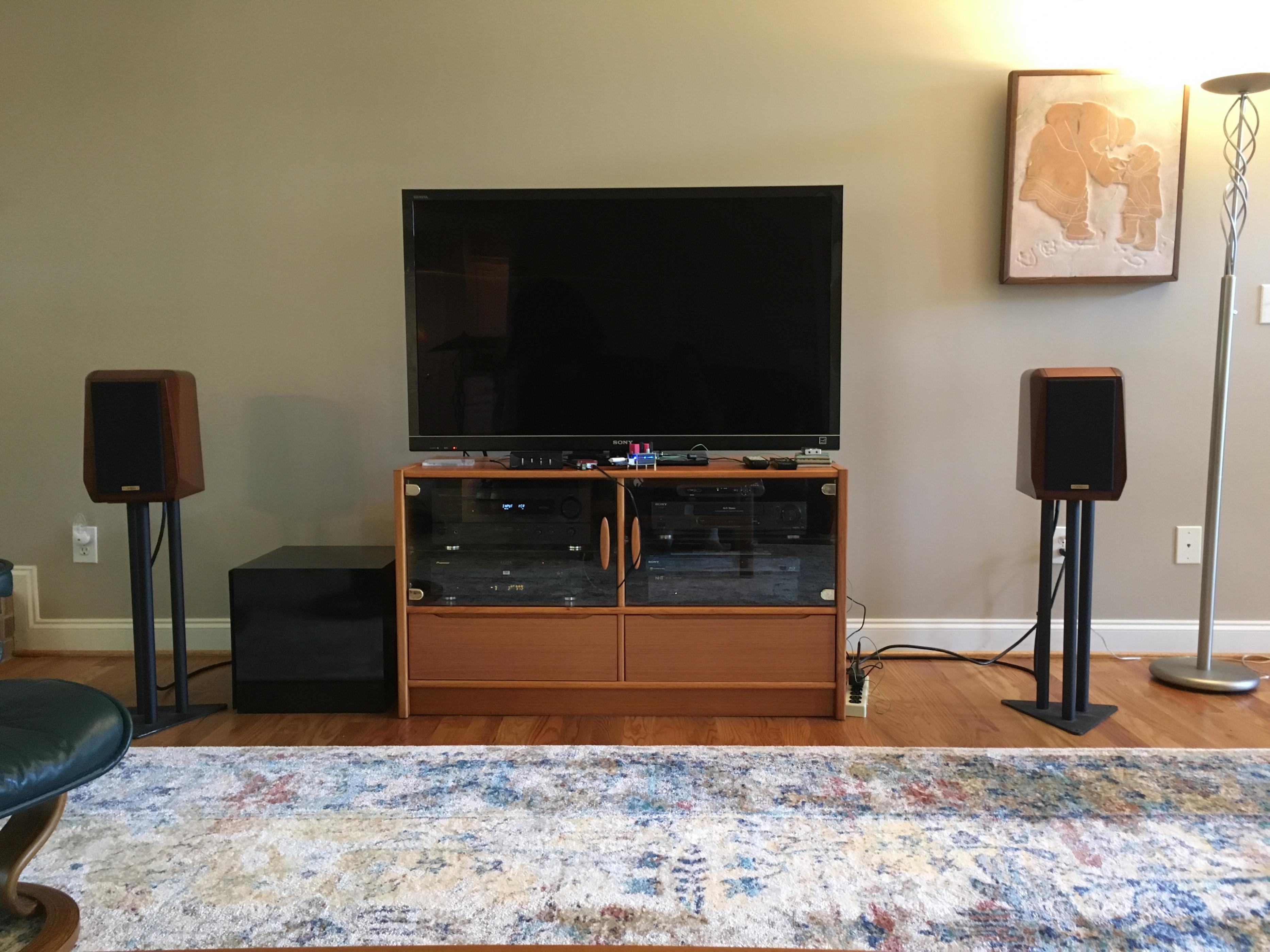

On to the Denon/Opera system (see pic from previous post). Over Easter weekend I convinced my dad to let me hook my Pi stack up to his stereo, which is pretty great to my ears—detailed without harshness, lively and engaging, with more grunt and euphonic warmth than my own Class D setups. His usual source is a 20 year-old Pioneer Elite CD/DVD player, which we ran into the A/B box alongside my DAC (which was warmed up for six hours). While they say that the apple doesn’t fall far from the tree, I was only able to find one disc in his entire music collection that I also have in FLAC—John Mayer’s Continuum. It actually turned out to be a great album for critical listening, since all the instruments are very well recorded. I synced up both players and we listened to several tracks together, switching back and forth.
In this test, one distinctive characteristic of the 1387 stood out clearly to both of us. It seems to present the leading edges of notes in a much slower/softer way…the attack of a snare drum, for instance, has much less of the usual snappy energy presented by Delta Sigma. I feel this softness was compounded by the fact that the DAC seemed to slightly compress the full dynamic range of the source material compared to the livelier dynamics of the CD player. Perhaps this shortcoming would be ameliorated by proper gain staging. My DAC’s output was much quieter than my dad’s CD player, and required the Denon’s volume knob to be bumped up considerably. I tried inserting my Pocket Class A, and was thus able to match the volume, but I actually found that in this powerful and resolving system, the PCA seemed to veil the 1387 hat’s presentation (recall that this is actually a tiny headphone amp, with electrolytics for output coupling, not to mention redundant film input caps and a second volume pot :eek:).
attachment.php
We concluded that the Pioneer player was more fun, engaging, and realistic in my dad’s system. However, this was a $600 player back in its heyday, compared to a sub-$100 Pi stack. Both sources had plenty of body and good overall tone. When we hooked up my X3 player just for grins, the music just collapsed into a cold, 2-D bore. My Dad agreed that the 1387 sounded “good,” but “less clear” than his player. My own personal taste was sort of a toss-up. Though I did prefer the Pioneer’s detail and liveliness, I found the 1387 sound less intrusive as a whole—something I could probably leave on in the background throughout the day at home, without feeling on edge. The Pioneer’s soundstage was much wider throughout the room, owing to its greater treble extension and detail. But when I sat right smack dab in the sweet spot, I found the 1387’s presentation plenty bright, and still “open” and “transparent” and smoothly satisfying, despite its lesser width, microdetail, and punch. Its cohesion, timbre, and solid imaging are really something special.

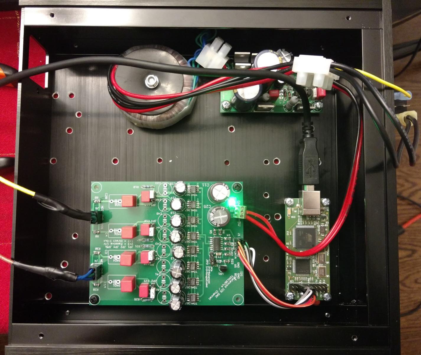

At any rate: do you have the ability in any of the rigs you mentioned to take advantage of balanced (XLR) inputs? Again, without doing any kind of formal comparison, I feel the balanced version takes it up a notch. Not dramatic, but definitely an improvement. I built up two, I could send you one as a loaner if you can use it. (I wasn't planning on doing a group buy with the balanced ones, as the BOM cost is higher and they are significantly more work to assemble.)
At any rate, from my personal perspective, my goal of creating an "80-20" DAC (80% of the goodness at 20% the cost/effort) is a success. Sounds like you'd agree with that characterization as well! I created this to "scratch an itch". And while I'd be happy that it works for me, it's delightful to see someone else getting some enjoyment out of it.
I'd say the next step is to grab Abraxalito's "back end" (filter + I/V + buffer). I haven't heard it yet, but my expectations are high. :)
Thanks again for the write-up!
I'd borrow your balanced DAC if I could use it, but I don't have any balanced amps. I know that balanced drive doubles the voltage swing and cancels EMI pickup--so it makes sense that you prefer it. My Firewire DAC actually has dual 1/4" balanced TRS outputs but I have never had the equipment to take advantage of it. Perhaps someday I will build a balanced headphone amp and rewire my headphones to hear the difference.
