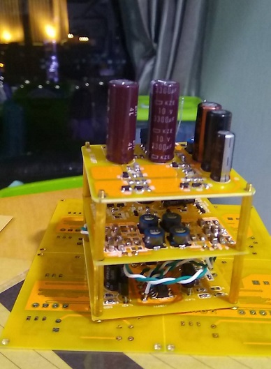

Those of you who've expressed an interest by PM in getting one of my lingDAC prototypes for a listen, here's an appetizer pic. The DAC board's the lowest floor, then the filter board's in the middle and the latest addition is a buffer stage which means you can drive headphones (lowish impedance, planars not included as not enough swing) directly. Or you can use the buffer stage to drive a classD amp as it has much higher drive than the DAC I/V stage itself.
Looks good.

I'm guessing you need + and -15 or 18vdc or something like that for the buffer? Makes the power supply a little more complicated, always a tradeoff lol.

abraxalito, congrats on successful first sound out of your new PCB stack! The filter board with the tiny inductors has quite an attractive layout. How is the buffer stage biased? And have you tried measuring a 1kHz wave to see the distortion harmonic ratio, maybe with and without the buffer? Exciting work.

@se - the biassing of the buffer stage? Its an SE buffer so there's a single MOSFET biassed by a current source. A total of 3 transistors per channel. I made some distortion measurements without the buffer, it showed a rising distortion profile with frequency, I think mostly 2nd harmonic. I plan to build a balanced version to see if the 2nd H gets cancelled.
looks very compact ! does that buffer board require +/- 15V?
I wonder if a JG (joachim gerhard) buffer from the ES9023 thread could be used in adition to the filter board in the middle cause I have one lying around
anyway, I would be curious of a listening test with this filter board, I have heard the raw (paralelled) sound of the TDA1387 using just a simple I/V resistor of 390 ohm and indeed has huge potential, so I'm curious what magic does that filter board bring to the sound in terms of 3d stage and microdetails 🙂
