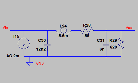

Here's a rough first draft of the filter
OK Abraxalito, I'm at this point now. A bit ashamed to admit I can not read that draft, since I don't see where the IN, OUT and GND are in that schematics. I modified the draft as I guess in/out/gnd are, I'd appreciate if anyone can confirm/correct.
attachment.php
Thank you

I gave up on passive I/V a while back - active sounds so much better, particularly in the bass, provided a passive filter is used before the active stage.
ok one more stupid question, bear with me.
I understand passive I/V purpose is HF rolloff to avoid next opamp/s oscillation. What is the purpose of the active stage afer the passive? Maybe reducing impedance? Add capacitance? Add some gain? ...?
Thank you again for your patience
I don't think the purpose of passive I/V is to prevent oscillation. Rather it allows the transformation from I to V to happen with negligible intermodulation distortion.

Ok. Just trying to understand the general use, yes. I’m planning to use a passive I/V followed by a LME49720 with gain, a digital pot and finally a driver to convert to differential. Since you say you’re now also using an active stage after the passive, I was curious on the why’s and also what was the main function of the active stage. Thank you again
As usual, the answer depends... If the filter's highly constrained (like I can't use more than 2 inductors for cost or space reasons) then I'll go for a lower cutoff freq to get more stopband rejection. But for cost-no-object designs the nearer to 20kHz cutoff the better. Bear in mind that FM radio has an upper bandwidth limit of 15kHz and I don't recall hearing people saying that's lacking top-end.
As regards RC and RL - presumably the RC are used in conjunction with opamps to provide positive feedback? I haven't seen RL used as C is much more manageable than L - better tolerances, lower losses, better temperature stability, smaller, cheaper. A passive filter which doesn't use both L and C is going to be severely limited in how steep a roll-off it can achieve.
Good then, I'll use 20K directly. The question was because I think that Fc is the first -3dB cut, but the curve still goes down from there so the final cutoff is a bit higher HF. (If that makes any sense, I'm the newbie here)
No idea, tbh. But I saw RC or RL w/o opamps in this calculator, that's why I asked here to the expert :D Maybe you can recommend a better calculator?
Thank you again
