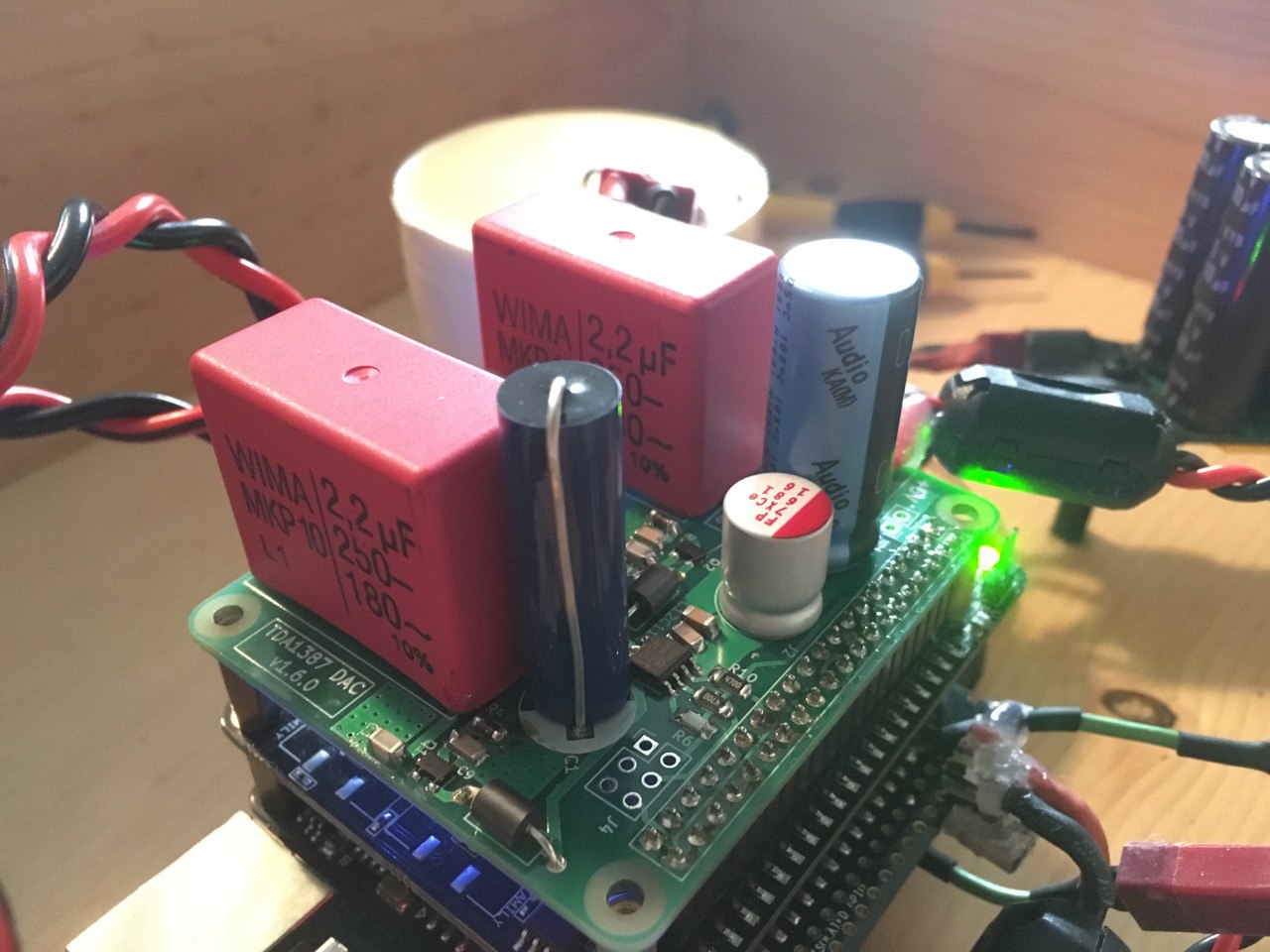

I have been meaning to comment on a small discovery I made while rolling caps in the v1.6 HAT that Matt sent me. This board has room for a large electrolytic for the TDA1387's Vref pin, and the BOM calls for such. The cap you fit in this position will have an obvious effect on sound quality.
I tried many different brands and values of electrolytic caps in this position, up to 3300uF, and found that what sounded best to me were several small value film caps, especially PP. Some may like the bass with a big electrolytic there, but it sounded bloated to me.
The TDA1387 datasheet calls for 1uF, and this is what I ended up with. Here's how I fit a Jantzen Standard Z-Cap in the 5mm pitch holes. It is worth experimenting to see what you like in this spot.

Great info stellarelephant! Thanks. Usually the data sheet designers know what's right. The thing is, on the TeraDak, there are eight caps on that board.

At some point, I think I will try to change the eight Vref caps on the TeraDak to film. Sounds like an interesting project. But, after looking at it, the smallest 1uF film caps I have are too big. Buying eight is too expensive. I would like to experiment with Matt's DAC.
