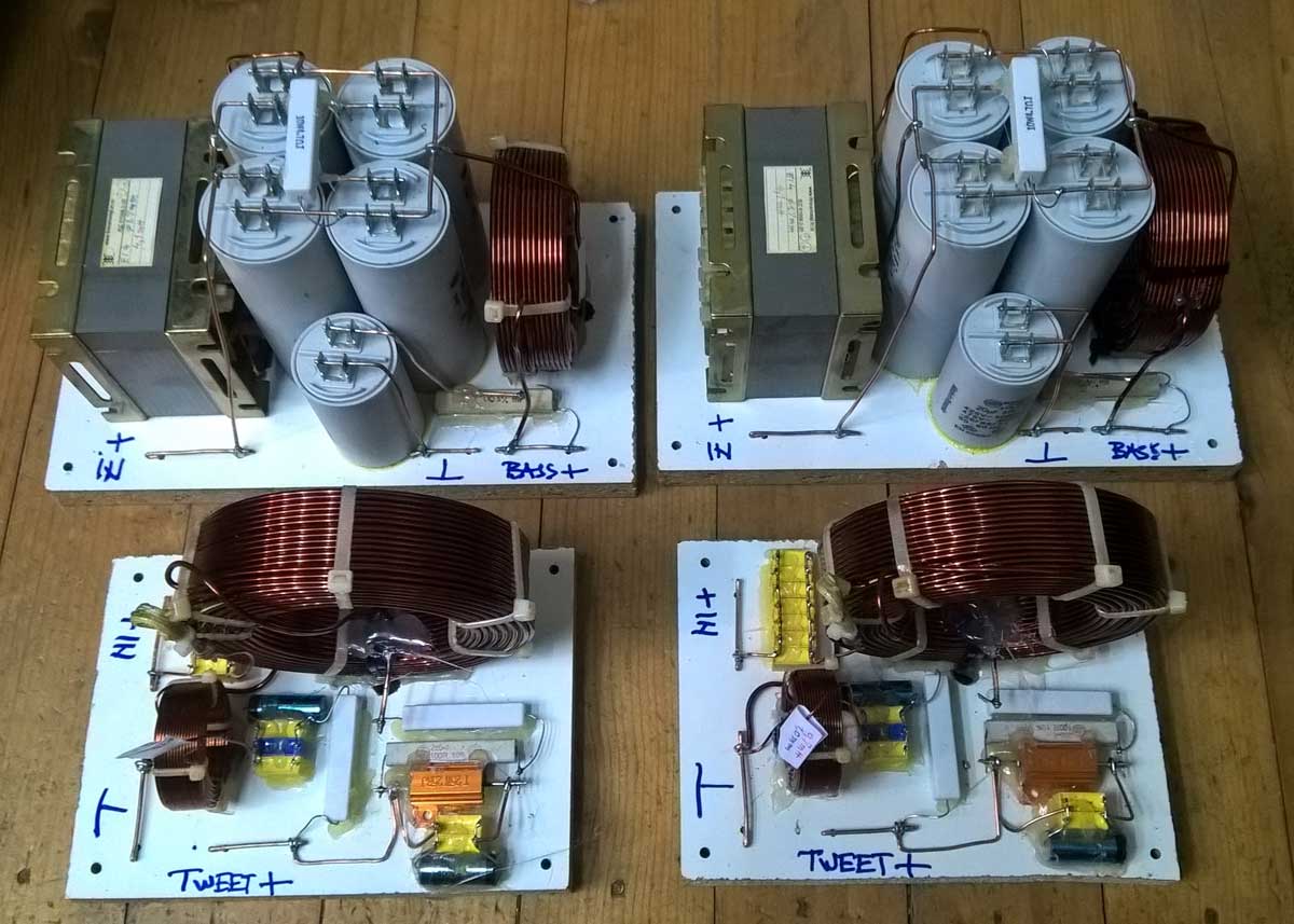

found it
Pa posted it on forum few years ago, and this is last iteration, with proper caps
he sent me pic later
conclusion - he gave most to bass choke, fat wire, while tweet autoformer is made of filmsier wire
mine are better, both bass and tweet chokes are made of same 2mm Dia wire

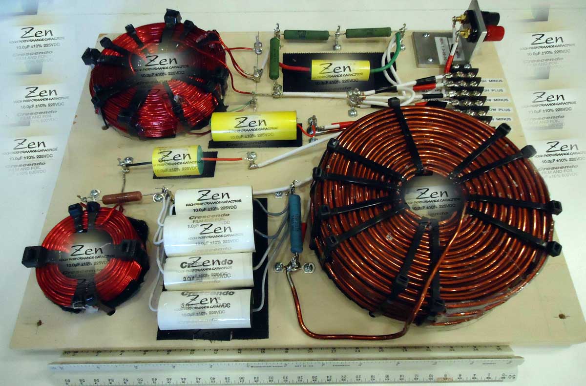

Bubba Bob was Family enough, so he took-over (Papa's) Joe Sammut's set of 15" Tanns, when Joe was gone to smile on us all, above........ and I know Bubba is immensely happy listening them every day
Bubba, you ever had a peek inside, just to know do you have same xovers inside, as on pic posted in #86?

ZMBubba Bob was Family enough, so he took-over (Papa's) Joe Sammut's set of 15" Tanns, when Joe was gone to smile on us all, above........ and I know Bubba is immensely happy listening them every day
I have yet to take back off the Tannoys but the picture you posted is the crossover that Kent and Nelson said was in Joe's Tannoys. They sent the same pic.
