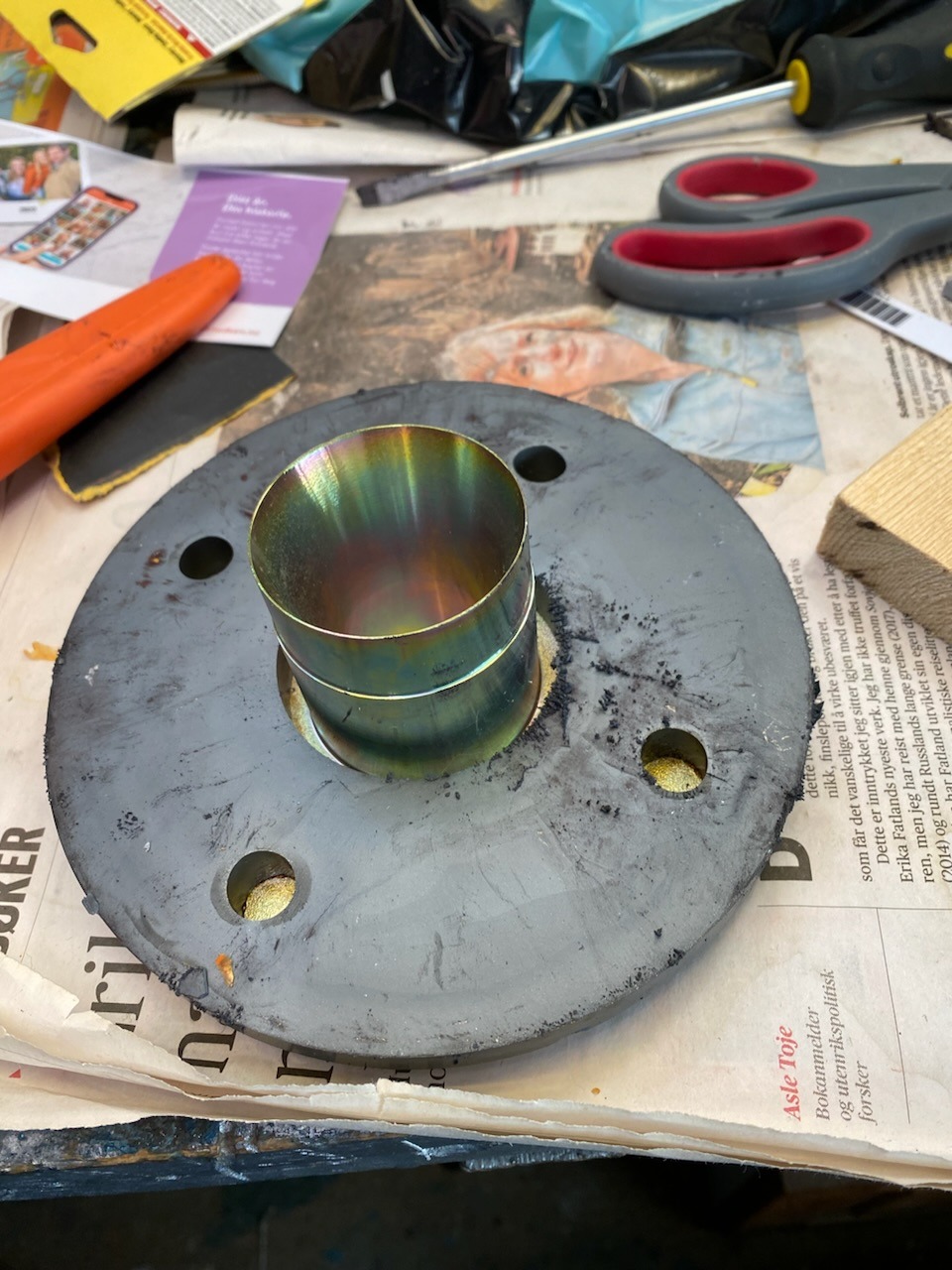

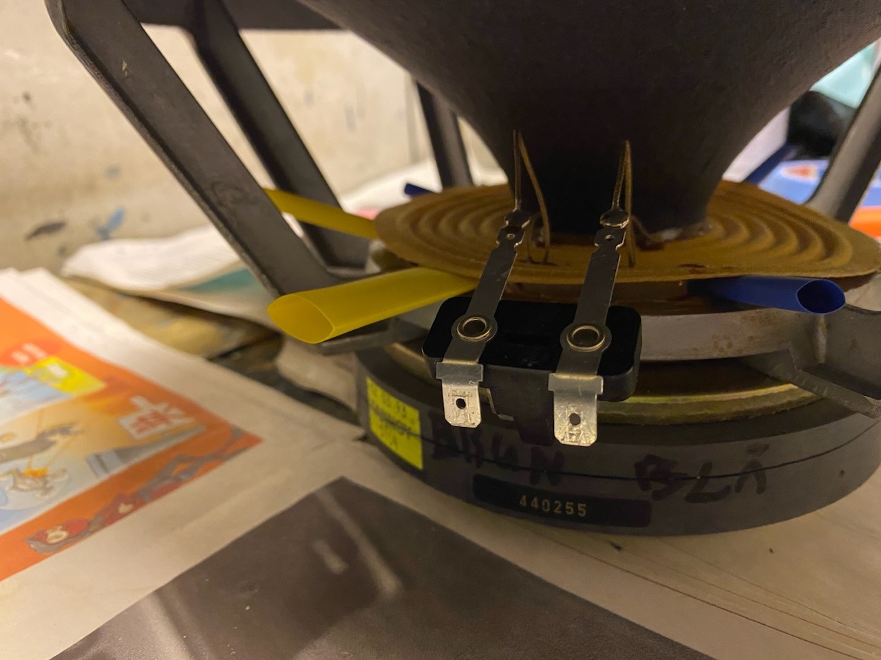

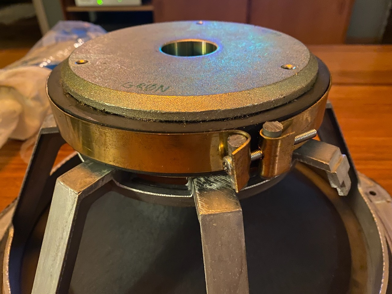

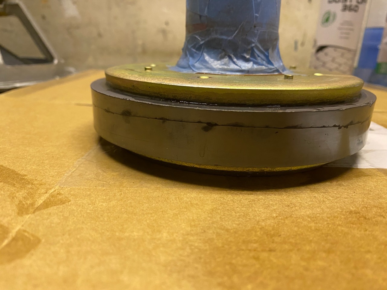

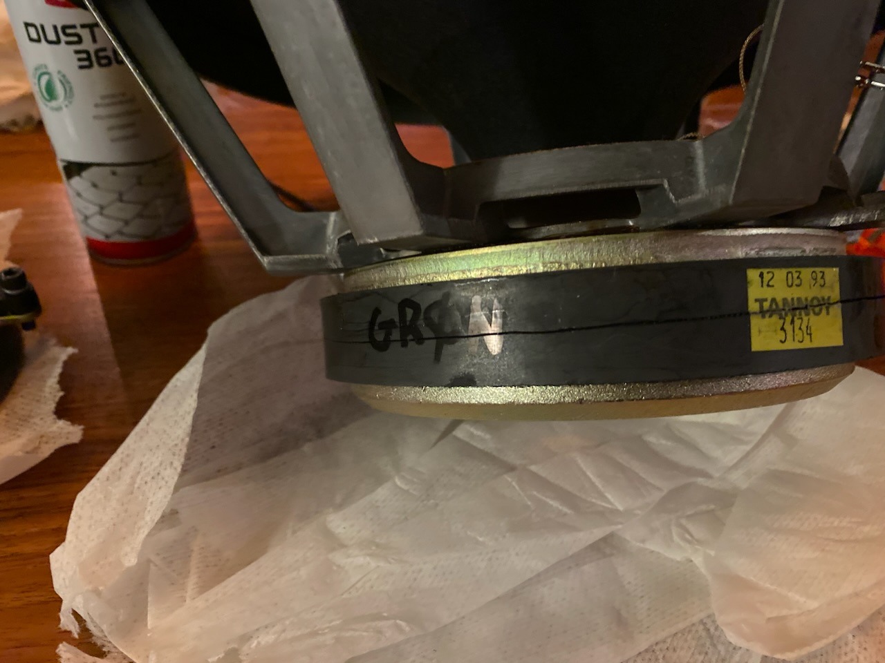

Continuing showing the plethora of drek involved in the service of these drivers. Driver B, had a scratching sound when pressing the cone. As it turned out, magnet was completely cracked. Checked in with MZM, and started a lenghty repair process.
Previous owner had used depicted copper crap to keep the magnet assembly together. Not a good idea, a cracked magnet means risk of displacement of upper and lower part of the assembly, and even a mm displacement means the voice coil risks scratching and de facto shorting against the magnet assembly.

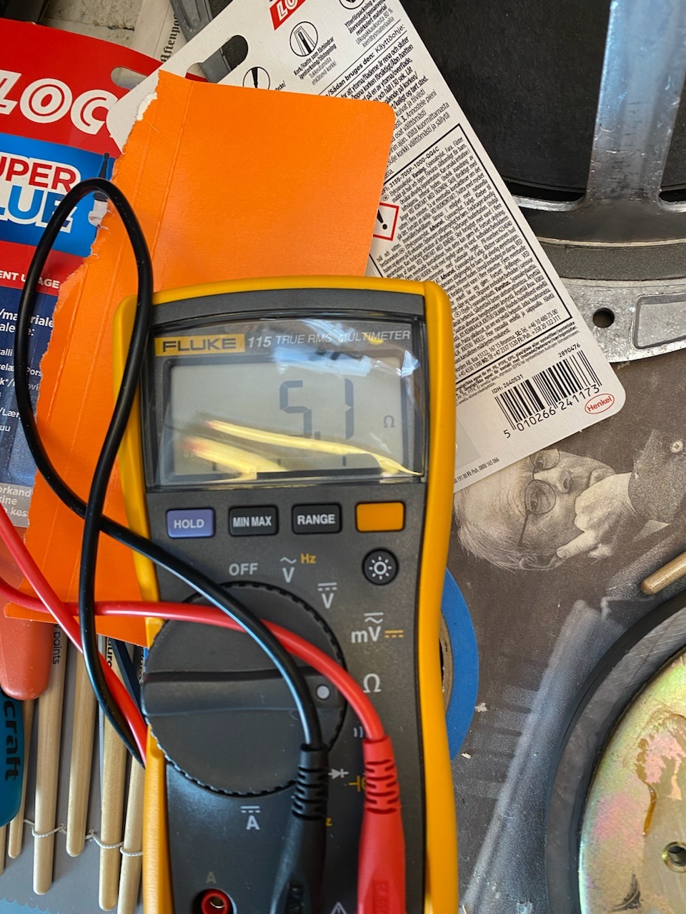

At this point, woofer impedance showed 5R1 vs 5R on driver A. But, getting a stable reading was difficult, and impossible when tapping the cone. In fact an indication of a voice coil making contact with the mag assembly.
Reactions: Mikerodrig27

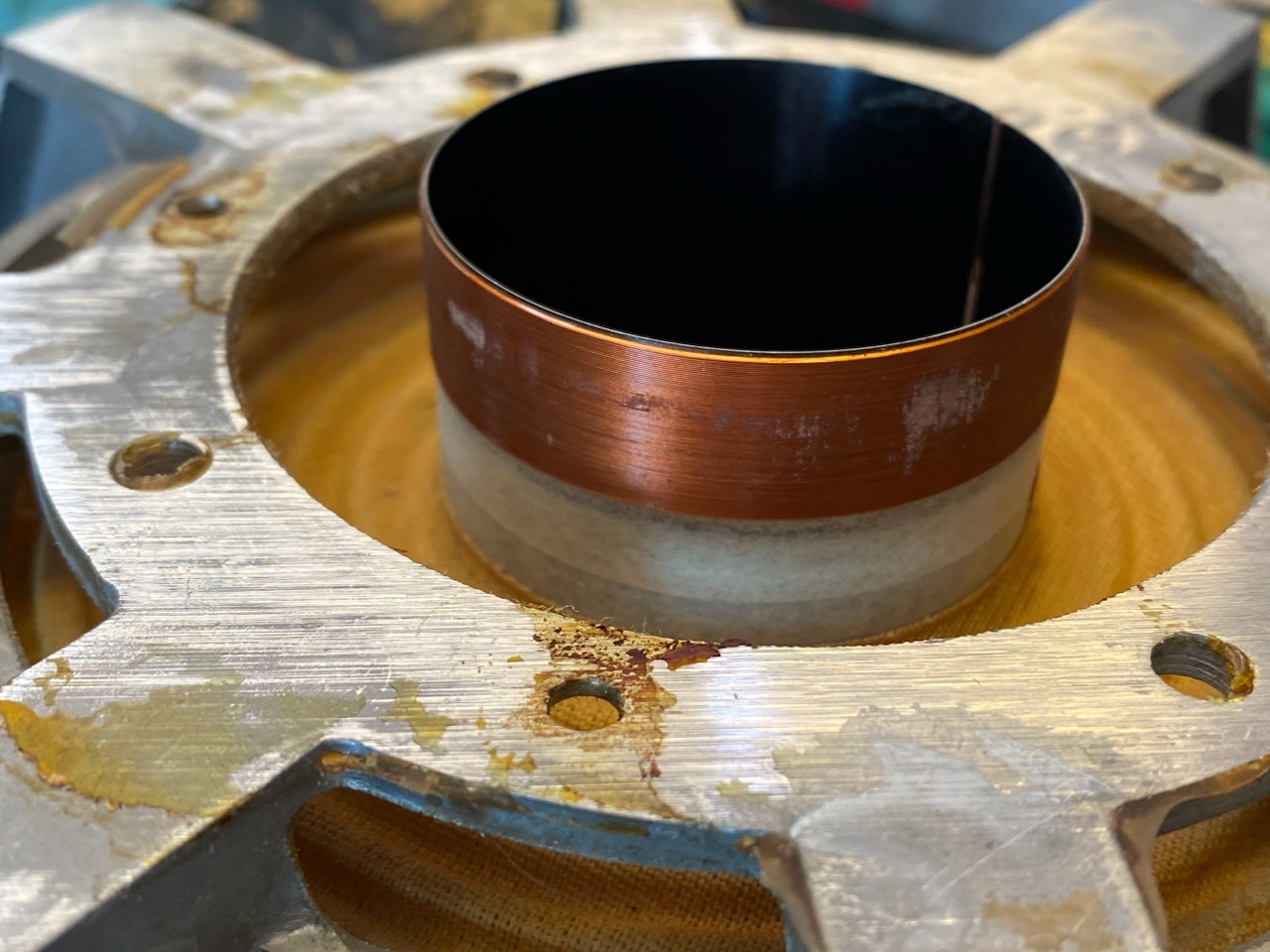

So, lot’s of stuff needed to be done, including a few pics. First loosening the spider without damaging it. Done with huge amounts of acetone, a brush and time…

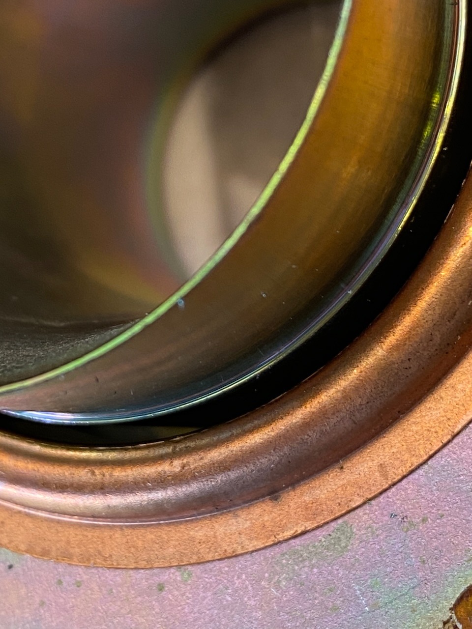

To reveal huge amounts of magnet residue in the gap (difficult to depict), also a decentering of about 1mm with magnet residue hindering clamping it together. Also, tell tell signs of suspected VC-magnet contact: a scratched voice coil.
After dismounting: stable 5R1 reading. Later I did more work on the VC, and for some reason it then suddenly showed 5R, exactly like on woofer A, and completely stable - meaning theory of contact with mag assembly was correct.

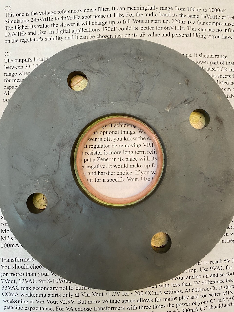

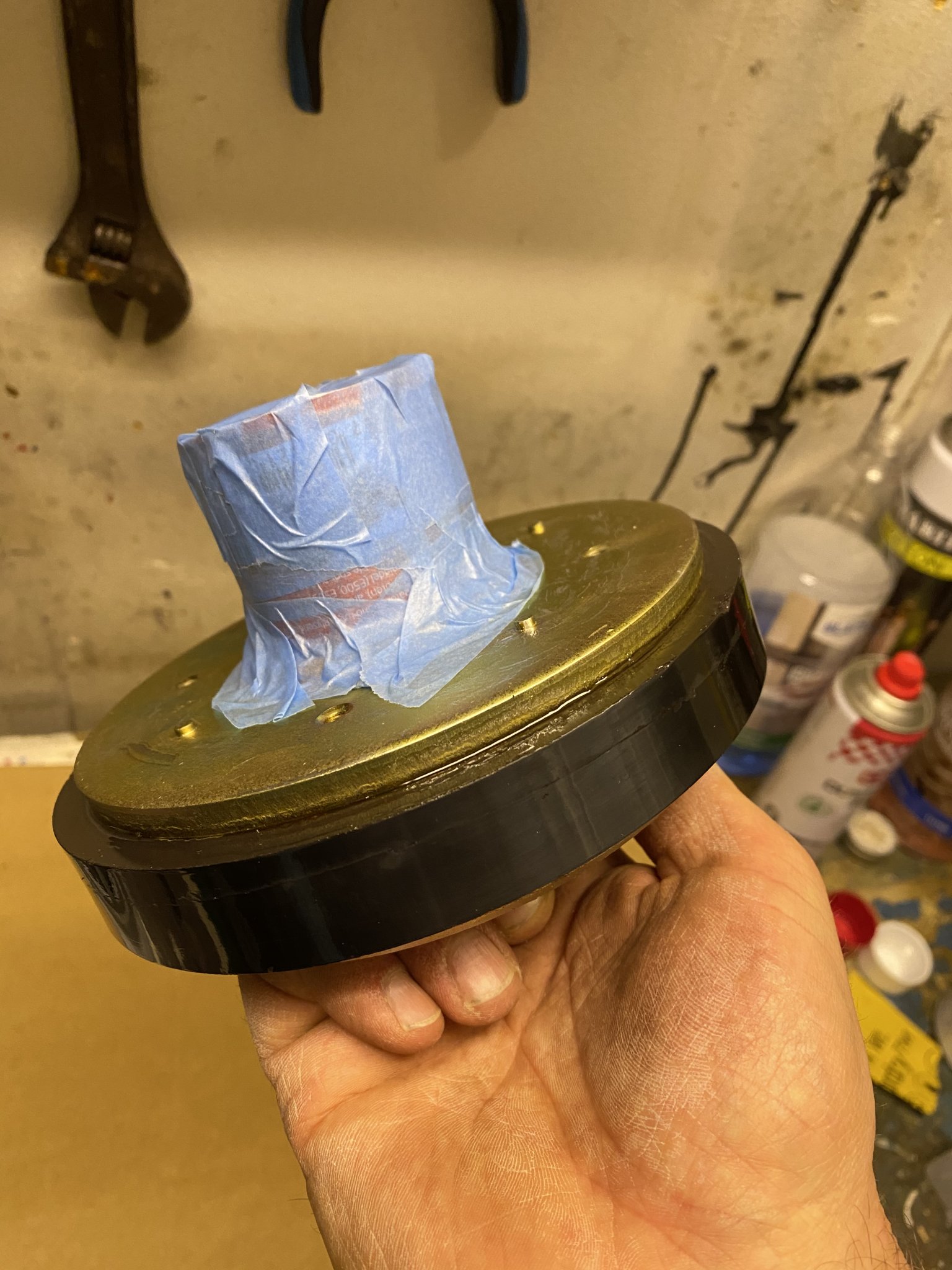

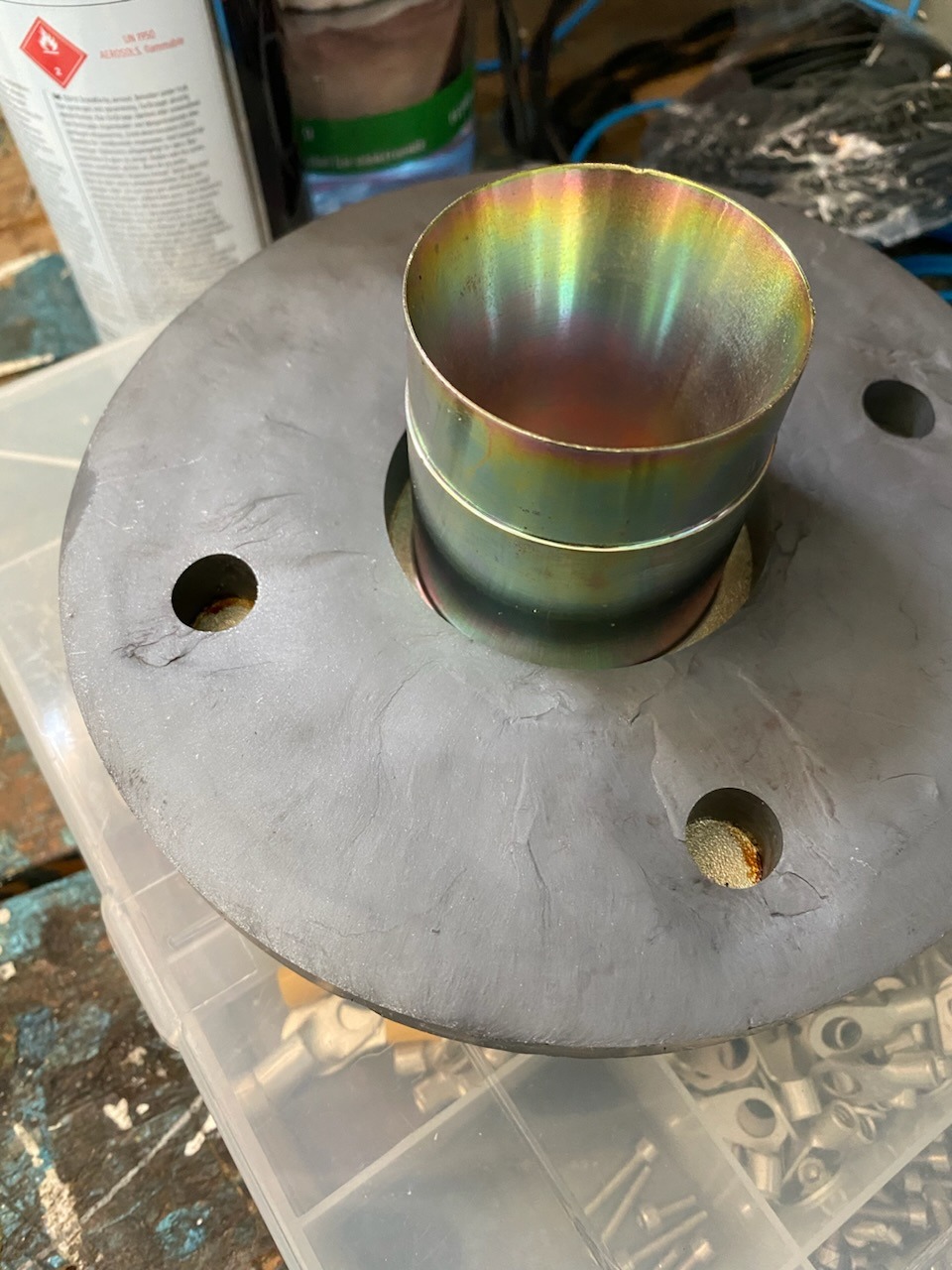

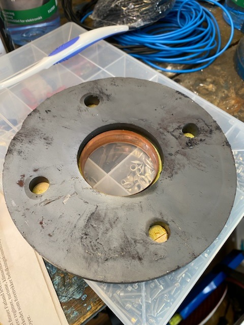

Split the mag assembly, revealing suspected drek between upper and lower halves. Also, the copper ring on the top half was scratched and damaged. So I sanded it with very fine wet dry paper, and bent it back were uneven.
Then, a few hours of cleaning with stocky tape, magnetized screwdrivers, compressed air - heck, whatever worked, and the halves looked like this:
Reactions: chromenuts

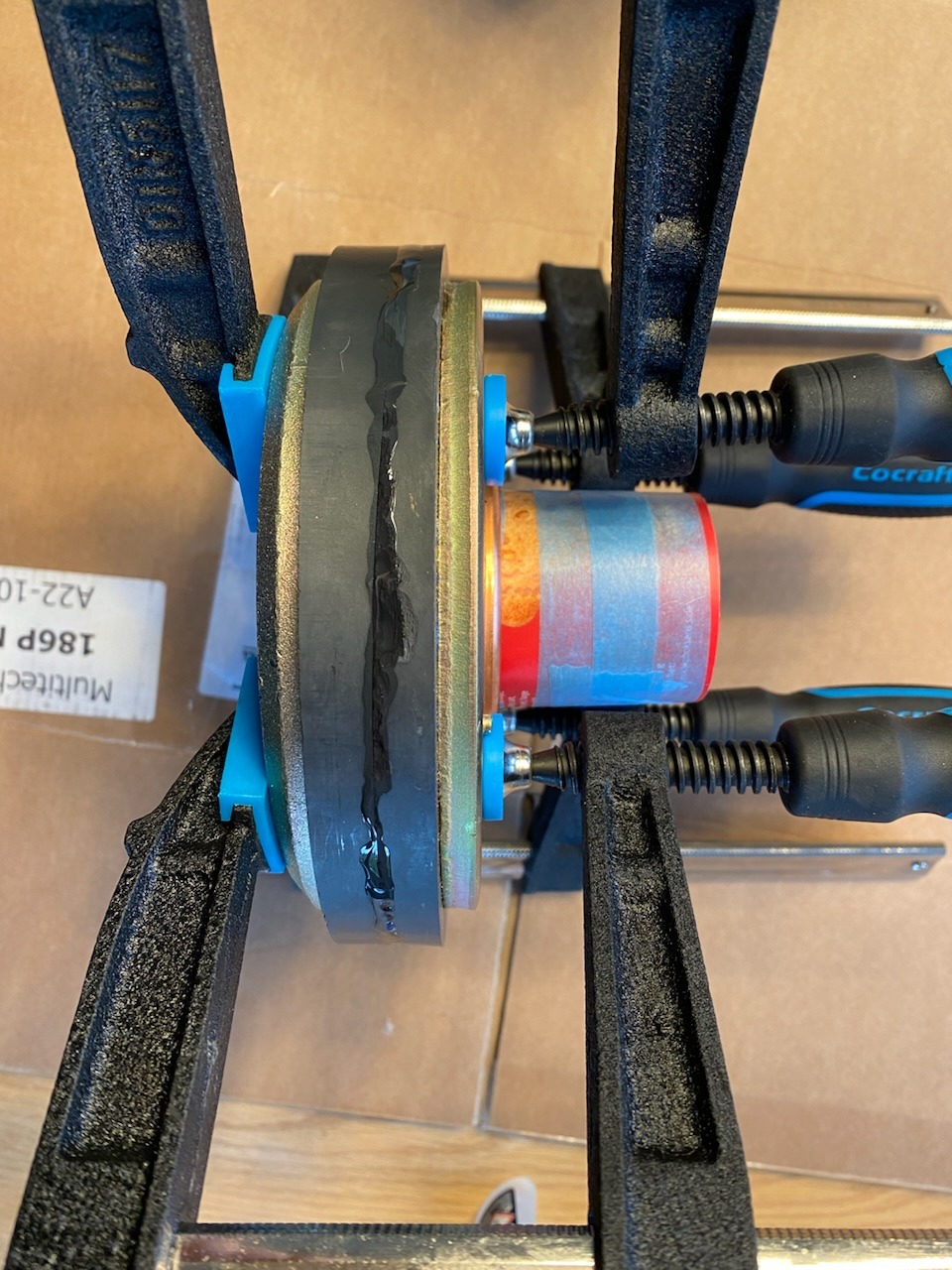

Very few pics from this next process. But it involved making a centerint piece for the gap, using parts of an old gingerbread box and sticky tape. Then using spacers (rubber bit in several layers, then removing one by one slowly), in order to get msgnets back without them crushing each other from the mag force. Then, clamping them, then applying the heaviest glue EVER: loctite super glue. This glue is so super it according to MZM is sucked into the cracks due to a capillary effect. And voila: mag was one piece again. Tests then showed it was possible to move the cone and VC without scratching, so I could proceed 🙂
