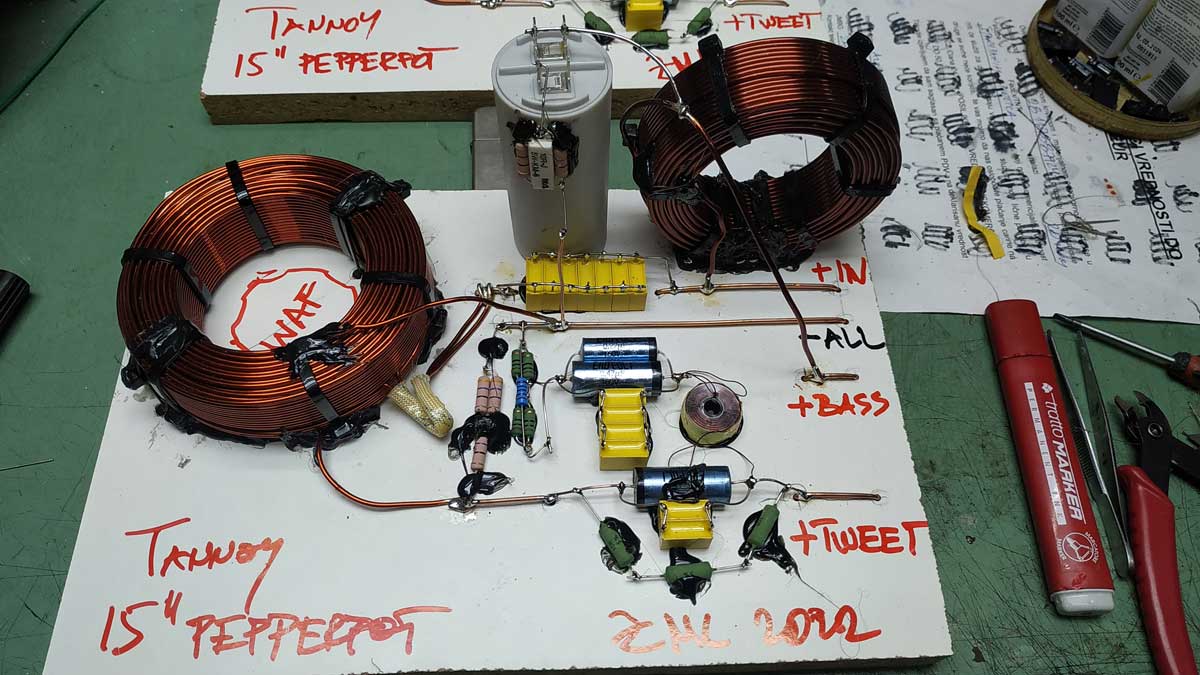

K3149 is Pepperpot driver, so you must use proper Pepperpot xover; CPA12 factually being made with Tulip equipped DC, different beast regarding xover electrically ...... but worth saying (repeating) that I'm finidng them (Pepperpots and Tulips) not so different in sound as one could expect from their physical differences
that's practically clean original Tannoy xover for them where difference between 12" and 15" iteration is "just" in value of series cap in HF section
10" Pepperpot is not demanding autoformer in HF section ( plain parallel choke is OK) while both 12" and 15" are demanding autoformer, where I'm finding "flat" position as preferable
meaning - autoformer is elevating tweet modulation by 20% voltage wise, which is approx. 1db5 to 1db6 increase in SPL, thus after necessary Eq (Newman compensation) tweet is hopefully equal with bass in SPL

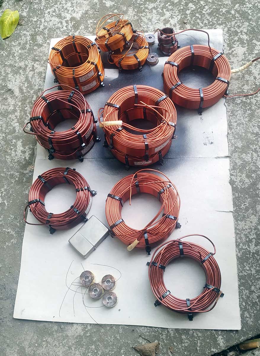

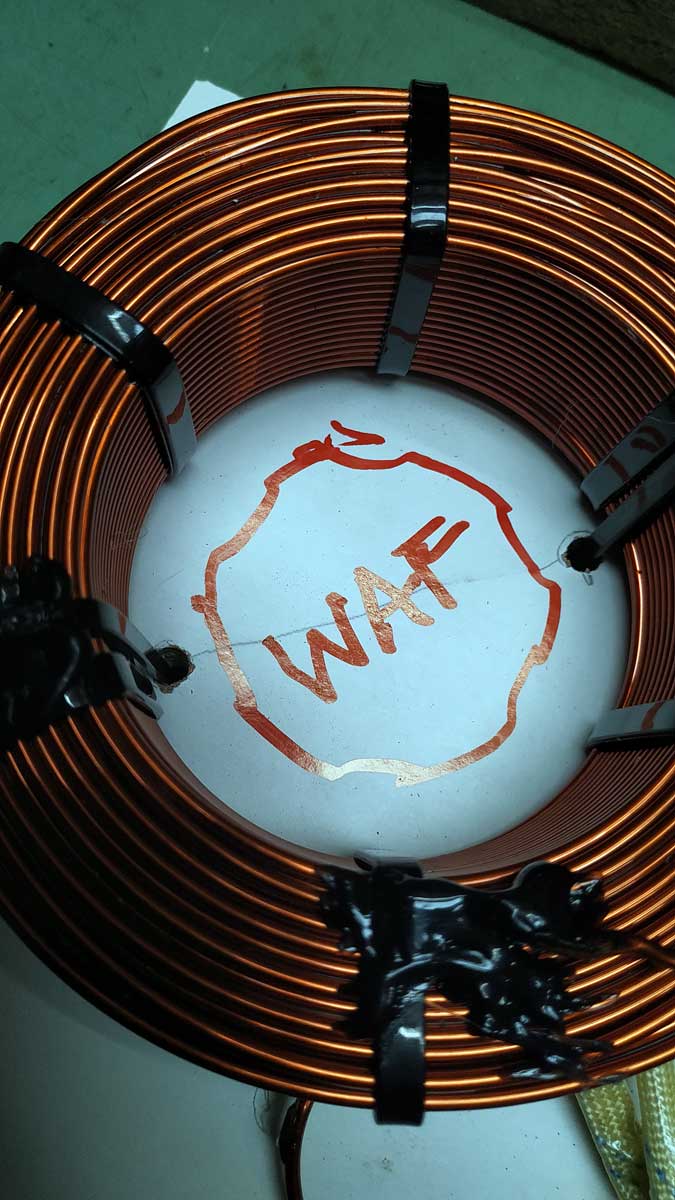

in my Pepperpot xovers I'm using air choke autoformer, inductance value(s) pretty much taken from original Tann autoformer, but air choke version is to my ears superior to puny lumpy piece of EI iron, which is so adored by Tannoy puritans
those ( puritans) are also adoring original Tann boxes, amongst them Westminsters**, but I'm leaving them to their own misery ........ after all these decades I know some things about my own ears so I'm choosing by that, not by penny dreadful publications
as I'm ordering that choke from my winder GranPa, that's pretty much most expensive part in circuit - made with 2mm Dia wire, starting inductance of 2.55mH, then additional 20% of turns... ending in somewhat as 4.45mH, almost 1.5kg lump of copper
1.22mH for bass driver, wound with same 2mm Dia wire is half weight of big one
anyhow, buzz me for Pepperpot xover schm whenever you want; if I remember tomorrow ( now half of usual half of brain) will post it here
**me being old stubborn fart, having opinion about almost everything (even if not caring to express it even when I'm asked to) being sure that only 2 Tann boxes are of substantial value, construction and sound wise; both of them being Horn construction, and none of them called Westminster; Westminster is great advertisement piece, properly made to please eyes, tease wallets and elevate sense of self-importance and social status of owner ......... but substantially not achieving same levels in sound quality area

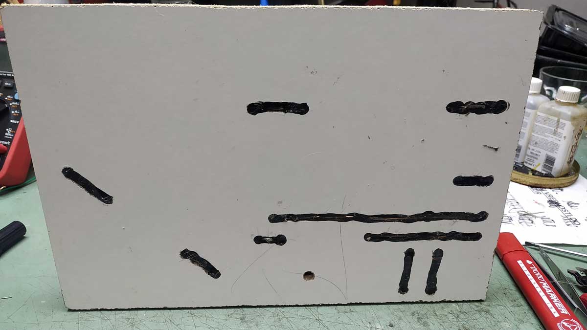

edit: have them, found them

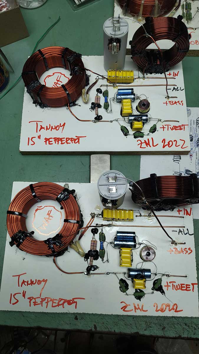

editedit: actual xover pics - these were made for big cabs, so no particular care of miniaturization

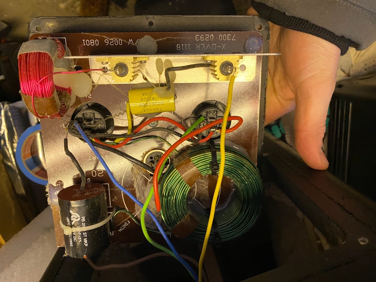

I did get a pair of Tannoy crossovers with my K3149, but they are not the originals intended for them.
My drivers were supposedly from a pair of SRM 12b. The seller only said they worked well with these crossovers.
My understanding is the crossovers are from a pair of SGM 10b speakers. They have the autoformer in the circuit. They are hand labeled “1073”.
I haven’t found much other specific information on them.
I did find some resources on the Tannoy group with some circuit diagrams for SRM and SGM 10 and 12 speakers.

not much headbanging needed - just decide whom you're going to trust
it's that simple
I'll try to get my Buddy 0Waf to explain his experience with xovers shown on these pictures in my last post
they're intended for his pair of 15" MLTL (in making) but he tried them on his pair of original 12" Tann boxes, instead of original xovers; it was needed to clip out 2pcs of 1uF MKC caps in front/start of tweet section, easily redone later
I'm lazy to research which exact model of his speakers is, so easier to get him here
it's that simple
Hi there!
I am that 0Waf guy 😀
My speakers are Tann Devon with HPD315.
Monitor Gold 15 are in cardboard box eaiting for Zen Mods MLTL enclosures.
About xovers:
In short, I wasn't aware how my original xovers masked the sound. With Zen Mods xover it is like in that cliche sentence - a weil has been lifted!
Everything is there vut clearer and better. From bass to high freqs.
This xover should be first tweak for any Tannerd. There are a good chance that some Tanoyistas could abort a build 8f new boxes. At oeast for a while because, ya know...it never ends in this passion of ours. 😀

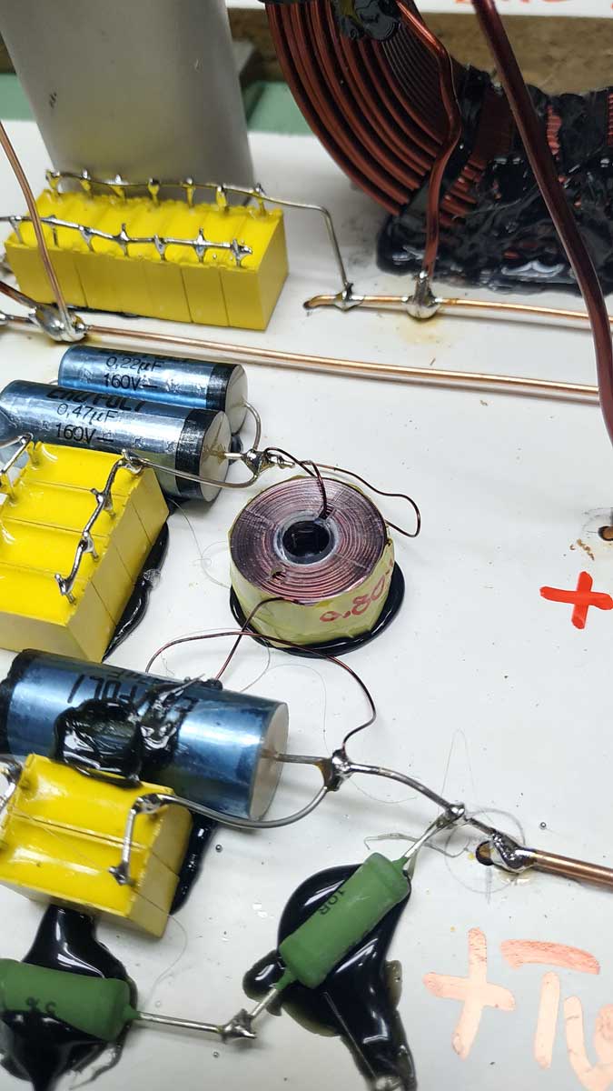

you already got instruction for that, but beingThis begs the question: no point in zen modding the CPA12 XO?
in final boxes (or before that) remove those nasty connectors ( good for quicky pro use, but even for that they're evidently tired)
redo all solder points, try to make wiring between components shortest possible, use 1.6mm solid core for that
observe pics of xovers I posted above, analyze and apply what you observed
if bass choke wire is 1.6mm Dia it is good enough; if you want better, find a way to get it with 2mm Dia wire
rest of part is decent; if you have some doubts in yellow Tann cap, replace it with your preferred poison brand
