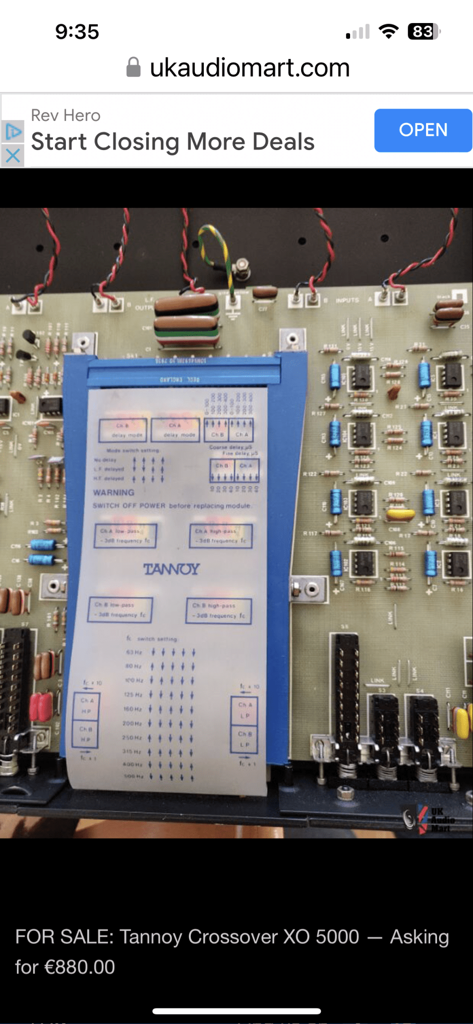

Yes I saw that information and a bit more on Hans’ site when I was researching in it.
It’s a gamble in more ways than one. Vintage piece to start.
Tannoy label…meh…at least it tells me someone had more of a clue than me.
The card installed is the most flexible they offered…rather than design for one driver.
All I can do is cross my fingers and hope I get lucky. 🤞
I paid probably half of what most the “mid-range” aftermarket Tannoy crossover options were asking.

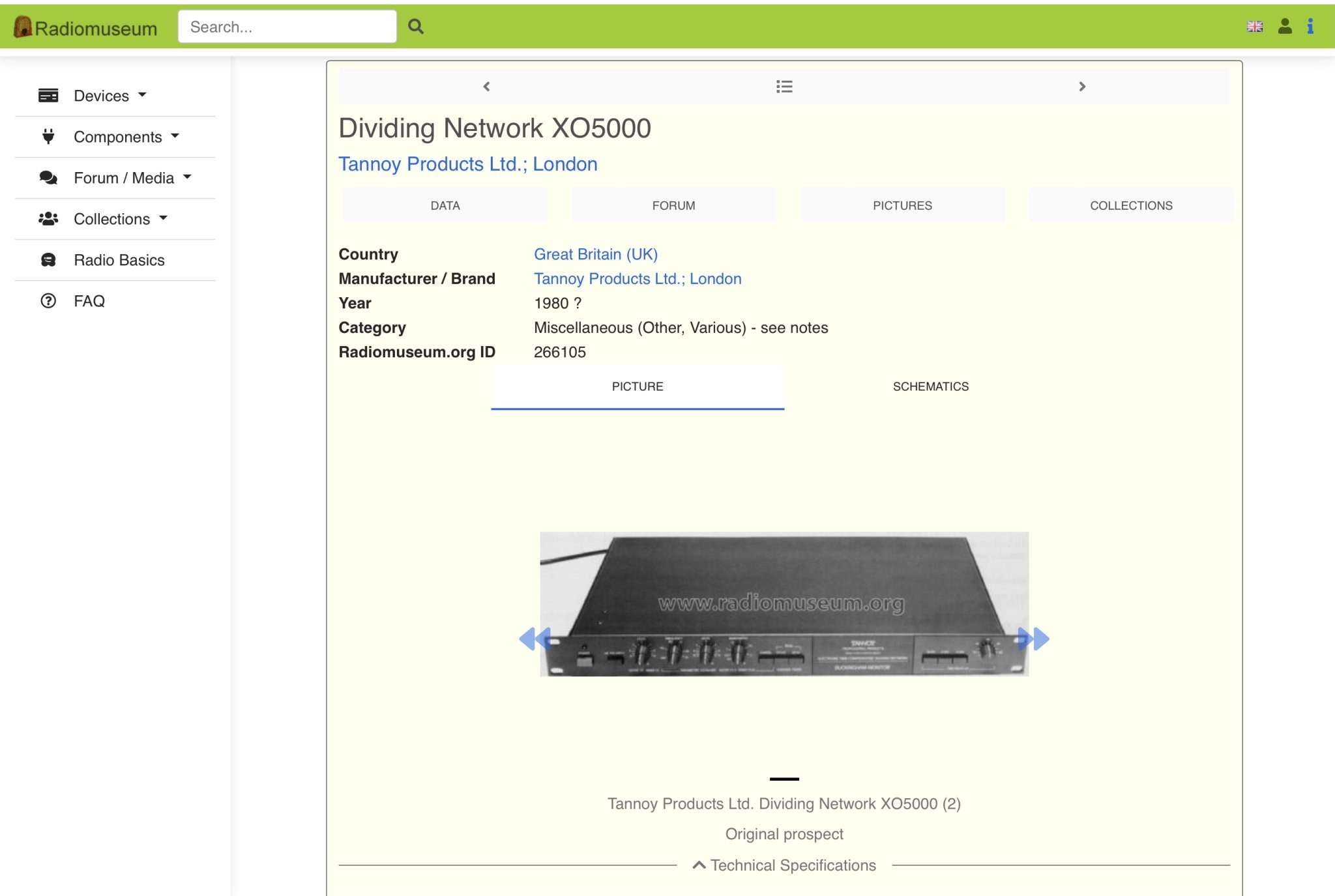

No original manual.have some manual/data?

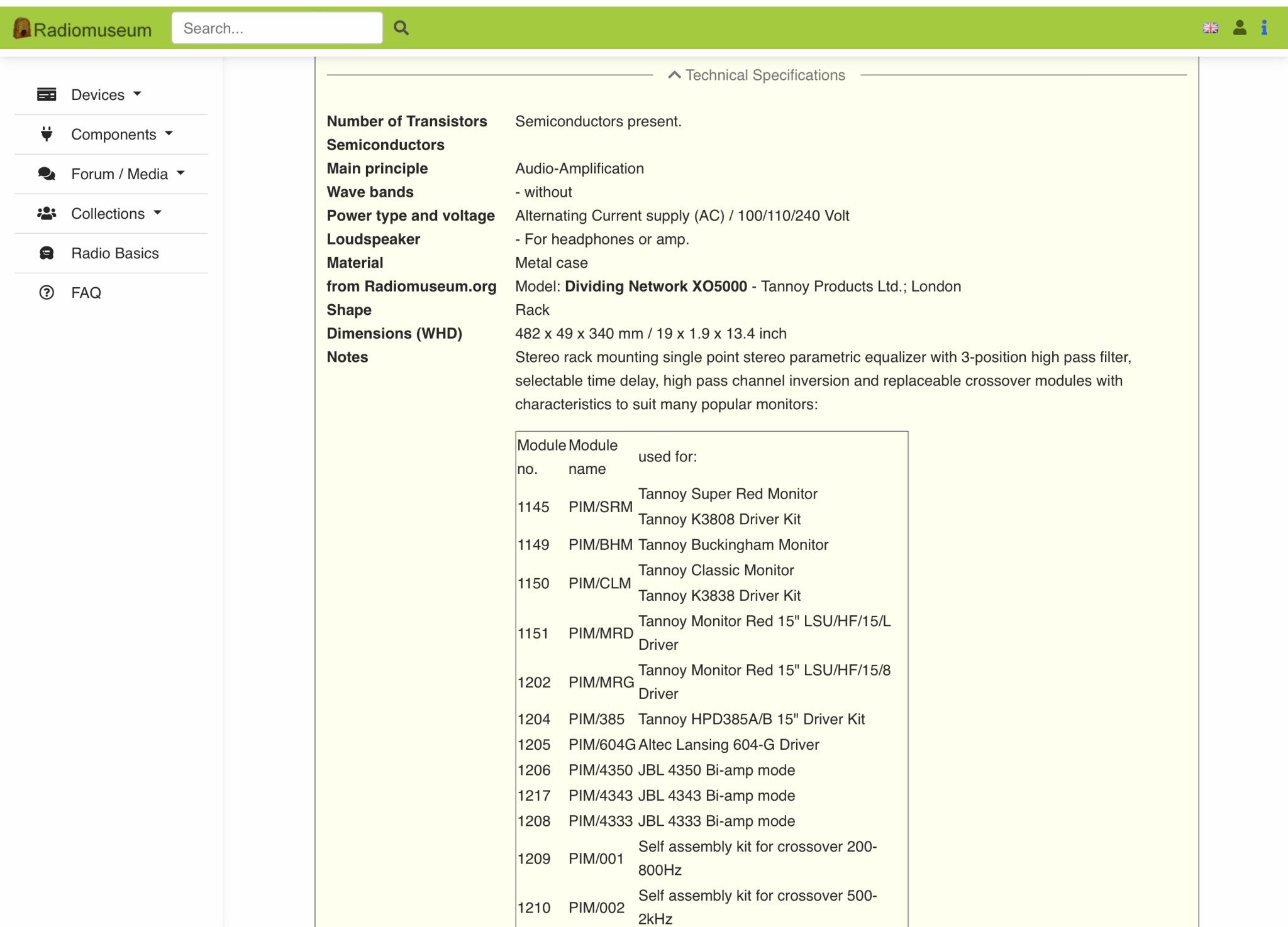

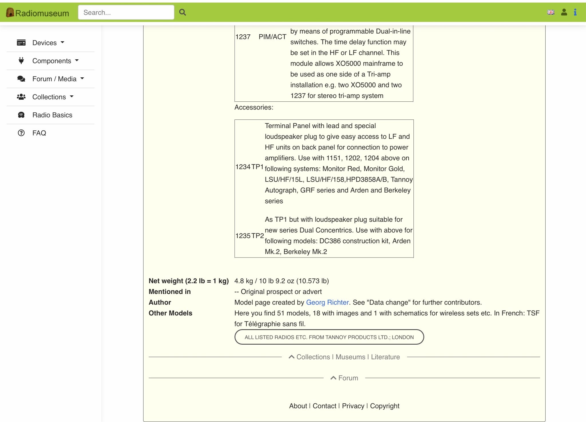

I got basic info off Radiomuseum (screenshots).

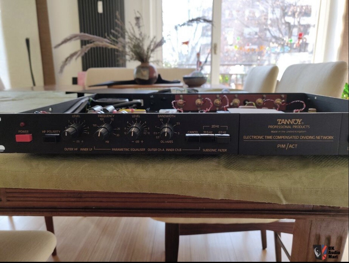

Hans has a link on his website that says he’ll send .pdf or hardcopy of original manual for a contribution. Haven’t done that yet.
There’s a second link on his website with snapshots of unit and a bunch of pages from original manual (file).
Kind of a pain to view, but gives an idea.
Edit: Added close up of card with adjustment switches.

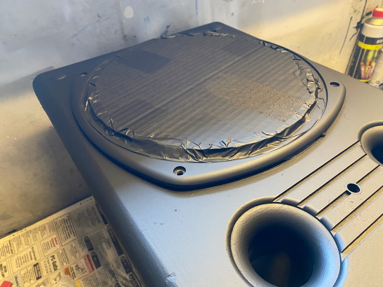

Wrt driver work: Both are now finished, except for basket painting and plastic ring painting. Though those basket rings are damaged, and I originally wanted to swap those, but can’t find new ones. So I am going to remove paint and sand carefully, then paint and see what I get.
Also, need to measure Fs on driver B. Easy and quick, maybe today.

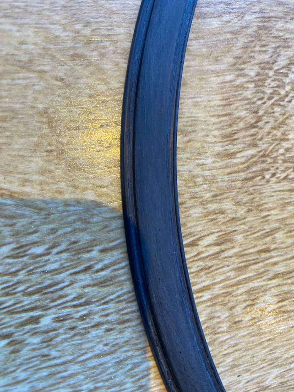

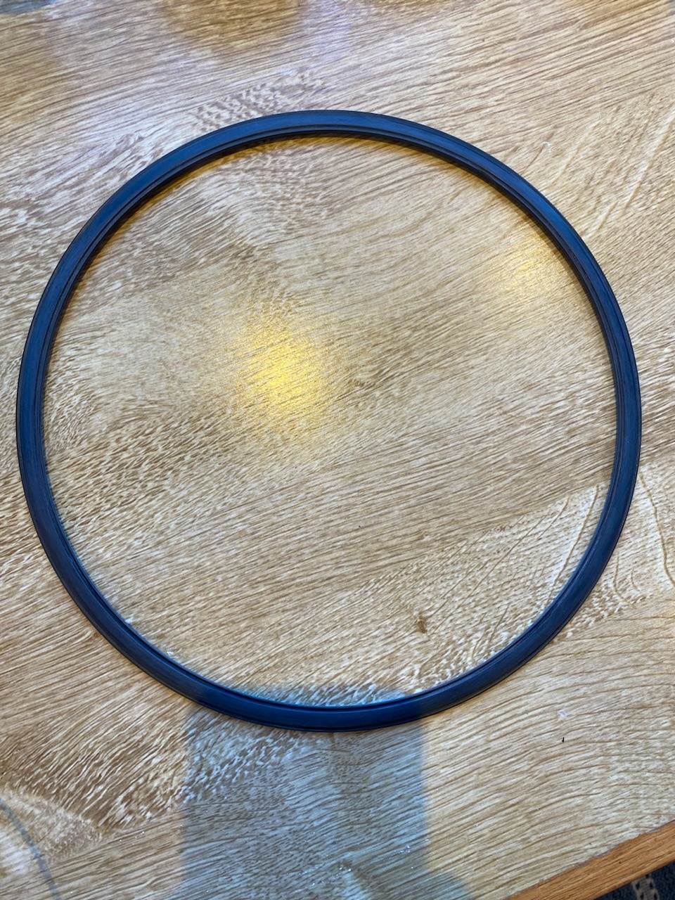

So, ad planned I did some paint removal on the plastic rings that protect the surrounds. Well, this had been perhaps the most tedious job og all during this service, several hours spent…. And a nescessary one: these parts are no longer made, two good UK sources and the Mighty one himself confirm this.
So, to the rescue. Using sand paper of different coarsenezzez, and whatever tools needed to remove all the drekky paint.
Thinner is not recommended, the plastic melts… ehem…
So, some plastic has been sanded away. But it still looks good, and is now ready for paint. The seeming unevennezzez are purely visual, and should be gone when painted. Plan is four coats of matt black spray.
Yes, yes, we all love OCD. But I am planning on very very thin coats
Nah, start with two, then see.
Used 4 on the baskets, and difference between second and fourth coat was significant. Thin coats.
+1 Andynor. Thin coat.
No primer? For plastic i usually sand to 400, clean degrease with isopropyl 99.99% alcohol and apply dedicated primer. Promote adherence and make a proper surface (by filling irregularity). Use nitril non powdered glove if you have to touch parts.
Seems like OCD but it's the way for clean work ime.
Andy is a cheapskate, no primer
me being taught by friend ( now retired) working all his professional life as car body repair/paint Guru
though, these simple works (Tann plastic and Tann basket) aren't so critical, due to wonders of modern paints
in short, primer is proper, but with first timer (at speaker repair) every additional step is increasing risk of ooking something
