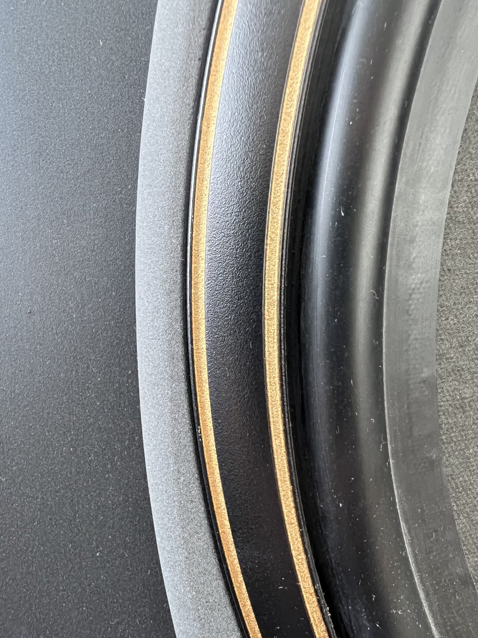

Plastic ring you’re working on…it is the trim (in pic) with gold lines on mine right against the surround? Didn’t know it was removable.

that beautification thingie ( likely useful to decrease edge diffraction) is "just" glued in place
Andy was over-energetic with solvents whole cleaning paint residues on surround and basket rim, so it was loose
Yup, but since there was paint all over - including between the surroung and the plastic fantastic silicon valley thingie, it was very good the first one came loose. The other one came loose really easily.
That said, for a recone, it needs to come off. So it was easily removable, only fastened with a few strips of glue.
In retrosepct, I find drivers a lot like clothes: it can all come off. But sometimes a bit more effort is needed, and cleanup to be expected

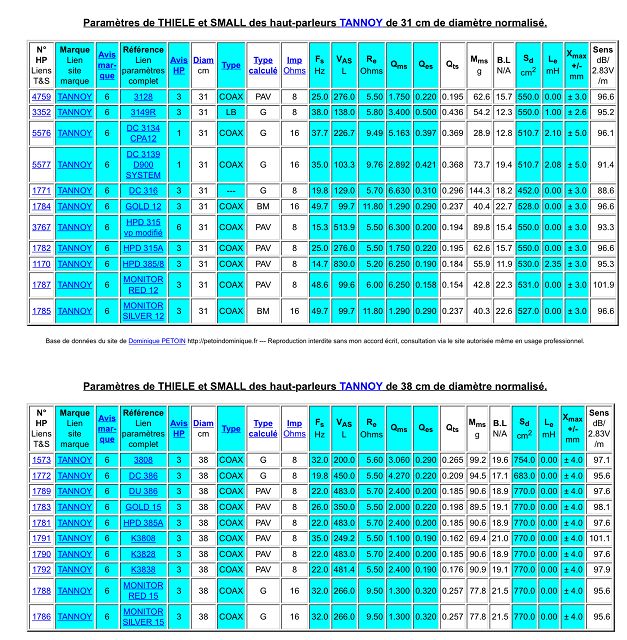

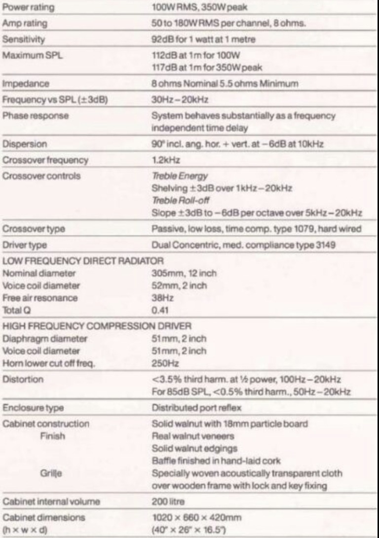

Hi, I’m trying to find the original specs for the 3149 but I can’t find those on the interweb.. I’ve measured the fs on one of my 3149 using scope and generator and it’s around 70hz. I’m pretty sure it’s suppose to be lower than that.
That cloth surround? 70hz Fs is nothing new to Mighty… just follow his lead. Alcohol, rat poison, the cure.Hi, I’m trying to find the original specs for the 3149 but I can’t find those on the interweb.. I’ve measured the fs on one of my 3149 using scope and generator and it’s around 70hz. I’m pretty sure it’s suppose to be lower than that.
38 is the factory facit according to this spec sheet from an old 3149 ad. Mine are supposed to be around the same, though now they measure 30hz. Need to retest whilst pressing the driver against the table, according to Mighty, iot get it absolutely correct. But a ballpark reading it is 🙂Hi, I’m trying to find the original specs for the 3149 but I can’t find those on the interweb.. I’ve measured the fs on one of my 3149 using scope and generator and it’s around 70hz. I’m pretty sure it’s suppose to be lower than that.
