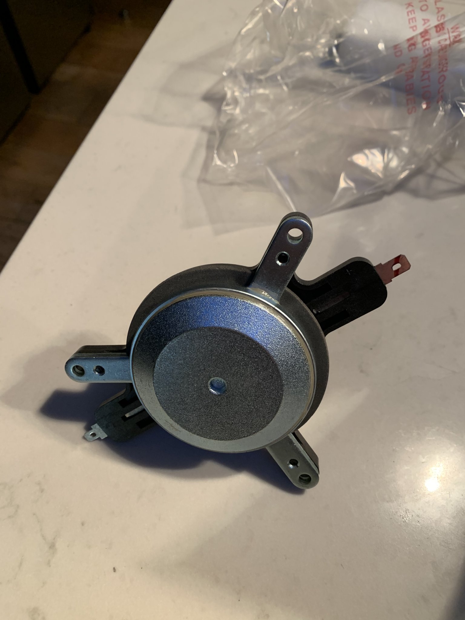

I got one tweet with ff with the drivers. It was produced in 2006 and supplied by the Norwegian importer at the time.
Nick @ Lockwood has succeeded in getting the last three tweeters from Tannoys stock, and I will get one of them. They are normally sold with ff, Nick is double checking this. Price was 165E.

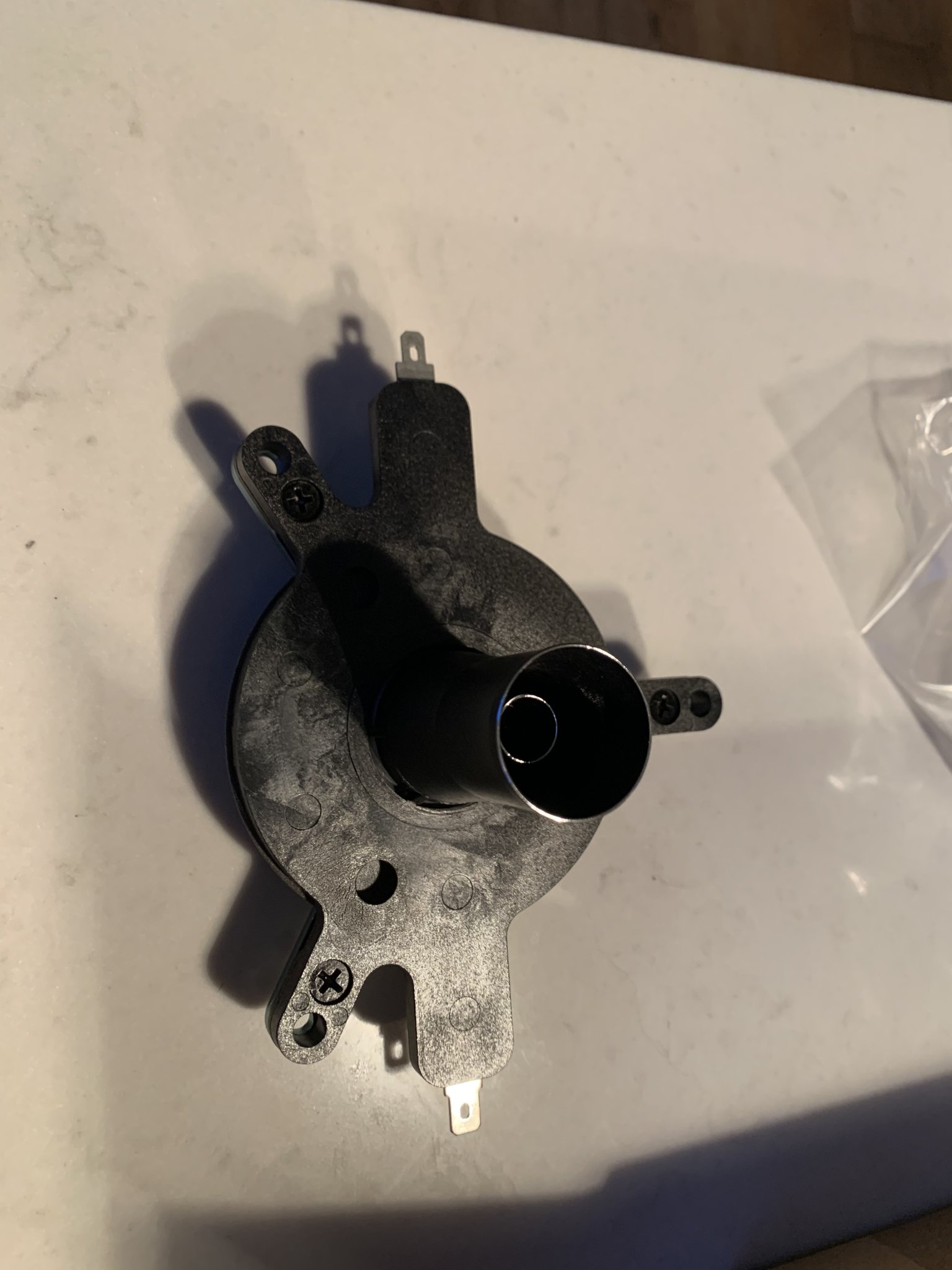

so, just heard back from Nick: There is even a magnet assembly inlcuded with my new tweeter. So no ferrofluid needed, allready in.
I did not get it yet, but I am trying to decide whether to buy 1 or 2. now, since the mags are different (also, mine do not have screws, the plastic part is «loose» until magnet is fastened to basket magnet assembly, I will only buy one. But it still needs to be confirmed that the part fits, so I will do some more checking today.

Dodo, exactly as I presumed - you got new one, having smaller magnet than original
