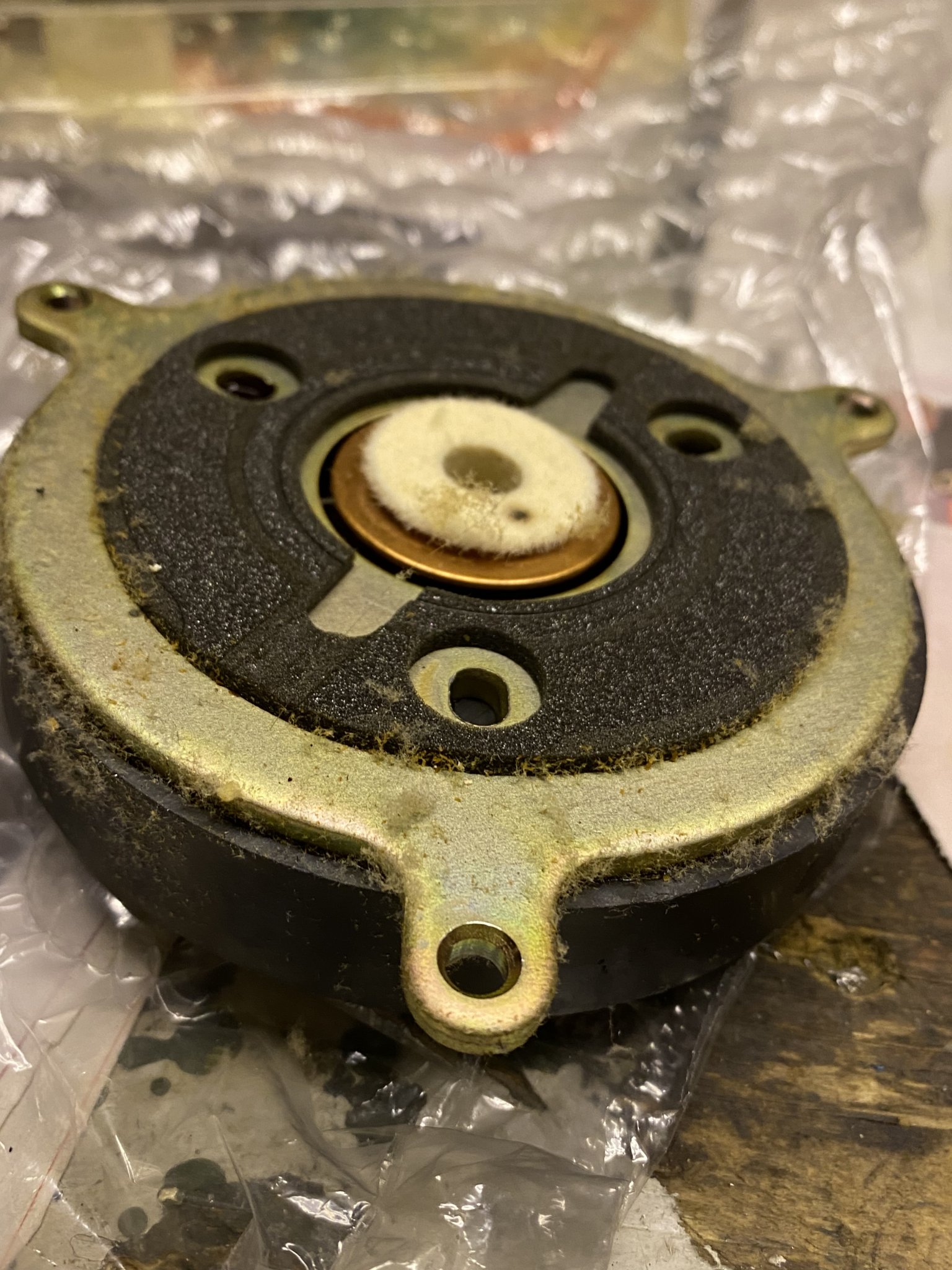

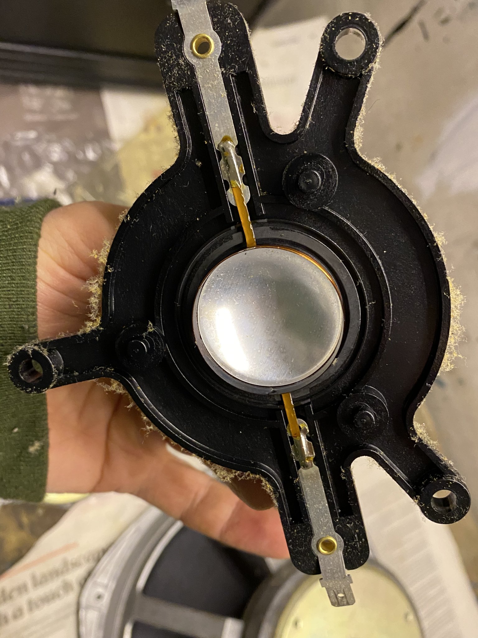

Now, in my case, a combo of long time use, and an attempt to clean away dirt, has left me with dirty ferrofluid in both drivers and unequal amounts of Ferrofluid.
So I will also be servicing tweeters.
Step 1: Full clean, also of gap (to come)
Step 2: Regluing of magnet assembly, and then applying dammar to provide nice finish and ensure loose magnet bits stay in place (they are everywhere!!
3: Replacing Ferrofluid (with syringe, with drug addict needle to get properly into the gap)
Now, since Tannoy in 2006 provided a syringe with proper ferrofluid type and ampunt with the replacement tweeter diaphragm, I know the specified amount is 0,3mL, and the type to be APGS15N.
Now, I have somehow managed to get hold of another spare bottle of ferrofluid of the correct type. I have also bought several syringes, and greedy and not so greedy boyz have started to line up for leftovers
Hierarchy will rule, and I will take what I need first. With something to spare, not much.
Attached is a few pics that explain some of the reasons why I am servicing tweets too.
And yes, I did destroy one diaphragm, and yes - I wasted some ferrofluid from the provided replacement syringe, so now I needed more ferrofluid.

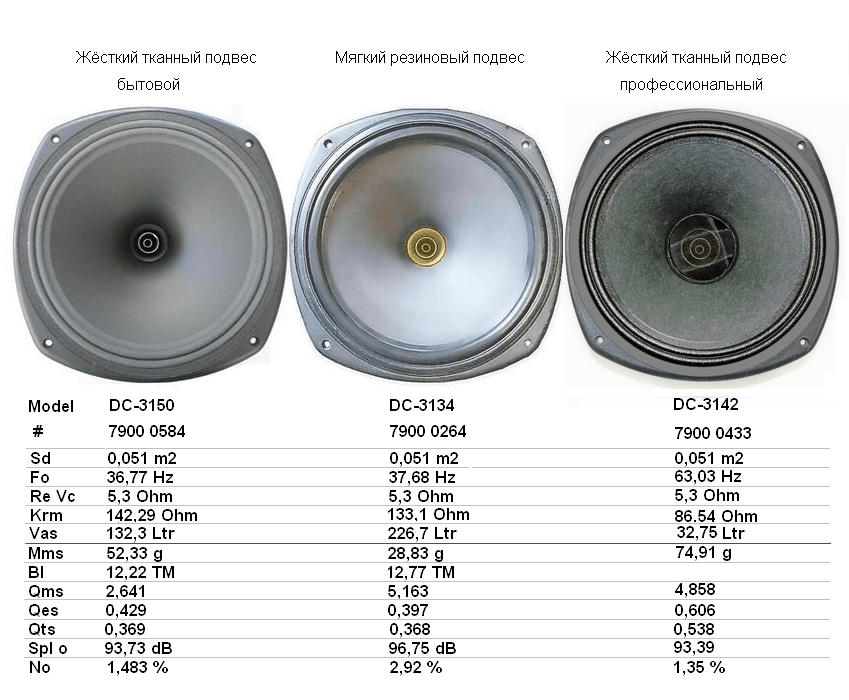

Now, what ferrofluid is needed for your drivers?
Master MZM had cleverly explained to me that a lot of DC’s use the same tweeters as 3134, so if you own one of a certain few drivers, you need APGS15N ferrofluid and at least 0,3mL in each tweeter gap (after cleaning). Now, so that it is said: MZM/I will test both 0,3mL and 0,5mL and decide proper amount. It is likely better to use a tad too much than too little.
The following use this ferrofluid @ 0,3mL:
3134
3142
3139
3150
3833
3836
3840

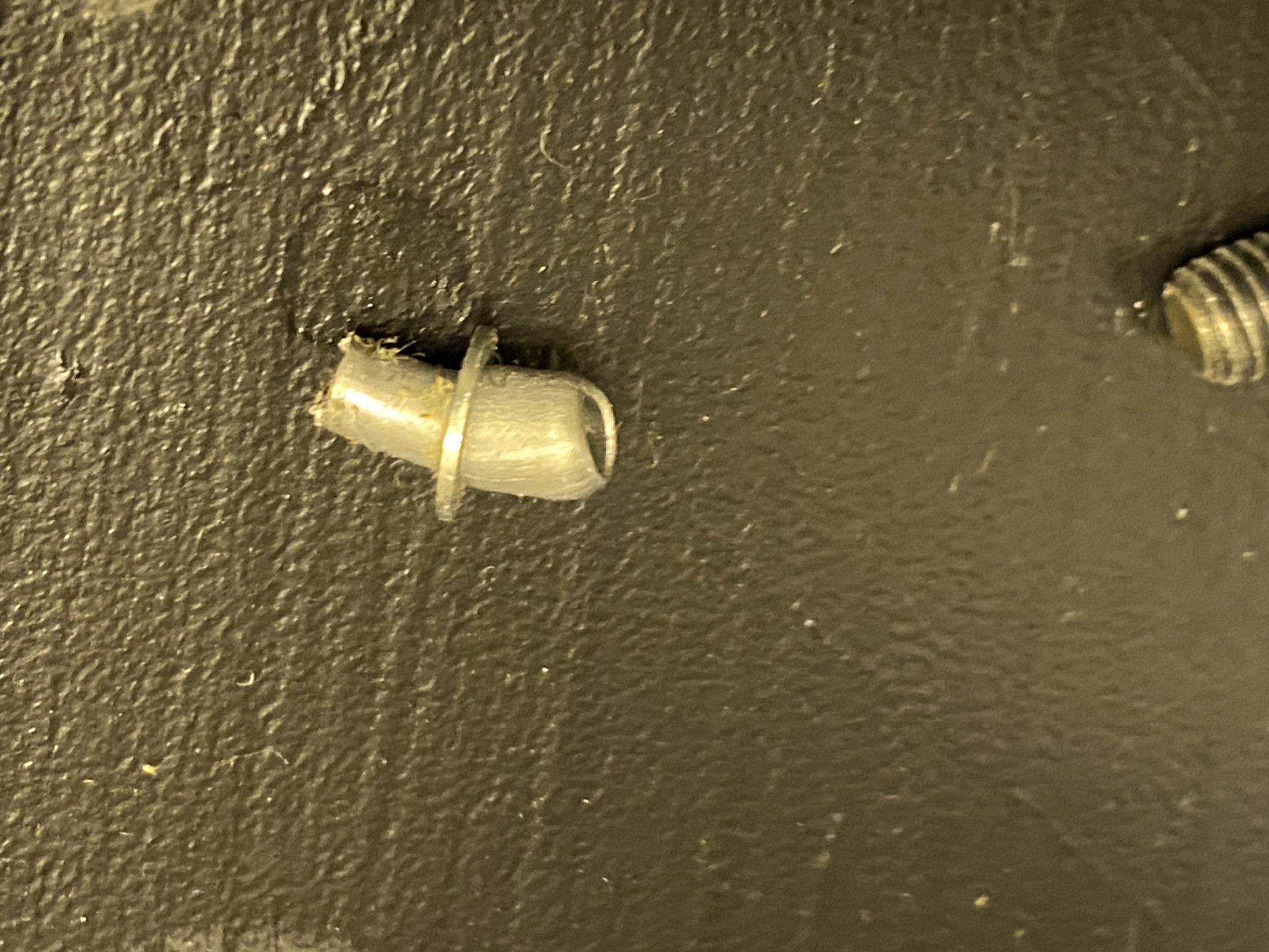

I know, but it will not hurt. I bought three syringes and two needles for 2 dollars. So who cares
Please note that there are syringes that have a rubber piston. This rubber part may be incompatible with ferrofluid. So for short period for just filling that is ok, you will not notice any problem. But do not use such syringes as a storage container. It may damage the ferrofluid and the piston. Other types of syringes which do not have this rubber piston are no problem at all.
Nice to see Ferrotech Europe joining the discussionPlease note that there are syringes that have a rubber piston. This rubber part may be incompatible with ferrofluid. So for short period for just filling that is ok, you will not notice any problem. But do not use such syringes as a storage container. It may damage the ferrofluid and the piston. Other types of syringes which do not have this rubber piston are no problem at all.
Also, a very good point. The 17 year old rubber in my syringe provided by Tannoy, looked as if it had started to dissolve.
