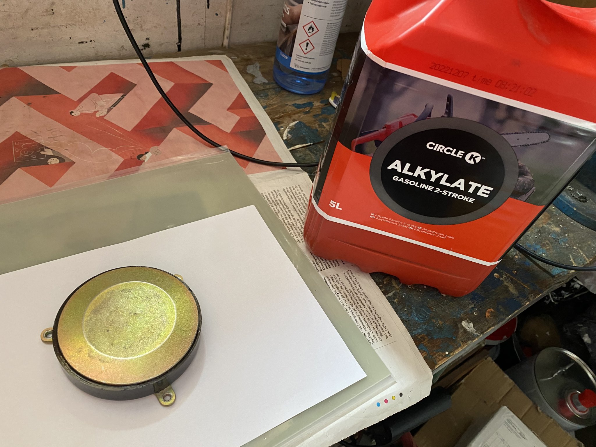

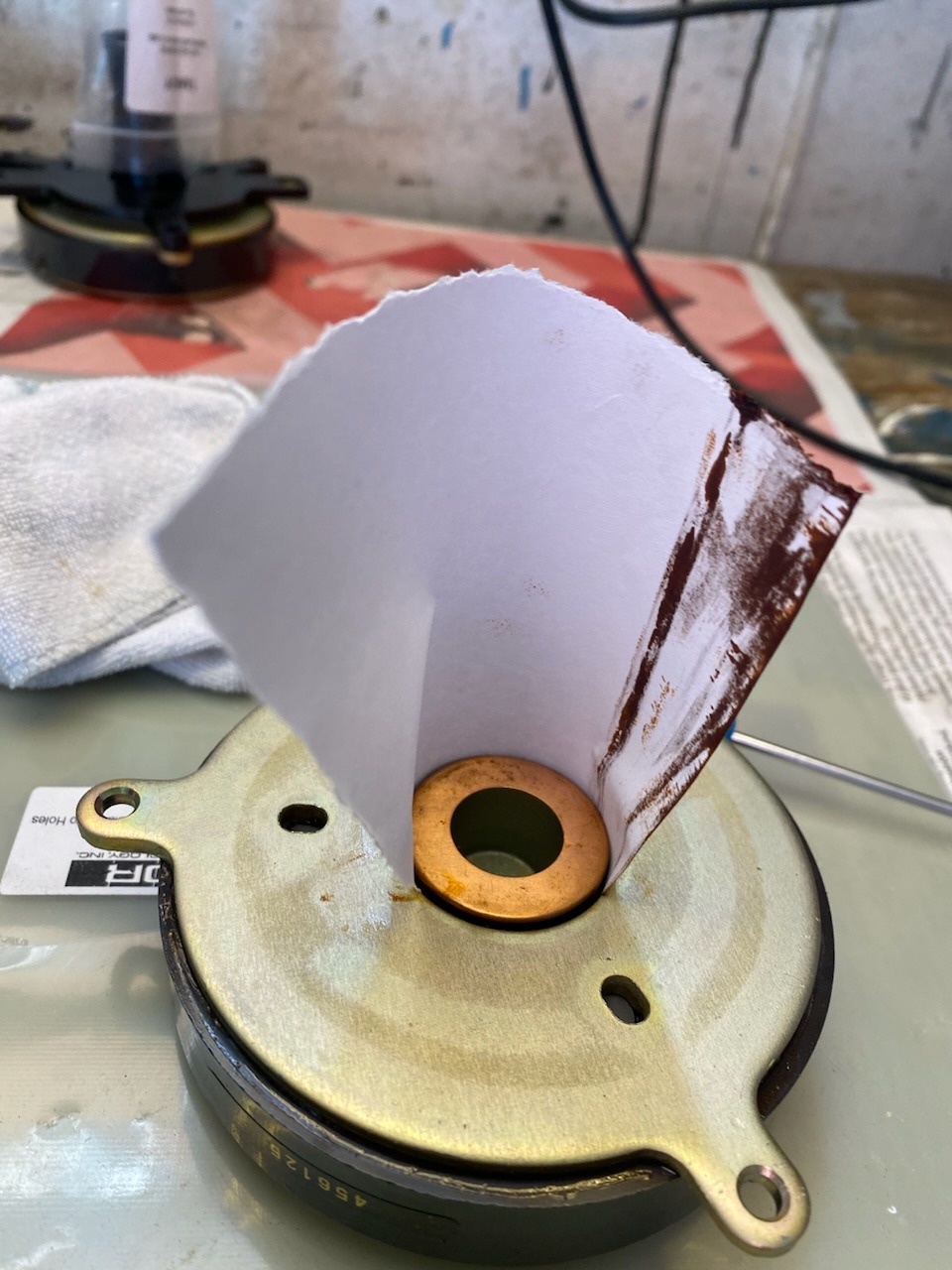

Some work. Both gaps now cleaned. They do not seem to have been opened before by me. Still dust and probably residue from speaker damping material had gotten into the gaps. Along with some metal residue. Got it all out, and topped it off with alcohol soaked paper. Succeeded using normal A4 printer paper. Metal bits came out with the help of small magnetized screwdriver.

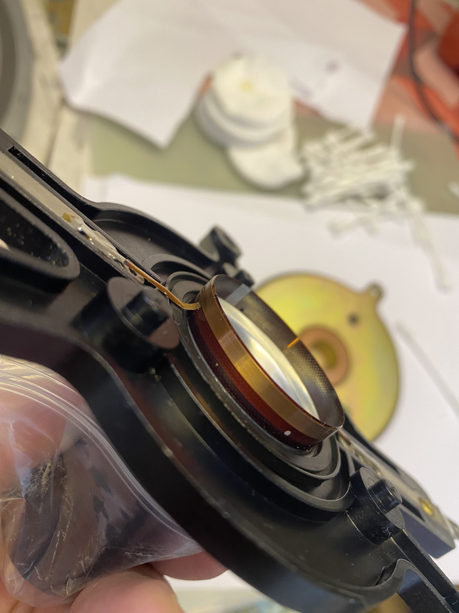

Next to clean tweeter plastic assemblies including VC and diaphragm, with alcohol and q-tips for starters.

bits and bits. Let’s call it two small fragments in one of the two gaps.

Alcohol works somehow. However, as the Ferrofluid carrier is a synthetic ester, a hydrocarbon solvent like alkylate gasoline (here you can buy it branded as Aspen fuel) or a light petrol should do better, as it mixes with ferroflud easily in every ratio.Next to clean tweeter plastic assemblies including VC and diaphragm, with alcohol and q-tips for starters.

Thanks for that!Alcohol works somehow. However, as the Ferrofluid carrier is a synthetic ester, a hydrocarbon solvent like alkylate gasoline (here you can buy it branded as Aspen fuel) or a light petrol should do better, as it mixes with ferroflud easily in every ratio.

Alkylate gazoline really cleaned up much, much better than isoprop/alcohol, both gap and VC cleaned an extra time.
