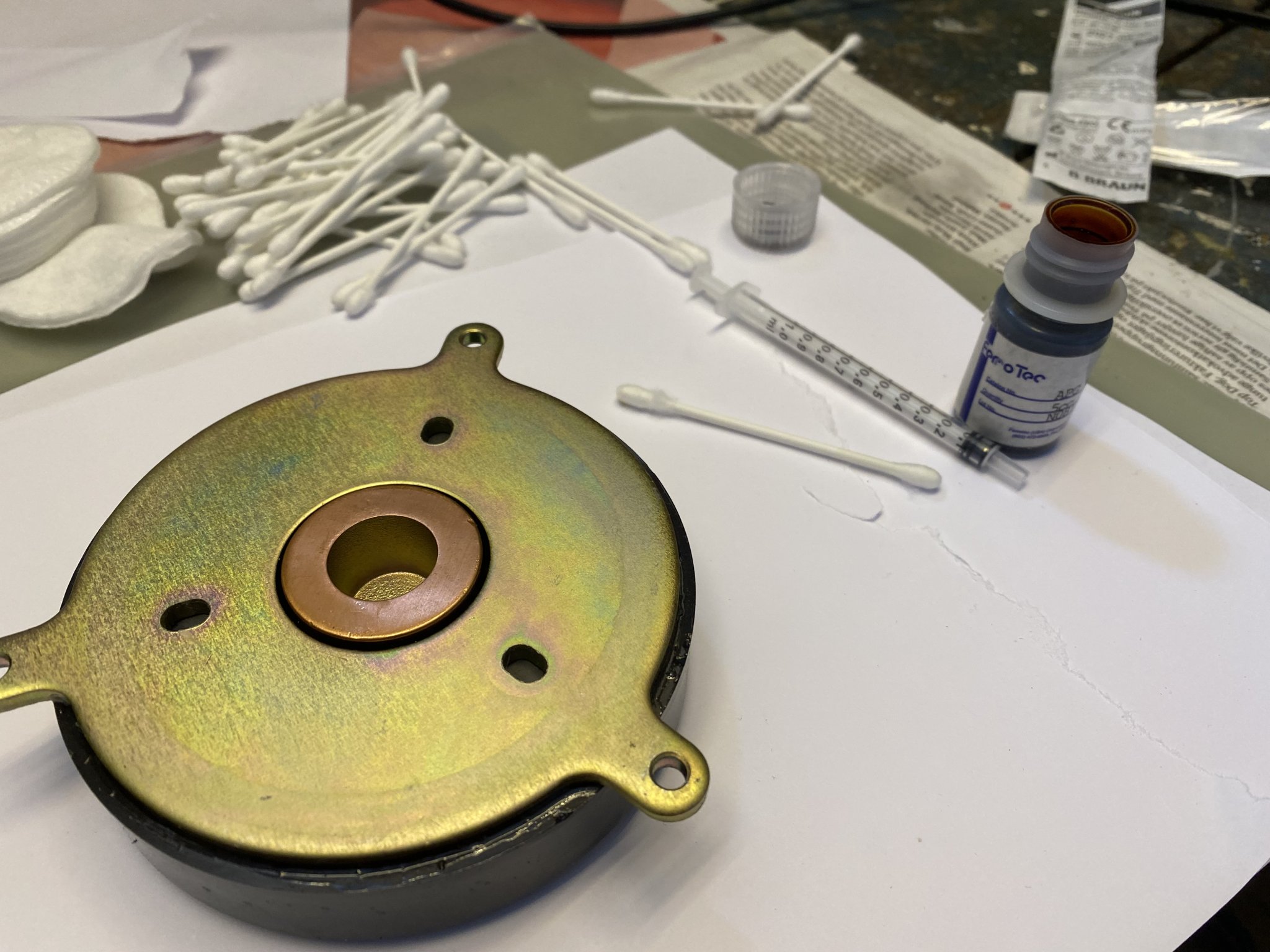

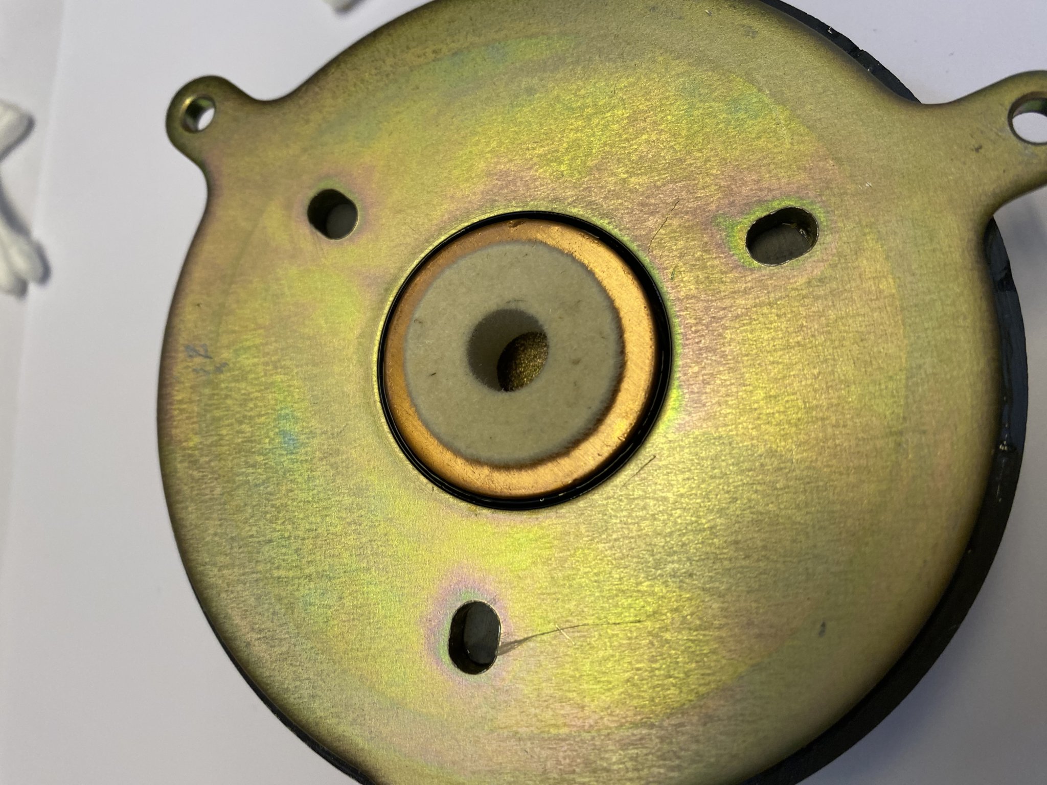

0,34. For starters. Easy to add more laterzzzz, but ******** impossible to remove only a tad. So this is more economic. Good filling with that amount.how much ferrogunk you put in gap?
0.5 or 0.6, as we spoke?

I found 0,35mL proper to fill the gap. But I will ship 1,2mL to both you guys so you can experiment. No timing on shipping yet, need some small bottles etc first.was it consensus that 5mL is proper for one?
or less?
