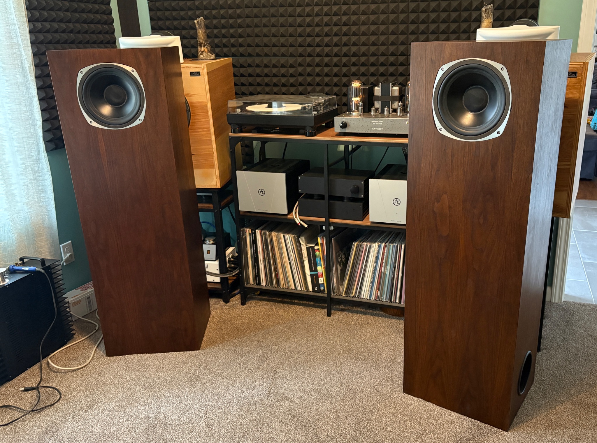

Porn for ZM 🙂

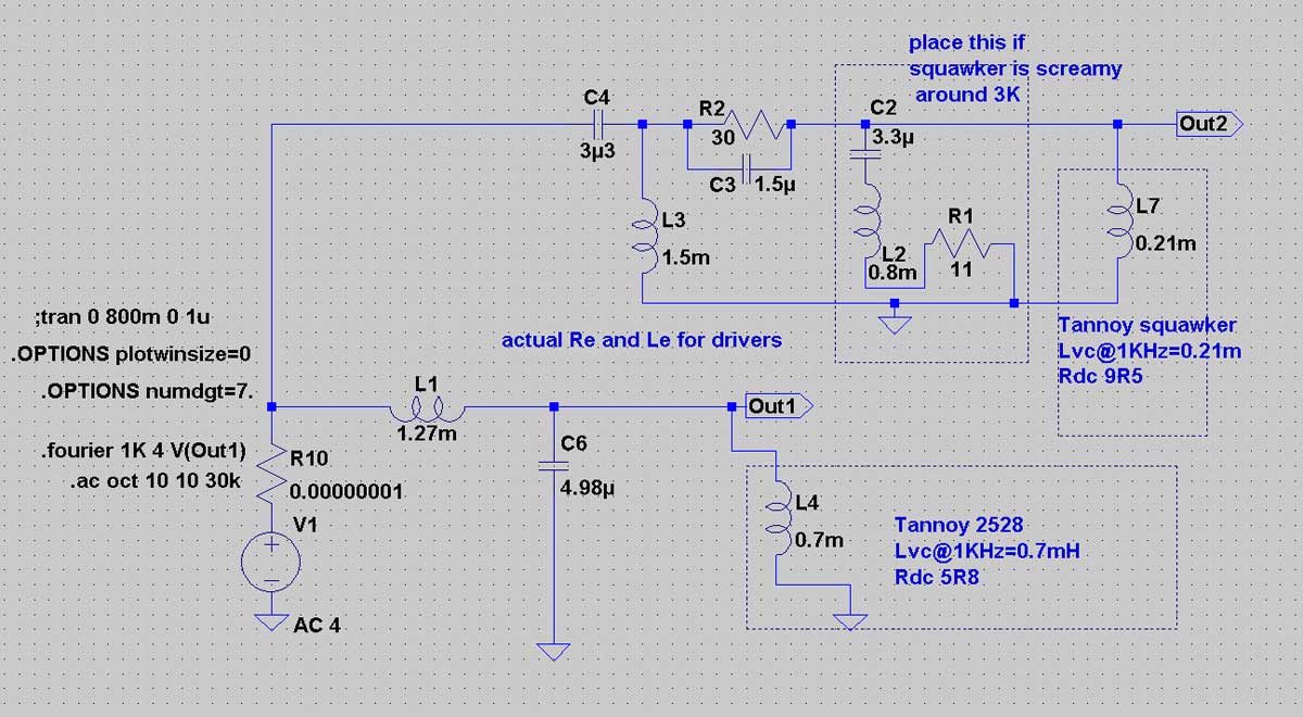

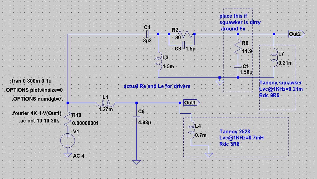

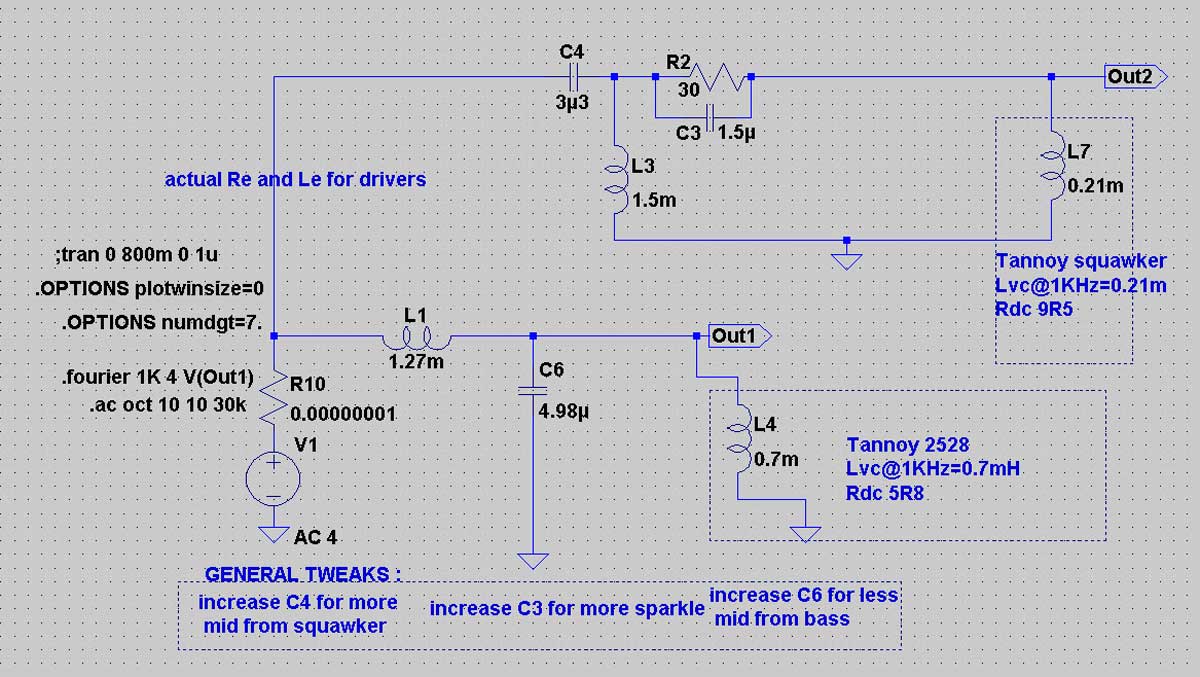

And here's that crossover I settled on. It's the same design ZM posted many moons ago (also attached), with all optional sub-circuits employed and some value changes to accommodate my drivers, room, etc.

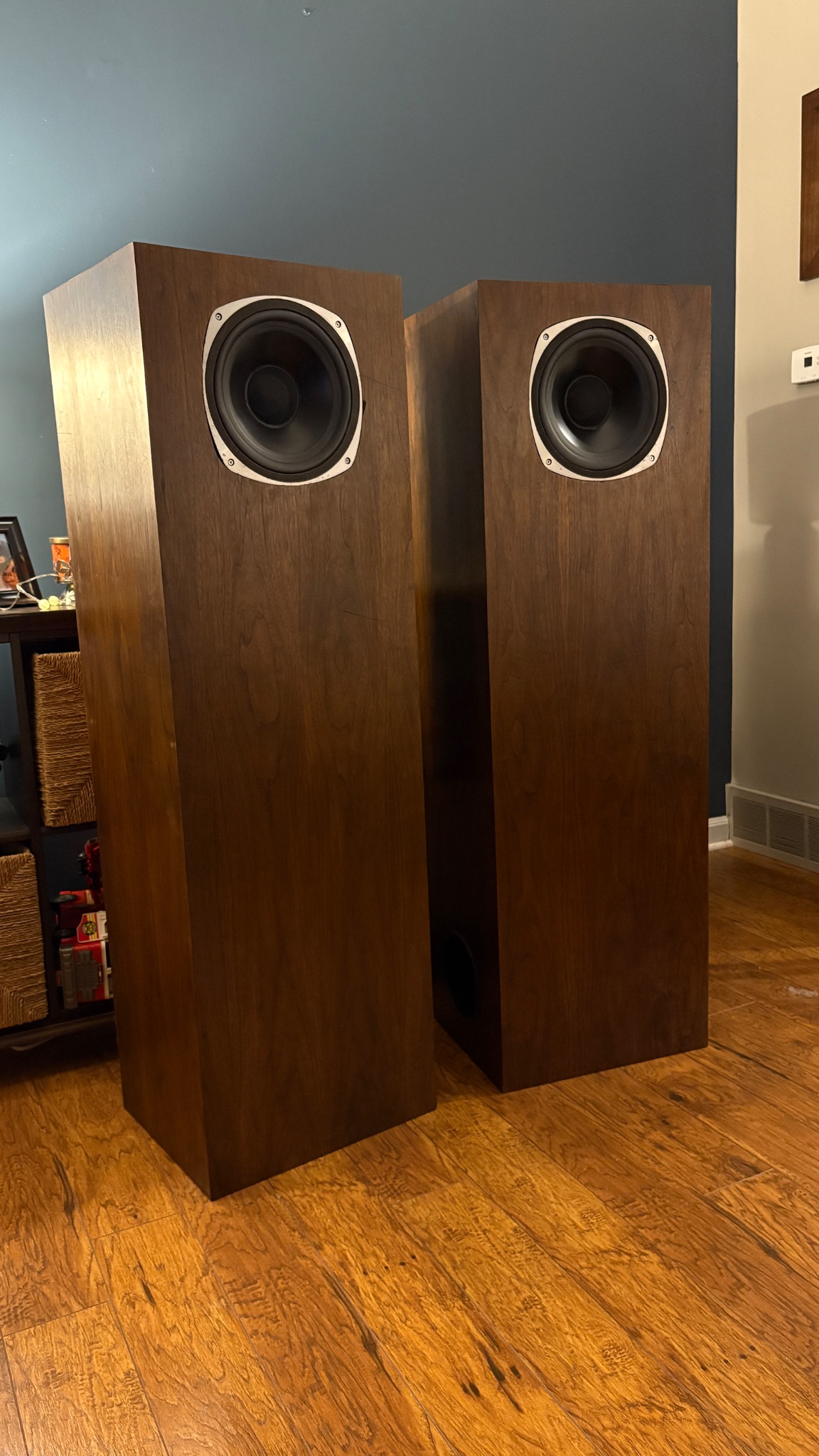

That's a pretty good sized box. Not giant, but not tiny.
Most suitable speakers are big, these no exception. Unless you don't want bass, I want that most definitely!
Hmmm. Maybe I should pole barn a giant "listening barn" and store large speakers and have room to rotate. Heaven forbid selling any!
