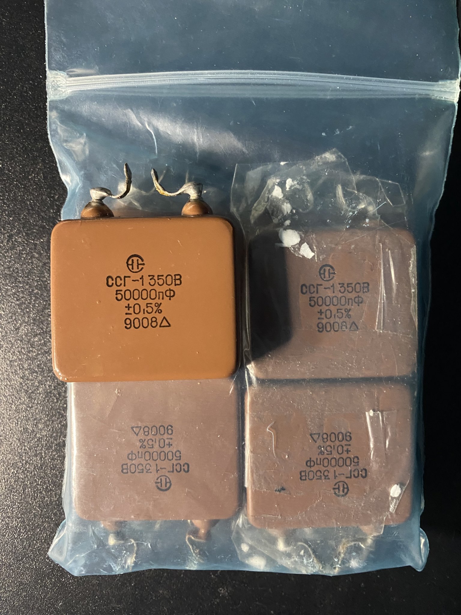

ссг from russian is ssg, translated with google.
Initially I remembered them as being teflon but after a quick search I seen these are silver mica.

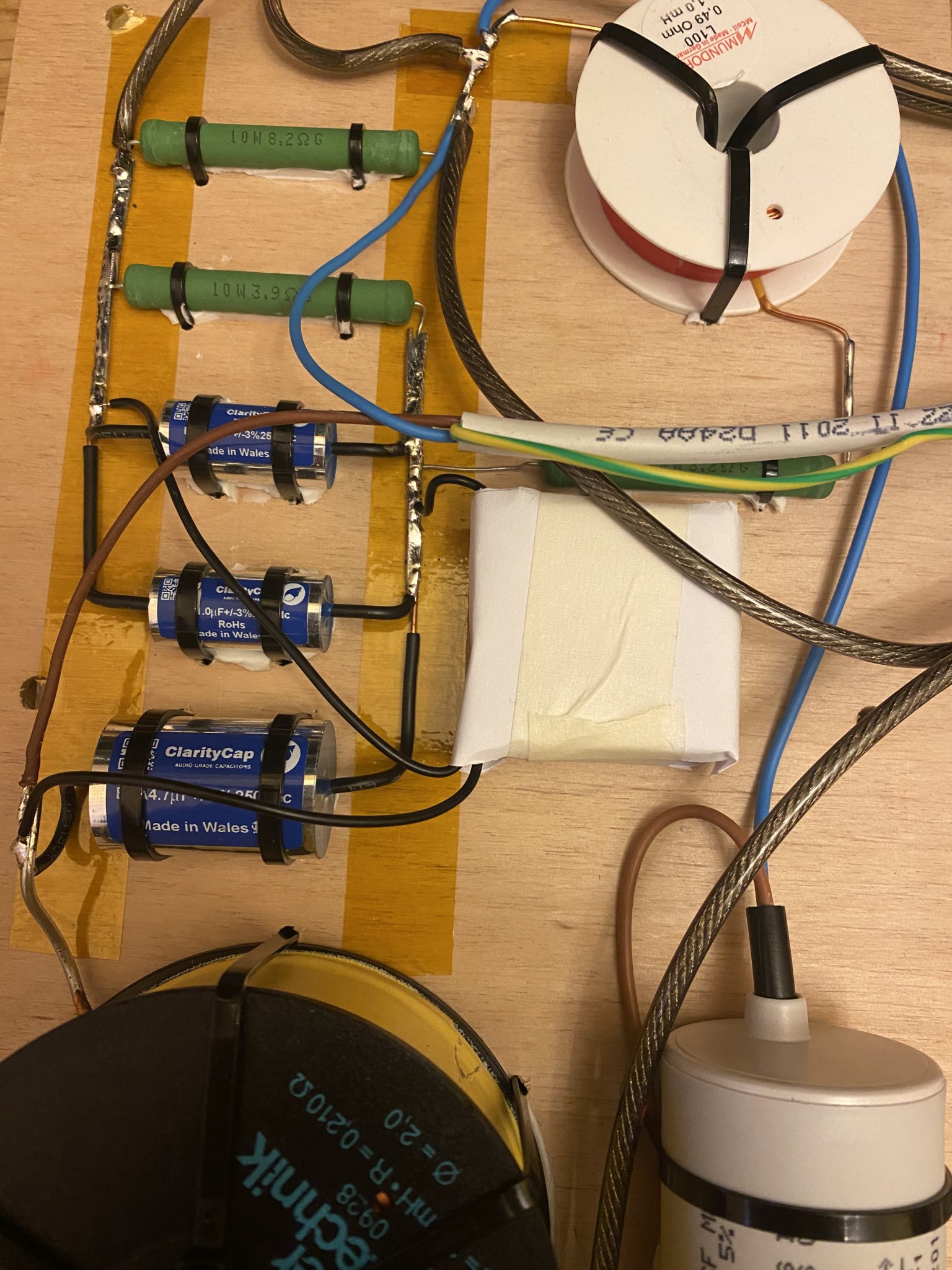

I still have some spare space on the crossover pcb so the entire night I kept thinking about these caps.

Silver MICAs are great, I use them in my xo too, for tweeter bypass. You may try difderent values to get the best sound, however.I have 8pcs of 50nf silver mica caps.
Was thinking to connect 1-2 pieces in parallel and then use them as bypass for the 2 caps in the tweeter crossover network.
Anyone had experience with silver micas as bypass caps?
Yes, they are silver MICA: https://tubes-store.com/index.php?cPath=35_67_99ссг from russian is ssg, translated with google.

I can try with 50nf or 100nf. This because I don’t have enough capacitors for more than that and I will alter also the crossover points by adding too much capacitance.You may try difderent values to get the best sound
but type name is different
БМГ
@schultzsch - you can try........... but - frankly - with 50nF, I'm expecting no difference
with 100nF, you'll rather hear difference in sum capacitance than anything else
БМГ
Judging by the eye I said that I have room for 4pcs, 2 in parallel for each position.
Unfortunately there is room for only two pieces and these need to be stacked.
So I connected 50nf in each position.

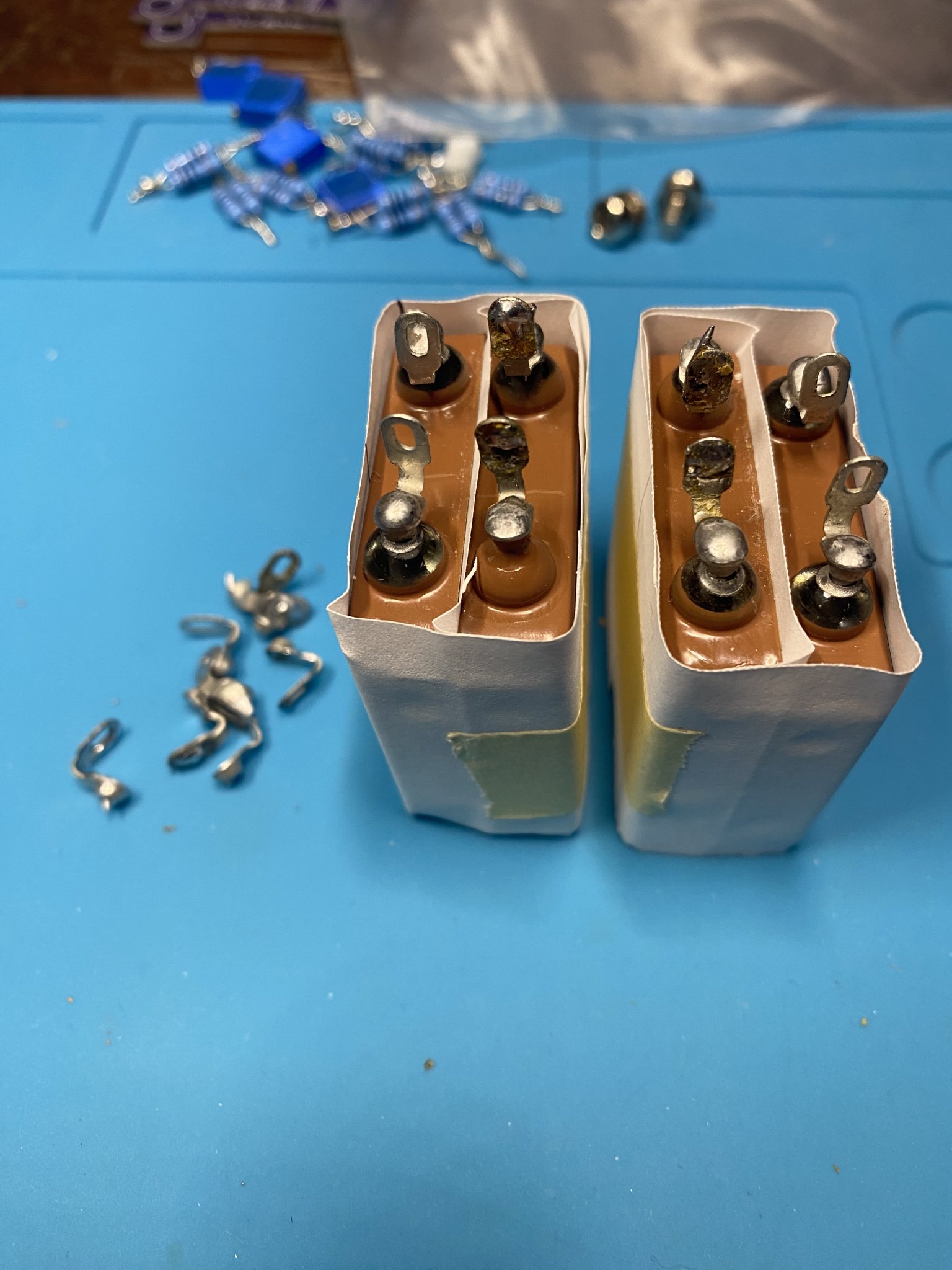

The contacts were not soldering at all so had to disolder them and solder the wires directly to the cap terminals.
Like you say ZM there isn’t much to be noticed but I will leave them in for a while and then remove them to see if I notice something’s missing.
small file or scalpel knife
