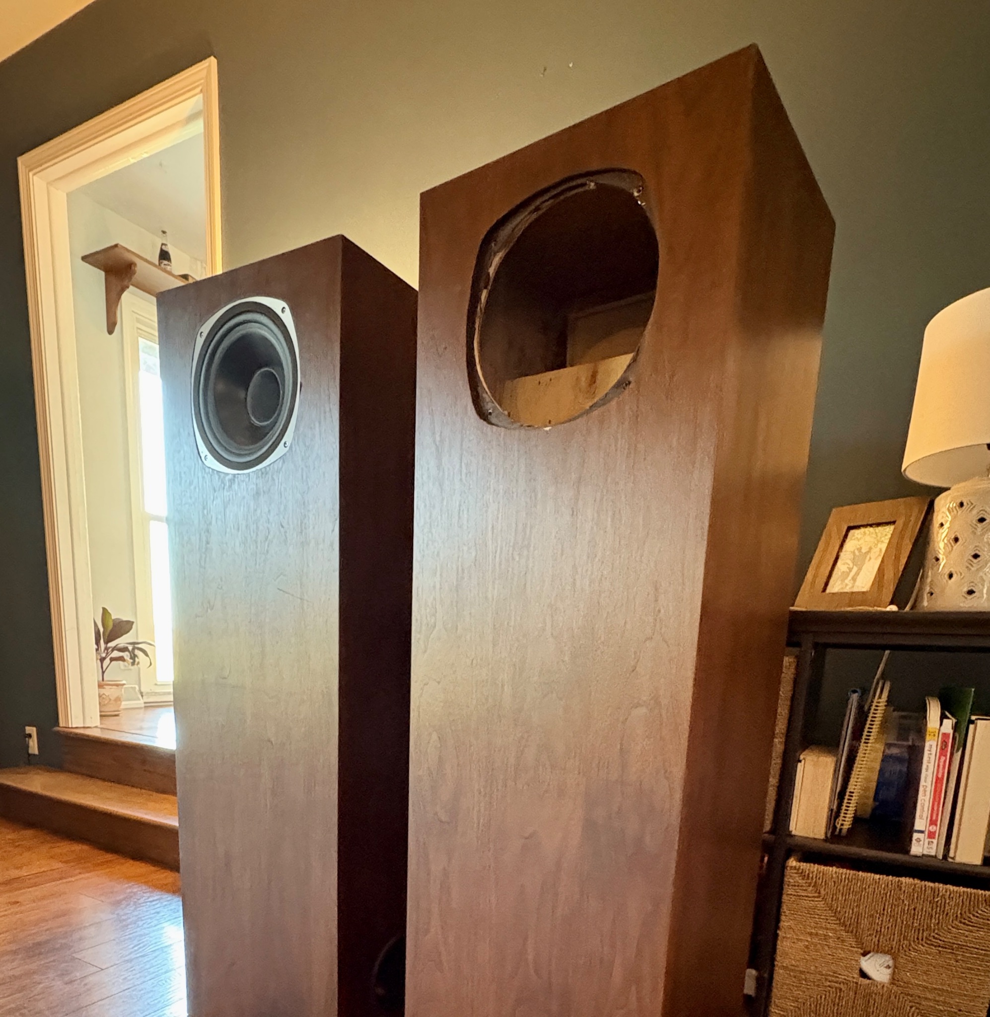

Picked up these monolithic, ZM-designed cabs from diya friend and woodworking extraordinaire @hirscwi today. Just a few tasks left before they sing again

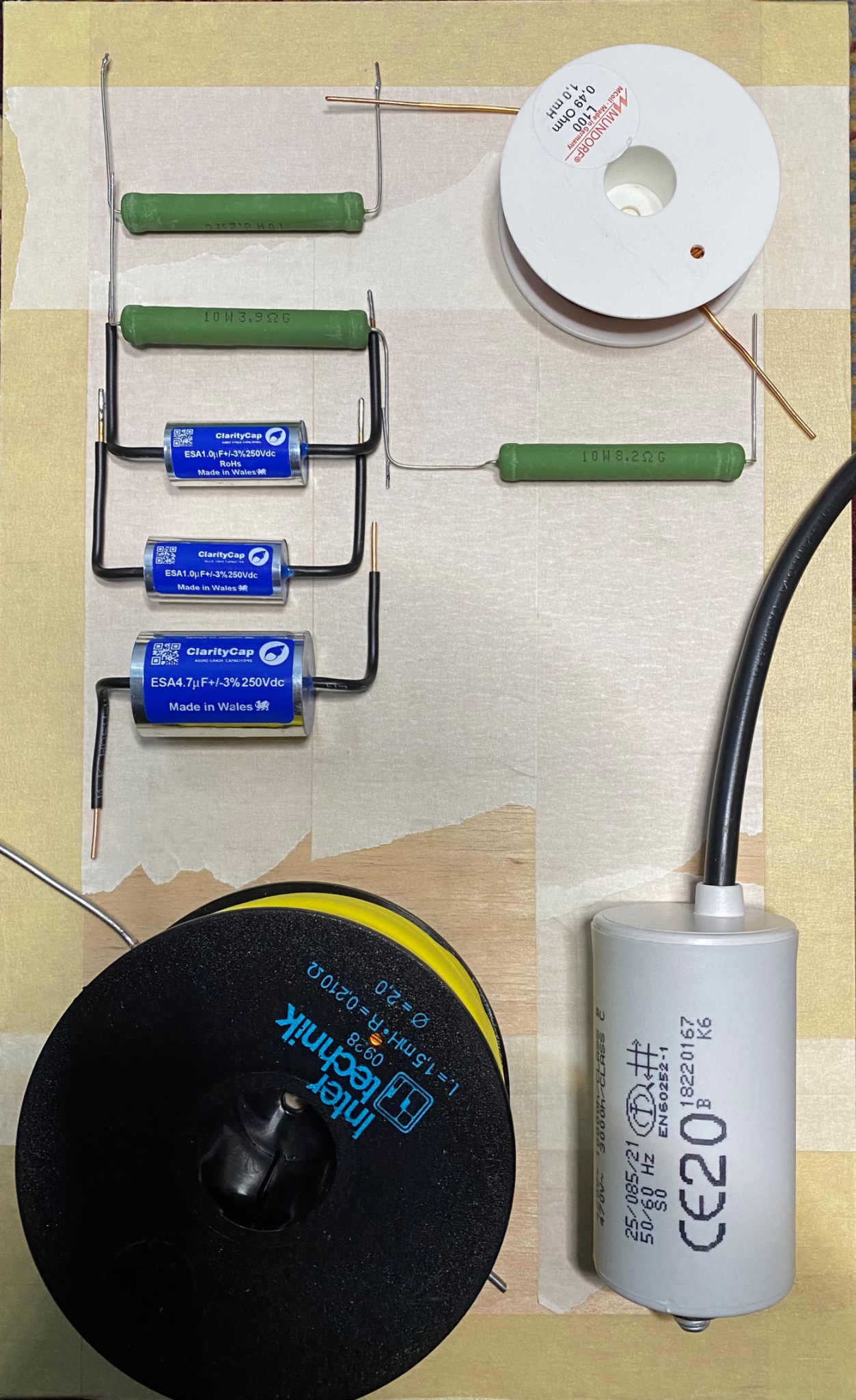

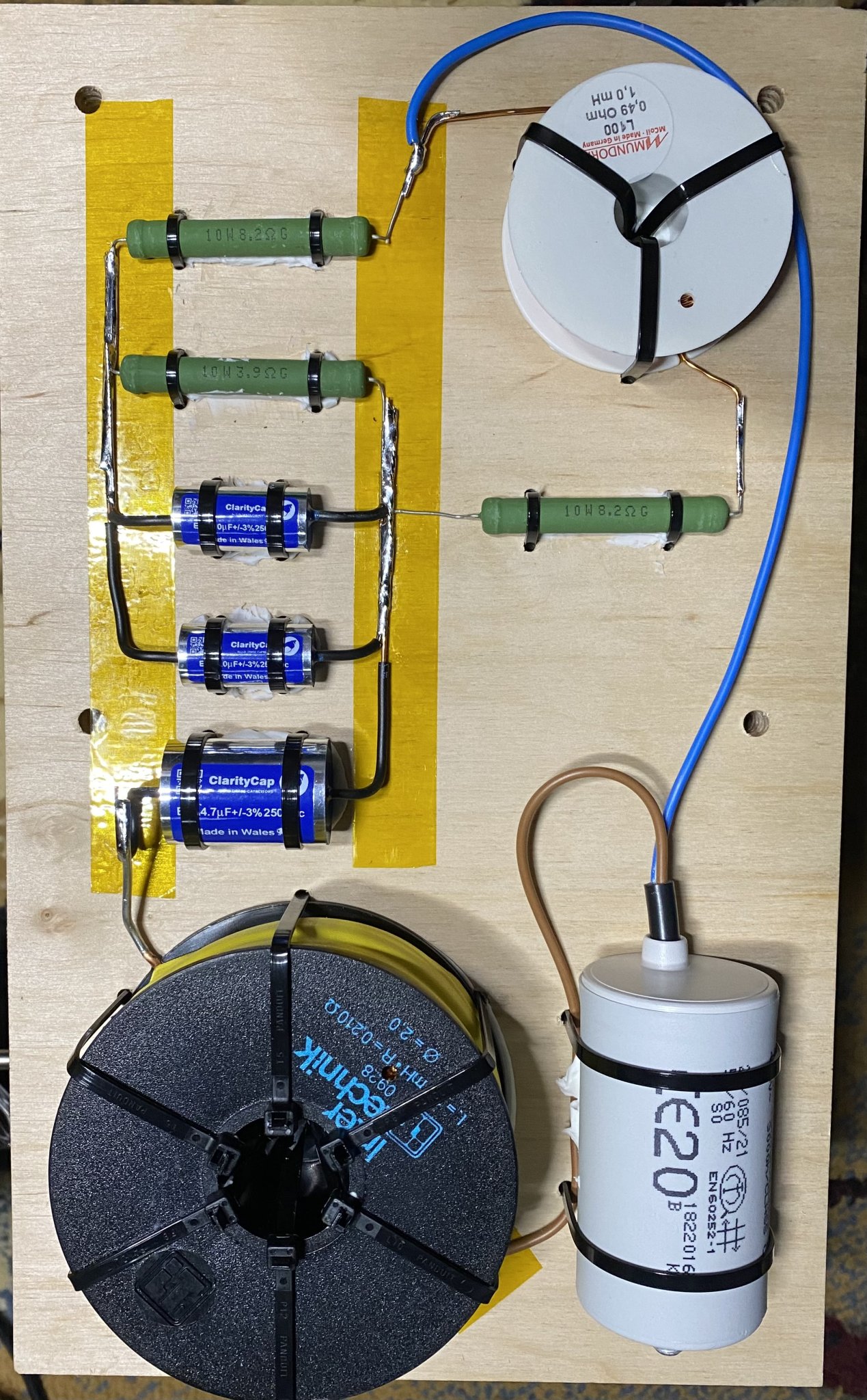

I was thinking at this layout for the crossover. Will fix everything with zip ties.
2 zip ties for each of the small components and 4 for the big inductor.
Should I use glue too on the bottom of each ?
Managed to finish them. A lot of patience was needed.
A bit clear for sure. You can easily notice it on voices. The soundstage is a bit wider too.
The second thing you can easily notice is the better control of the woofer.
I think I pushed around 2w through them and the bass was already punching deep in my chest.
