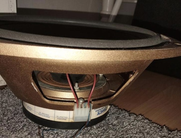

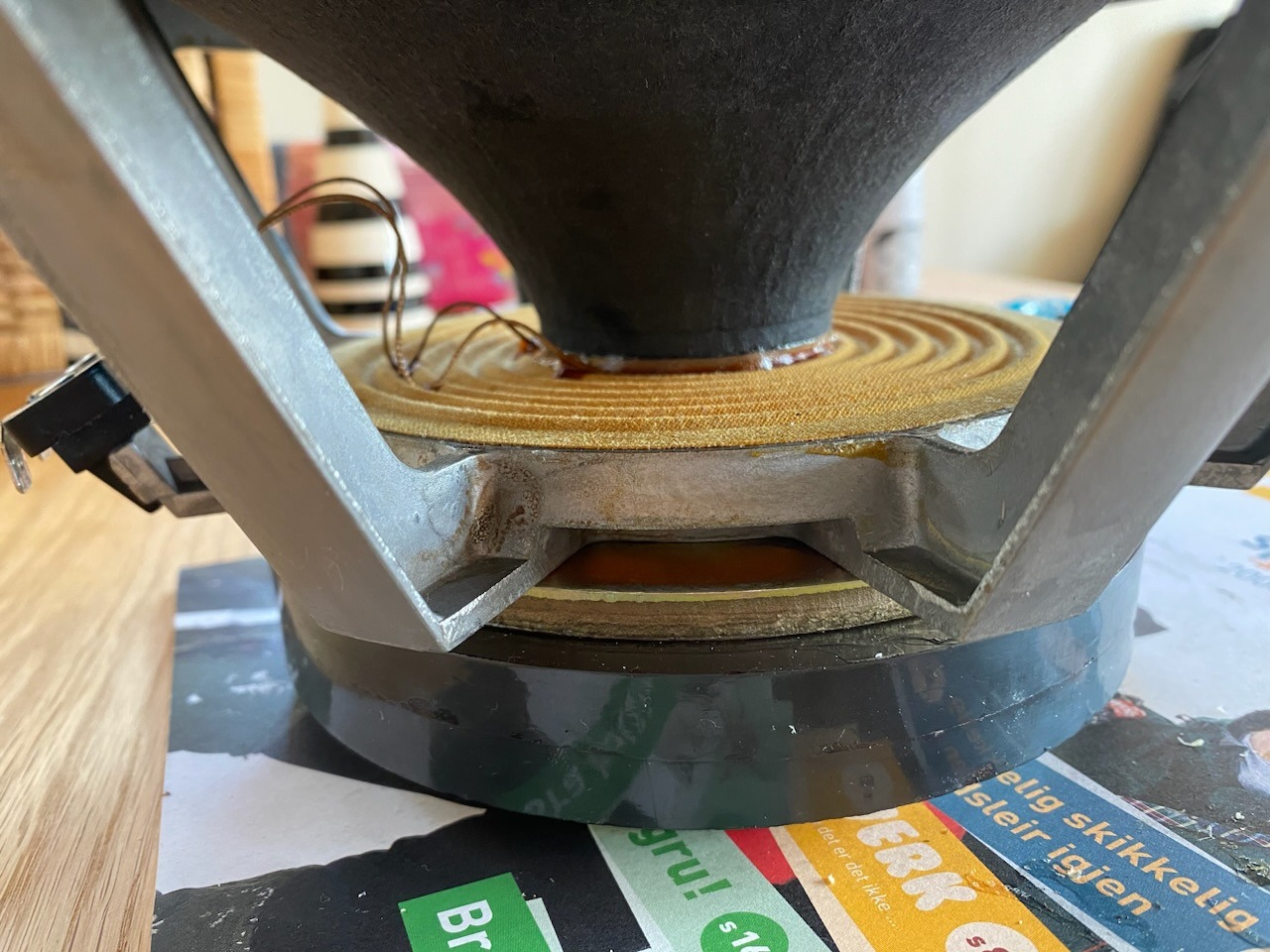

For example, on that picture of the to me unknown driver, the spider looks saggy, meaning the cone is also saggy. Might be just the pics, but if buying such a driver, unless you know it’s full history, spend some time checking parts availability, go have a look a them, and or ask the seller all relevant questions. And haggle if possible 🙂Thanks for the incredible valuable inputs! I’m looking to upgrade my Cabasse Bahia Altura’s and am going back and forth between old Tannoys, new Fynes or a Troels Gravesen design (something like the Faital 3WC-10). The thing with Tannoys is that they go locally for crazy prices and I just have no idea of the real value…. Is a pair or 15” monitor gold worth 4 to 5kEU?! I saw a pair of more recent DC12i (97dB!) for a bit over 1kEU, but can’t find a lot of thoughts about them… or something like the 12” here attached, but without filter for 650EU. A system 8 probably going to be too small… not easy. Important for me is that pinpoint wide & deep soundstage, but not only behind the speakers… and working well with most FW-amps! ;-)

things to check:
- if driver being originally in small PA box or wedge monitor, it's likely type with small Vas and high Fs, so no go if one wants to build proper full range box, it can't be done without bass helper**
- if driver is having pleated (cloth) surround, read on my blog how to cure it to restore proper low Fs
even in cases where ( who knows what was original ) surround is freshly replaced with bazookatractorlike neoprene (as shown on pic above, in #41) be sure that driver is mostly looking horrible, but even those ghastly looking surrounds are relatively close to good one; luckily - there are available proper surrounds for majority of Tann drivers; one instance is sicken4you at German fleabay; he's even having cloth surrounds for 12 and 15" Tanns; not exactly same looking (number of rolls), but proven as fully functionally adequate and of right dimensions
as I wrote to Andy several times - DC Tanns are sturdy tractor-like construction, without too much gimmicks, so working on them is relatively easy and not so critical, even for amateur as I am, when dealing with speakers

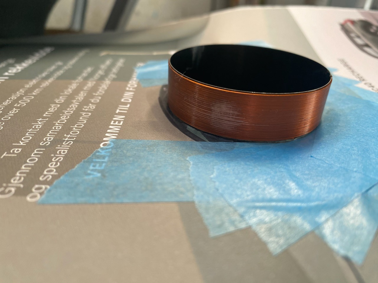

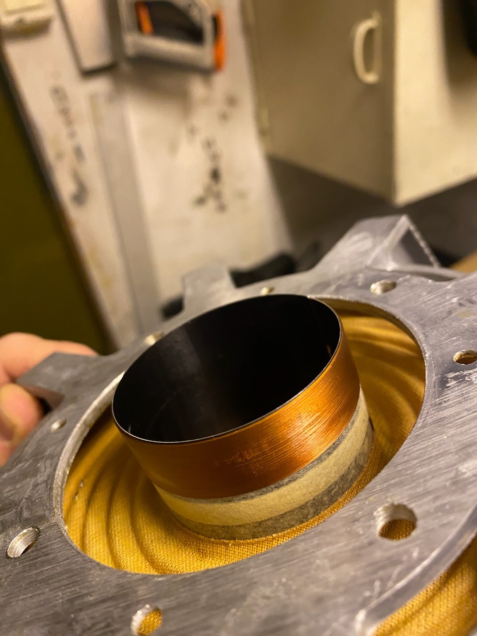

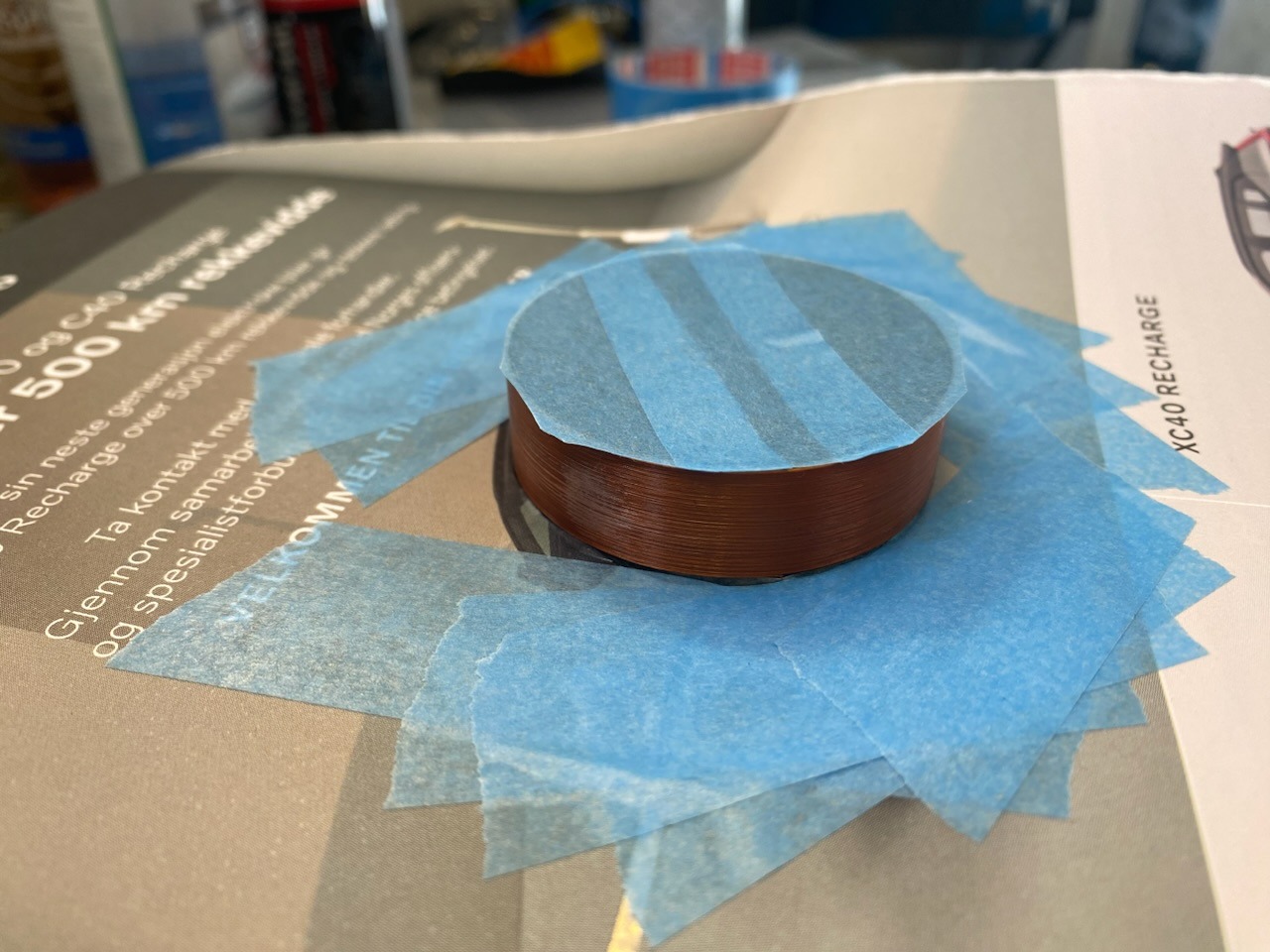

Attaching a few more pics of the VC, which was seemingly damaged but it turned out to only be visual.
Careful sanding of uneven areas, cleaning and decreasing, then a thin layer of clear spray paint.
Forgot to mention time and time again that MZM approved every step of the process in advance, to avoid f…ups.
You will also notice that glue has been removed from contact surfaces. I did this wherever applicable.

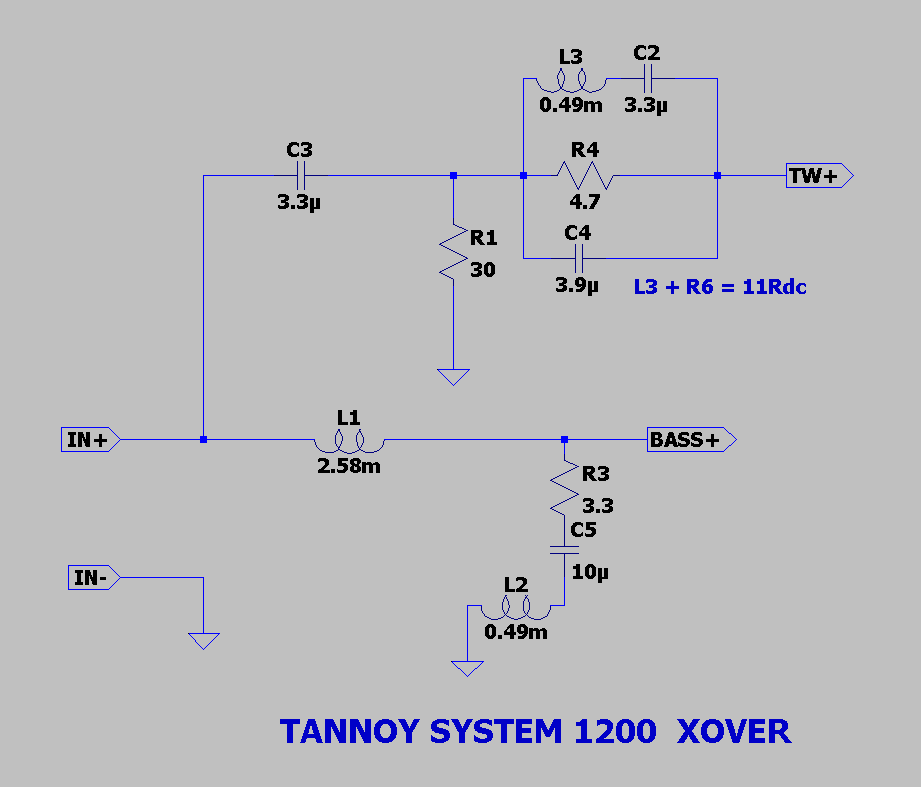

I have a pair od System 1200
box is so-so
xover is a mess, total massacre, nothing is coming out of them
and people (even some professionals) are having them highly regarded ......

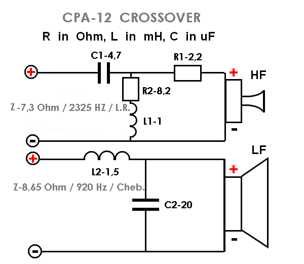

anyhow, make CPA12 xovers for them (fat air-coil for bass, please) and then you can expect proper sound

Coming together to todays status. Work left is to measure Fs, remove old basket top paint and respray.

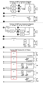

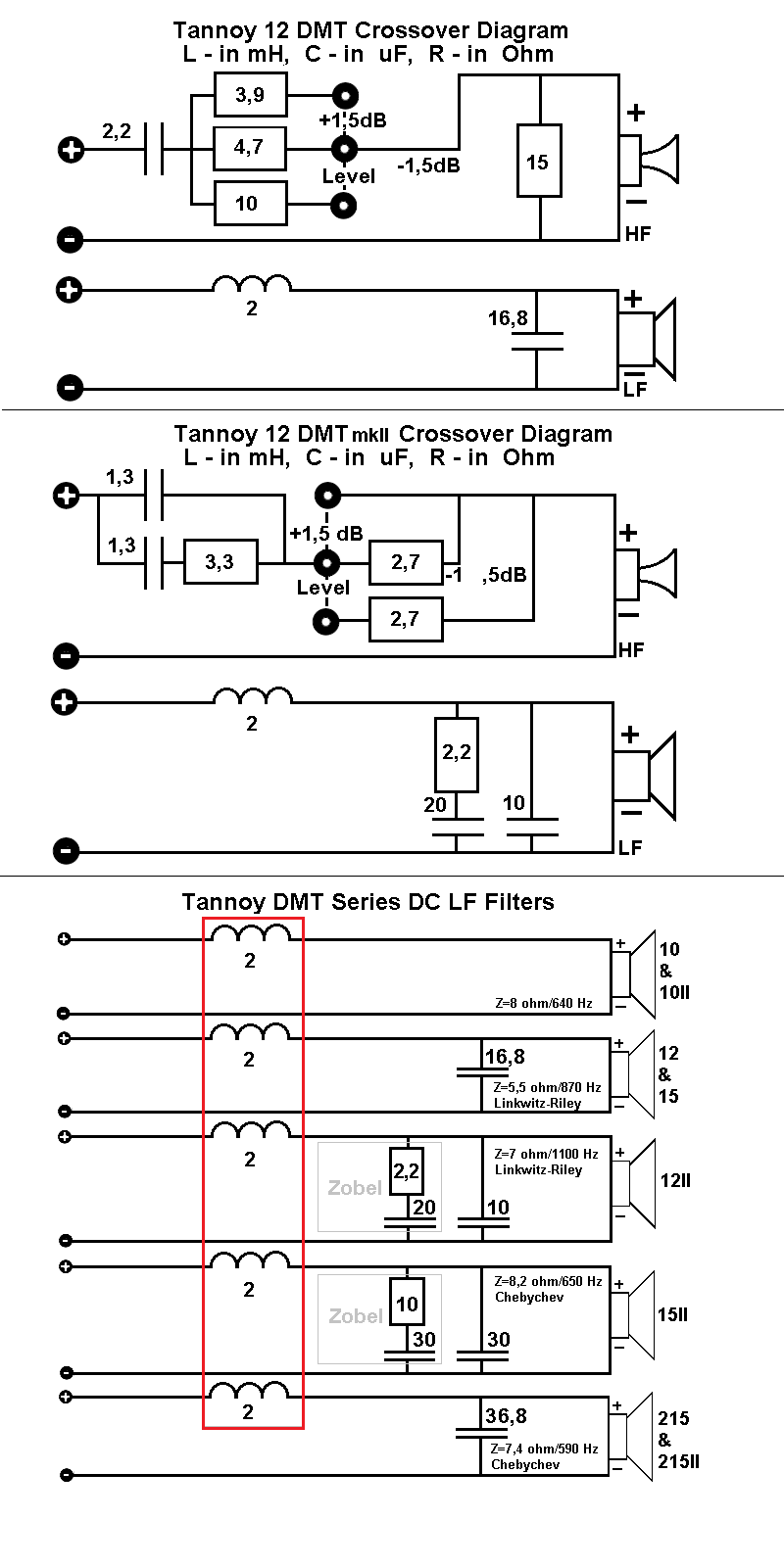

As i'am one liking the 1200 i've heard i'm truly interested in your view about their xover and what you would suggest to cure it ZM?
It seems they had issues with this line of drivers: the offset between acoustic center in the sytem800 driver gives Tannoy's passive filter design philosophy an hard time.
In the active version it is solved through the use of allpath filters in the woofer way. It sound good to me but it's not simplistic passive approach anymore. It can bother, not me.

Experiment with the driver told me (for my preference) it needs 3 way and sealed. Xover in the 250/300hz range. Going sealed helped to clear midrange from leaking mid from bass reflex tube, highish xover help with modulation of acoustic at higher level ( it goes unoticed to me when low level).
The xover i've tried with other coax ( not Tannoy) and it brings good ( imho) even to 12" and 15".
And it's not something new to Tannoy: Buckingham, 215 Dmt, Dreadnought used same approach.
It's really a question of size (3 way are ussually bigger than 2ways) and if you are ok with another filter or not.

And I knew how similar driver is singing through that xover, while with original System 1200 I could hear nothing - no foot tapping, nada
I'm allowing personal tastes, pretty much I don't care what personal tastes of other people are, nor I mess with that
But, for my taste, I'm finding DMT12 xover criminal, System 1200 even worse , while CPA12 xover is giving much more verity and life to same drivers
see enclosed, be amused, use your own head to judge what's best for you

Just curious ZM…would you try the CPA 12 crossover with my K3149 in MLTL as well?
