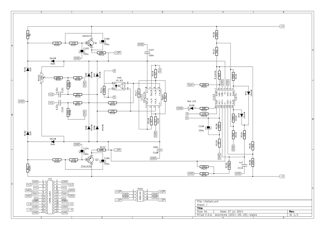

Here is the first schematic of the gain stage with limiter for discussion.
Not build yet, only theory so far, not tested.
The input stage with U102 is a low noise differential input gain stage with an input impedance of 100k and input protection up to 50Vrms.
This part hopefully won't make to much surprises.
Similar I guess with the Sallen Key Low Noise Supply.
More demanding is the limiter.
U101 is a Vactrol (LDR+LED) which attentuates the signal in case of to high input levels.
U103 is a TL074 which forms the control mechanism of the limiter.
This circuitry offers a very high compression rate of more than 40db and at the same does not cause a dynamic compression and does not pump much. Dynamic compression is simply avoided by a long release time.
The threshold of the limiter is a dynamic threshold which follows the rail voltage of the power amp and limits the output to 90% of the rail voltage.
Basically the design should be fine for rails from +/-20V up to +/-100V.
The shown values would fit for VTL5C2, however in reality I intend to adjust it to the more common NSL32. This is likely to require changes in the lead compensation (C109) and proportional loop gain setting (R128 & R129), and potentially also in attack time and release time (R134, R130, C110).
The lead compensation compensates the slow dR/dt of the VTL5C2 and is neccessary to allow high compression rates with fast attack times at the same time without overreaction of the limiter.

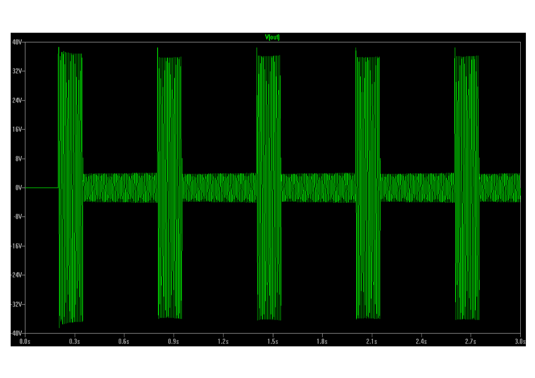

The first simulation screen shows the operation with an input signal which would already force the amp 6db to high (double voltage) without limiter and would result in heavy clipping. The recurring bursts simulate a music program with 100 beats/min.

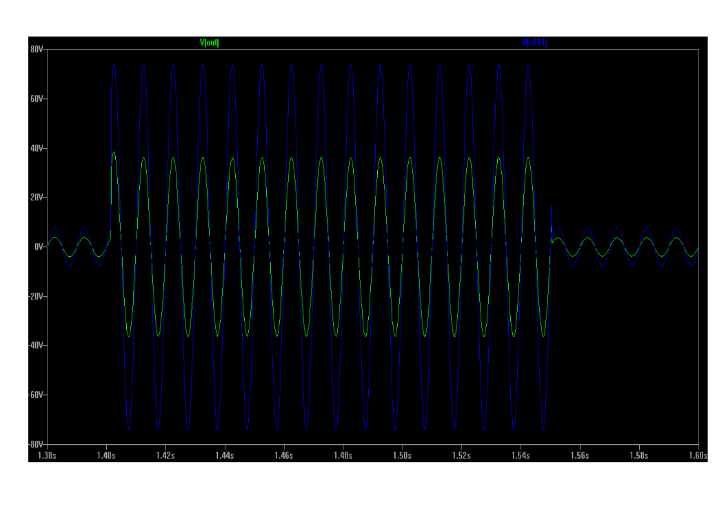

The second simulation screen shows a zoom of the output signal with limiter (green) and for comparison the signal which would correspond to the input signal without limiter.
With 6db to much input signal the limiter easily keeps the amp output unclipped.

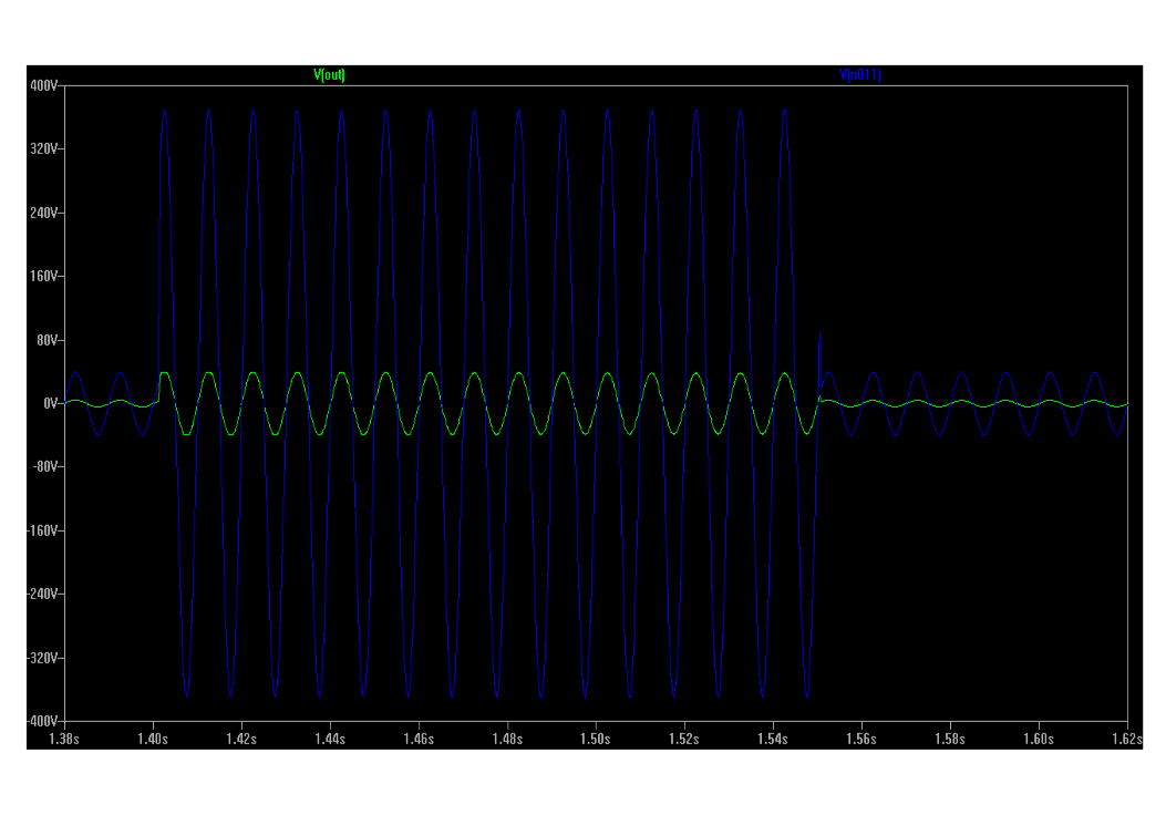

The third simulation screen shows a zoom of the first burst after a long period of silence. Imaginge music was off and you tip on PLAY at the CD player while the volume is turned up too high...
Even under this condition only the very first half wave gets slightly clipped, then the limiter already reduces to unclipped.

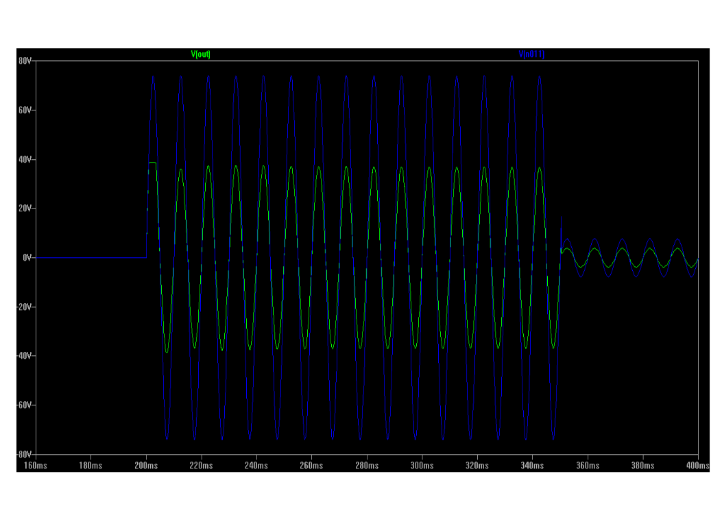

The fourth simulation screen shows a zoom of recurring beats with 10 times of the possible level. Means the input signal would demand the amp to deliver 370Vp...., without limter the output signal would become a fully clipping rectangle.
Also here the limiter keeps the signal low enough to show just minor clipping during the first waves of each burst and then runs unclipped.

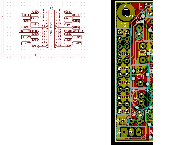

Some questions:
- Is the pinout of the daughter board now fixed so we can start designing own frontends?
- The gain of the master board is rated at?
BR, Toni
Hi Toni,
yes, the pinning of the connector from main to daughter board is fixed.
Please refer to the attached picture of this post.
The picture shows the pinning (top view) of the mother board.
The pinning of the daughter board must be the same, considering
it to be turned vertical and having the components on the outside.
The connector is 12x2.
Grid: 2.54mm.
Center of pin 1 is in 11mm distance from the upper board edge.
Center of pin 23 is in 10.9mm distance from the lower board edge.
Voltage gain of the main board is 4.8 (+/-40V type).
Inverting.
Cheers
Markus
Grid: 2.54mm.
Inverting.
Cheers
Markus

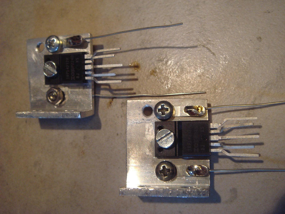

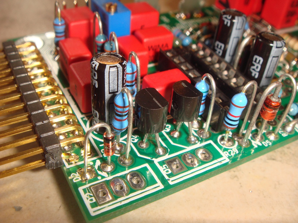

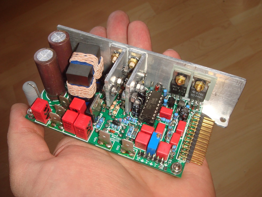

Mainboard PCB assembled
Assembled and everything is fine.
Mechanical construction is proper on paper, also proper in reality.
But paper tends to hide how tight the heat sink construction
will appear during assembly. Assembly needs some patience and mechanical
skill.
OCP (which was not present in my earlier bread board) is set to 30A peak.
This ensures plenty of headroom for operation at 2R from +/-40V rails.

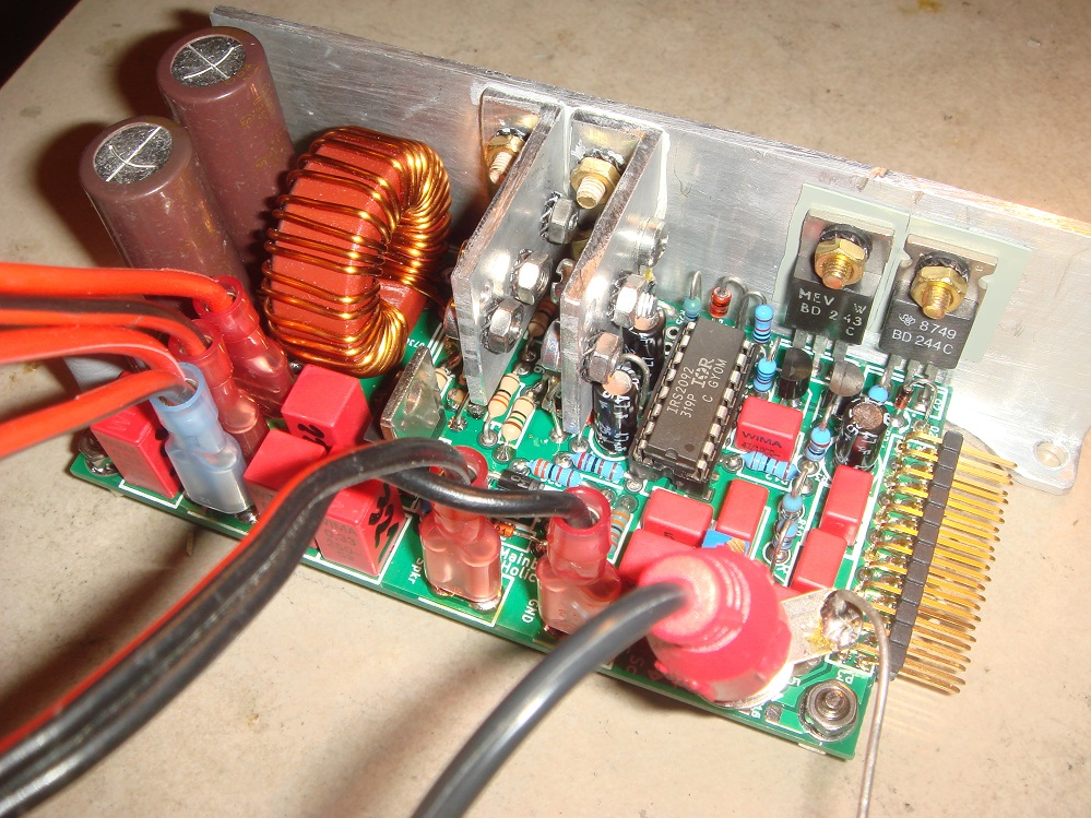

With respect to an earlier request I also changed the output inductor from 12uH to 15uH.
==> Ok, found a good adjustment for this as well.
Furtheron 15uH causes less continuous stress to the e-caps, so I decided to pick the 15uH as preferred value for the +/-40V version.
Experiments with various different choke types show that a T106-2 with 33turns is a good choice, but also other solutions will work.

I thought vertically mounted toroids was a no-no for class D wrt to EMI?

System schematic for the main board of the LiteAmp:
Well, on system level there is the schematic in the first post.
If you are curious for a schematic showing all components in detail - I am still reluctant. But of course everybody who wants to build the amp can get
the PCB + set of key components + BOM + building hints for a non profit price. - Will settle the proposal when also the gain board is ready.
Well, and then there is no way to avoid reverse engineering.
But I do not want to make it too simple for the commercial copy cats from the very beginning.
Potential later publication of details will depend on my feeling if the amp is popular enough in DIY circles.
skill.
