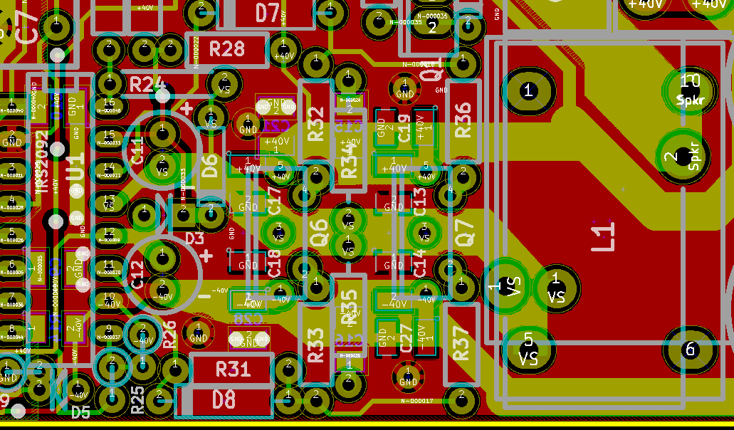

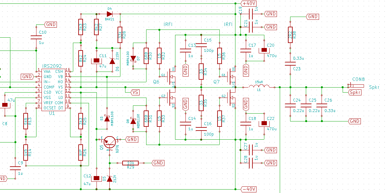

Some insights regarding the switching stage.
Please refer to the attached schematic and PCB.
The MosFets are two IRFI4212H.
Their specific beauty is the package, which allows low parasitic inductances, combined with an easy to handle fully isolated TO220-5.
It allows to keep small the critical half bridge loops:
Q6, C17, C18 and in the same way Q7, C13, C14
This keeps the intrinsic ringing frequency and damping high.
==> You get perfect signal integrity free of ringing already with very light snubbering.
Low Qrr of the IRFI types also keeps the situation nice during heavy load with hard switching conditions.
Downside of course is the very restricted portfolio of MosFets in this package.
Gate drive:
The shown values are the softest, but still reliable gate drive which at the same time allows to skip D7 & D8 for high end spectrum shaping.
Particularly in the mid power range (i.e. 10W into 4R) with D7 & D8 you will get some more high order harmonics, vs the posted spectrums.
However D7 and D8 are strongly advisable for heavy duty party operation into 2R, because D7 and D8 substantially reduce the switching losses at heavy loads.
During idle operation the losses are identical for both variations, no shoot through, no forced transitions, but nice ZVS.
Overall the idle losses of the main board are 3W, whereof 2W happen in the auxiliary supplies and small signal area.
Approx. 1W idle losses sum up in the MosFets and inductor.

Very nice design. Do you have any idea what causes the extra harmonics with the extra diodes? Is it the extra asymmetry of switching timing (faster off with diodes)? If so, can it be tweaked with a different dead time setting?
Another question, not for implementing in this design, but have you ever tried a separate npn-pnp push-pull for gate driving? Especially if you parallel FET's this is very beneficial in my experience (in power electronics, remember, not class D designs).
Cheers, Marc
... any idea what causes the extra harmonics with the extra diodes?
It is a combination of dead time distortion and dv/dt shaping.
IMHO the dominant portion is the dead time.
Dead time has to defined more detailed.
There is the dead time of the driver IC and there is the time during which upper and lower MosFet are both non conductive, which I call effective dead time.
In order to avoid heavy brute force during removing of Qrr and avoiding exzessive dv/dt afterwards it is helpful to chose moderate high drive impedances for turning ON. In order to achieve low losses during turn OFF and (ensuring that the reverse transfer capacitance cannot cause unintended turn ON effects) it is often helpful or even necessary to turn OFF with lower impedances. In many cases this leads to effective dead times, which are longer than the dead time of the driver IC. Unpleasantly the effective dead time is also depending on the load.
A multiparameter optimization which becomes even more difficult with the restrictions in dead time setting the IRS....
Besides dead time setting of the IRS also the level of gate driver supply can be used to tune a little bit.
I would not dare to state that the shown solution is the ultimate, but it is one of the good performing options, so in the moment I tend to stay with it.

Thanks for the effort of elaborating. Very interesting. Every single detail you mention is relevant in power electronics too. I remember a design where I added an extra boost switcher in order to be able to meet minimum VCC for a gate driver IC and at the same time keep the rail for gate driving at a lower voltage. And then it all changes again when you start using SIC FET's. An interesting hobby/profession, isn't it 🙂
One thing that you might easily try: I'm used to very different gate on and off ratio's.
You could try 2E2 off and 2E2+22E on. That's usually a good starting point in my experience. I'm also used to snubbering with a much lower resistive part (sub 10E).

2E2 off and 2E2+22E on:
Fine in terms of power electronics, but for low distortion this would need a driver IC which enables negative dead time at its output in order to achieve a very small effective dead time at the MosFets.
And if the driver would provide this - I would clearly prefer your proposal over the slowish turn OFF, which I am using here.
If you do it with the restricted options of the IRS your proposal will work reliably, but dead time distortion in the mid power range would be of average level. Please also note that 2E2 OFF will shift much more heat into the IRS driver.
But true the DIL package can take pretty some losses and most likely I will need this capability for the +/-70V...+/-80V version.
This snubber is not intended to limit dv/dt sloping with a large cap + small series resistor as you often find it in half bridge SMPS with inductive loading for ZVS.
Here the snubber is only intended to dampen parasitic HF ringing during hard switching, which is massively triggered by the snappy di/dt of the body diodes right after Qrr is removed.
At the ringing frequency this snubber should behave mostly resistive.
The parasitic ringing frequency is defined by the inductances of the MosFet + PCB + caps + PCB tracks ( this loop should be small to avoid high parasitic energy) in combination the Coss of the MosFet.
In case of the LiteAmp the parasitic main mode is at 150MHz 😀.
100pF at 150MHz show a Xc of 10 Ohms ==> in order to achieve an overal resistive snubber behavior the series resistor must be at double of that, most common rule of thumb is even triple ==> roughly 30 Ohms.
In fact not only the Xc of the cap are relevant but also the series inductive impedance of the snubber. As long as the XL is not larger than Xc it is helpful.
A resonant adjustment of the snubber (go for XL=Xc) allows a very efficient snubbering with very small capacitors and very small snubber losses.
Well... in the lite amp this is close to XL=Xc and is intended to allow lower resistors for damping more heavy MosFets without the need of much larger snubber caps. ==> Keeping the IRFI4020 in mind for the +/-70V...+/-80V version.
...the +/-40V would most likely also be fine with 47pF, but I did not check in detail, because already with 100pF the snubber losses are completely trouble free for +/-40V and 400kHz. There was simply no need to tune the low voltage version for small snubber losses.

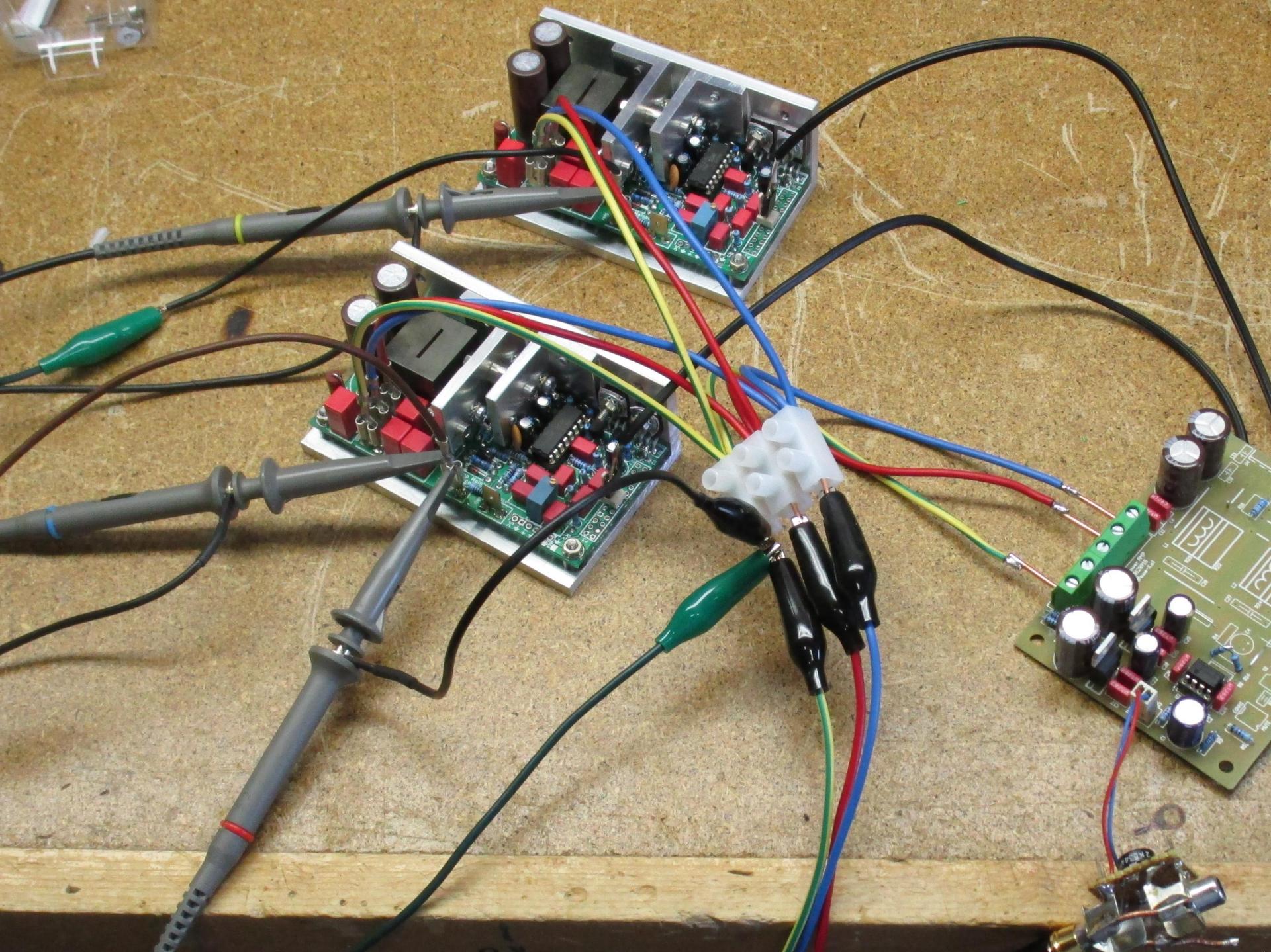

Marcus was so nice to send me some preliminary LiteAmp part kits so I was able to do some "Beta" testing.
Running the LiteAmp bridged at +/- 31V supply was a big success. Without any optimizations on components and cabling the THD+N out of the box is really impressive:
0.0051% 1kHz@1W@8R
0.0026% 1kHz@10W@8R
0.0056% 1kHz@50W@8R
0.024% 1kHz@100W@8R
0.025% 1kHz@150W@8R
SNR better as 110 db (A-weighted with 20kHz prefilter, referenced to 150W output)
:up: goes to Chocoholic for this nice and powerful amplifier.
BR, Toni
