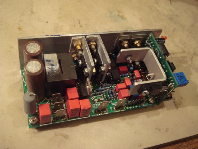

Marcus was so nice to send me some preliminary LiteAmp part kits so I was able to do some "Beta" testing.
Running the LiteAmp bridged at +/- 31V supply was a big success. Without any optimizations on components and cabling the THD+N out of the box is really impressive:

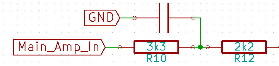

@ ChocoHolic, may We know the impedance for 8Vp ?
Attached the input section. The cap towards GND is 1nF.
In simplified view the node on the right hand side of R12 can be
counted as a virtual GND.
Despite the low input impedance, it is possible to drive it from higher impedances. The LiteAmp remains stable and well behaving.
But of course - when driving from higher impedances - you need to consider the voltage divider formed by your high output impedance and the input impedance of the LiteAmp.
That's highly welcome.More measurements and pictures will follow...
Your mechanical work is so much better than mine!

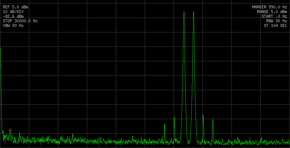

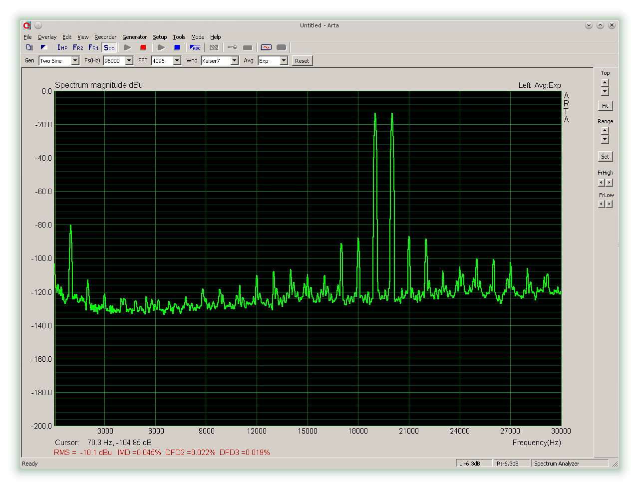

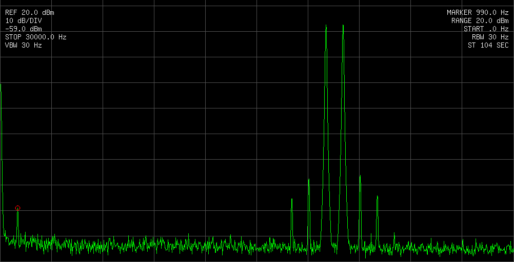

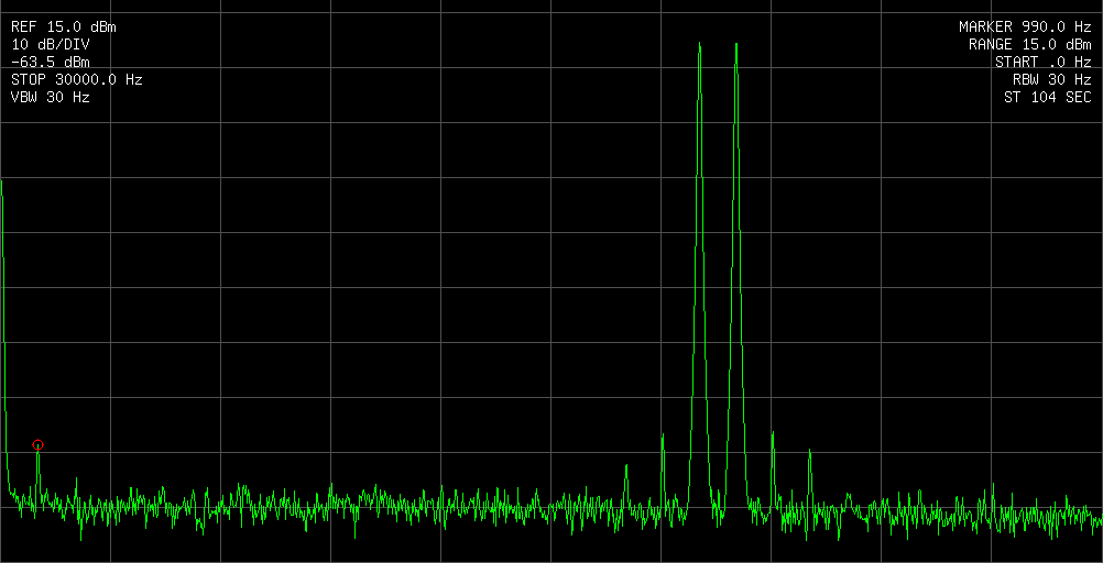

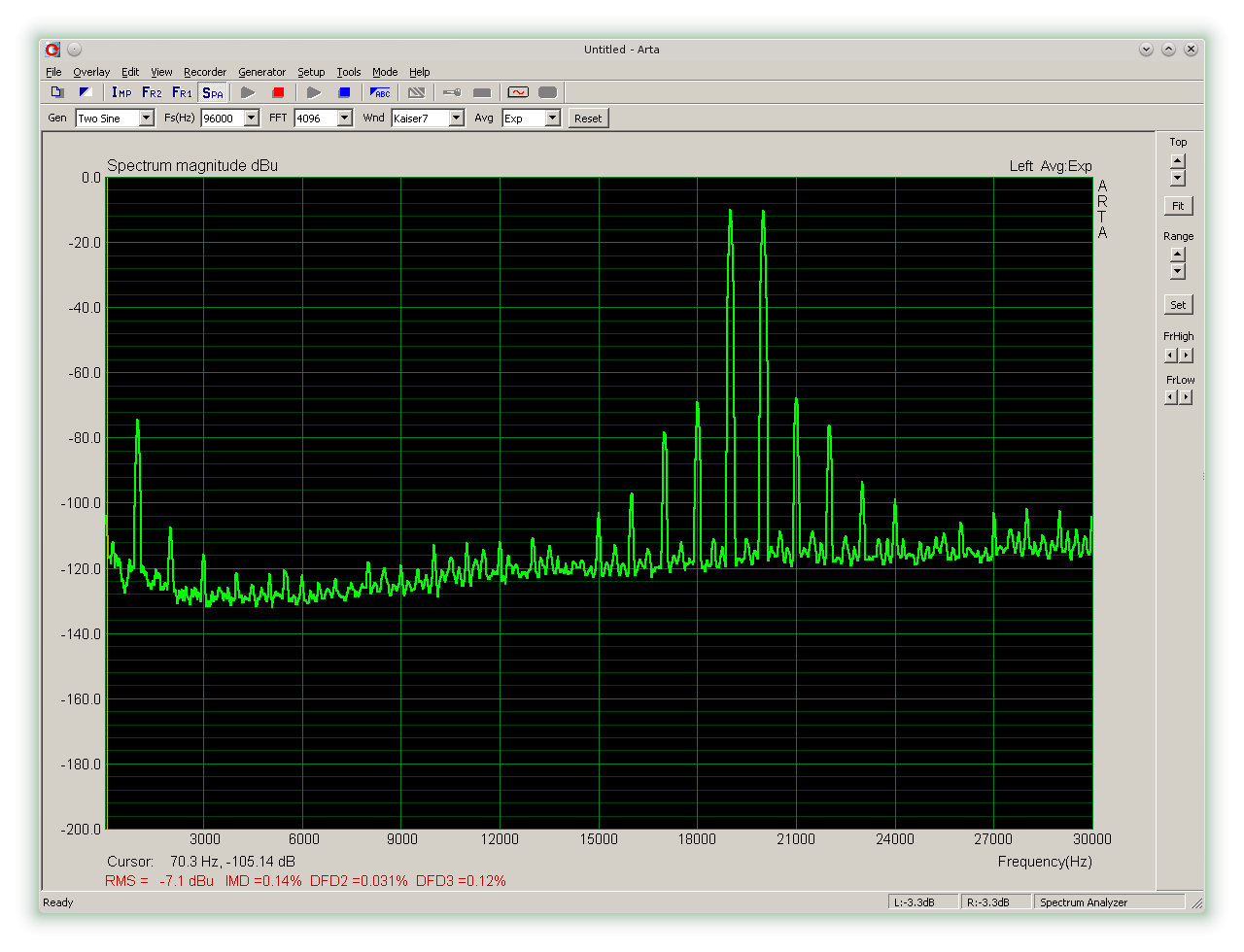

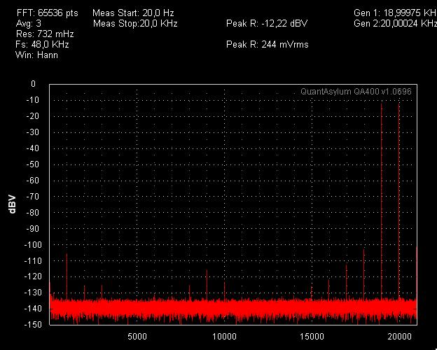

Some more measurements ...
Have had some time to do some more measurements of a single SystemD LiteAmp. Attached some IMD measurements made with 2 different measurement chains.
All measurements done with +/- 31V regulated PS.
Measurement chain A:
IMHO a very nice implementation of IRS2092 with very low distortion figures especially in the critical 0.1 - 10W range.
BR, Toni
- Hameg HMF2525 Arbitrary Function Generator with homebrew 19/20kHz IMD wave.
- HP Spectrum Analyser 3585A
- Software "ARTA" as IMD 19/20k Generator and Analyzer
- Soundcard Asus Xonar STX (headphone output set to 300-600R)
1kHz@1W@8R 0.0040%
6kHz@1W@8R 0.015%
1kHz@16W@8R 0.0048%
6kHz@16W@8R 0.045%
1kHz@32W@8R 0.019%
6kHz@32W@8R 0.24%
SNR in reference to 1kHz@50W@8R 107dB (bw. 20k)6kHz@1W@8R 0.015%
1kHz@16W@8R 0.0048%
6kHz@16W@8R 0.045%
1kHz@32W@8R 0.019%
6kHz@32W@8R 0.24%
BR, Toni

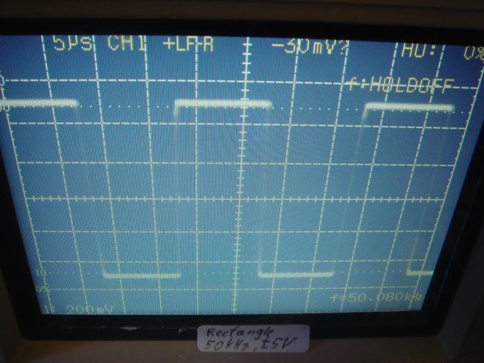

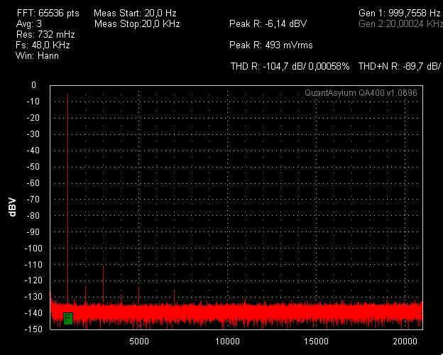

Gain Board Builders Package
Here is the full builders package of the gain board with limiter.
The differential amp behaves as blameless like one can expect from modern OP amps.
Touching my measurement limits for THD & IMD. Step response has a sloping time of 300ns and is free of overshoot.
Most liekly this board will not the bottleneck, but of course you can also experiment with
OP amps different from the OPA2134.
