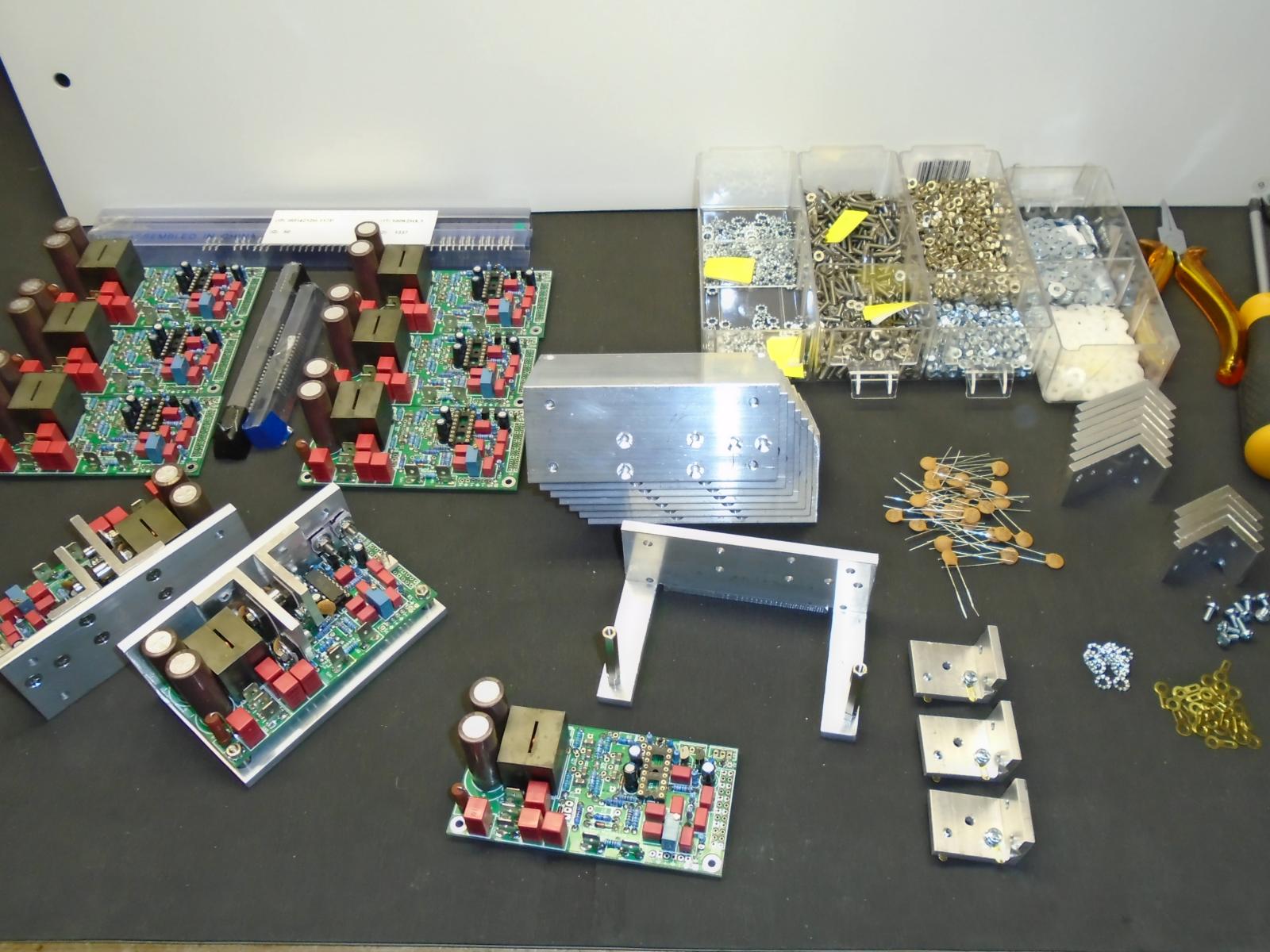

Liteamp Bridged ...
... 8 + 1 amplifier modules assembled and ready for detailed measurements.
First tests showed: all amplifiers are working out of the box.
(Amplifier #0 - see southwest on picture - is a spare part and my reference part which has been measured also by Markus.)
BR, Toni
BR, Toni
@astx:
Your buidling quality and mechanics are always stunning!
@irribeo:
In my building describtion I have four short wires aside the MosFets.
These short wires are connecting the heat sink with low inductance to
the GND plane of the PCB, for EMI reasons.
Downside of this is the fact that the heat sink is connected to GND,
which makes it more difficult to avoid humming GND loops when building a multi chanel amp.
Instead of wires it is possible to use small ceramic capacitors, which tie
the heat sink for HF to the GND plane, but allow LF floating.
