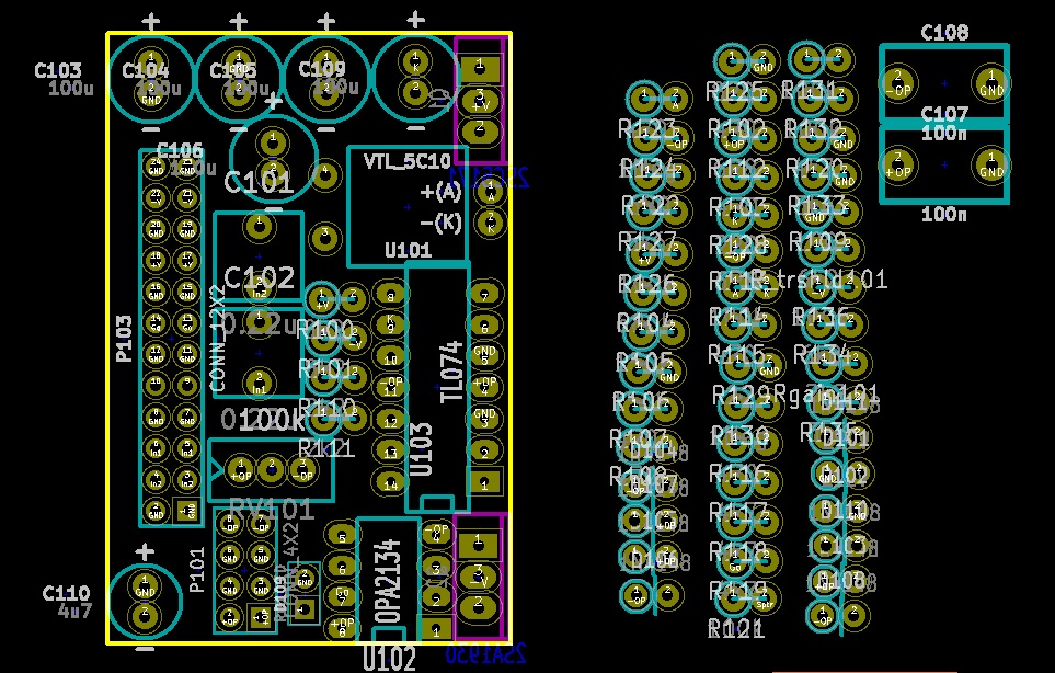

The gain board with limiter and low noise supplies sums up to an unpleasant size.
Already the components which I really want to have as pin-through-hole devices consume the entire board.
Have a look to the attached picture.
The resistors, diodes and caps on the right hand side, but displayed outside the
board won't fit in pin-through-hole-style, but could be solved as SMD.
As 0805 SMD types I guess that they will fit on the back side.
Who would be in trouble with 0805 SMD components on the gain board?
Astx: As I understood, you would dislike the SMD, but you intend to go for your own discrete input stage.
So the gain board would not give you headache - right?

Ok, I see 0805 seems to be acceptable for most.
Personally in my DIY assortment, I enjoy to use 0805, but do not stock 0603 or smaller...

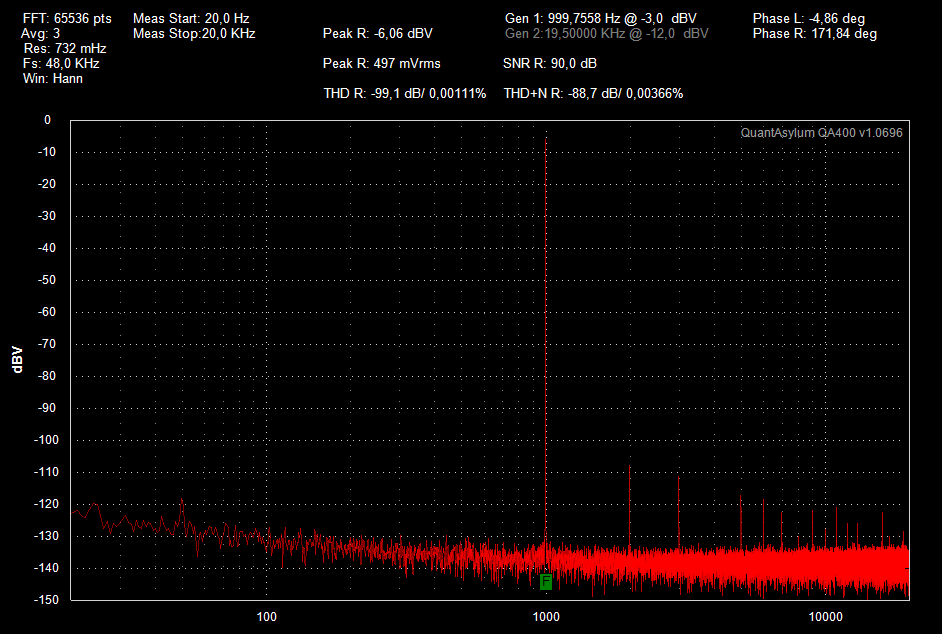

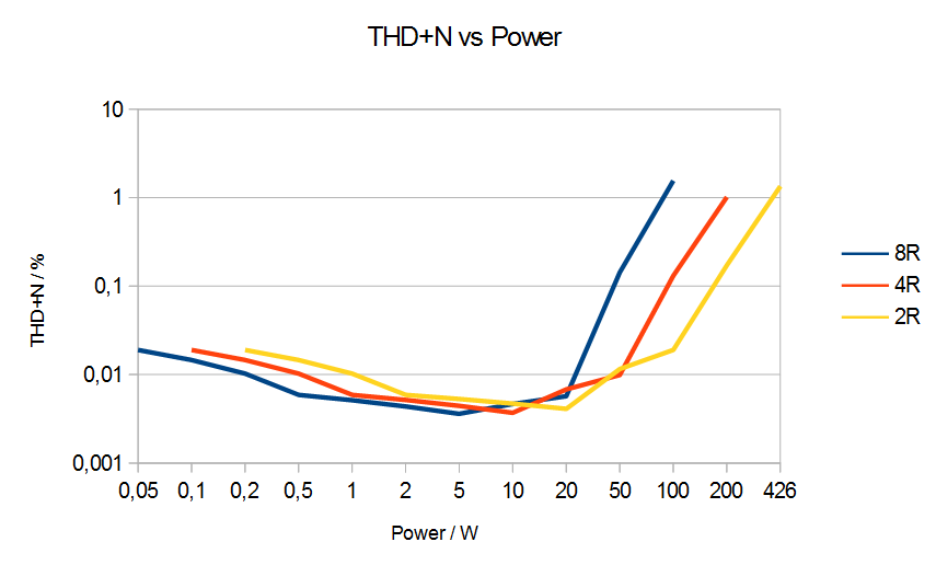

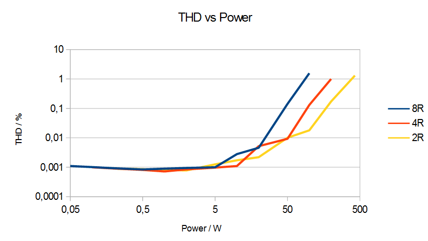

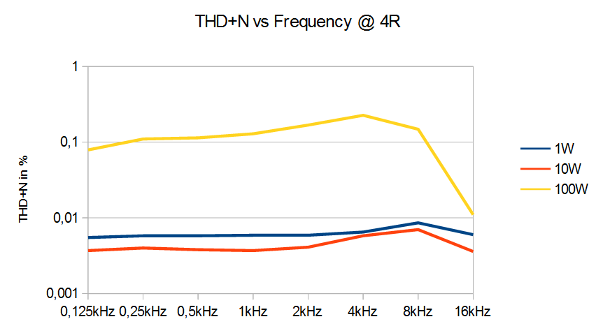

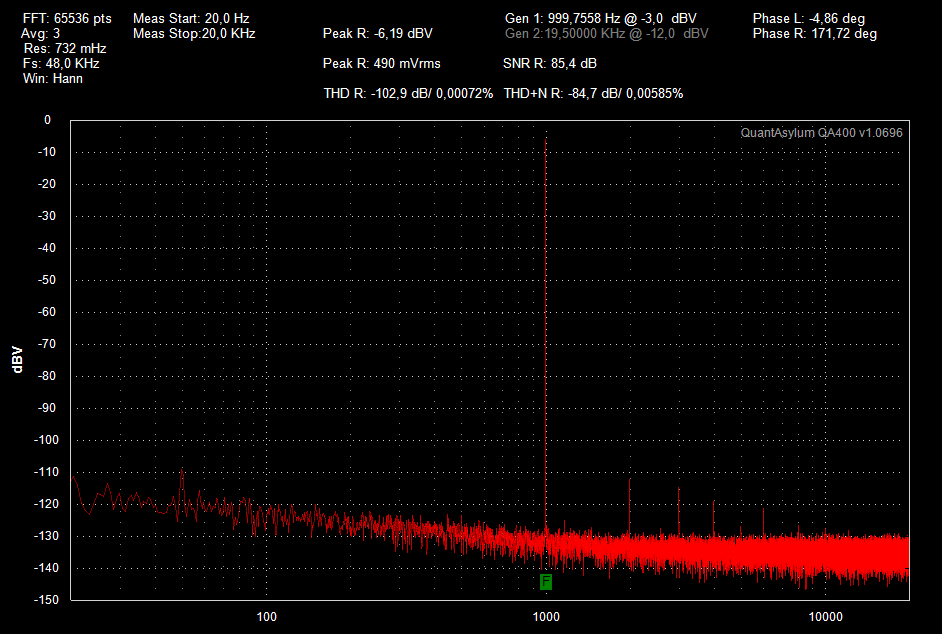

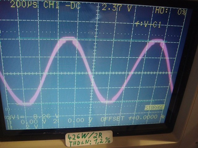

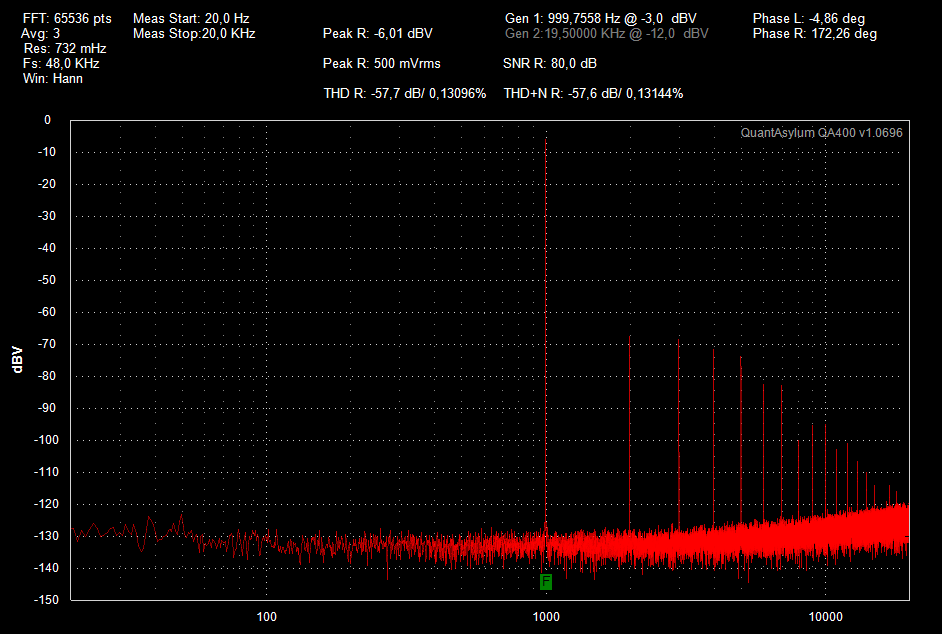

Performance of Main Board
...measurements done with +/-43V rails:
Idle noise is 75uVrms. Relative to 100W @ 4R this means -111db.
Attached pictures:
+ THD vs Power
+ Spectrum 1W @ 4R
+ Spectrum 10W @ 4R
+ Spectrum 100W @ 4R
+ THD+N vs Power
+ THD+N vs Frequency
+ 426W @ 2R

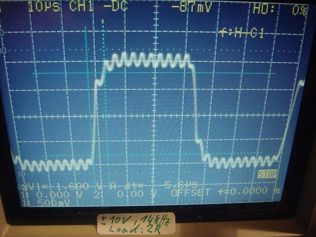

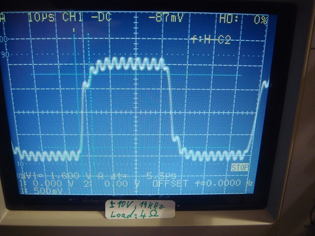

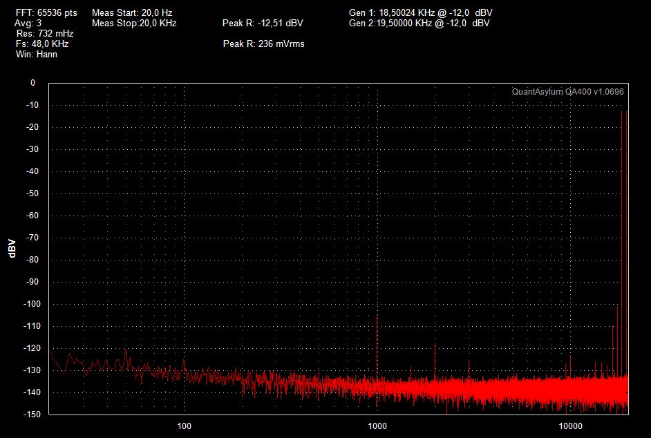

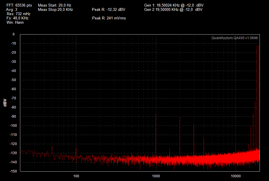

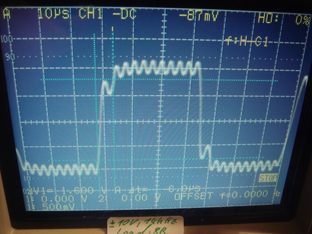

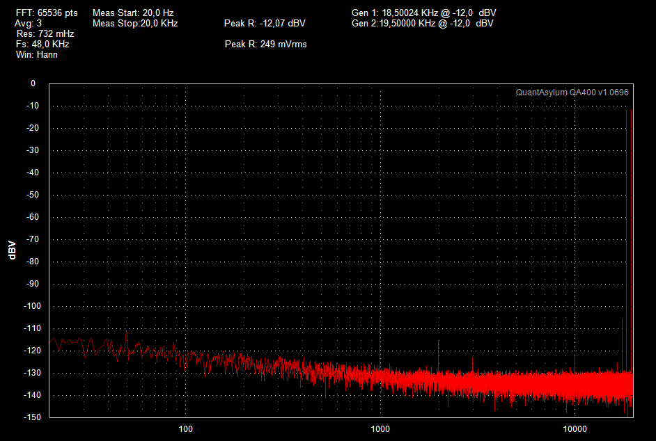

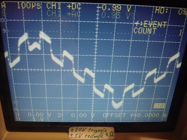

Performance of Main Board ...continued...
+ IMD 1W @ 4R
+ IMD 10W @ 4R
+ IMD 100W @ 4R
+ Rectangle, +/-10V, 14kHz, 8R
+ Rectangle, +/-10V, 14kHz, 4R
+ Rectangle, +/-10V, 14kHz, 2R
+ Complex signal handling, +/-20V triangle(1kHz) & +/-5V rectangle (8kHz), 4R
