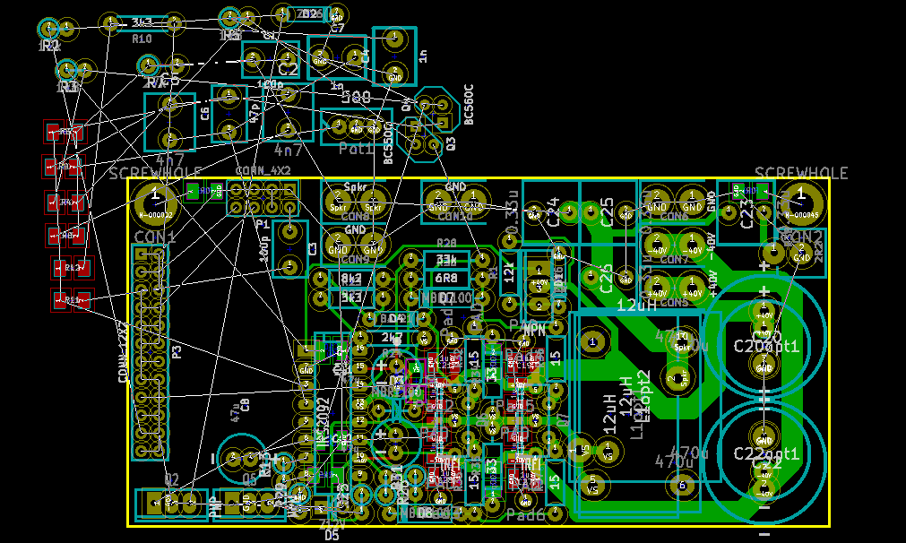

...still some work to do, and it is going to be pretty crowded.
Changed the orientation of the IRFIs again to the same like on my breadboard.
The trial to have them at the edge of the PCB for easy heatsinking was pure pain for the parallel connection of both IRFIs.
The position in the middle will need two angular pieces as thermal link, but in class D the electrical requirements of the PCB clearly has higher prio than easy heat sinking.

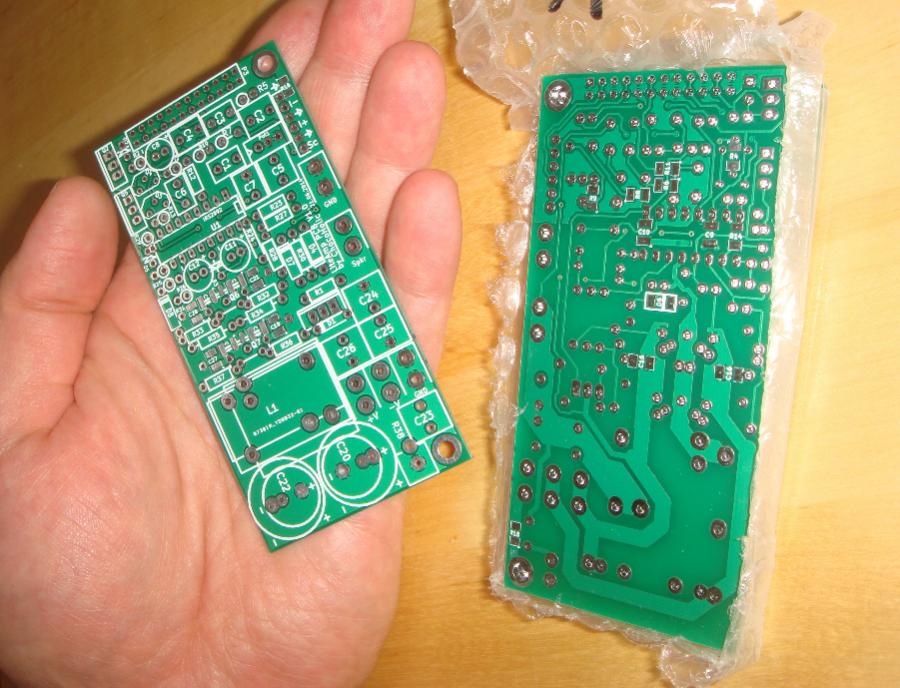

The layout of the main boards is done and it fits to 100mmx50mm including all options and just few SMD 1206.
Itead delivered a bunch of 20 PCBs within one week. Few days processing at Itead + few days shipping. That's fast!
Seems like they made nice boards - hoping that there are no catastrophic errors from my side...
There will be pretty some time gap until the board is populated and tested, because I still have to order components and work is going to be very busy next month.
However I went on with my considerations on the optional gain board and
will post details soon.

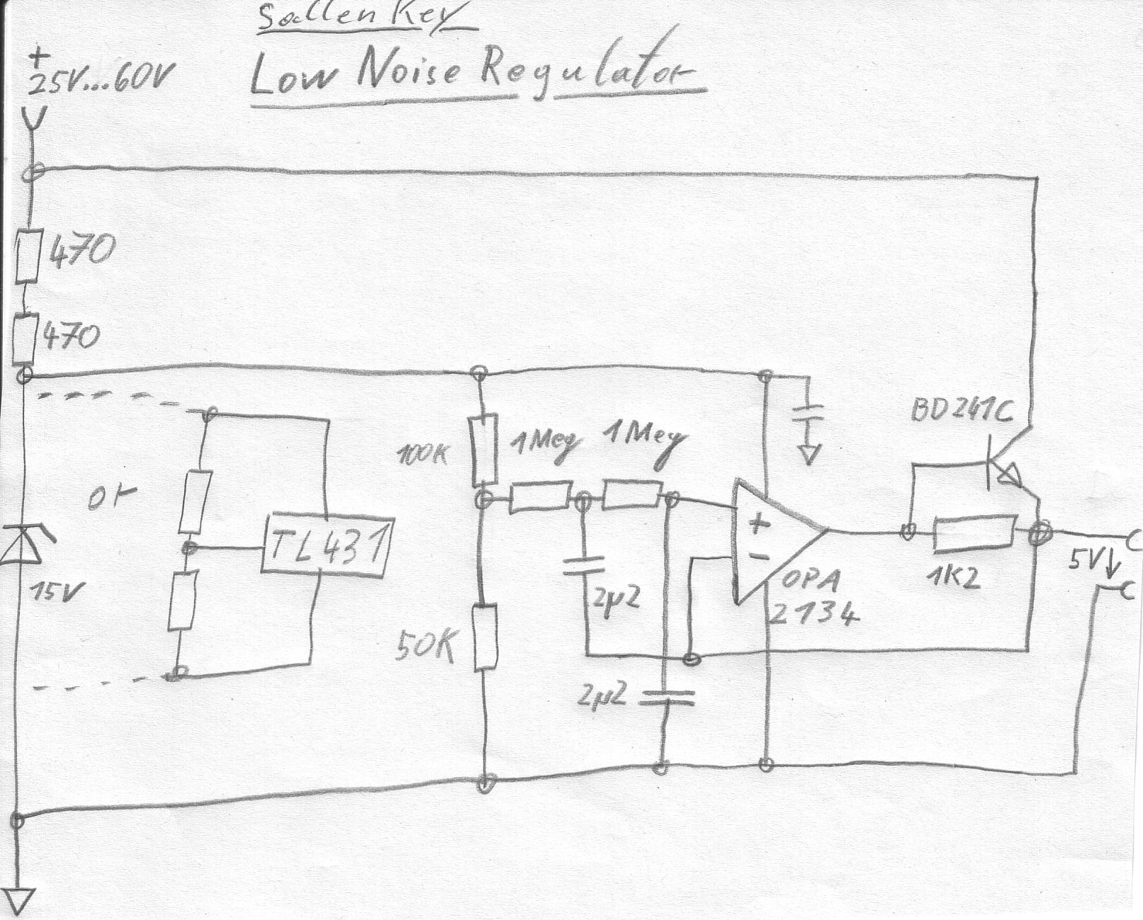

Low Noise Regulators for the Gain Board
The gain board is intended to become an universal input gain stage with optional limiter function and optional offset adjustment.
This gain board should be usable for any amplifier which needs an input gain stage and/or limiter.
The fundamental circuitry will be an instrumentation amplifier using a dual OP amp. The instrumentation amplifier with three OP amps did not make the race simply because of limited PCB size and current consumption.
Current consumption becomes a thermal concern when the supply of the OP amps is derived from the main rails through an onboard linear regulator.
For the gain control of the limiter I intend to use a vactrol (LDR+LED).

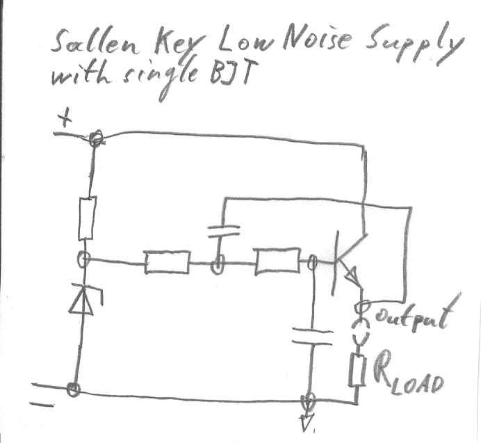

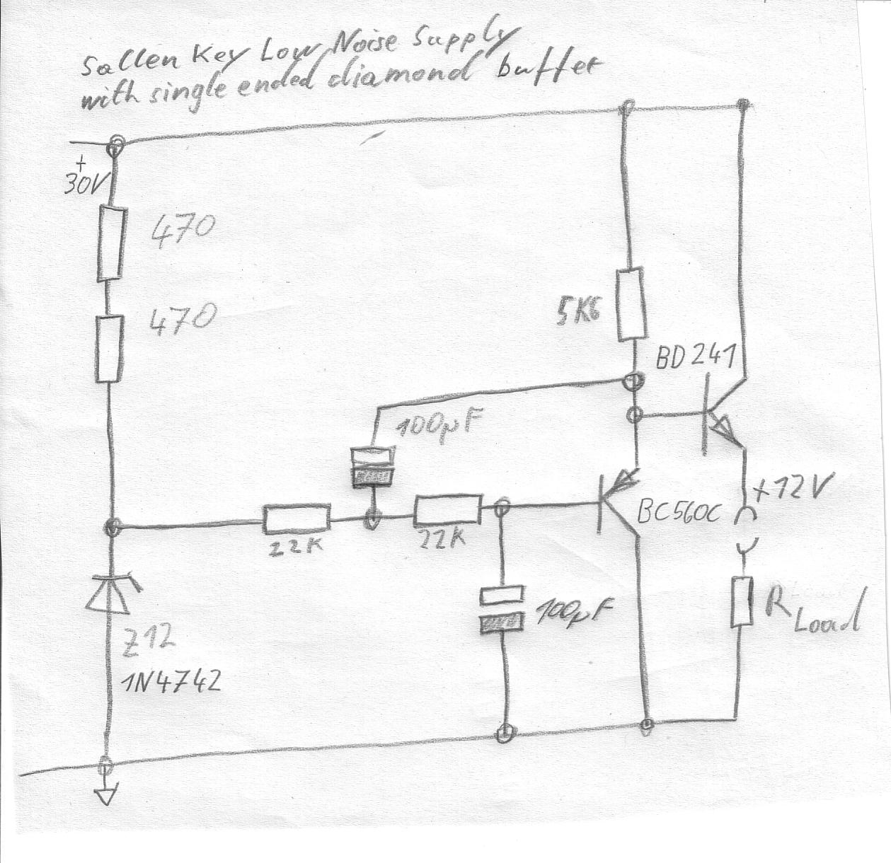

Some years ago I digged into solutions to achieve lowest noise supply rails.
The nicest solution was to use an active power sallen key filter.
Attached three possible implementations.
In the first implementation the resulting rail noise is dominated by the OP amp.
With slightly reduced impedances and 1/2 of a NE5532 the rail noise was around 5n/sqrt(Hz) - means the rail was by far cleaner than most audio signals.
For the gain board of the lite amp I intend to use a variation like in the third picture - let's see how far we can get with this simple solution.
