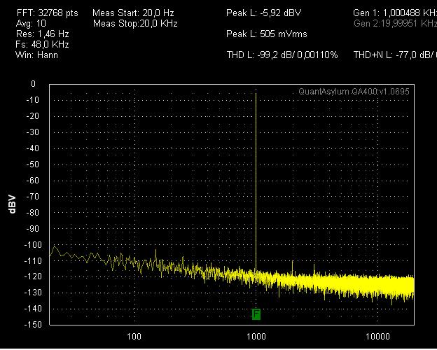

Here the measurements with 1Vrms into a 4R load.
The absolute voltages in the display of the QA400 do show the level at the input of the QA400, not the absolute value of the amp output.
Between QA400 and DUT I have a filter and adjustable buffers, running the QA400 always in its sweet spot around 700mV (500mVrms single tone).
Please also note that this sweet spot means the peak of my 1kHz is at -6db (while the AP2 scales the peak to 0db), so the floor also is shifted by 6db...
IMHO the findings with the CDA-224 fit acceptable to the application note of IR.
First picture:
CDA-224, please ignore the hum - it is a short coming of my placement in the specific enclosure.

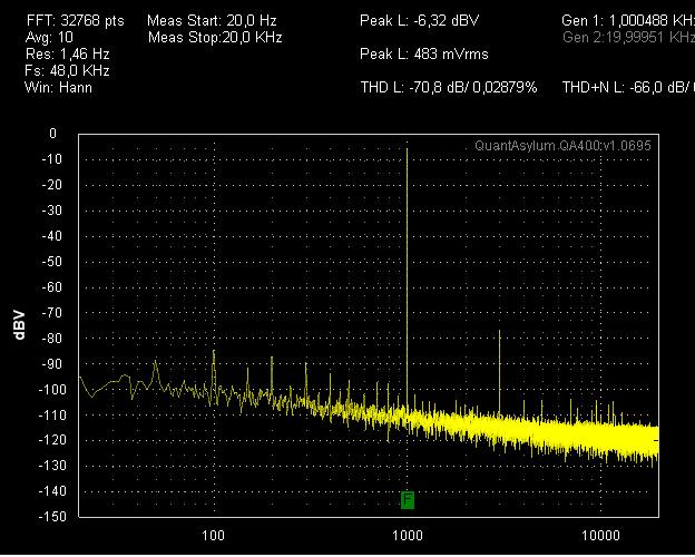

Second picture:
The LiteAmp with a voltage gain of 10.

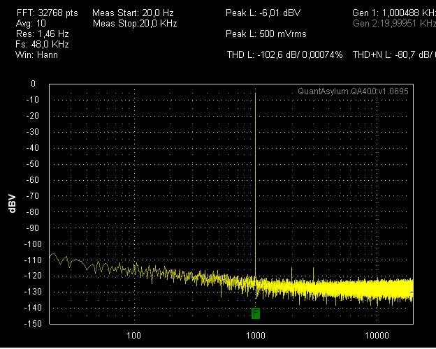

Third picture:
The LiteAmp with a voltage gain of 5.
Would you prefer to go for the low voltage gain of 5 in order to achieve the lowest possible noise?
Please note that this would require to use the optional gain stage daughter board in most applications.
For me it would be OK to go for the lowest noise.

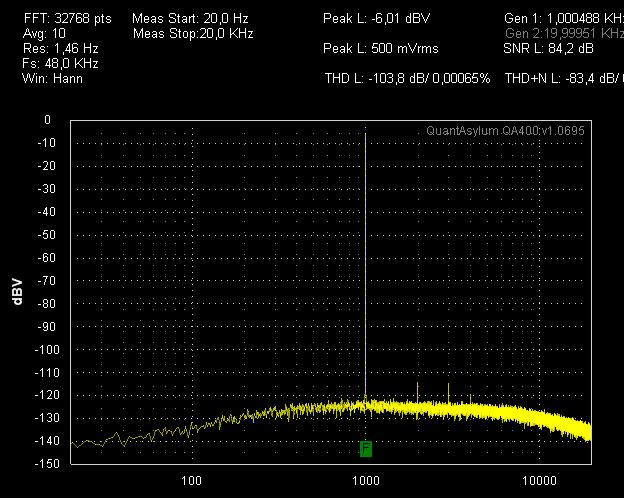

...and here the gain 5 with A weigthing...
The -84dbV (A) fit nicely to the noise which I get visualized with my noise amp and scope: 65uVrms
Related vs intended full output power (22,4Vrms) this translates to a normal advertising specification of SNR:110db
I think we should go for the low gain, because with this we achieve
noise figures which are normal for class A/B amps.
