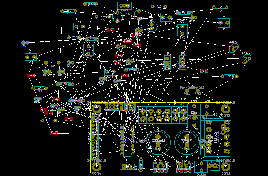

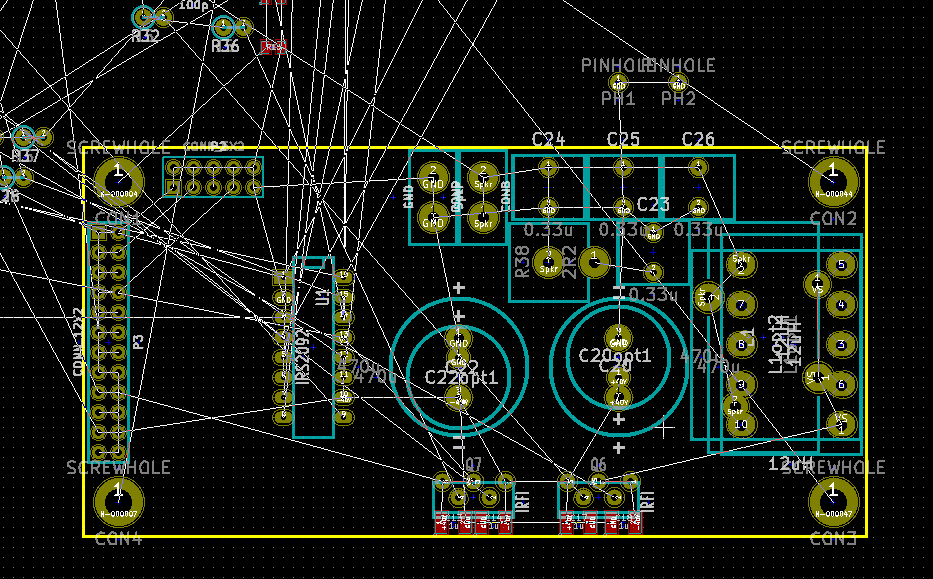

Started with the PCB and have to notice that my intesion to
bring the main board with a 100mm x 50mm size will become
pretty compressed, because of the many options + daughter board +
being prepared for the higher power version + using mostly wired components. Most likely I will have to use lots of vertically placed resistors.
Ugly, but the PCB will clearly show at which side has to be the body and which side has to be the wire ...
Hope vertical resistors are not a hard NoGo for you - or if it is a hard NoGo, please veto now and let's find a trade off.
The trade off moves between larger PCB, or more SMD, or allowing to place axial components in vertical manner, or canceling alternative component options like for the choke.

Did some googling and found this and a lot more :
"Mounting a resistor vertically creates a bigger loop that can pick-up interference magnetically. Compare this with a resistor being mounted on the PCB flat against a flooded ground-plane. The voltage pick-up level is proportional to frequency and area of loop formed by the resistor. This is why surface-mount resistors are preferred a lot of the time.
Also, A high value resistor mounted vertically is also asking for trouble in the presence of HF electric fields - what you can create is a mini-antenna.
As for pull-ups and downs, surely you won't be swapping these out in your prototype - I'd consider using surface mount devices for these parts."
Have no idea if this is a valid statement .
Would not have any problem with SMD parts , 3 days no coffee and beer and solder on !
Most PCB suppliers offer SMD parts placement for little cost . See LJM's LxxD's and Christi's kit , they come with pre soldered smd parts .
As for the Choke , just go for the best one ! it's post filter so one value suits all speakers .

... no idea if this is a valid statement .
It is definitely a valid statement.
That's why it is important where to put the body and where the wire.
Loop size won't change, but at least one can control which part has a
low or high impedance vs the GND plane...
I am confident that I can achieve a sufficiently good layout this way,
but going for SMD would be better, 4 sure.
Personally I am perfectly comfortable with soldering resistors and caps of 0805 size.
(Smaller becomes more and more pain. Pitches like the LT1711, are really the limit I can handle and definitely heavy pain.)
Question to all:
Would you agree to an increased amount of 0805 SMDs or larger?
IRS2092 would still remain DIP.
The caps in the signal path would also remain wired.
I dislike the ceramics in the signal path and experiments with small film/foil SMD, say 0805 and 1206, showed that it is hard to solder them without damage (large film/foil SMD where less critical).
doctordata's view is in principle correct, but e.g. "MyDOA" uses only vertical mounted resistors and hasn't more problems picking up RF as a commercial opamp which is very small compared to MyDOA ...
My old eyes and fingers hate those small smd parts. Every second part will get lost during mounting. Sometimes you here a creak under your shoes ...
Needed to use small smd caps in my class D project to fulfill datasheet requirements of TDA8950J. If you solder them too long the caps simply explode after first power on ...
In other words: if only some parts need to be smd and those smd parts are big enough I'm willing to solder them ...
astx & gommer ... you are obviously living on different planets 😛
Ok, in first step I will see if I can follow the request for easy DIY of astx.
Already changed the few SMD from 0805 to 1206...
... think some 1206 can be handled by my old hands and we save some money cause we do not need the costly premounting by pcb manufacturer ...
🙂:up:
Eyes get older and parts become smaller - this is a real challenge for DIY. My actual "pain limit" is SMD 0402 even working under a microscope. I do my layouts since decades and "converted" to smd for some time - the layouts are definitely much better than with THT.
So I think SMD1206/0805 are a good comprose for all.
