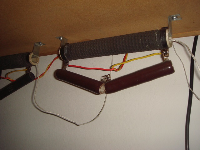

What kind of load resistor did you use, can you show your test rig with the test module wired with power supply and load resistor?, and how long is it safe to run the module in that condition without overheating the mosfets / load resistors. What interesting wave shapes and behavior to look at.
Hi Lester,
I do not have any special test rig, I am just using ordinary high power resistors and combine them in order to get the required resistance and power rating.
I.e. mounted below my workbench there are two resistor triples as shown in the attached picture. Each of this triples results in 4R capable of roughly 200W with some forced ventilation. With this 2x 4R I can get easily 2R, 4R, 8R - simply by series or parallel connection. If I need other values, I have to settle specific other resistor combinations...
Besides the resistor picture, I am also attaching a schematic showing the connection circuitry.
The down side of this method is that you need an extremely strong PSU already for moderate amps.
Consider the LiteAmp tested at 20A. Drawing this from 40V. The PSU and the resistor are stressed with 800W.
For larger amps usually you sinply do not have sufficient PSU and resistors to test this way.
But there is a simple trick for reducing the involved power, but stressing the amp with high currents.
Instead of giving zero input signal, you can jumper the input coupling cap(s) and feed a small DC voltage to the amp input.
I.e. if you have +/-40V rail, you can give a little DC input voltage bringing the output of the amp to +30V. Difference vs +40V is now just 10V (if rail does not sag). When now putting 0.5R between output and rail you will stress the amp 20A, but the PSU is not much loaded (200W only), because the switch mode amp will feed back a lot of current to the rail.
Always start with moderate currents, at high currents this measurement is really tough for the amp!
Duration of this test is short. Just some seconds, which you need to get the reading. When you stress the amp close to the shut down limit and use ASICs like the modern IRS types, which measure the drop across the Rdson, then you will observe a temperature effect.
Within few seconds the Rdson grows, which will then trigger the shut down.
If you do not have a reliable shut down, keep good margin vs max current with this measurement.

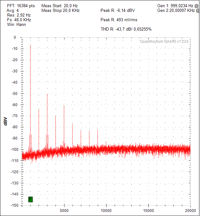

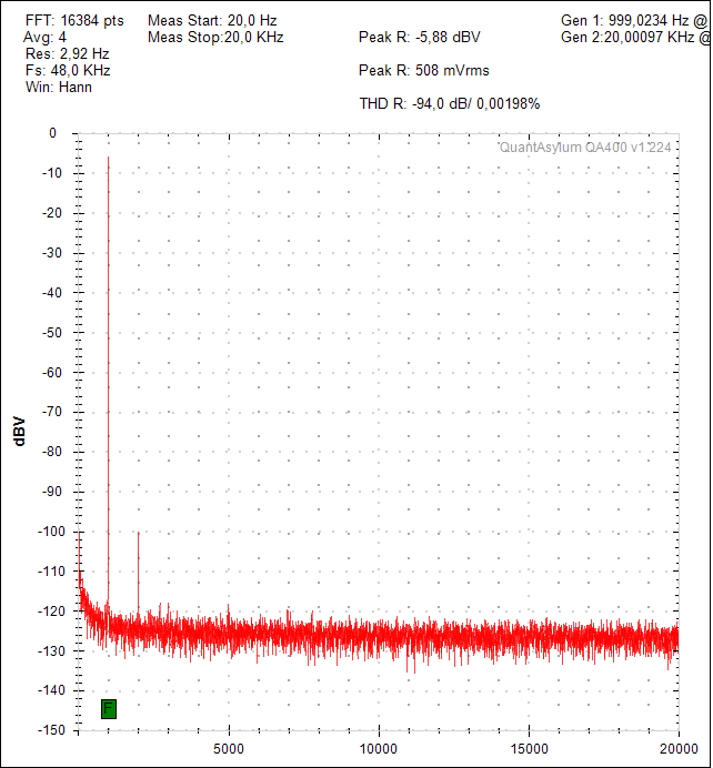

2x80V_IRFI4020:
Slightly less audiophile than the 2x40V-version, but still better than average.
Attached harmonics measurements are for 1W and 200W.
Possible operating range: 2x50V...2x84V
Max. power at stabilized 2x84V: 400W / 8R

2x80V_IRFI4020:
Power with realistically sagging supplies, idling at 2x80V:
250W/8R (not suited for 4R and 2R !)
