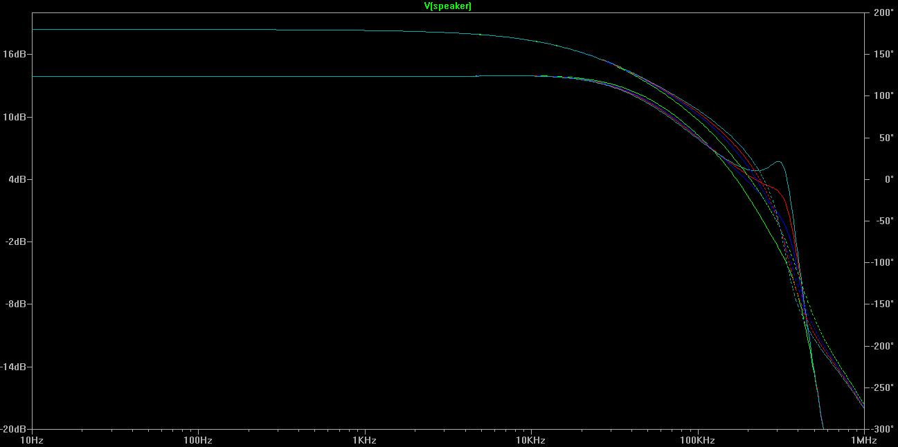

... post showing Amplitude Vs Frequency response with variety of loads say 2, 4, 8 ohm and also open load response.
The filters in front of my QA400 are to slow for a correct measurement.
From design theory the 2x40V version shows a flat gain of 13.9db (+0.1db / -0.5db) up to 26kHz.
-3db bandwidth is larger than 60kHz with any load.
The graph is showing gain and phase at 2R, 4R, 8R, 99999R.
Attached also the LTspice file with the averaged model for AC analysis.
Feel free to simulate the other versions.

Very nice Choco,
looks like Zobel is mandatory part of the response, omiting it causes peaky response with open loads.

...looks like Zobel is mandatory part of the response, omiting it causes peaky response with open loads.
Yes, especially for the 40V version I squeezed for high loop gain up to high frequencies. Besides reasons from control theory I also used the Zobel for carrier shaping in order to achieve lowest THD.

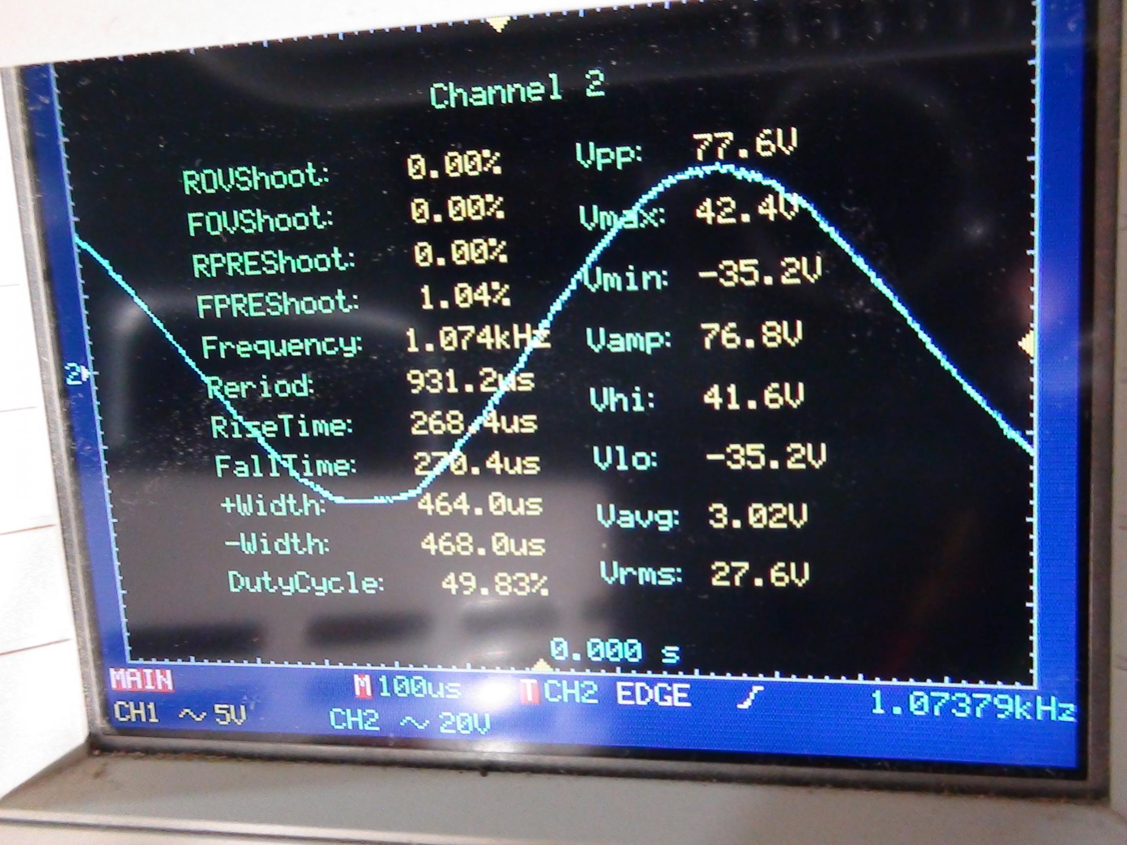

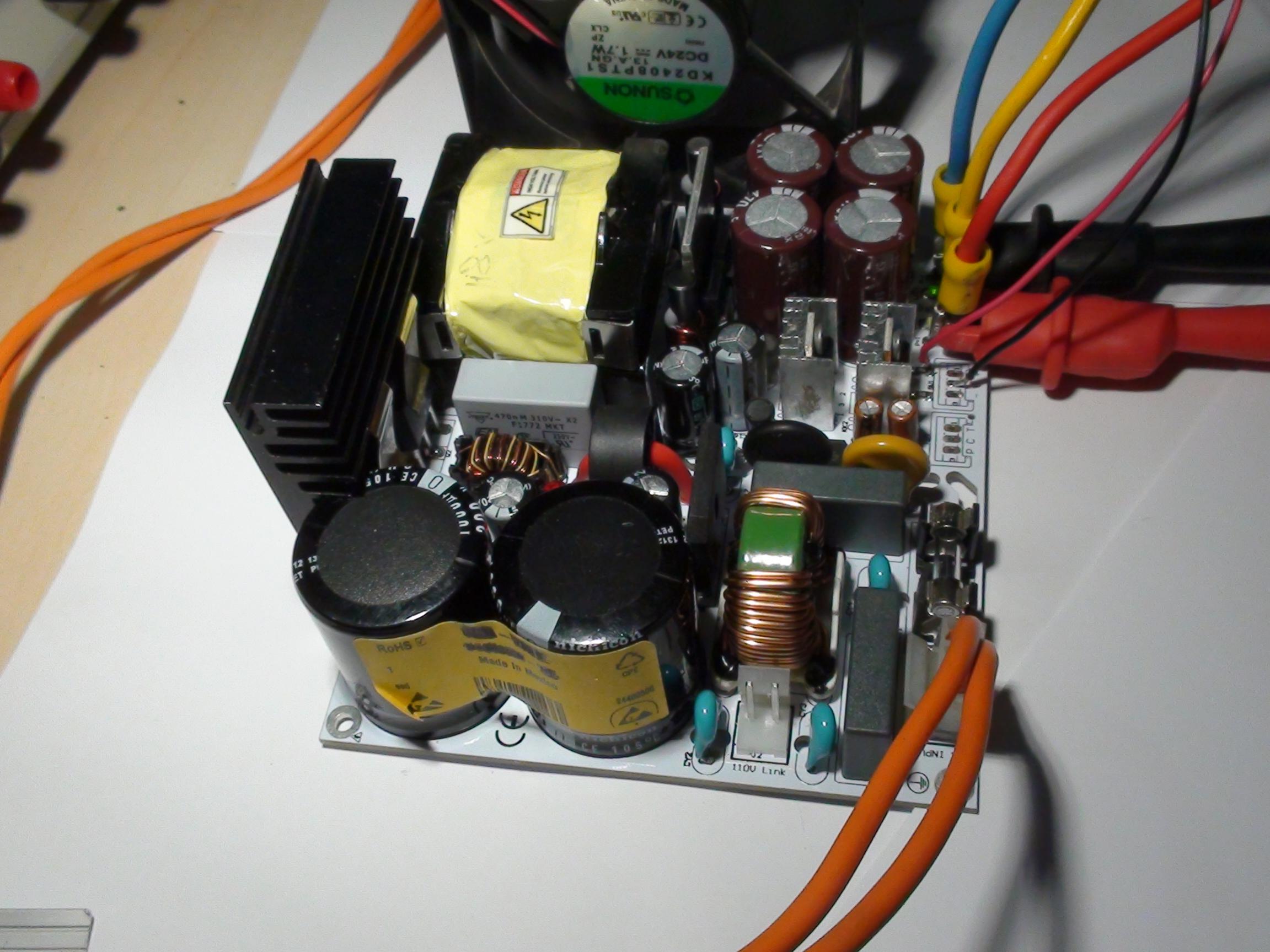

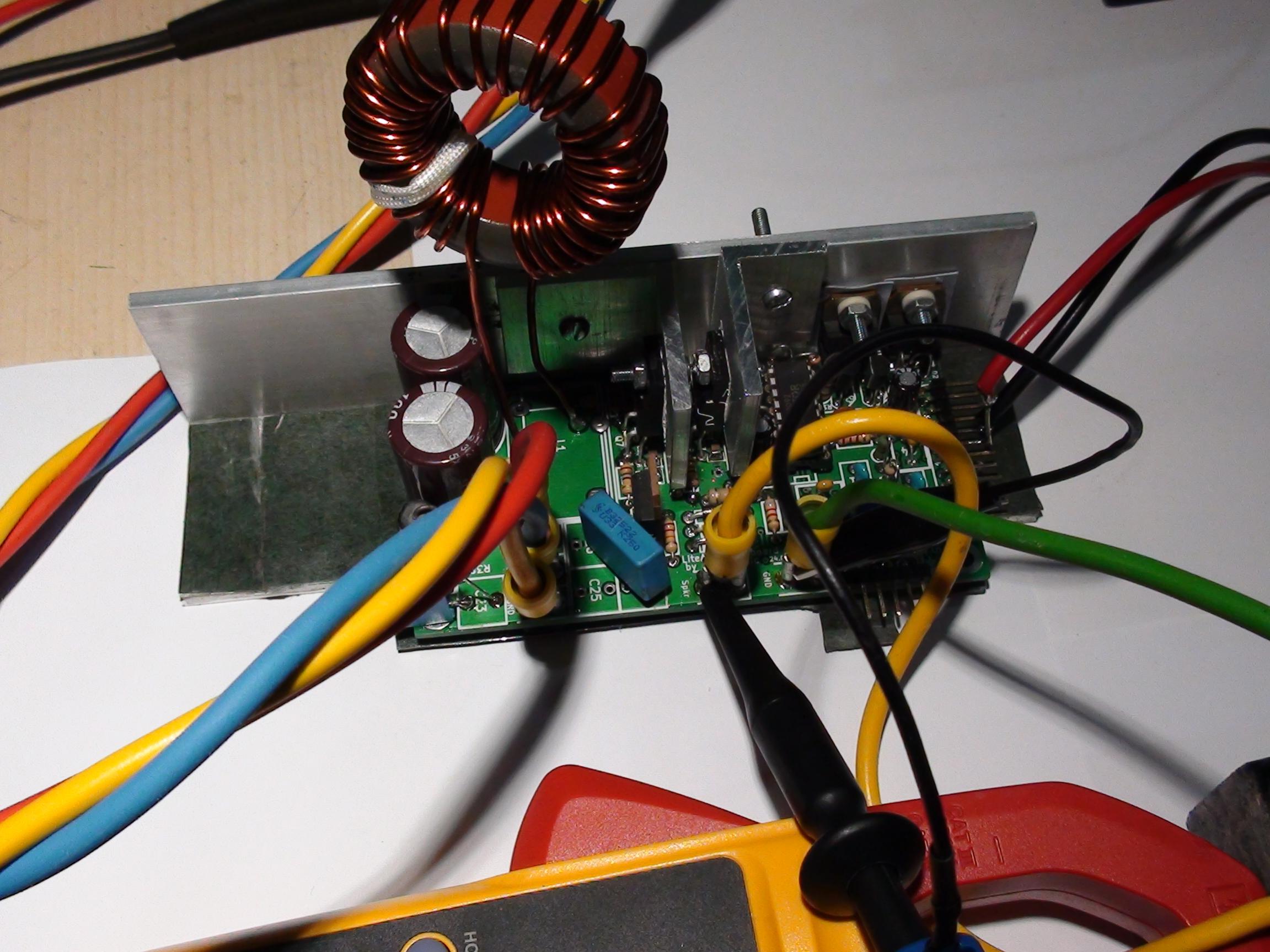

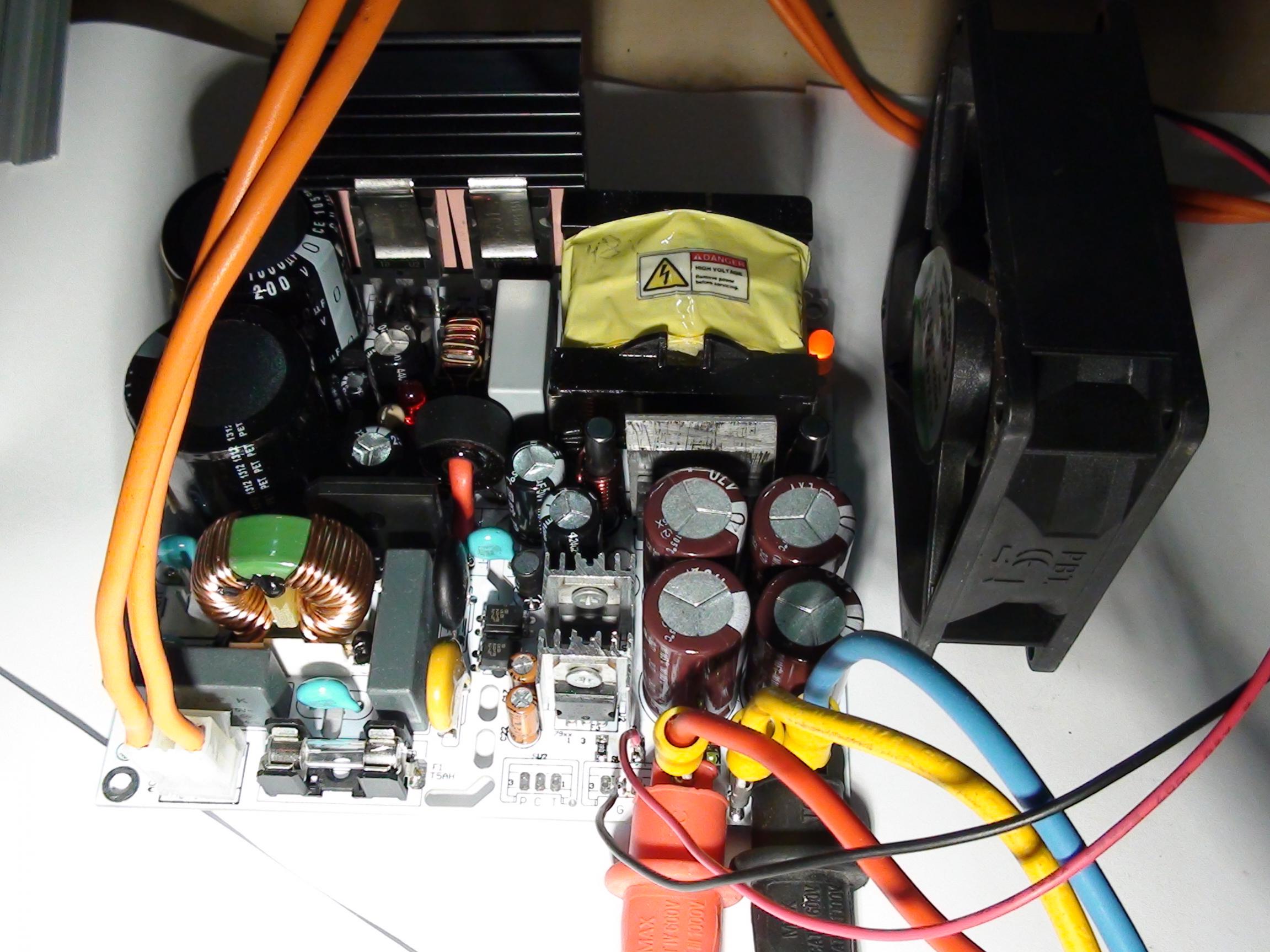

Today I finished my first PCB of the amplifier, I am showing a video of my setup, loading the amplifier 2 Ohms, 1Khz Sine wave, using my UNREGULATED SMPS to drive the amplifier.
I really like the performance of this amplifier.
Soon I will assemble the other PCB with for the +-80V version 😀
Some pictures and the video, ( the music was too loud in the video, sorry for that!)
https://www.youtube.com/watch?v=4T6JIH9cUzo
