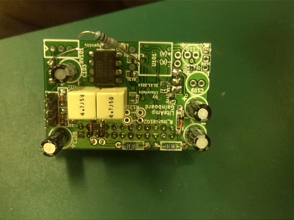

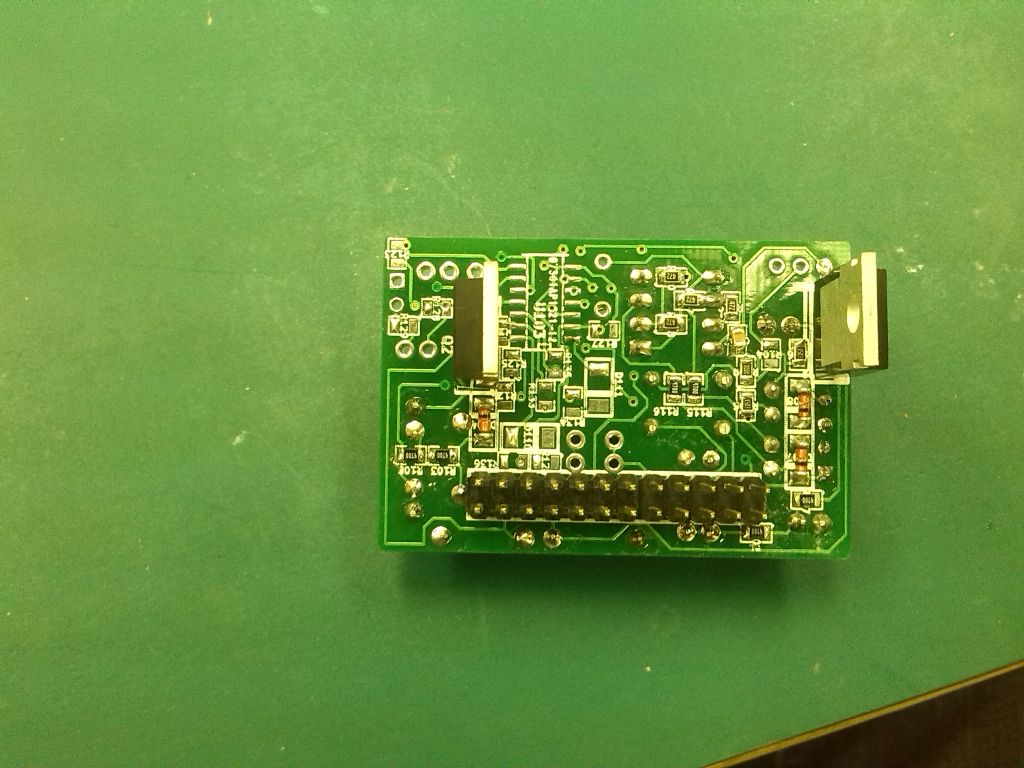

However in this application it will work to substitute 2SC5171 with a BD239C
and to substitute the 2SA1930 with a BD240C.
Hi Choco,
I tried using BD239C and BD240C in one of my gain boards and during step one of "getting it going" I have severe oscillation on the emitters of both devices with the 3k3 resistor tying them together. If I remove the resistor I get 11V on the NPN emitter and 10.6V on the PNP emitter with a +/-20V input. Any ideas?
I guess it is -10.6V at the emitter of the PNP?
If so , then your description would point to heavy fluctuations of the +/-20V.
Do you measure similar fluctuations also at the +/-20V?
Yes, sorry, -10.6V at the emitter of the PNP. No fluctuations in the +/-20V, I am using a regulated dual bench supply. Behavior does not change if I increase the supply to +/-30V.
Hm, strange - can you describe the oscillations more detailed?No fluctuations in the +/-20V, I am using a regulated dual bench supply. Behavior does not change if I increase the supply to +/-30V.
Which frequency? Which magnitude? Any method of describing your observation is helpful. Verbal description or screenshots or a video showing your set up and measurement...
Choco was kind enough to PM me with the offer of assistance in the background, but I believe hashing out this oscillation issue might be of help to others, so I am including some screen shots. With a 3k3 resistor tying the emitters together, I am seeing oscillation of around 10.8MHz. Without the 3k3 resistor I am seeing approx. +/-11Vdc on the emitters and the output is clean.
Power is provided by a dual bench supply with +/-20Vdc input voltage.
Thanks!
Hi Ungie,
theoretically this oscilation should disappear when you place
R112 and R113 (==> Low HF load impedance in combination with C107 and C108, like a zobel).
Somehow my sample was more forgiving and did allow operation
without R112 & R113.
If you are afraid of causing defects to your OP amp in case the
oscillation would not disappear with R112 & R113, then you can
try it without risk first, simply by placing a series connection of 6R8+100nF from each emitter to GND.
Choco

Hi Ungie,
Choco
Thanks for the suggestion Choco, I will give that a try and report back.
