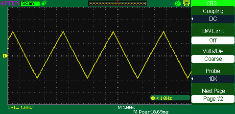

Hi Chocoholic,
I used your design and build it up in as far as possible in SMD.
The component selection is based on the 2x 80V version.
The stabilisation transistors are MJD340 and MJD350.
I used Polyphenylene Sulphide capacitors instead of the normal trough hole Polypropylene film capacitors
I planned to use 2 single IRFB4020PBF FET instead of your dual FETS.
However, it won't oscillate.
The voltage on VAA and VSS are 4.73 and -4.72 respectively referred to ground.
The OCSET is 1.25V referred to -PWR
VB is 14.97V referred to VS
CSH is 5.97V referred to VS
VCC is 11.46V referred to -PWR
I didn't mount the FETs yet.
The waveform on the CSD pin is triangular and swinging between approx -2V to +2V (see picture)
It seems like it will not become in normal mode, so oscillation will not start. I couldn't find any aspects what the IRS2092 should decide to hold in shutdown.
Do you have any idea?

The CSD is typical for a system, which tries to start, but immediately triggers a shut down function.
Pretty likely the IRS will start to generate a gate signal, but then there
is no power device, consequently the Vds will not become small within a few hundret nano seconds. ...well, and that's exactly how the overcurrent protection of all the modern IRS drivers work.
They examine if Vds of the power device reaches a voltage below the shut down level within a few hundrets ns after the gate signal is generated . Without power device Vds will typically remain higher than the shut down level and the IRS is reading this as over current.
Have a look to the gate drive output of the low side. If there you find one short gate pulse (likely shorter than 1us) at the beginning of every CSD cycle and then stops again, then it acts like one can expect without power devices.

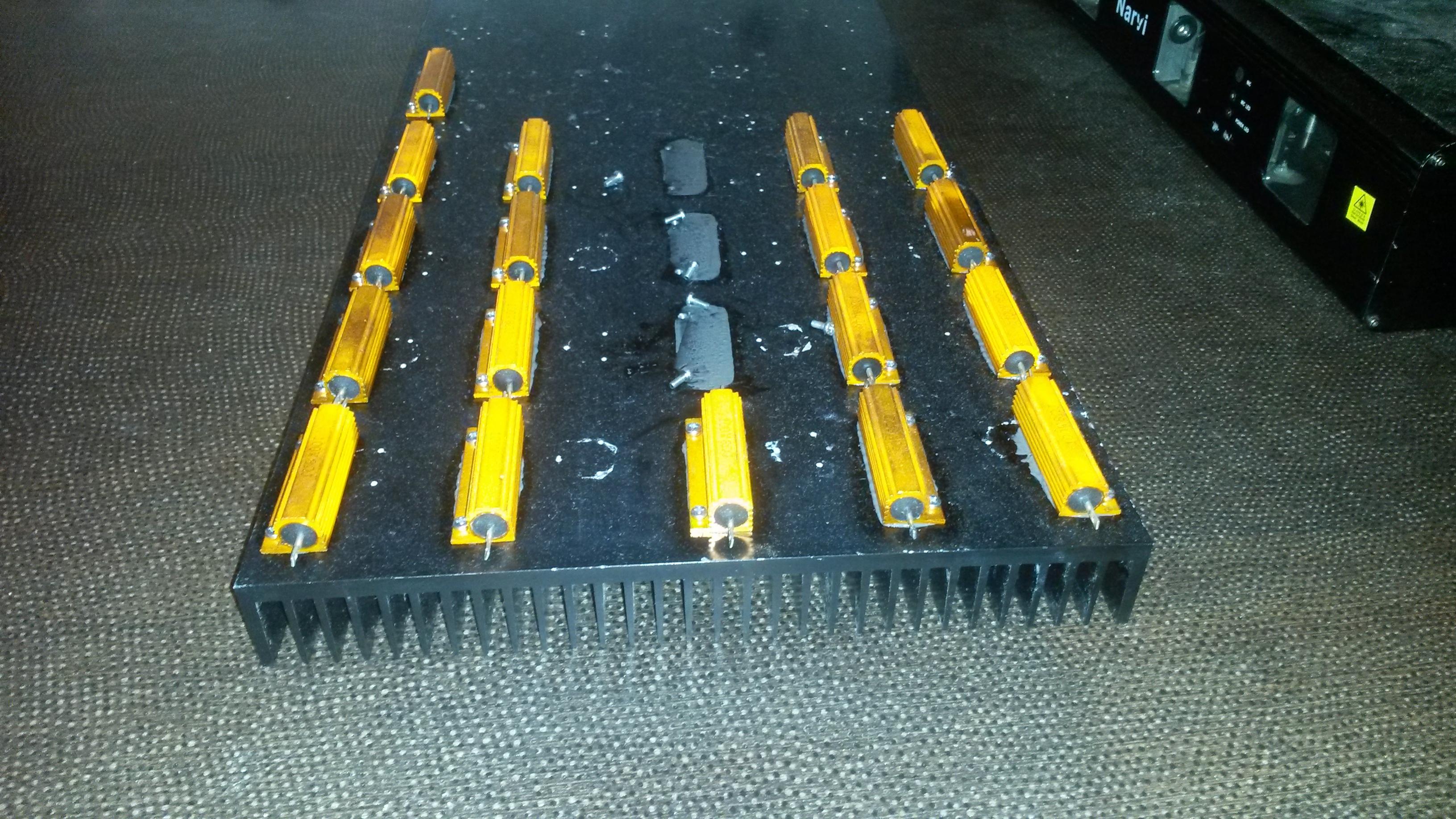

When you power up the first time with power devices, you should use a supply with current limiter. Reasonable settings for the current limiter would be 200mA...500mA.
If you do not have a suitable supply with adjustable current limiter then put serial 100R (2W or stronger) in +80V and -80V.

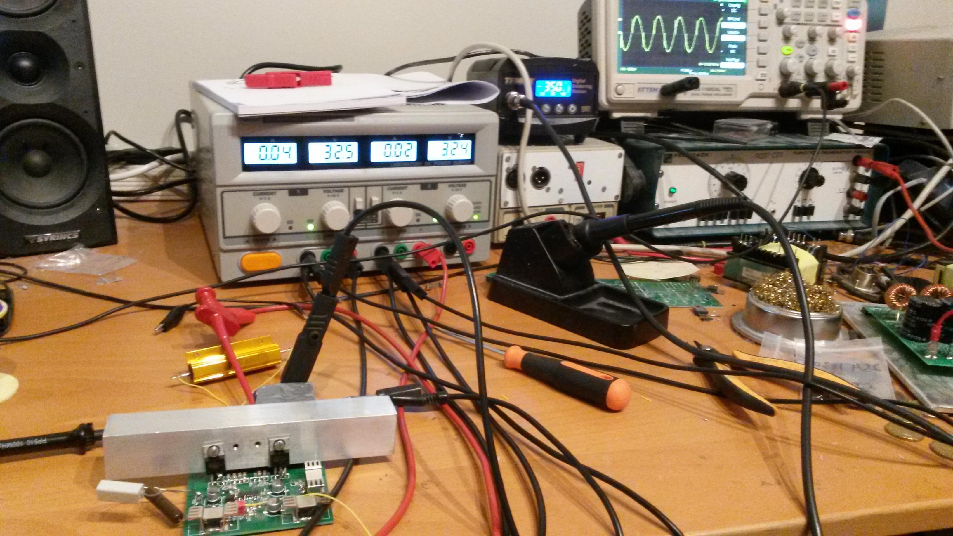

Thanks for your answer. It really helps me. I found the problem, drain and source of my FETs were not connected in the correct way. That's why the supply was shorted every time (body diode).
The circuit is up and running.
Hopefully it will perform as good as yours Chocoholic!
The last picture you see is the output ripple with input shorted.
with speaker connected I can only hear some soft hiss when I place my ear within 10cm from the speaker.
In the future I want to use 2 FETs a side and try to make the circuit suitable for 4 ohms load with double 80V supply.
From now I will try to do some measurements and post the results here.

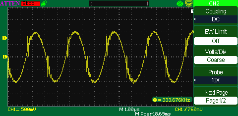

Thank you!
During the first test, I shorted R26, but now it is opened. The picture below is measured directly on the speaker terminals. But you can see the very small blips again.
I'm not very happy with the amount of noise. With my visaton DX10 test loudspeaker it is not audible 1m away from the unit, but if I use such circuit to amplify my 112dB/w/m HF drivers directly, it could be annoying.
Is that normal or should I look further into the PCB layout for improvements?
... to amplify my 112dB/w/m HF drivers directly, it could be annoying.
In order to judge if your set up is already touching the limitations of the IRS2092 or is suffering too much from other noise reasons (like layout) I would need to see a proper noise measurement. A high order (at least 5th order, preferably 6th) low pass filter with approx 16kHz...20kHz -3db bandwidth followed by a low noise gain stage with a voltage gain of at least 200, but preferably 500 or 1000. With this you can make the noise visible on any scope. Use a time scale of 2ms or 5ms per grid. Measure the peak2peak value. Anticipating a white noise you can derive the rms value by dividing the peak2peak value by factor 6.
The blibs on the output do not necessarily translate into audible noise. With some good luck you are just blasting EMI emissions into the world, without causing issues to your own circuit. But also EMI emissions not desirable and for good reasons there are limitations by law.
In general I have to state that there is no clue in running 112dB/w/m HF drivers from a +/-80V supplied high power amplifier in your living room. For this definitely the +/-40V version would be more appropriate and allow 4...5db less output noise.
With correct layout the +/-40V version can achieve an output noise level of approx. 75uVrms, while the +/-80V version will not allow less than 130uVrms.
