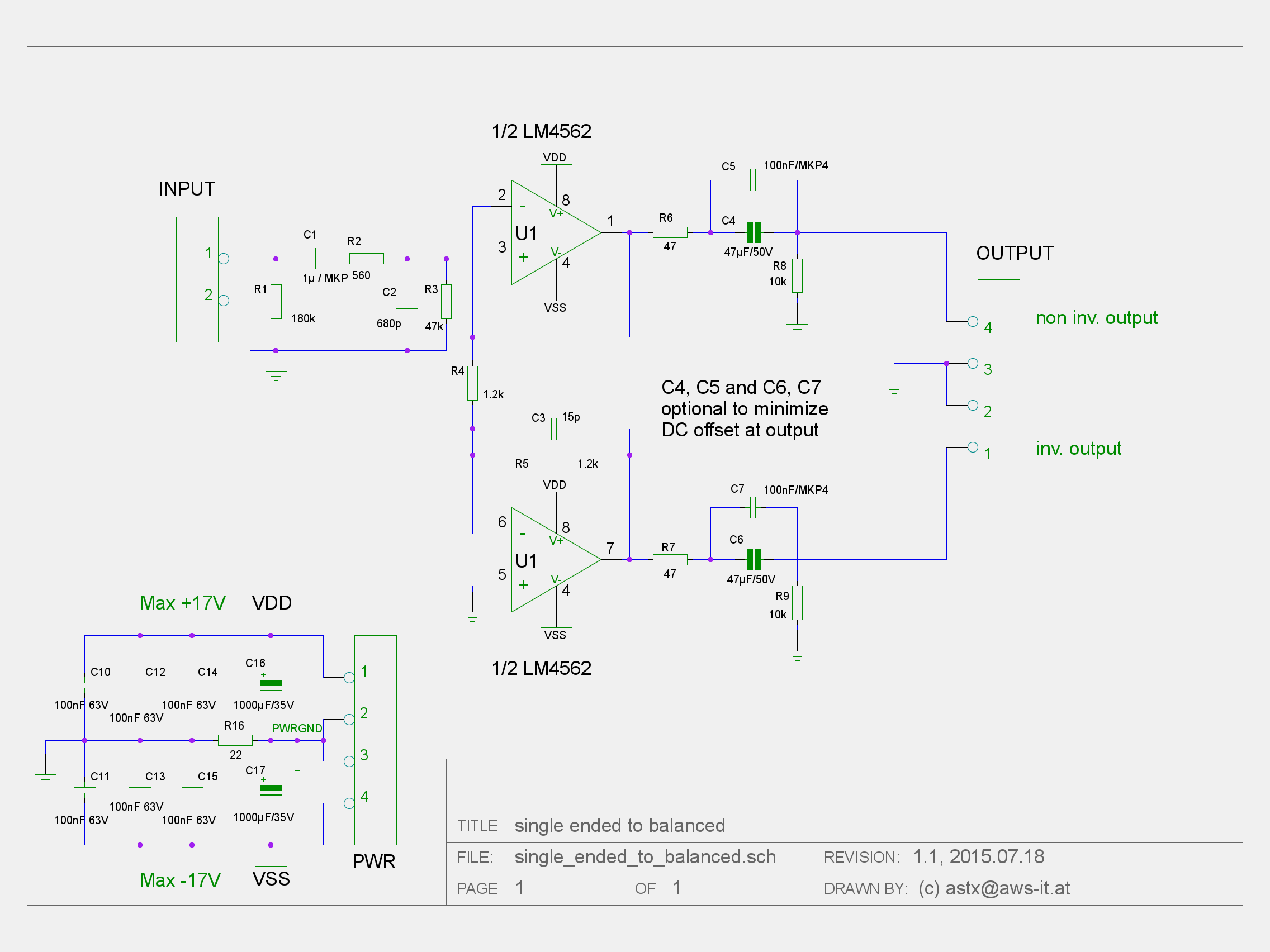

If your preamp has too high output impedance but enough gain you can use this simple single ended to balanced circuit (gain = 1x) connected directly to LiteAmp mainboard. Maybe you need to reduce C2 (RF filter resumes your preamp is able to drive 600R).
BR, Toni

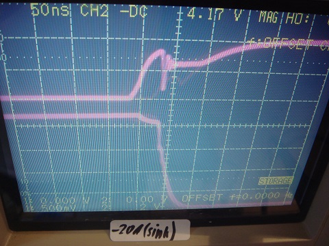

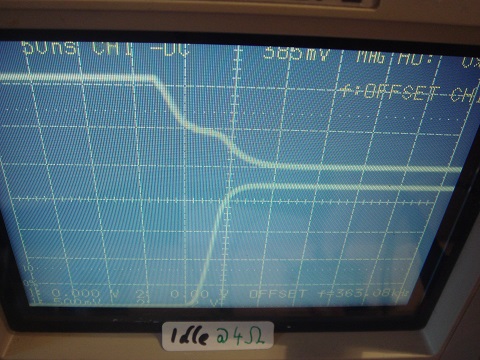

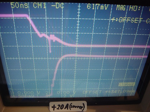

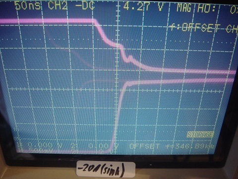

All attached screen shots were taken with the following settings:
Time scale is 50ns per horizontal grid.
Upper trace: Ugs of the low side switch, 5V per vertical grid
Lower trace: Half bridge output voltage, 20V per vertical grid

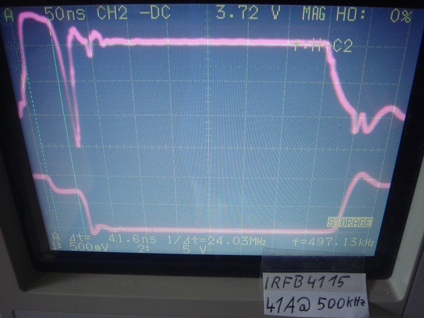

Interesting data; thank you for sharing. What is the scope+probe bandwidth?
This very smooth and soft approaching of the Vds at the rails is something special of the IRFI4212. With most Fets you will find Vds hitting to the rail more hard.
For reference I am attaching a measurement with a halfbridge based on IRFB4115 when sinking 41A.
Upper trace is Vgs of the low side Mos, 5V/Div
Lower trace is Vds of the low side Mos, 50V/Div
The 25V step in Vds in the first grid is mostly the inductive voltage drop of the rails + upper MosFet package while the lower MosFet first takes over the load current and then removes Qrr. Together this takes 50ns with an di/dt of approx 2000A/us.
The deep dip in Vgs happens when Qrr is removed and Crss feeds the giant dv/dt from the Vds to the gate - superimposed with an inductive effect of the giant di/dt in the source wire when the Qrr-removal-current-peak snaps back.
Both half bridges (IRFI4212 in the LiteAmp & IRFB4115 in the SystemD_MD) have proper snubbers in place. Otherwise heavy ringing would happen, when driven with such speed and current levels.
Scope is the good old 500MHz analogue Iwatsu TS-8500 (...yes John, I am still using it. 😎 )
Probes are the ELDITEST GE4512 (Bandwidth: 450MHz)
