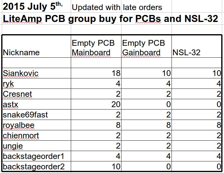

I'm very sorry that I forgot to post last night before the deadline Choco! Is there any possibility to still be added to the list?
Main board x 2
Gain board x 2
NSL x 2
Main board x 2
Gain board x 2
NSL x 2

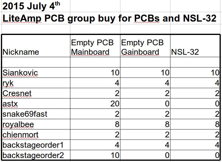

PCB ordered
...PCB orders are now placed at the vendor.
The attached table shows all your requests which I took into account.
My thanks to all of you who have given me the shipping adress early and paid fast. Thanks, this helps to keep the org efforts low.
In case you did not pay yet, please do not forget to so in the next days.
Please check your PM for details.
