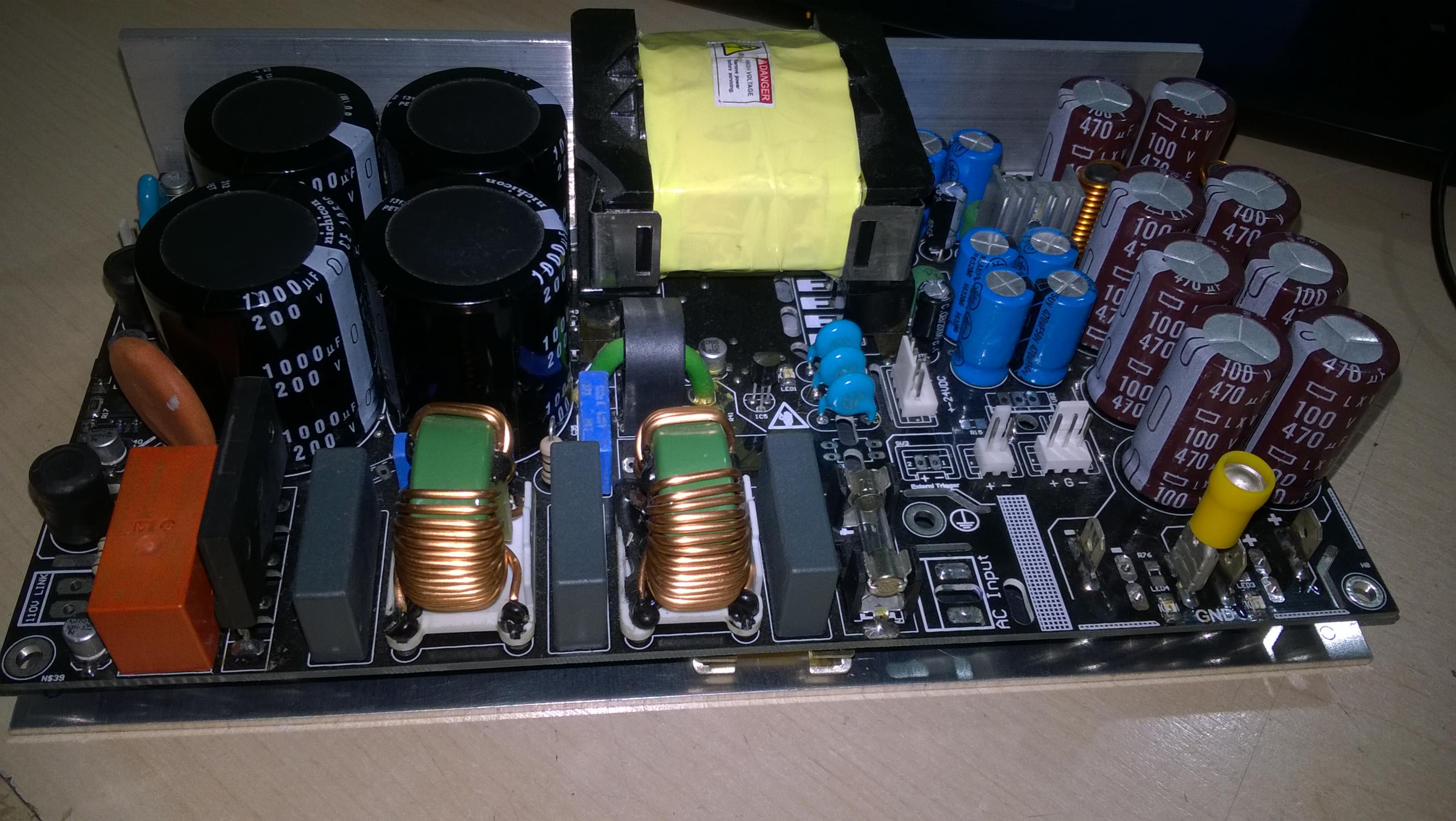

My SMPS in idle is +-45VDC, with 10A resistive load it drops to +-38VDC.
I think its going to be good!
SMPS is just missing the final touches!

Indeed a nice looking SMPS.
But take care. +/-45V is already critical in an unregulated SMPS.
Already +10% of change of your AC mains will bring the supply to the absolute max rating.
Second I assume the smps can only source but not sink, so you have to expect buspumping. The attached SIM shows the effect and the supply goes to roughly 107V from pos rail to neg rail. Defect likely.
Feel free to investigate with values that fit your SMPS.

I am planing to make a Synchronous rectified version of the SMPS (Unregulated also). The design is ready to be on PCB later 😉
ChocoHolic, Toni, having looked at my ideas bridge at 35-0-35 may be better than a single amp at 50-0-50. Are there any problems to be aware of?
I realise that 4R is the lowest load but what other things should I be aware of?
I'm running my 4 Channel LiteAmp bridged without any problems at 2x37V rails. Running the amplifier modules in bridged mode avoids the bus bumping problem.
Despite of the tuning procedure to get lowest noise and distortions the amps are running very fine and without any problems even with high load ~ 180W@8R
