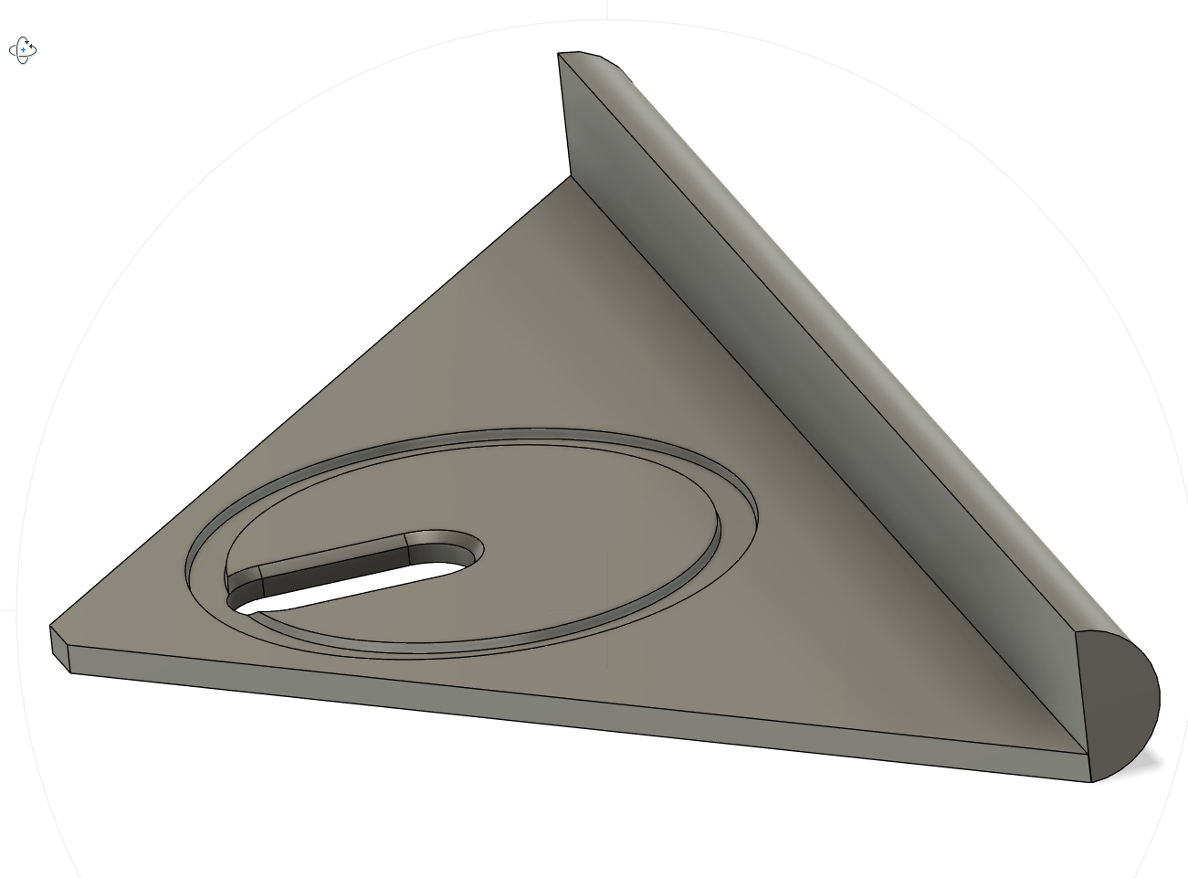

Ok thanks guys for the answers.
Yes, I was hoping with the squarish horn I could get away without the secondary flare and just go with a simple round over. Thinking of just cutting a 4" ABS pipe in half (image)
Point taken about the floor/ceiling issue. I will go with a 60 vertical.
My plan is to stick this in a corner, use walls as the horizontal horn extension. I really like when I had my synergy flush to the side walls. Eliminated the side wall reflections, which was a big bonus.
Corner placement will let me go big, possibly up to 48" wide with no issues and let me use a 15" woofer, hoping to 400Hz XO with BMS 4592ND. Just planning stage for now, looking for ideas or somebody pointing the obvious mistakes...

Right now it's single flare 41" wide to fit a 15" driver. It's actually not that big if placed in the corner, virtually disappears, almost 🙂
Gotta thank Mark for his work, I would not have thought about this without his excellent work. Thank you

Oh, be incredibly careful if you attempt to slice pvc pipe longways. It's a long story, but it's why I had to retire early. Injury due to a tablesaw kickback from hell! Also don't underestimate the difficulty of gluing pvc to wood. Most things that adhere to pvc don't adhere to wood and viceversa. I'd look into ply or maybe even foamboard if I were you!
Ouch sorry to hear that. Thanks for the warning Bill. I was going to try it with a band saw or a tracksaw. I'll play it safe and follow your suggestion.
I'll be measuring it first before adding round overs to see if it makes a significant difference.
I read here that the bigger the horn the less the second flare or round over helps?
At least for home use purposes

Take this from me and the thread in my signature:
You will get a good response in the sweet spot but the waistbanding will constrain the sweet spot. As will the fixed toe-in, if you indeed fit it tightly into the corner - but if the geometry works out, go for it! It doesn't need to be wide because of the corner walls but it needs to be tall for vertical directivity down low enough to preclude a floor bounce null at the LP - which will make it wide.
If I had to do it again, I would implement some form of mouth termination.
I agree with having mouth termination.
Both for preventing waistbanding and the extended pattern control.
The added flares on my 90x60 and 60x40, both made sound imaging extend lower in freq.
fwiw, i would not make foamboard flares again. Too much work and expense. And hard to get right.
Just making a hot wire cutter that could handle a 4 ft span was enough work, then there was learning how to use epoxy and glass cloth.
Was a hell of a bigger project than the dang synergy itself.
I'd go with wood for either a straight or curved secondary. I'd use bendy board with ribs if curved.
