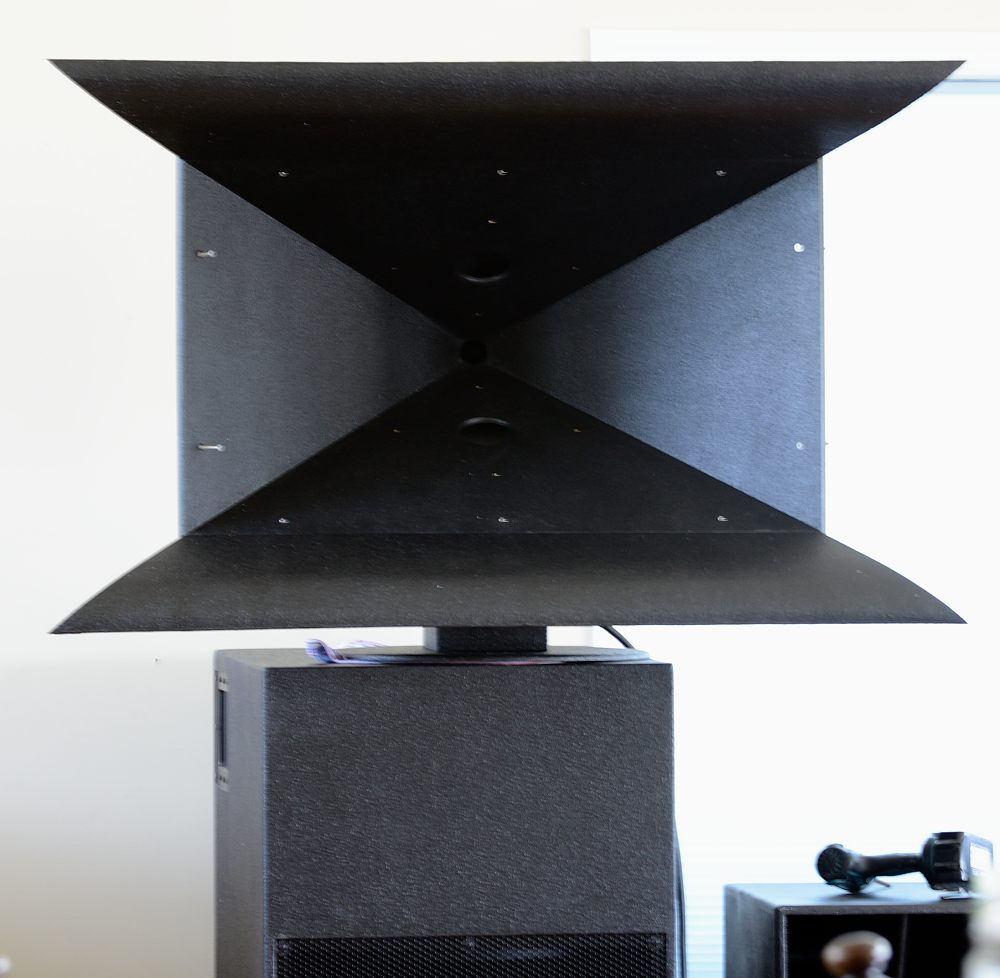

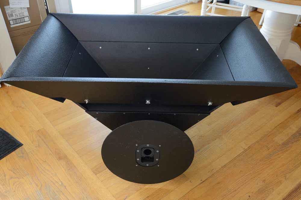

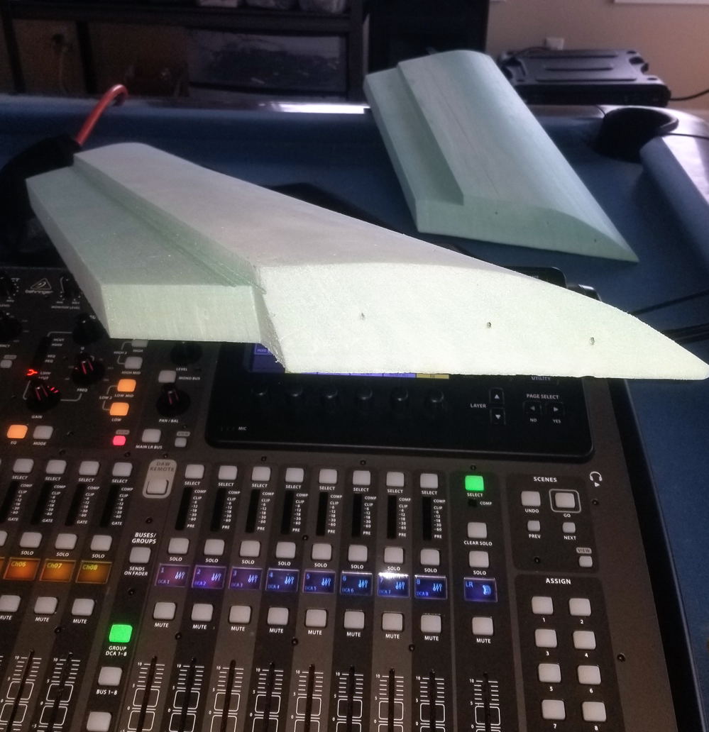

This syn has the primary wood flares square cut to allow different XPS foam to 'bolt on' easily.
I could very easily make the primary flare really huge, and then add a second foamboard flare using your great speadsheet for angles.
See pict for how the foamboard flare mount to primary wood flare...

Update:

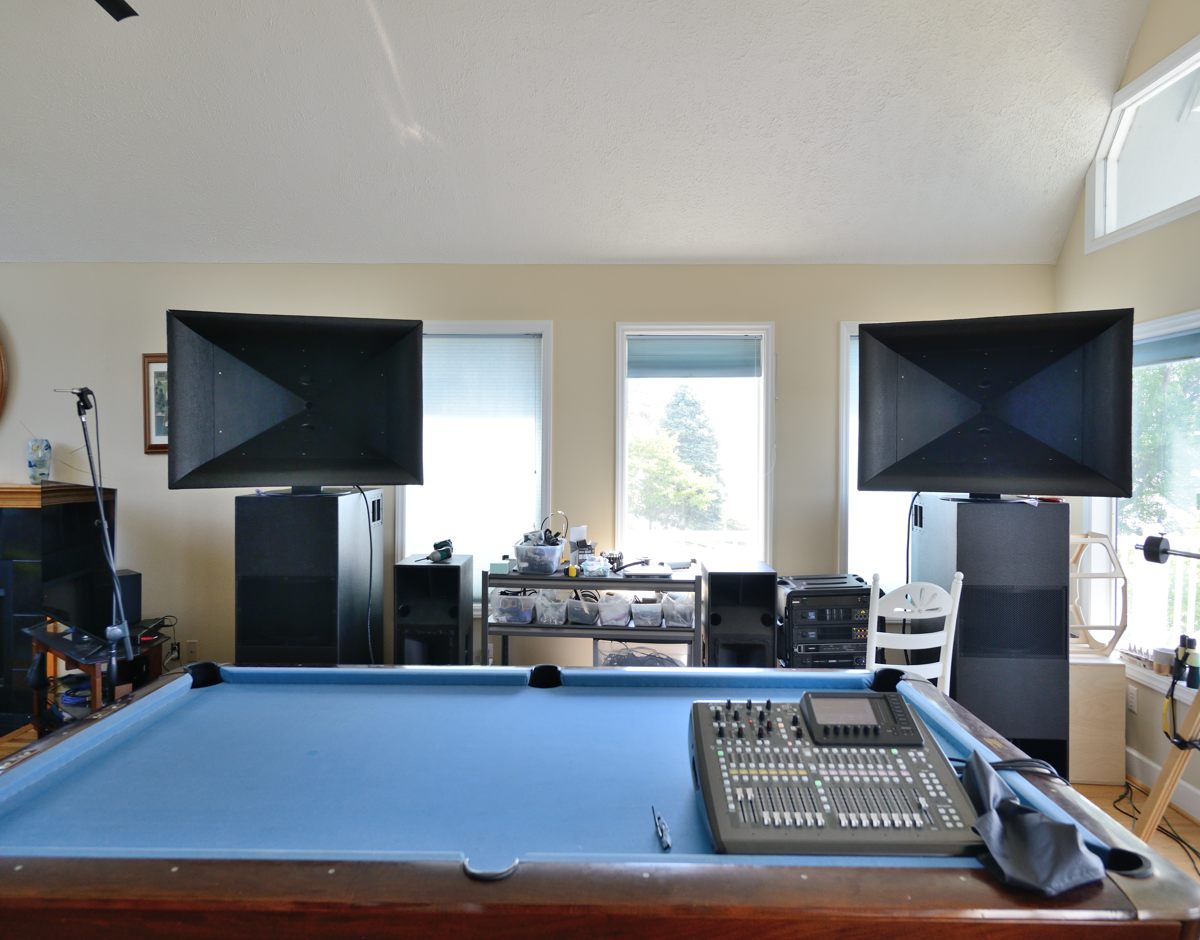

Finished detachable flares, and ........a second syn7!
It's the first stereo I've listened to in almost a year, since going down the synergy development hole.
Final weight with flares on, is 52lbs. So foam flares and hardware added only 5 lbs, yay!
Like said, the goal was to be 90x60 conical for the first 2/3's, and as tractrix-like as possible for the last 1/3.
Here's a pict with just the horiz flares attached.
I can move them around from indoors to outdoors, even with the flares attached.
Portability, has been a huge part of the design goal; the flares go on and off pretty easily and quickly. But it's been a pleasant surprise to find I can move them around attached.
That said, their sheer size does make moving them a little awkward, but with each move from place to place, I've been gaining the muscle and logistic memory how to make it easier. So goal met !
Here's a pict from the bottom.
Sound wise....hey, hey, hey...happy camper here 😀
Great imaging, outstanding transients and SPL.
(Lowest SPL box I've built yet lol...single box should be good for >128dB.)
Both running in room.

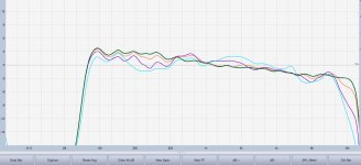

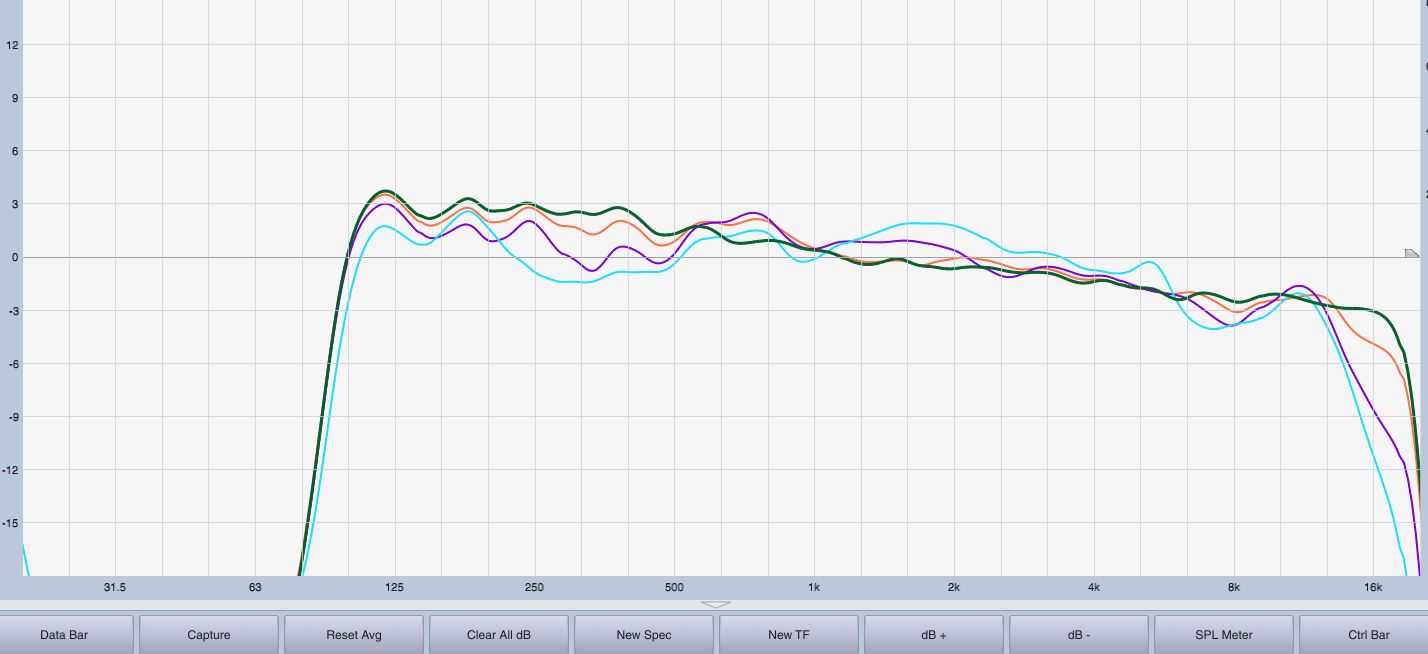

So we have boatloads of rain falling and the only measurements I can take are indoors....aargh...
Here's a quick set of horizontal polars at about 1m. 0,10,20, and 30 degrees.
Green is on-axis with a gentle down-slope house curve in play.
Had to stop at 30 off because of heavy room/object interference beyond that.
Must admit I'm surprised how good these are appearing. Won't know for sure until outdoors, but it looks like the secondary flares have really helped.

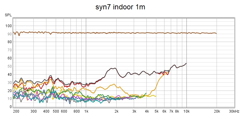

Also took a quick distortion test.
SPL is accurate.

It sure looks like the curved secondary flare does improve the response!Won't know for sure until outdoors, but it looks like the secondary flares have really helped.
Looking forward to seeing the response measured outdoors.

Hi Art,
Yep, i'm kinda surprised really how much the secondary flares might be helping. This 90x60 syn without the flares, had the worst polars of any syn attempt I'd tried. Will be glad to get outdoors and see for sure....
