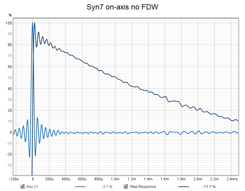

Here's an acoustic impulse and step response i made this morning for the syn7 with flares on.
Took 3-way raw measurements, corrected each driver section individually, and then summed to results below .....all in under 30 min....

Mark100, I remember some diy members have critisised the "heavy" FIR processing due to preringing and you have responded it is not much of a concern. I guess the ringing is visible in the impulse response you posted? Have you tried to reduce it by using shallower crossovers or something to optimize between the ringing/overall frequency reponse smoothness and what is the verdict?🙂 Great results anyway!

I've also been one of the diy members that criticize over use of FIR processing.
Imo, any high Q, sharp frequency change, over-correction, is to be avoided, whether IIR or FIR.
I'd even go further and say any use of FIR to tune specifically to a spot is over correction, unless you lock your head in a vise 😉
But that's just me...(and it's because I think such tuning always spans xover summation regions which are not minimum phase.)
I do not believe high order linear phase xovers produce any sharp frequency changes.
And high order linear phase don't have the excessive phase rotation that precludes using higher order IIR crossovers.
But the biggie is, I've heard zero evidence of pre-ringing from their use.
The only time I've heard 'pre-ringing' is what I'd call pre-echo...when I was using very long FIR filters across the frequency spectrum...and no doubt over correcting. It was in my early days of learning FIR.
I now relegate pre-ringing to the myth category unless a person uses extreme high Q examples to prove it can be heard.
And I don't think the squiggles you see in the impulse and step i posted are pre-ringing.
I think they are just the digital gack we get in measurements, trying to precisely time all the FFT math needed.
Notice the squiggles are symmetric around t=0. Is that post ringing too? I don't think so, ...
I don't even think it's real, because I've learned if I add a a very high freq 20-22kHz low pass filter to the VHF output, after the FIR filter, the squiggles almost completely go away.
And there is no change in sound, so again, i think they are meaningless inaudible measurement oscillations.
Of course, could be wrong...

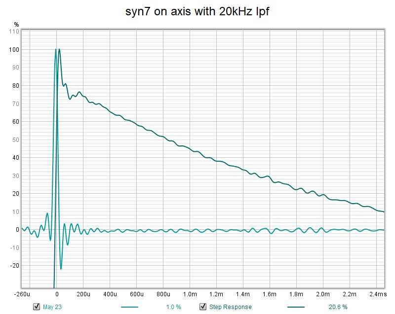

Below is the same tuning posted earlier with just a mild low pass at 20kHz added. The squiggles clean up and shift their look.
And then the original for easy comparison.
Better cleanup to near textbook is when low pass is set above 20kHz, but q-sys doesn't let me do that.
Both step and impulse improve using 22kHz or above.... then no small dip in step, and virtually no squiggles in impulse.
Like said, I've come to the conclusion it's simply graphical minutia that's immaterial to sound.

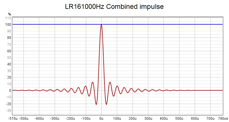

Another instance where the impulse is dominated by high frequencies.
Most DACs that use a linear phase reconstruction filter show some of this in a loopback measurement and it is often at or near the Nyquist frequency so almost certainly inaudible.
To prove it to myself I made a synthetic combination of Linear Phase Linkwitz Riley Crossovers 96dB (LR16) at 1000Hz LP and HP recombined using a 44100 sample rate.
I won't show the Frequency and phase because they are flat lines
This is the impulse
The ringing is there but it is periodic the period of the oscillation is 45 microseconds give or take my ability to get the cursor on it in REW.
And 45 microseconds is the period of 22,222Hz. So if I was more accurate with my positioning I would probably have got closer to 22,050. Getting it exact is hard because you are then at two decimal places or more in microseconds to get it bang on.
In this case close enough to show the ringing is at the half sample rate frequency.
