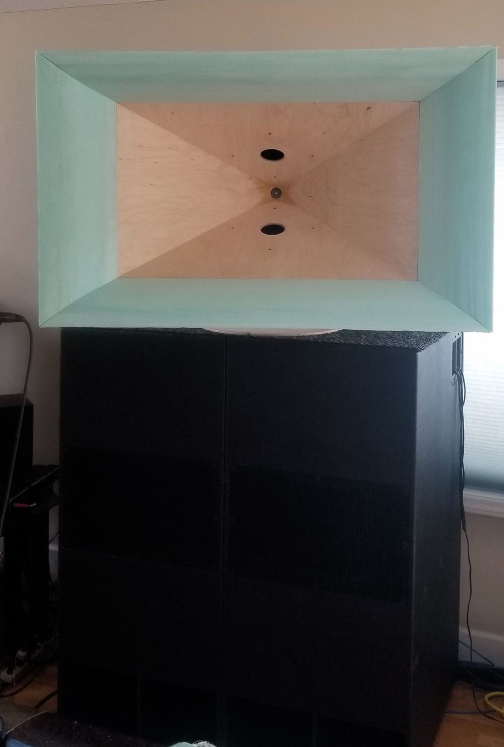

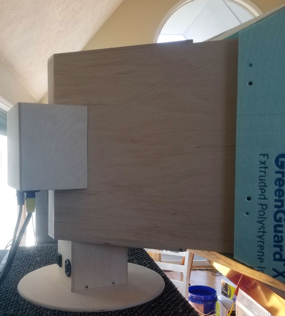

Update:
Definitely a work in progress still, but I'm committed to finishing it as my 'go to' all around compromise,....between super sounding, portable, and usable indoor and out... system.
With stand as shown below, weighs 47 lbs.
Stand includes speakon NL8 for feeding the synergy along with a NL2 passthru for a sub. Final version will not need speakon connections on horn cover.
Stand includes an adjustable tilt top hap for pole mount, outdoor use. Round base plate quickly comes off for pole mounting.
There's a strong handle in the top of the speaker.
I've gone with foamboard for the secondary flares, which are detachable and in the process of being glass-clothed with epoxy for durability. (thx for help diyuser2010)
The flares are curved ala tractrix, although I'm sure they wouldn't hold up to true tractrix math. It's been a heck of an effort learning how to cut them smoothly, 48" wide, with a hot wire.
Mouth size ended up at 48" x 29", for horizontal control down to about 200Hz.
On axis measurements rock; polar measurements still need to be taken.
But frankly it doesn't matter how they turn out. The box sounds too good on and off axis, gets loud enough, and is too light, for me to care.
Much work to do still, including building the second speaker, and figuring out finishing aesthetics.
But I'm psyched on seeing this one thru ! 🙂
