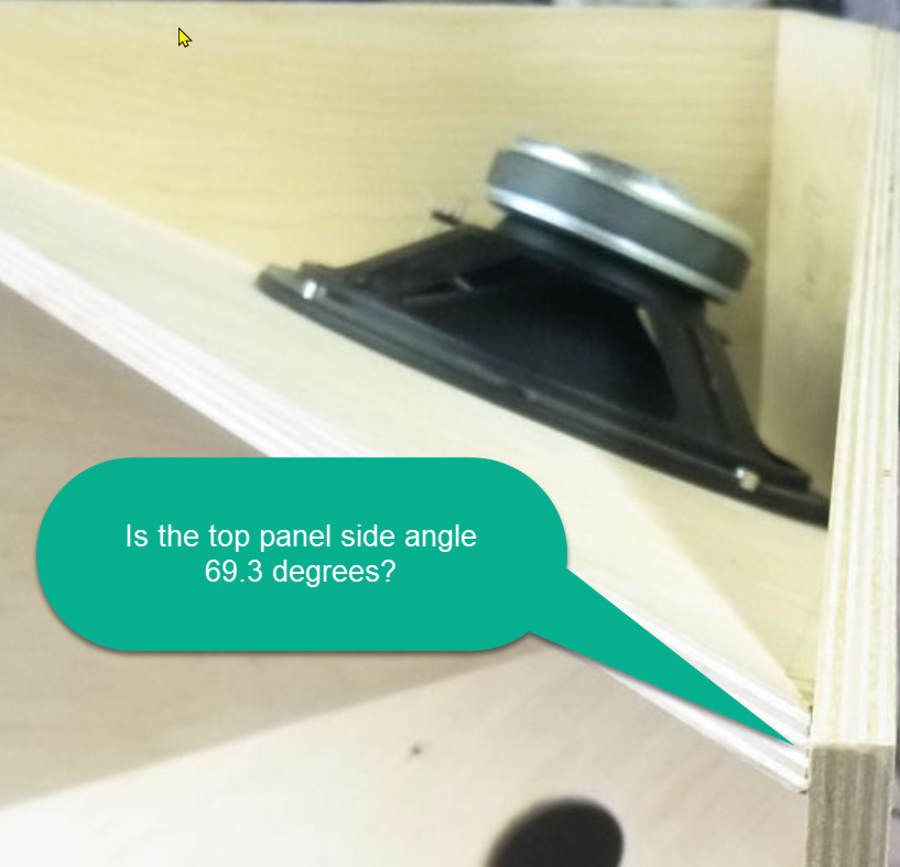

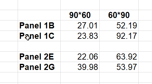

Hi Mark/Bill, can you please confirm the top panel side angle? I must be doing it wrong, I thought I could flip the ThetaW=60 and ThetaH=90 (on Bill's synergy calc) so I could have it the same as Marks setup, where panel-1 is the enclosure and panel-2 is the triangular piece. When I do this the panel sizes are more than double.
Yes, that's what I did ...flip horiz and vertical
So using 60 deg as horiz and 90 deg as vertical, piece 1 angle r = 69.3 deg.
Not sure what you mean by panel sizes are more than double though....
The pict you posted looks right... ???

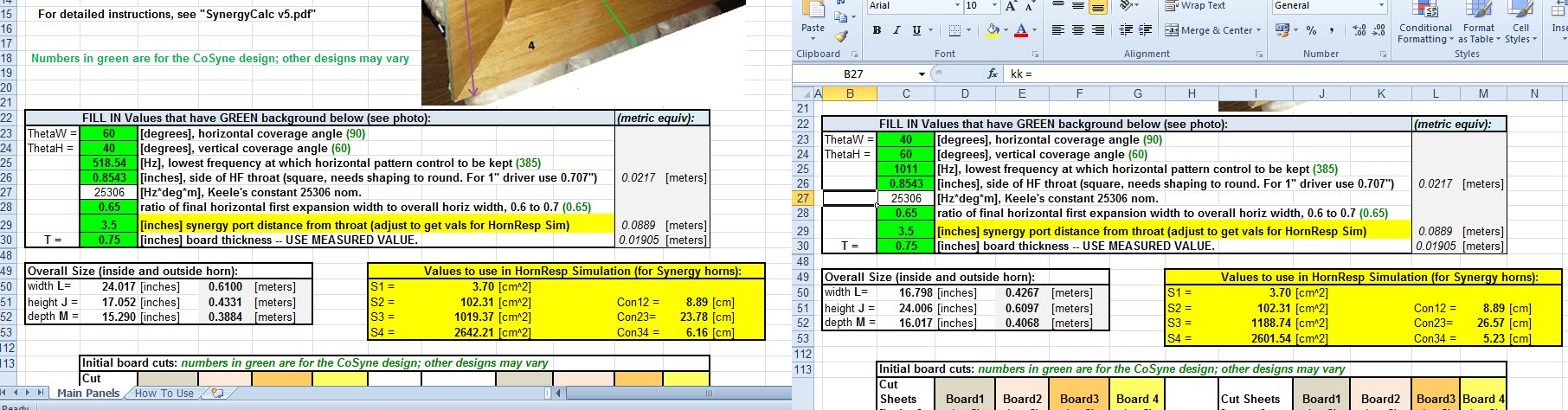

That's really weird I sent Bill a pm recently with that very question!
You need to fiddle with the setting for 'lowest frequency at which horizontal pattern' to get it close (because horizontal pattern is now vertical if you flip it 90 degrees). In my case for a 60x40 (40 x 60) horn the lowest frequency ended up as 1011Hz for a 24" wide enclosure, but the depth etc ended up a bit different.
Rob.
Exactly Rob, just raise pattern control freq until you get the width you want.
If you want to see what freq that width controls, just switch H and V back to normal, and alter freq until you get back to same desired width.

That's because the spreadsheet only calculates off of horizontal directivity. If you make the closer-together walls (narrower angle) be the horizontal constraint, then the control frequency goes up pretty fast so you'd have to make a bigger horn for the same pattern control frequency in that direction to compensate. But the other direction (vertical, per the spreadsheet entry) then controls to lower than the frequency you entered. Just model with the further-apart walls as the horizontal to find the overall horn width you need, then swap horizontal and vertical and adjust the control frequency till you get the same overall horn width (in what now appears as vertical).Ok thanks, I didn't know I had to play with the pattern control.
I just kept everything the same and switch the ThetaW/H and got a way bigger horn...

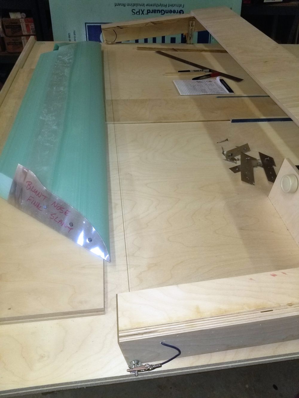

fwiw, i would not make foamboard flares again. Too much work and expense. And hard to get right.
Just making a hot wire cutter that could handle a 4 ft span was enough work, then there was learning how to use epoxy and glass cloth.
Was a hell of a bigger project than the dang synergy itself.
Thanks for the report. I assumed it would be just cutting some foam board with an Xacto knife and attaching the pieces to the wood horn. Does that not work? I know it wouldn't be as rigid as something coated with fiberglass and epoxy (ungodly smelly stuff), but is there much vibration on the walls of a horn's second expansion at the frequencies where foamboard might resonate? I've read that Xrk has had good luck with horns made entirely foamboard.
By foamboard, I meant the laminate stuff like Gatorfoam Board not the sheets of styrofoam used for insulation.

Ok I see it now, appreciate all help your Bill. Your spreadsheet does make all these builds simple. Thank youThat's because the spreadsheet only calculates off of horizontal directivity. If you make the closer-together walls (narrower angle) be the horizontal constraint, then the control frequency goes up pretty fast so you'd have to make a bigger horn for the same pattern control frequency in that direction to compensate. But the other direction (vertical, per the spreadsheet entry) then controls to lower than the frequency you entered. Just model with the further-apart walls as the horizontal to find the overall horn width you need, then swap horizontal and vertical and adjust the control frequency till you get the same overall horn width (in what now appears as vertical).

I don't know what's up with that (it's been years since I was into the spreadsheet). Maybe it was because the length is calculated for the horizontal frequency. The vertical behavior is basically a side effect of the horizontal values and vertical angle.
Aah, different foamboards. I've been using XPS from Lowes and Homedpot...particularly the 2" think stuff.
2" thick is the limit my tracksaw can cut vertically, and then a hotwire jig was used to cut the curvature....which was an important goal (kinda copying k402)
I can see the laminate stuff you are thinking about, maybe working nicely for straight secondary flares.
I don't know how stiff the secondary flare needs to be. It does give me pause for concern though.
