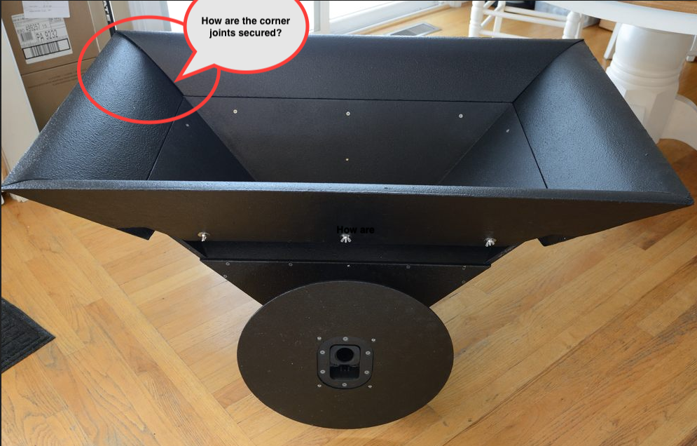

Mark,
"Resonating", "vibrating" and "rattles" point to separate issues.
Vibrations resulting in resonance that increases in level relative to the signal at higher amplitudes could be material related. That said, I'd think plywood would have a less mass to stiffness ratio than fiberglassed foam board, so don't think it would cure a resonance problem.
No fasteners are visible in your secondary horn attachment in the corners, that may be a "buzz/rattle" location.
While driving the sub only, listening to the output of a mic on a long boom close to the various parts of the secondary horn through noise isolating headphones (like GK-Ultraphones) could help you identify where the issue(s) are originating without damaging your hearing.

Hey Art, always lots of good advice.
And you're right.....a number of separate issues floating around.
That's probably why i'm calling them a bust....I'll get back to that in a second...
The fact the corners don't have any fasteners has been an obvious weakness from the gitgo.
I've tried different dampening materials stuck in between the corners...speaker gasket tape, etc, and now moving to sorborthane. It helps bigtime.
But problem is, the whole 'flare picture frame', and its tight fitting geometry gets screwed a little with the corners push out ever so slightly.
And then the fit between then flares and the horn, where the flares bolt on, isn't as tight/flush and starts to talk back some.
I'm thinking to try some very thin sorborthane, 0.04", as a gasket material anywhere the flares bolt to the wood, or the flares meet flares in the corners.
If this doesn't solve most all problems...which can manifest as sub induced, particular song induced without sub, etc, ,...I'll probably ditch the foamboard flares entirely.

Mark,
Unfortunately, hadn't thought of the idea before already sticking my head into far too many horns to determine which speaker was bad..
I once individually tested 12 cabinets (28 eight inch mid speakers) in my Paraline system to find just one of them had loose mounting screws. From the distortion I had heard from front of house, I was expecting to find a bunch of partially cooked voice coils or shifted magnets, not just a simple vibration buzz.
From what you describe, bolting on four exterior corner "L" plates probably will solve the problem without requiring gasket material anywhere but the corners.
At any rate, using a manually swept sine wave signal and the mic on a boom would go a long way to identifying the problem.
My bet is the "corner chatter" is excited at several different frequencies and amplitudes, then each of those is reinforced by the longer or shorter pieces.
Art

Your bet seems dead on...i've heard a number of sine tones cause problems.
It's been hard to figure out a corner bracket....damn angles, and even with one, how to pull inward.
Epoxy on foam is too thin a surface to allow any kind of machine screw bearing into the the surface, except on the backside where big washers, etc, can be used without visible consequence.
The idea just came to mind, to pull it together with low stretch black fishing line.....out in front pulling the flares together visibly.... strings streching across the mouth...
Probably another dumb / doomed to fail idea....jeez, gotta love diy .....huh? 🙂

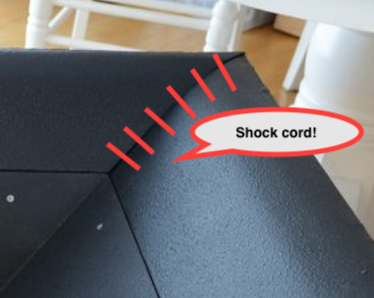

You might try lacing the corners with 1/8" bungee cord (AKA shock cord). It would look a little Frankenstein, but probably would work, although it sounds like you may need to put washers (or a few layers of Gorilla Tape, my favorite semi-structural adhesive) around the stitch holes to keep the thin glass intact.
Back in 1978 made bass cabinets ("Collapsible Crunchers") with a 30" x 36" x 48" four part horn, flat tops and bottoms, curved sides, using 3 rods and turnbuckles to connect the top and bottom.
Slow assembly, (and hard to explain turnbuckle operation to stagehands) the users later replaced the hardware with rubber bungee cords. I was surprised to find that the bungees provided enough tension to keep them from flapping.
Art

Yeah, i've played around with the bungee cord idea too, although not per your good idea.
I've only pictured it as a big wraparound so far.
I think whatever i come up with has to do more than just tighten up the corners.
When I feel the fares, and have put tension on opposing pairs, pulling them towards each other, vibration clearly diminishes.

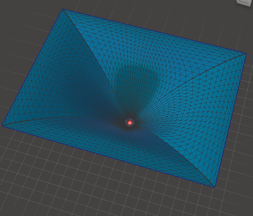

Possibly, Earl Geddes describes it as a standing wave forming across the mouth which causes a reflection to the throat. The smoother the termination the less chance of any reflections occurring. In simulations it is seen in the Radiation Impedance. The smoother the Radiation Impedance is the smoother the output of the horn is.
The simulations I am running are BEM through ABEC and are compression drivers on a horn, so not specifically of synergies but would apply pretty well to your latest as without the mids there isn't a massive difference from 500Hz up.
If you want I could make you a mesh of a conical horn with a smooth mouth boundary to compare visually. Would need the W H D of your horn to make it similar.
