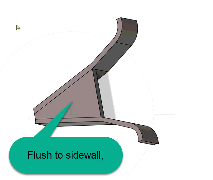

I think I'll just go straight 90 on my horizontal, no secondary flares flush to the walls... and do a bendy plywood/tractrix vertical secondary flare. You think this is a good idea?
I do think that's a good idea, and it's what i'd do if i build again.
Just not sure what you mean by "no secondary flares flush to the walls"
If I were doing straight wood flares, I'd use the angles and measurements the speadsheet gives.
If i were adding bendy board curved flares, I'd probably leave the mouth pieces unbeveled and square, to attach the bendy flares with square butts...
I was thinking making the vertical panel butt against the sidewall and make the room's sidewall as the flare extension. It will be like a klipschorn, corner horn style
The horizontal panels can curl up/down. Sorry for the drawings, I'm just learning and on elementary level with fusion360 🙂

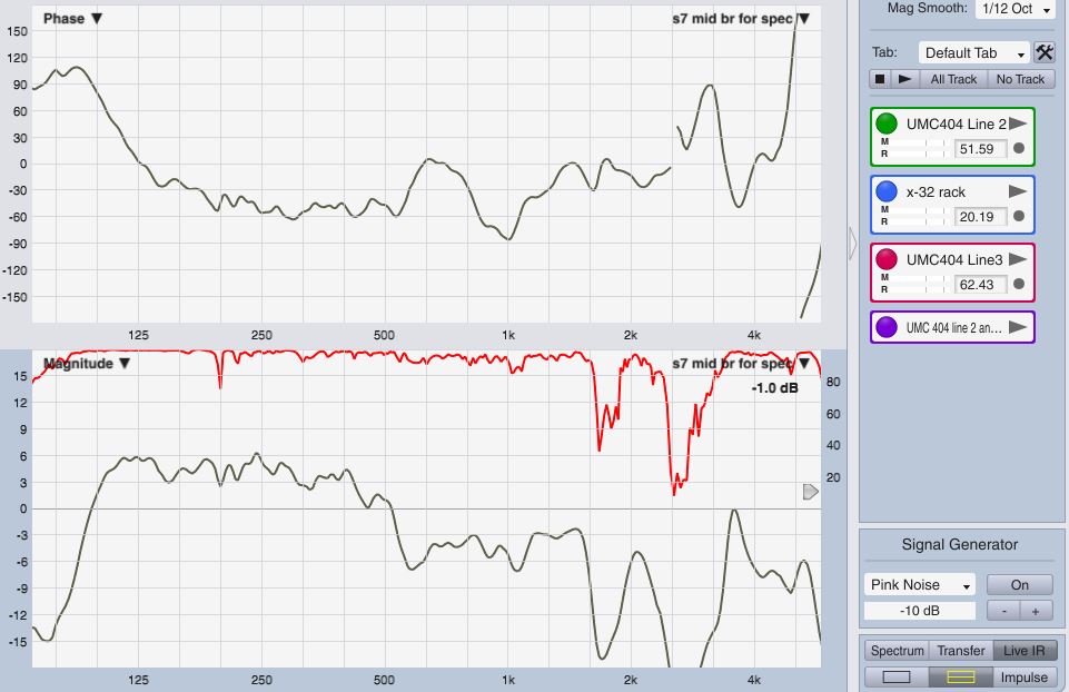

But speaking of higher spl's....now i'm finding some resonance issues to fix with the removable flares...couldn't hear them till the PR300's dropped in..
Always something huh ?

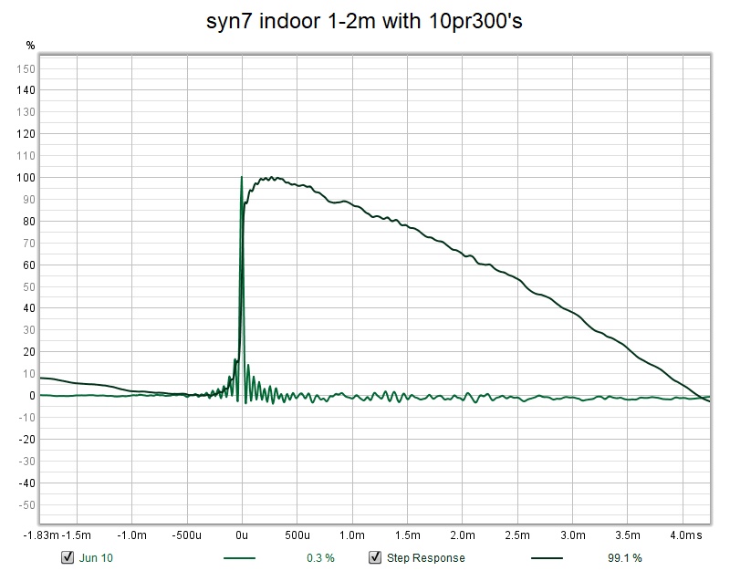

Here's today's indoor tuning with the PR300's in place, and a little deliberate VHF rolloff. Includes sub, so 4-way.
