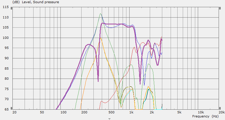

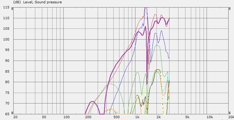

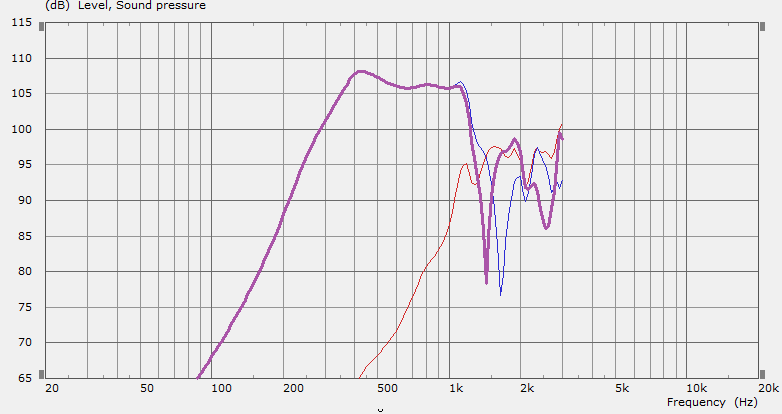

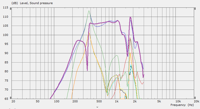

Ok, since I started this thread, I´m comfortable spamming the thread. 🙂
First: @ xrk971 and msibilia: Yes - I agree. But I have not come across a solution that works with a quarter radiating element for the compression driver and full radiating elements for the other drivers. I did try what you propose, but was told by the author of the software that it won´t give the right result. But I have tried another variant:
I split the model into four subdomains instead of two I had originally:
1: The CD entry and QTWG
2: The main flare
3: The extension flare
4: The exterior
I had moved the entry out to 7.5 cm from the CD, measured axially.
Simming only the compression driver, this is the result:
There is a huge dip for the compression driver at 1500Hz because of resonance from the midrange frustum and cavity.
Simming only the midranges, shows a similar story:
Keep in mind, that the other drivers are "off" in these examples, so what you see should be the resonances and reflections with a "dead" diaphragm (no passive radiator effects included).
So it appears that at the distance of the mids chosen (7.5cm), the mids reflect off the ports in a negative way at two high a frequency.

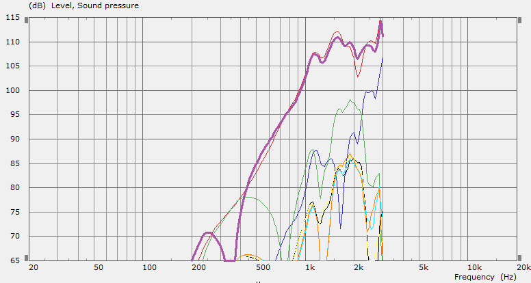

I tried setting the frustum depth for the mids to close to zero, to simulate a phase plug:
Much better. Now lets look at the mid response:
The dip on the left-hand size is due to the resonance of the woofer ports. Disconnecting the woofer ports:
It seems that there are two ways of going about a Synergy horn. One is to try to avoid these resonances, using phase plugs, or the second is to tune the resonances by placement of the ports and shape/size of the cavities.

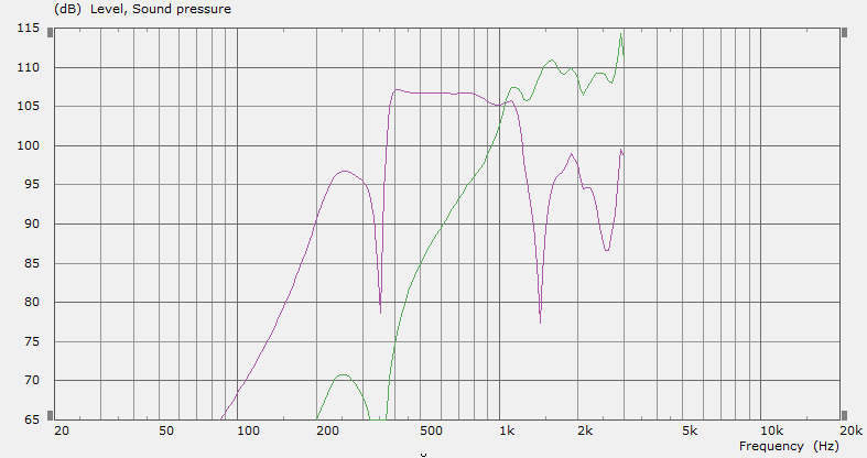

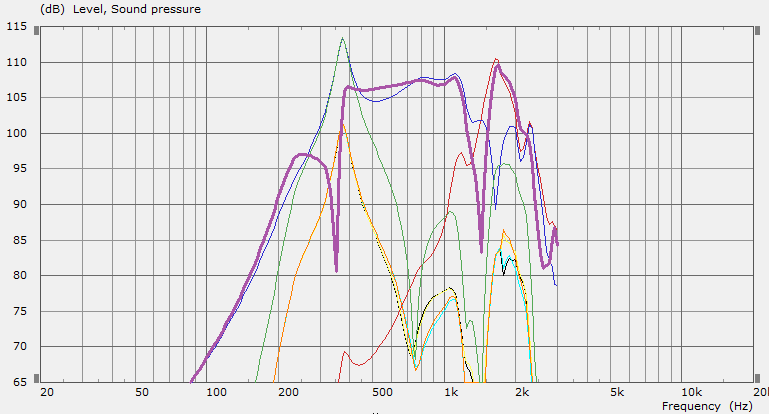

Back to the mids position. Its possible to tune remove much negative effect of the mid cavity from the compression driver, or at least tune the notch higher in frequency (beyond the crossover). That leaves the entry position.
The following chart shows the compression driver response along with the mids. (Sorry, I cant highlight both curves at once). Here I used the fake phase plug for the mids, but forgot to turn off the woofer entry port (so disregard the left side notch).
To my untrained eyes, it seems like it should be possible to make a crossover from compression driver to mids with this distance - or do you recommend further changes?

Well, I think you're mid entry point is too far down the horn to meet one of the Synergy criteria. I have no idea how audible this would be; perhaps more so off axis than on axis. If you think about it, if the 4 mids enter the horn within 1/4 Lamba of each other, then there is no forward angle from which they can be viewed in which their outputs don't add constructively. If they don't enter that close together, I don't think you can tell sufficiently close to on-axis. So maybe I should try this "cheat" myself as every fraction of an inch eases the problems due to the mid entry ports being off center from the cones of the drivers.
As you say, a crossover around 1 Khz looks very doable.
Good point. I also want the crossover higher in frequency. So i will readjust. Its difficult when you cant immediately say which effect youre looking at. Thanks.

I probable should have said "looks doable around 1200 Hz"; I'm not good at interpolating on a log scale so I didn't try...
are you still modelling Visaton M10? If so, I'm surprised to see it going so low but then you aren't showing excursion.
Yes not showing excursion - it wont go that low at all.. think 350-400 at best. I will try the faital mids next, as they also look easier to mount. Then try to produce new sims and 3d printable mounting adapter.
