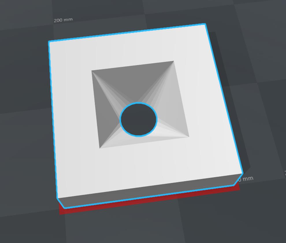

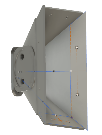

If you're 3d printing the entry to a Synergy Horn, there are two ways to do it:
The first way to do it yields an entry that measures approximately 12" x 8" and can accomodate four midranges that are five inches in diameter.
The second way to do it will also accomodate four midranges. The difference is that the mouth of the entry is truncated. The reason that we can get away with this is because the rest of the woofer will be on the wood part of the horn. Basically 60% of the woofer overlaps the plastic part of the overall horn, and 40% of the woofer overlaps the wood part of the overall horn.
The advantage of the second method is that it shrinks the entry down to about 6" x 4".
This is just a rough diagram, and is not made to scale. To determine how small it can become, I would have to design it for a specific midrange and a specific compression driver.

Here is a round to square converter I modeled in Sketchup for a Cut3D trial carving into 2 layers of 18mm baltic birch. It brings a 1.4" round up to a 3.02" square with 60 degree angled walls and filled in corners. You could build the entire horn this way but you would waste a lot of wood and spend a lot of machine time. Instead, straight walls can be glued or biscuited up to it.
If I were better at CAD it could be a Peavey quadratic throat but all it really does is the equivalent of modelling clay in the corners but with CNC accuracy.
