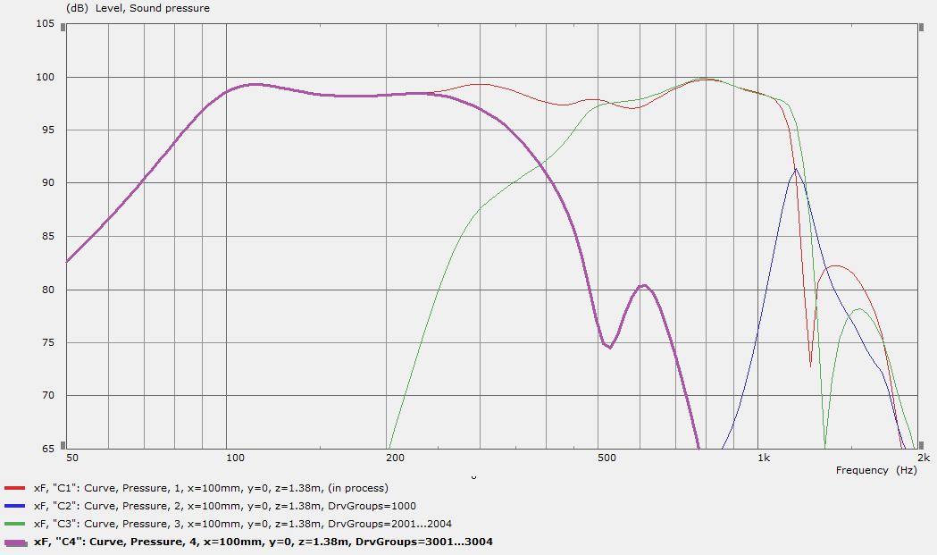

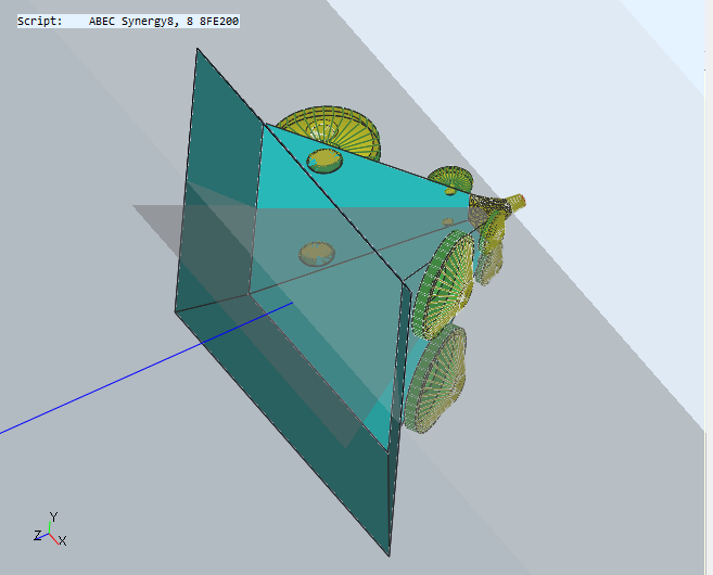

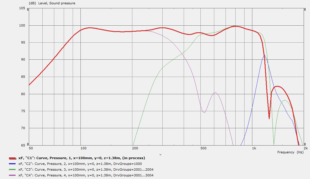

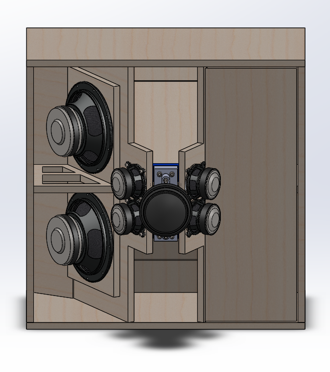

Ok, here is the latest. I imported the 8FE200 into the BEM part of the model.
Woofers:
It sims very nicely with a 16mm spacer (same thickness as the MDF I plan to use) to increase chamber volume. 55mm entry holes. 6 liter rear chamber per driver is used here. The cone profile is a guestimate based on the data sheet.

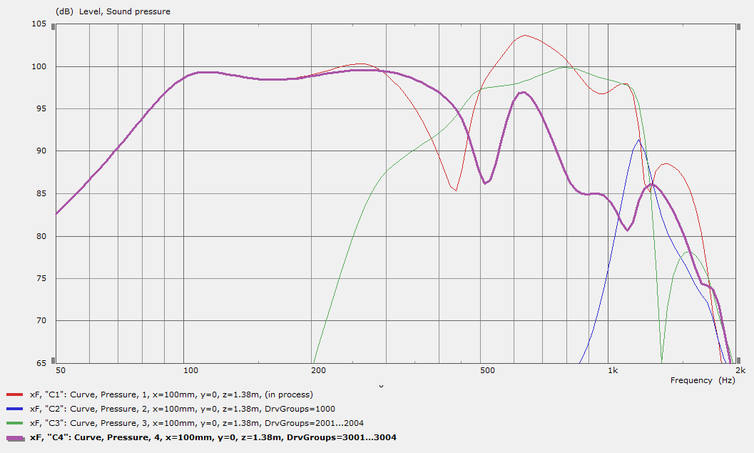

Response pre-crossover (100 measuring data points over 5 octaves)
After LR4 @ 400hz:

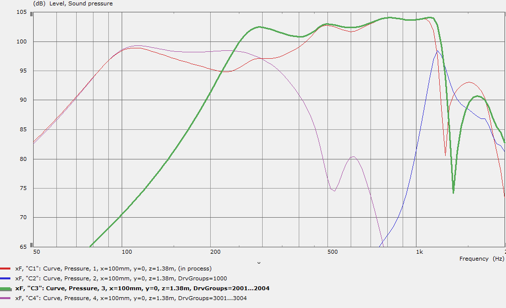

Mids:
Mids (3FE25, 8 ohm) using the 0.09 liter volume estimated by nc535 (tight mailing tube, magnet to seal off). Note: Sim is for centered entry hole, slight offset must be used. I don´t think it´s an issue - the bandwidth even after the offset will be higher than the reflection frequency.
Lowering mids 5dB, adding LR4@400Hz and LR4@1300Hz gives this:

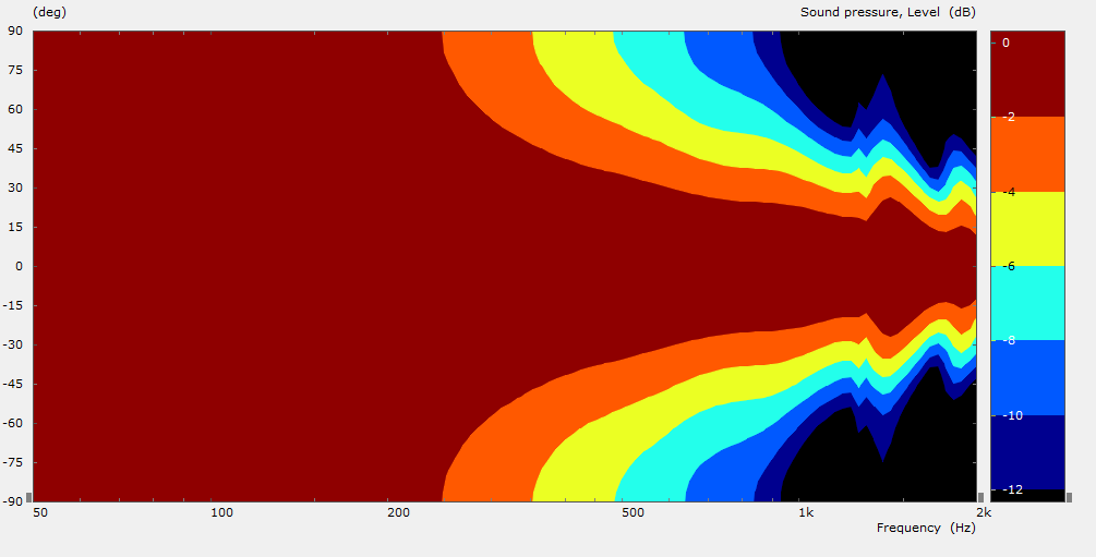

Simulated directivity on infinite baffle (normalised, so some "hash" after the midrange is done, just some low-SPL reflections being scaled up)
Woofers:
After LR4 @ 400hz:
Mids:

Hi CM:
It looks like you are on the home stretch!
With 4 8FE200's instead of the two I originally planned you should have plenty of bass headroom, especially since you are going to use them in corners.
Do you have any equalization in the crossover? Looking at your waveforms, I see your mids don't have the peak at Fbox that my HR sims show and, while I don't think that is due to the difference between SPL and HR's acoustic pressure, I would like to see how close HR can be made to come to your simulation. Could you get ABEC to create an acoustic pressure waveform?
Phase waveforms would also be interesting. My mids show a peak in group delay coincident with the peak in acoustic pressure at Fbox. If I increase the chamber volume, I can move that peak down below crossover, which should help with keeping the phase flat. Did you have to deal with that peak in group delay? I'm tempted to increase the chamber volume for my 4Fe35's to 2L for 4 chambers for that reason. With that much volume I'm forced to use a high pass to prevent over excursion but doing so allows me to move the crossover down to 200 Hz.
I see your woofer ports are round. Others have used rectangular ports with round ends to keep closer to the corners. Did you try other port shapes? With the BEM simulation you could try other shapes... if your computer needs something to do overnight🙂

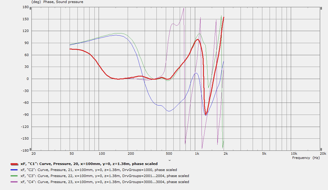

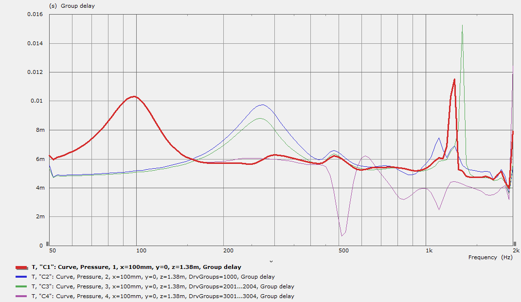

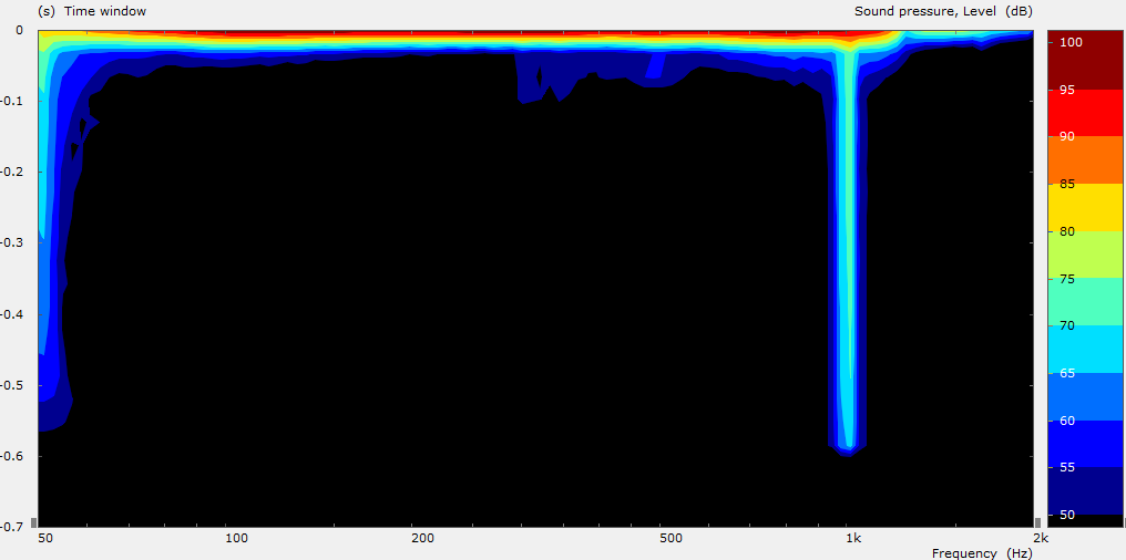

There is no equalization. Including that in ABEC is a bit complex, as you need to enter biquad-like functions, and to see the shape of it I need to play with Active Crossover Designer or another tool. If you know of a tool that gives analogue parameters for all these functions let me know. I had to resort to the Digital EQ Cookbook to try to find out how to make a shelving filter for instance. Regular textbook filters are easy in ABEC - but it´s not a crossover designer tool in itself. I guess I will use ADC once I have measurements.
See if these charts answer your questions:
Red is total response, green is midranges, purple is woofers.
Ignore the blue one - I believe it is the reflection from the "dead" CD.
Group delay
Decay spectrum
Phase:
The phase chart is shifted by -2.03m. I am not sure if I´m doing this correctly, but if I don´t do this its just rotation after rotation, and the figures seem to make sense. I also shifted the curves to fit on one screen (so that the response from 150hz up to 500hz is at 0 degrees).
These are "after crossover" results. Let me know if you need pre-crossover charts.
I am not sure if ABEC has the rectangle with round corners as a standard building block. But it seems like the compression driver results are not disturbed by the port at that location when that crossover frequency is used, so I don´t think I´ll dig into that. I´m not worried about my computers hard work, rather my own time.. 🙂

Thanks.
I like ACD and would use it to generate the parameters. Enter the poles, zeros, Qs etc in the top tab and then one of the inner tabs will give you the biquad coefficients which you can cut and paste into the miniDSP tool. The user manual shows you how to make shelf filters, etc. I've exported from HR into ACD to make trial crossovers.
Your group delay chart is not what I would expect. One would think the peak in group delay at 100 Hz for the total response would be mirrored in the woofer group delay but I don't see that. Its curious that the green and purple group delay traces both peak just below 300 Hz. I would expect the 3FEs with their tiny chambers to peak closer to 400 Hz and the 8FE200 to peak down where the system response peaks.
I think you got the colours wrong. Purple peaks at 100, and green below 300hz. Ignore the blue. But i am also surprised at why the peak is not higher than that. Sorry for the short reply - writing from my phone.
