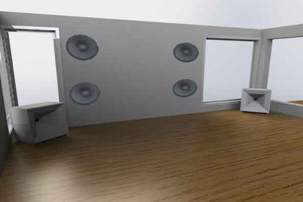

CookieMonster:
You had a long and productive day yesterday!
Is that what your finished design will look like? I had to look twice to see whether it was a photo or a rendition, but ultimately the emptiness of the room was the giveaway 🙂
My 90 degree corner horns tuck more tightly into the corner than yours but when I put them up on their Jubilee-like base bins, they are still hard to miss. Nothing one can do about the fact that size matters.
Are you going to extend your mesh to include the room? I guess that would/should be a separate simulation...nice that ABEC can do that too.

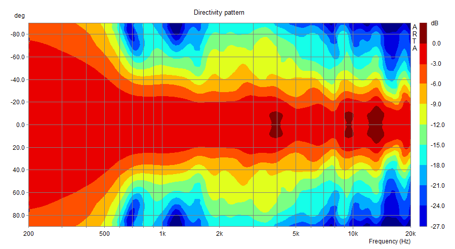

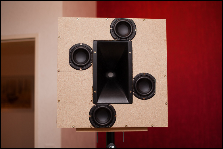

Hi!I prefer woofers outside the horn as well.
Cool directivity pattern!
What is xover frequency and drivers\horn sizes in this prototipe?..
Thanks! I hope it will be still as good with the 40° x 40° horn.
At the moment I use a 1" horn (Limmer 022, 75° x 45°) and 4" midrange drivers. Crossover point is at 1,8 kHz. The front of the enclosure is 50 x 50 cm. Of course the prototype lacks the bass section, yet. When I make progress I will open a new thread about this concept. 🙂

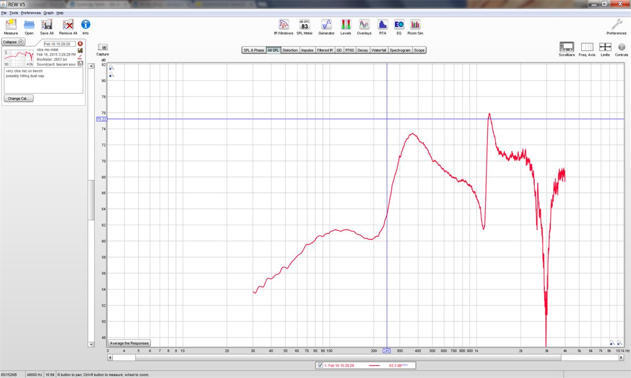

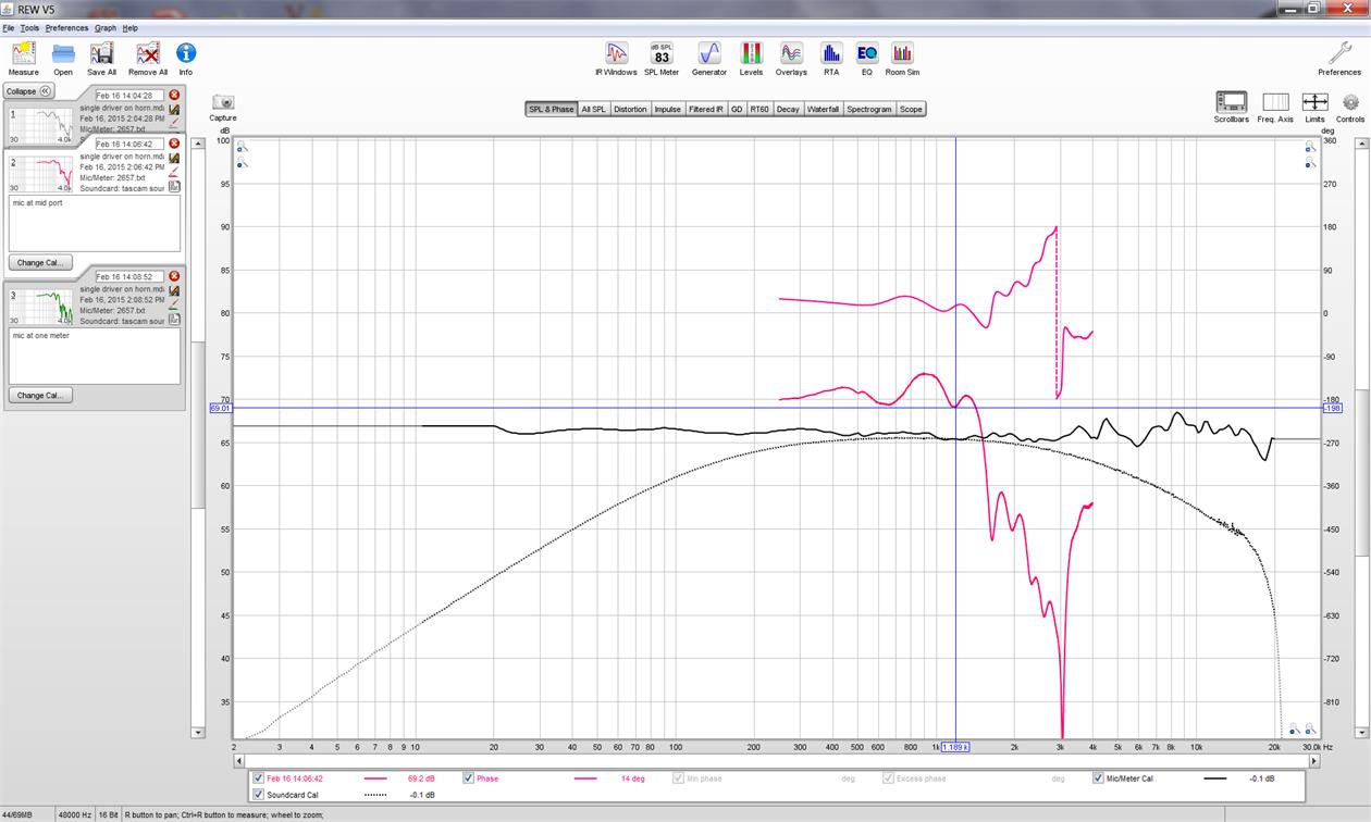

Hi CookieMonster:

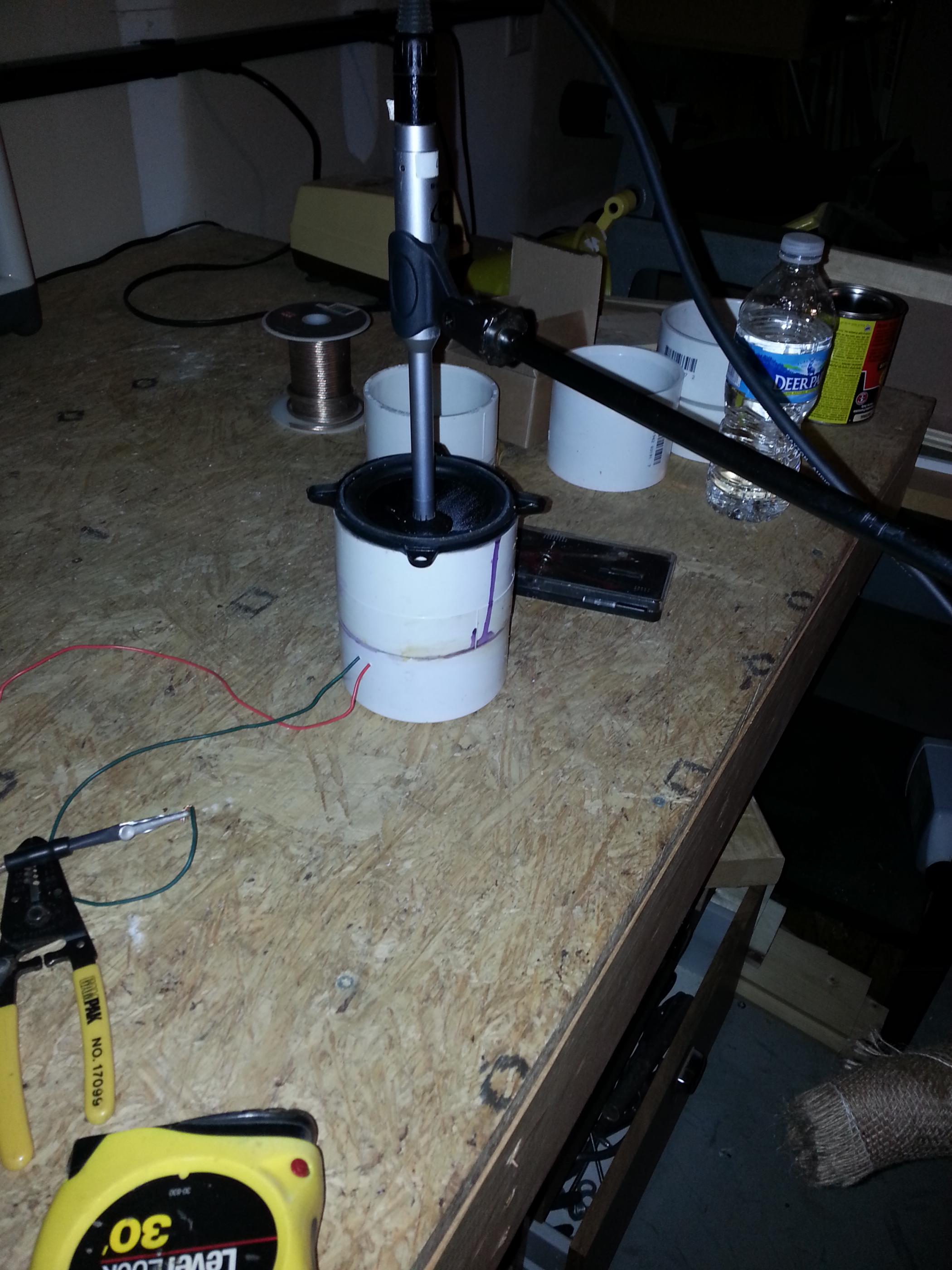

Today I measured my 4FE35 in a sealed chamber. Its made from PVC pipe fittings with 3.5" internal diameter, a good match to the seating rim provided on the driver for mounting to the front of a baffle. I'm making a similar chamber with a mailing tube for the 3FE25s
When building it, I was concerned that the response would be affected by the magnet (2.8" dia.) almost completely filling the pipe, that the driver wouldn't see or feel the cavity in back of the mirror. The measurements show that this is indeed the case. I calculate .54L volume, which should yield a peak at (Fbox) of 232 Hz but instead get a peak at 345-365 Hz (two diff measurements). This tune corresponds to box volume of .15L but I imagine what I really have is a bandpass system with a port between two chambers.
I thought I would pass along the caution because the fit in a 3" mailing tube for the 3FE25 is even tighter and could impact what you are doing. I'm hoping you are motivated to model the chamber in ABEC as I'm not there yet in terms of being able to do it myself. I'm waiting for the glue to dry on the 3FE25 chamber and will have a measurement on it before long.

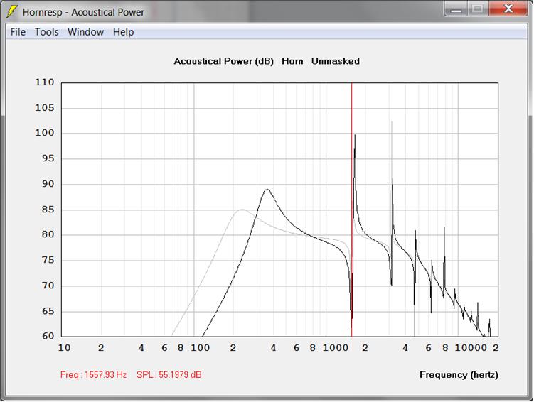

I've attached the horn resp sim results and a screen shot from REW of a clos mic measurement. In the HR, the grey trace is for a .54L chamber and the black is the chamber volume adjusted to match the peak frequency in the measurement. Note the nasty resonances as well.
Jack

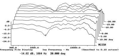

If anyone is interested in building a D'Appolito with waveguides, David Smith did just that for Snell and he's a regular contributor to the forum. His pseudonym is "speakerdave" and he's building commercial arrays to this day.
Here's the Snell:
As noted, they are dreadfully tall 🙁
Here's the vertical polars of the Snell. The only real issue is a blip at 2khz. I would speculat that it's an artifact, caused by the fact that the waveguide on the tweeter is only sufficient to control directivity down to about 4khz. And easy solution to that would be to simply stick a very small Synergy horn in the location where the midranges and the tweeters are in the Snell. For instance, a 7" waveguide would control directivity down to 2khz. That would fix the blip in the directivity.
Now, obviously, waveguides control directivity better than arrays do. And I've heard SH-50s and they're rather magical. But trying to fit them into the décor is a challenge. The Snell has better WAF.

Well, it´s difficult to say if I will ever have the woodworking skills to put this together. I suppose for me it will be necessary to get them CNCd. Just added bracing and access holes on the back and sides, so it´s going to be a lot of parts, even if I try to minimize it.
The tradeoff I suppose is that if you run a two-way corner variant, you need to have the bass bins pretty close. If you go three way, subwoofers can be out of the way - but then the horns themselves get more intrusive..
I don´t know if I will do room sims. I have requested as a feature that you can split the sim into pieces based on subdomains, and not have to re-solve every subdomain. That would enable moving the speaker around and not wait hours to see what happens. I think it will end with the "infinite baffle" sim, with a guess to what happens when I stick it in a corner: Some wraparound/cancellation around the "baffle step" frequency, and then increased sensitivity as the corner walls kicks in. Floor will be improblematic in this setup, but ceiling bounce will cause some issues etc..
I hope to hide subwoofers somewhere clever, like the tv bench we have - rebuild that and make it inconspicuous. 🙂

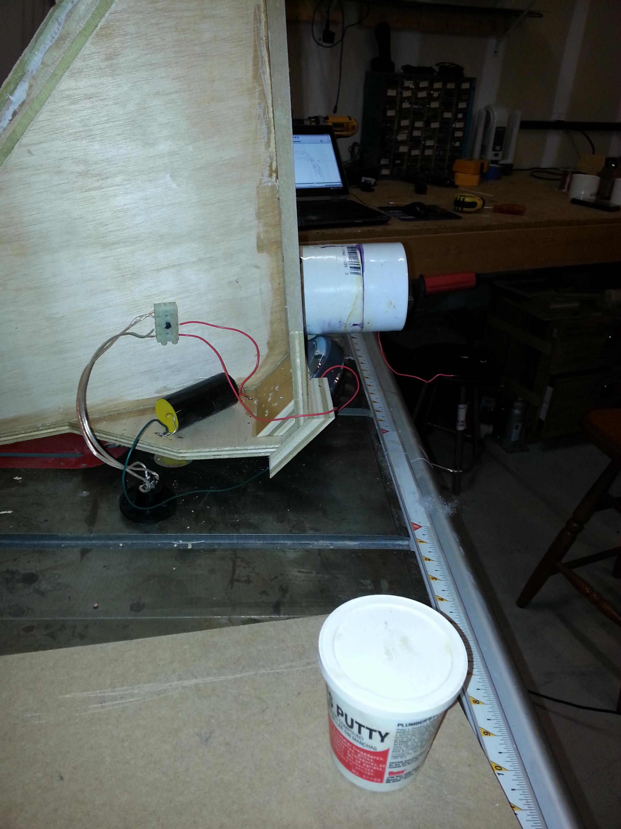

Thanks! What kind of front chamber/exit are you using? Are you measuring this in a horn, or by itself? If by itself, one a big flat baffle?
Look forward to seeing your 3FE25 measurements!
Photo shows how I measured.
Later I screwed that chamber down onto the horn but I couldn't get a good measurement as the garage was fully loaded and the weather precluded me emptying it out. It looked promising though with the mic all the way down the horn throat, like a clos mic.
That horn now has ~28 sq cm, .5" wide slots with round ends for mid ports. That is more than I need. I will fill it in partially with plumbers putty during next measurement process.
