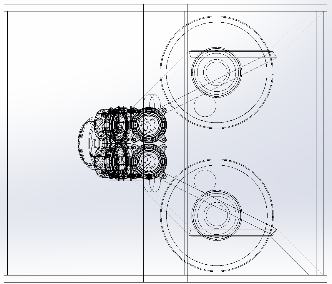

For now, I´m focusing on making this buildable. It seems to me that moving to a two mids per side has great benefits in making it possible to construct. So here is the latest iteration:

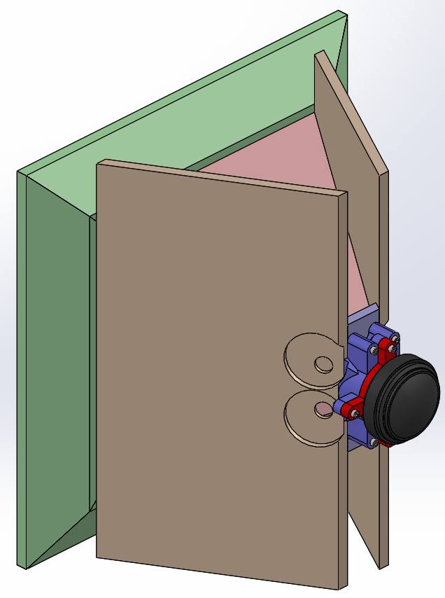

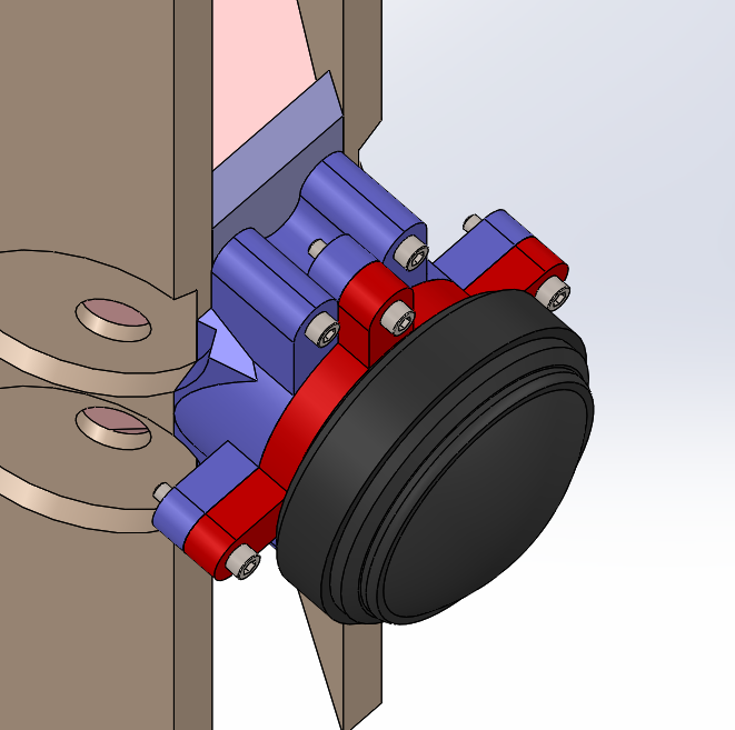

I started explaining it in writing, but I suppose the pictures explain it, or at least I hope. One thing I can mention is that the adapter is divided in two bits - the red one and the purple one. The red one makes it possible to attach the CD to the rest of the adapter.
I have discovered a bug in ABEC3, specifically that the Baffle element in the software does not accept a WallImpedance parameter. The author will fix it, hopefully by end of february. For now, I will assume that moving the entry holes slighly offset from center won´t remove too much upper bandwidth. Currently, the midranges reach higher than they need to, because the reflection frequency kicks in before midranges run out of extension. I will sim this once I get the software update.

I think you are ready to print. The only thing I don't see in your last drawing is where you are going to put the woofers. You'd have more room for them on the horizontal flares, but you would have to cut down the front portion of the vertical sides and extend the horizontal sides. This does make cutting the wood a little trickier...
