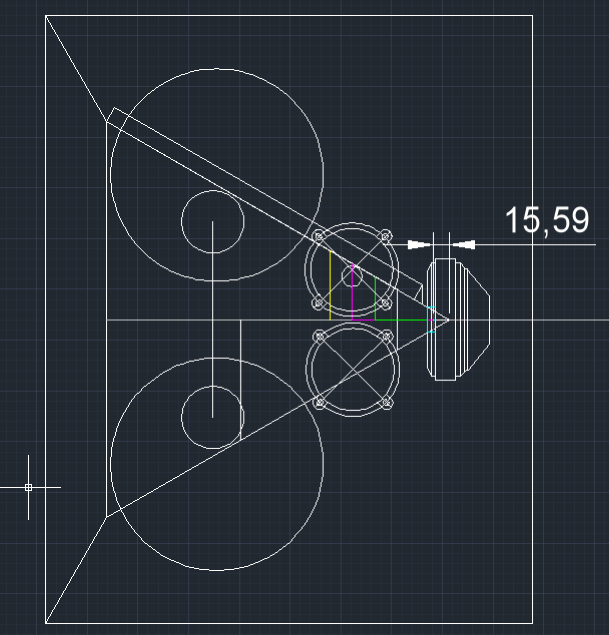

Where you add 6.7 cm for the BMS4550, I believe you should use 3 cm for the DE250. I've been using 3 cm for the DNA360 also but that is simply an assumption it matches the DE250. I've got an AkaBak model for the DE250 that I found in one of these threads and it includes a 3 cm "duct". My guess is a first pass approximation to a MBS4550 model would be to change that duct to 6.7 cm. Yes, when you use the BMS4550, the reflection null moves significantly lower. For some reason though, Tom Danley recommends its use nonetheless. The resulting steeper acoustic slope for the sub 1Khz mid crossover might actually be a good thing.
I think a good way to sim these things would be to forget about the motor etc of the compression driver, and only sim the actual response of the midranges downwards. However, the compression driver must be included to get a decent estimate of the reflection null. One way is to measure it and add that measure as a "duct", or another way is to draw the geometry, ending at the inverted dome.

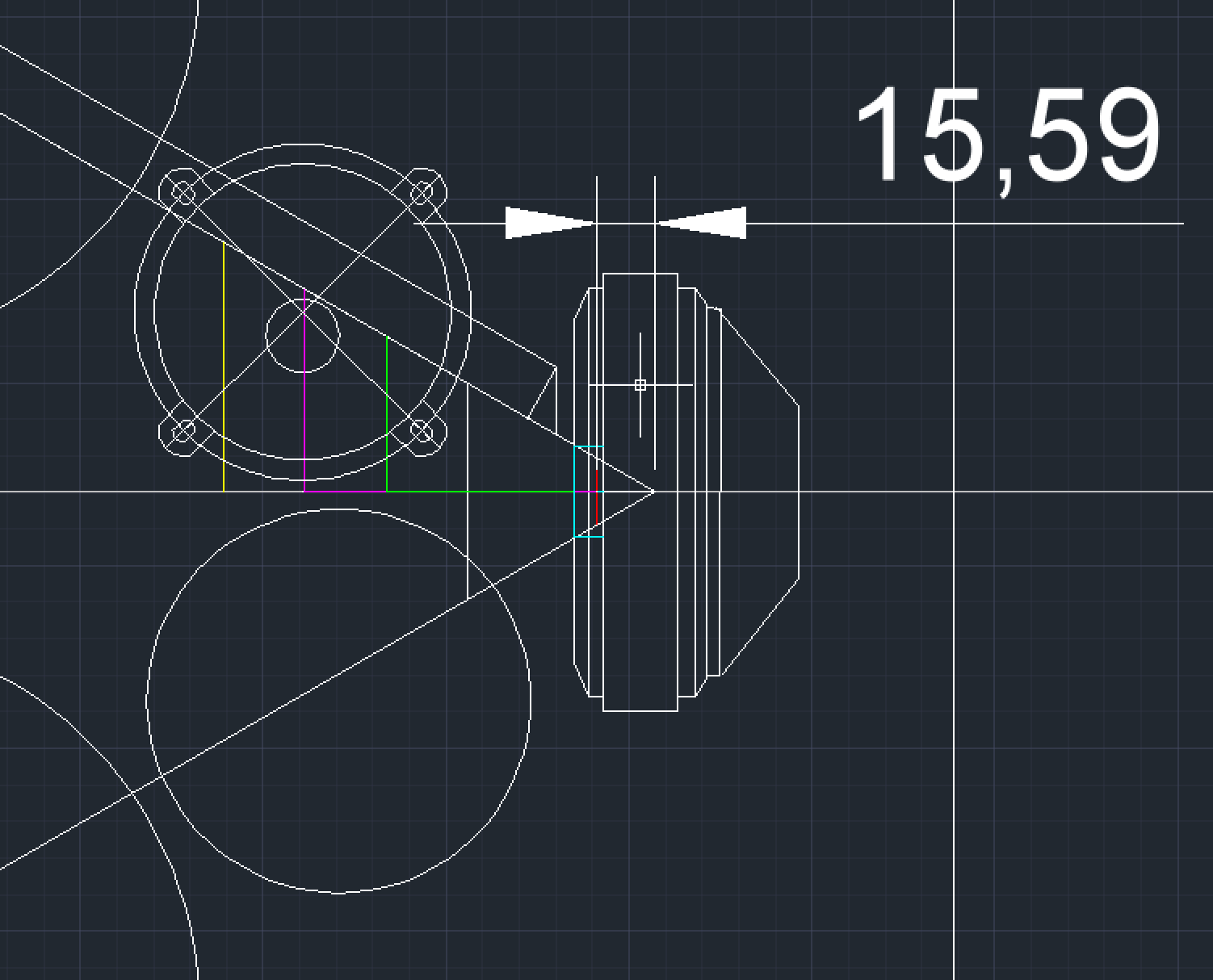

I think I have a cross-section of a DE250 somewhere. It will be easy enough to draw some lines to see if the numbers match those mentioned in other threads. In ABEC, I want to include a number of small ducts though, to avoid any resonances that mask the effect we´re looking for.
So, looking at the cross-section red spade audio has posted, it appears that the DE250 has a conical section, about 27mm deep, starting at 1" and ending at 20mm diameter. Beyond this is the phase plug. It looks like the distance through the phase plug to the cone is about 15mm.
Total path length is therefore 27+15 = 42mm. Does this make sense?
So I include this on the BEM side of the model like this:
Shell "CD stub"; Subdomain=1; RefNodes="CD"; Position=100,101,102; Shelltype=Cone
HasBaffle=No; dD1=-20mm; dD=1in; tD1=27mm
On the LEM side, I need to add the 15mm to the diaphragm.

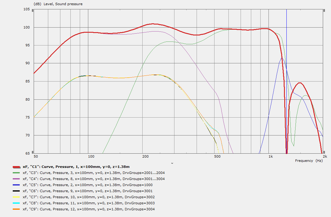

So I had a go with the smaller 8 inch Faital driver. Seems to be a better fit altogether from what I can tell.
Didn´t spend any time trying to optimize crossover points etc now, just wanted to get a rough test. Even with four of these in each, the speaker won´t manage any dinosaur footprints.. 🙂 However, with some EQ it seems like they could integrate well with subwoofers now. The four woofers have 50 liters back chambers, which shouldn´t be too far off with the box size used.
In this simulation run, the diaphragm of the CD is held "dead", and the CD and Mid systems are run as one, ensuring coupling. The reflection null seen therefore includes the entire path to the diaphragm, as I mentioned in the previous post.
Again: These are peak values I believe. So subtract some (3dB?) for RMS.

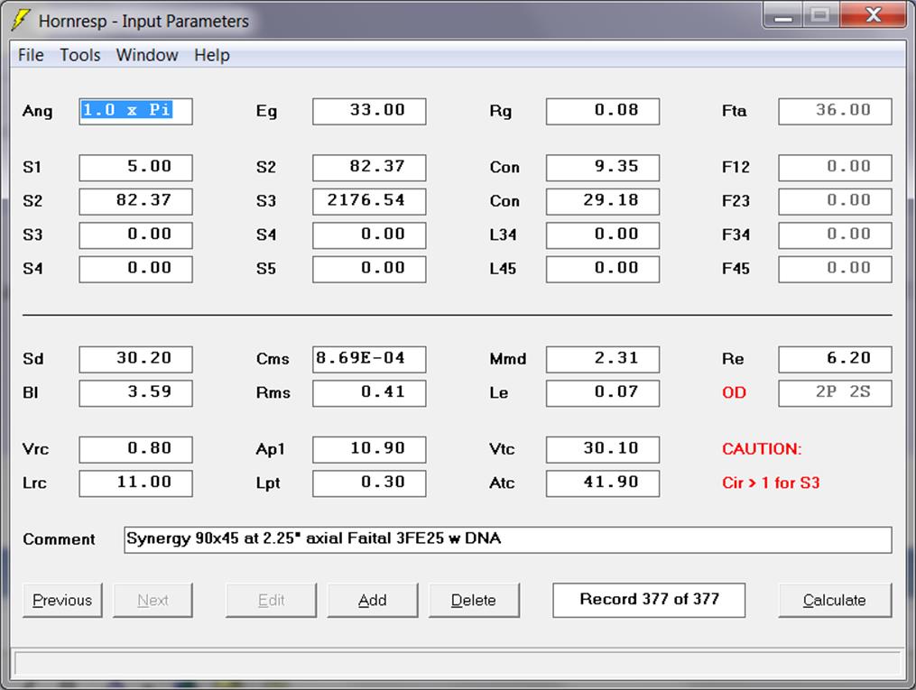

nc535 could you post a shot of the input parameters page for the Hornresp sim in post #251 it would be helpful to see what values you have used.
here you go
Thanks for image.
I have a few questions about the parameters you have used so I can try and understand this better as I have limited Hornresp experience. As you have 4 drivers in the model I have read that Vrc, Ap1, Vtc and Atc should 4 times the size of a single driver.
That makes your ports 18mm diameter by 3mm long.
Front chamber volume 7.5cc and area of 36.5mm diameter.
Rear chamber 0.2 litres.
I have used roughly the diameter of the driver as Atc and 30cc or more front volume as the air under the cone. Are you planning on using a big phase plug or have I got this wrong?
Lrc is 11cm this would make the rear chamber a very long thin tube. Is this right?
I thought 1.0 Pi space was a for a corner horn that went from floor to ceiling?
I am not trying to question your choices just trying to improve my understanding of the parameters people are choosing and why.

re' " or have I got this wrong?"
You haven't got it wrong. I found that the response wasn't very sensitive to the value entered there by trying a range of values. If it had showed sensitivity, I would have measured by filling the cone with something and then pouring the contents into a measuring cup. Apparently I left the value down at the low end of the range that I tried. I'm sure the real value doesn't matter much. If there is a lesson there, its to always try a range of values for any parameter and then focus on those that seem to matter.
The definition of x pi space is independent of what the horn size. Would you change your definition if you were simulating a direct radiator placed in a corner? Its the walls that have to go all the way between floor and ceiling. That defines a corner. Its half as much space as an infinite baffle and therefore its 1 pi.
In any case, I only have 4 choices for the value in that box, which one would you have me pick?
I take the corner gain and boundary support with a grain of salt because how much gain you get depends on the construction of the corner, at least at low frequencies. I know I've got enough headroom in the design to make up the difference with EQ if I don't get as much gain as predicted. At 300 hz and up where I'm using this driver, even sheetrock should give good support.

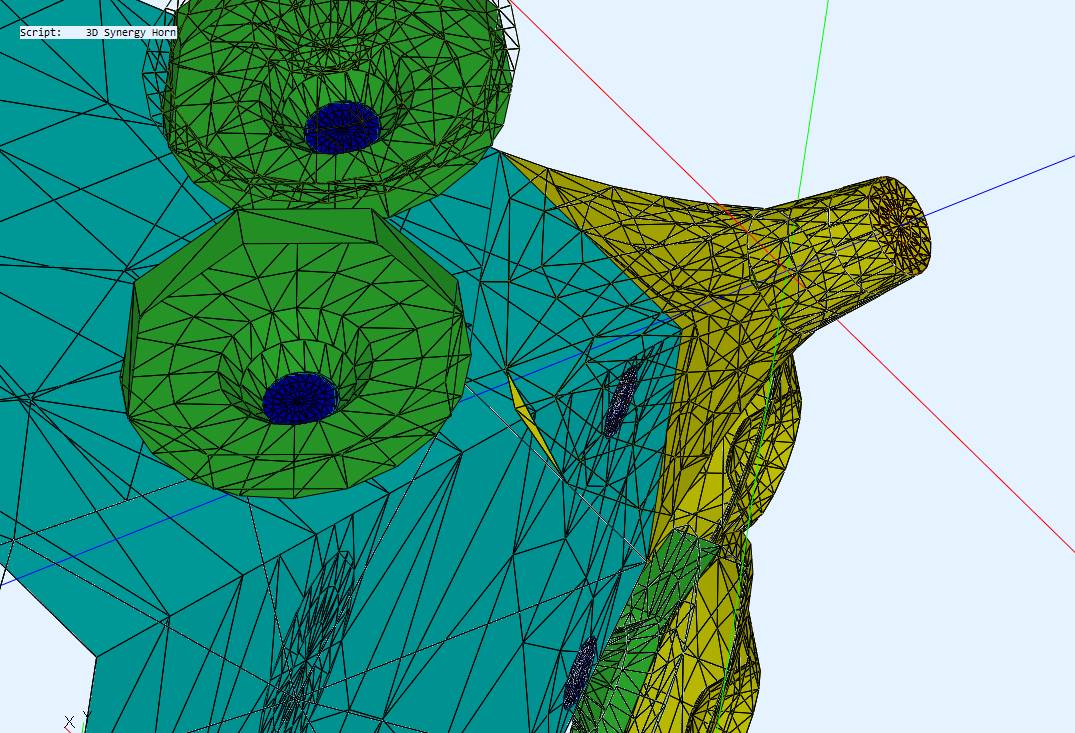

@cookiemonster:
I had a look on your ABEC model and found out that there is an error in the QTWG Element in Subdomain 1. There is an small area which is not aligned correct. It is the small yellow area in the screenshot. The normal vector is pointing in wrong direction and thus the area is not correctly orientated. This will lead to an error in the simu.
Also the numbers of elemtens and DOFs is quite large, on my computer it would take 2-3hrs to solve the model. Symmetrie would be the way to go, but as I experienced ABEC has (or had?) its problems with symmetry and several (more than one) diaphs included.
For HF only simus I would highly recommend a quarter model, as the actual model has its practical limits to midrange only due to limiting computational time.

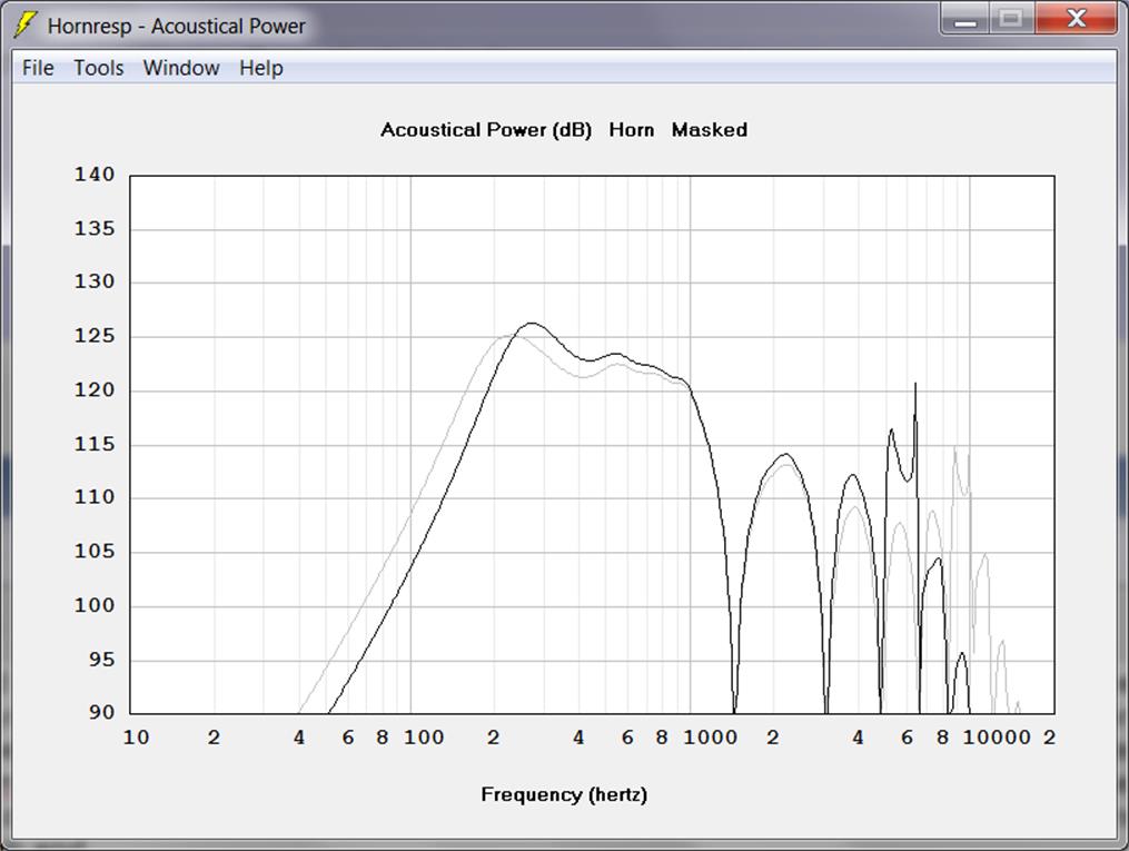

The main reason I have been trying to use Hornresp is so that I can help cookiemonster get a sanity check on the ABEC model by getting something similar out of hornresp for the same input. That way any changes can be tested in hornresp first to see how they work out before trying to change the ABEC model.
I am trying to compare apples to apples which is why I asked the questions about your parameters to make sure I hadn't got it all mixed up.
I have also found that some parameters make very little difference to the output in Hornresp. For me front chamber volume and port length seem to be related. As you increase front chamber volume the port length needs to be increased to keep the output the same.
The pi space is probably irrelevant as that is placement dependant. The reason I asked is that I had seen this question spoken about by David McBean.
