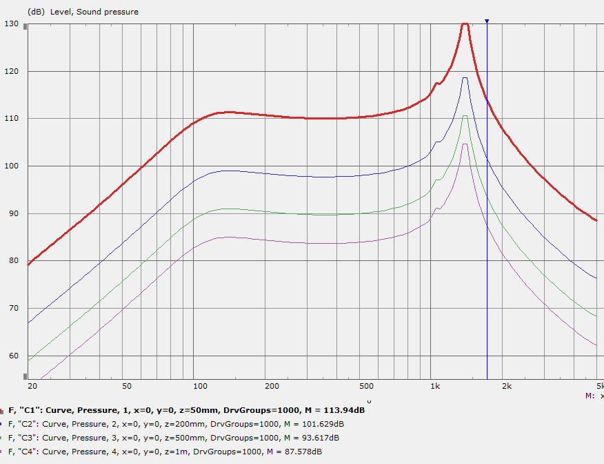

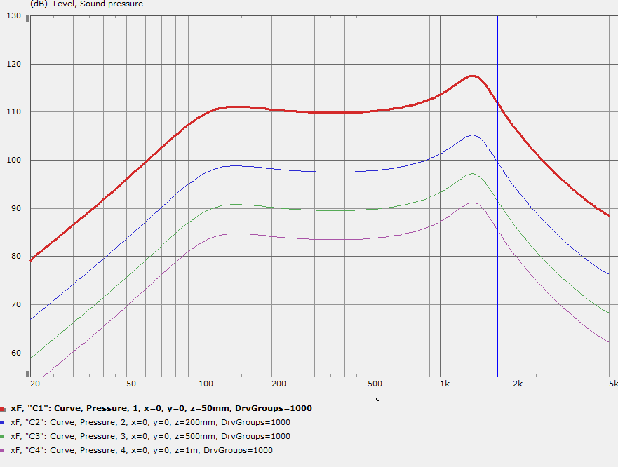

@Kessito: Thank you! I had read about the damping WallImpedance, but I think I have tried just about everything else instead. 🙂

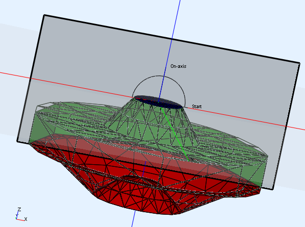

Let me show how it changed the response. This is the driver with a small cylinder on top (few mms), a cap and a hole in the cap of 10mm across - trying to mimic Nissep´s measuring setup.
Before adding damping:
After adding damping:
And here the only thing dampened is the cylinder walls (factor 0.1). Not the driver, nor the cap.

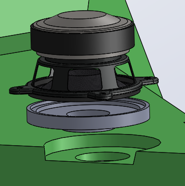

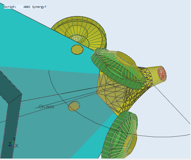

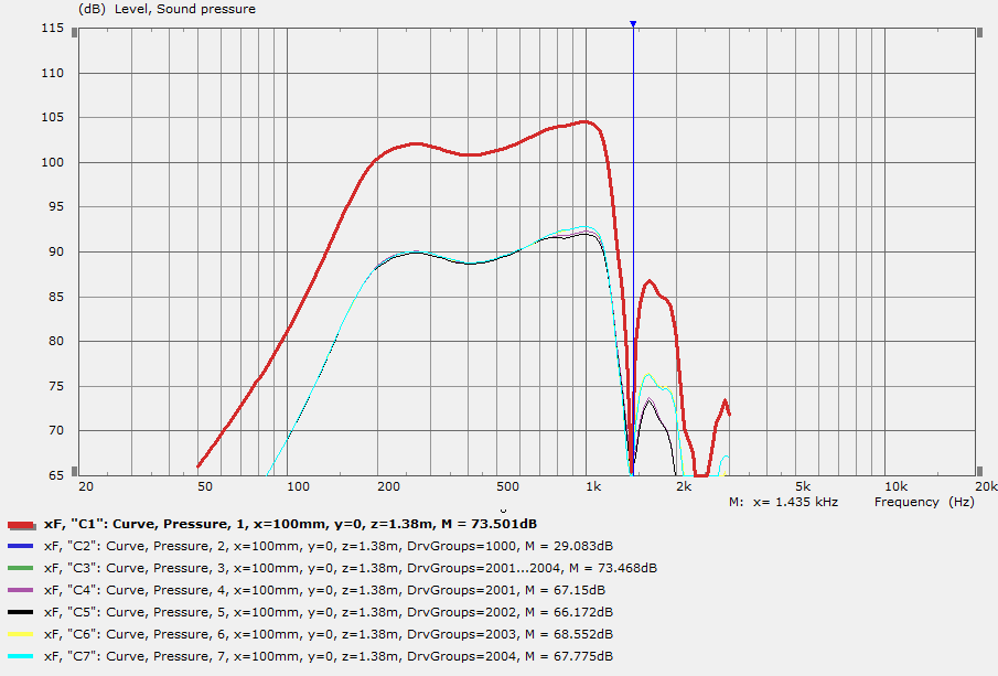

Current sim with Faital 3FE25, in a simple chamber that should be easy enough to both print and/or do with regular tools. 🙂 Rear chamber simmed in LEM part - 0.3 liters.
You can see how it peaks slightly above 1kHz, and that -3dB from the flat section is around 1.5kHz. The peak is rounder thanks to Kessito´s tip on using damping to get more realistic results - not assuming perfectly reflective surfaces, but allowing some absorbtion.

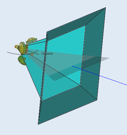

All four mids are now in the BEM part of the model, except the rear chambers, which are simulated as a simple enclosure in the LEM section.

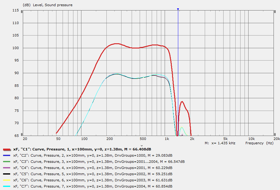

Raw response of each driver 90-92dB efficiency (peak values) 1m from horn mouth compared to around 85db at 1m from driver (also peak values) in the bandpass alone.
Adding a LR2 filter @ 1300Hz:

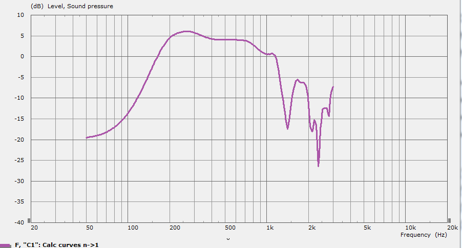

Here´s the difference in amplitude response between the single bandpass driver and the same bandpass driver in the horn. The absolute levels is off, since it´s measured at different distances, but if we assume the top flat part is regular horn loading, I think can explain drop from ca 1150Hz as the reflection from the throat.
It appears to me that since the -3dB level of the bandpass driver by itself is around 1500Hz, it should be possible to get more extension by moving the mids even closer.
Naturally, moving the mids closer brings them more into the view of the compression driver, and the holes will be relatively bigger compared to the throat area there.
So the question is whether the response now is OK - can the DE250 cross over at this level in a domestic environment without strain? I should think so, but please correct me if i´m wrong.
I would tend to think that for maximum output, and less regard for fidelity, one would move the holes slightly closer to the compression driver, but for home use it´s best to leave them where they are. Any inputs?

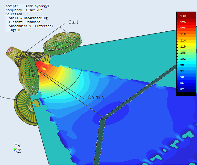

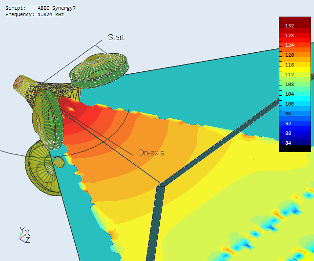

Here´s field showing the frequency with maximum cancellation. You can see high SPLs near the compression driver but very low travelling towards the mouth.
And at 1000Hz, just before the drop:

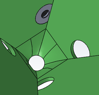

I think the M2 waveguide might offer a couple of advantages for a Synergy horn. First, the knuckles on the waveguide are designed to absorb higher order modes. JBL doesn't call them "HOMs", but that's what they're talking about. Those 'troughs' in the waveguide absorb reflections from the mouth. It's similar in effect to covering the waveguide in felt, like Dunlavy Audio Labs did.
The other nice thing about the M2 waveguide is that we can 'tuck' the Synergy midranges into the 'knuckles'
Once you spend a few hours designing Synergy Horns in a 3D program, you start to see that the midrange taps take up a lot of space on the waveguide. In some of my designs, the depth of the midrange taps gets as deep as 1-2". That takes up a lot of space, increases the pathlength, etc. The 'knuckles' on the M2 give us some space to hide the midrange taps.
Geometrically, we make an M2 waveguide the same way that we make an Altec Tangerine Phase Plug. We take 'slices' out of the shape using a wedge. (The wedge defines the expansion rate of the phase plug.)
Here's a pic of the design coming together. It's not perfect but you get the general idea of how to make it.
