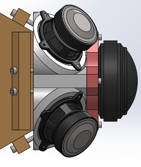

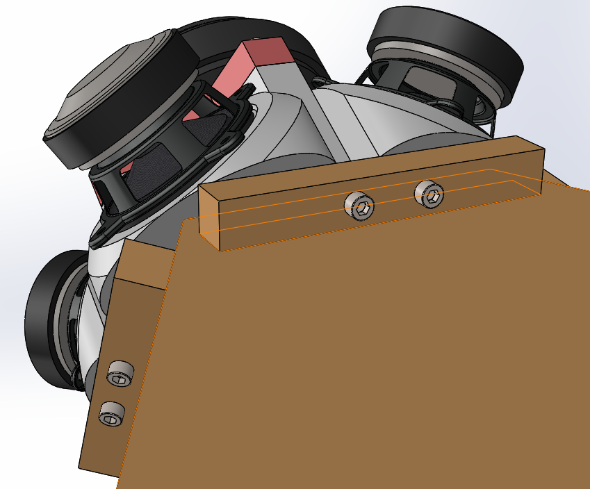

Anyway, I added a variant for mounting the adapter to the horn - again relying on inserts. Ugly but I need to be realistic about what I can achieve with plywood. 🙂
Hopefully with eight M6 screws the tension on the plastic won´t be too high.

You could also just epoxy the plastic 3d assembly to the wooden horn. I am not sure they need to be separable unless you want to try different throat assemblies.

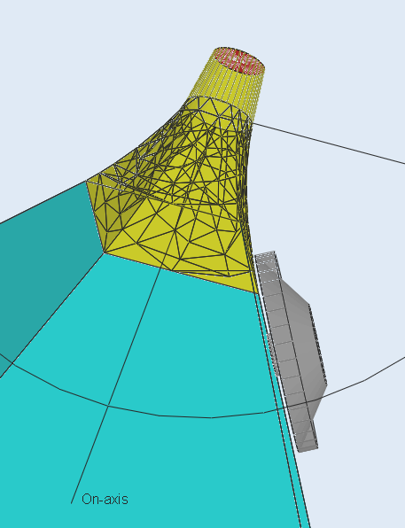

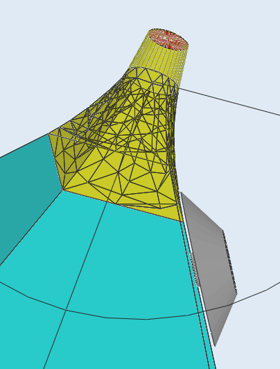

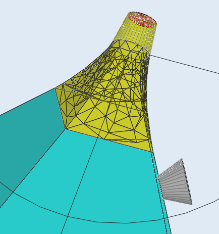

I had some strange resonances showing up, and also wanted to simulate better the effect of a phase plug. In the previous model, everything about the midranges outside the entry hole to the horn was done in the LEM part, so similar calculations as Akabak provides.

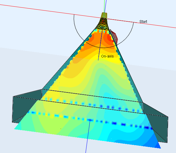

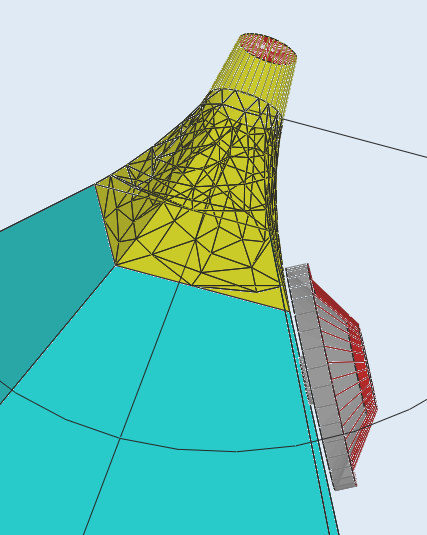

Thanks Nissep for the cone profile. Here´s how the driver is added into the BEM part of the model:
Rear chamber still in the LEM section. As you can see above, I have tried to use a kind of phase plug to increase the high frequency response.

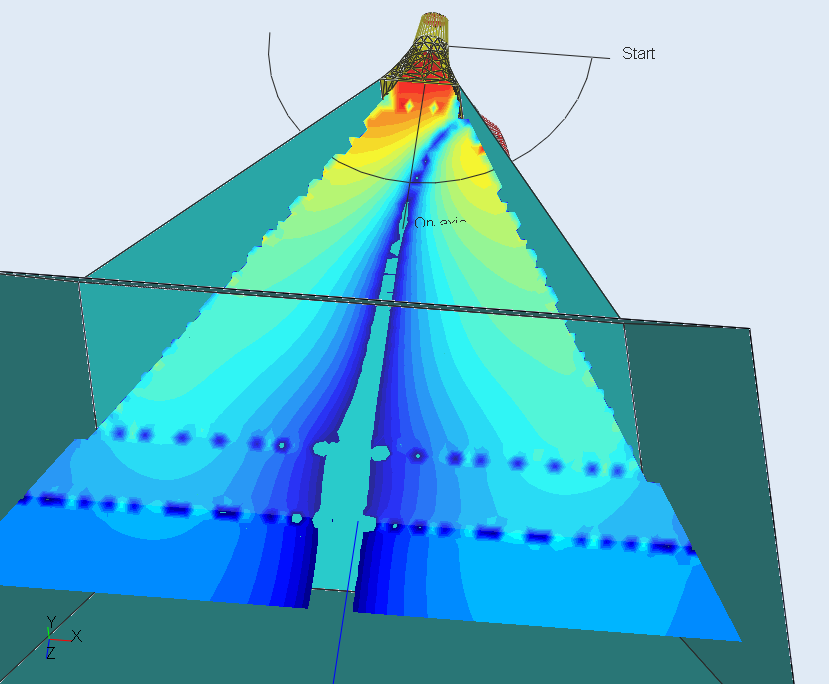

A sound field at 2000Hz shows clearly the kind of assymetry one can expect when loading only one driver into a Synergy horn.
Or at 1400Hz:
Next - add the three more drivers, and re-sim with reasonable front chambers.
Or at 1400Hz:

It´s a bit advanced for me to model in ABEC now, but did you test or sim this phase plug design? For instance, how did you arrive at the exit hole diameter?
With the simple design I´m simming now, I end up with a huge peak around 1500Hz (when simmed without the horn, just the compression chamber into free air).

Right now, I cannot seem to make the simulated driver in BEM mode match your results. I get a huge peak around 1000Hz. I think calibrating to your measurements is necessary before trying out various phase plug variations. Perhaps the simulation exaggerates the peaks somehow (assumes no cone flex etc), but I think I should be close first...
