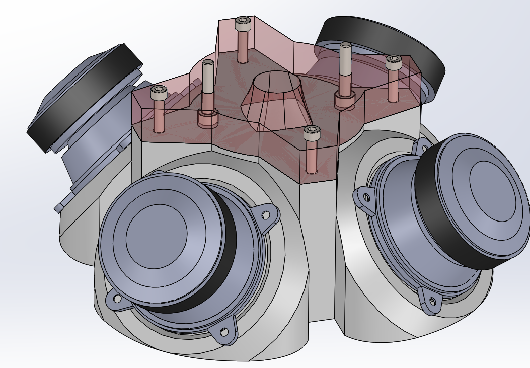

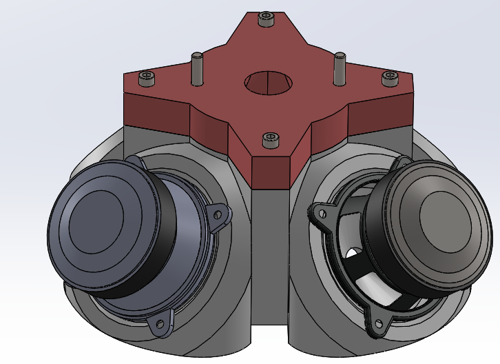

Updated mounting plate and made the adapter a bit smaller by cutting off more at the large end.
Also stretched the CD mounting flanges out to make room for mounting, and now it is aligned with where the wooden horn will continue.
Todo:
Mounting midranges. I suppose threaded inserts is the way to go here also.
Midrange cups - a bit of a headache actually, since the Faital driver looks funny with seemingly no easy place for a seal. I´m imagining resorting to hot glue here. Ideas?
Mounting adapter to wood. Some ideas already. Since I´m trying to avoid overhangs, the CD mount now continues vertically down to where the wood starts, where it will flare out 30 degrees. I am wondering if making holes for dowels would help with alignment, and then using screws to hold in place. Perhaps silicon between the wood and the plastic will increase the grip and make it more immune to buzzing?

Why not print a screw thread around the boss where the Faitals mount and get a food jar with matching thread? Or print correct dia boss (with o ring groove) and slip a SCH 40 PVC pipe and end cap on it?
If you can design the horn, you can certainly design and print a cap to slip over the Faital and glue to the rim of the ram just inside of the mounting tabs.
I think the seal between the Faital and the horn might more of a concern. I have a 4FE35 here and the gasket is tall but thin. (assuming the 3FE is the same) It might be good to print a groove for that gasket to sit in and perhaps a thin bead of flexible, never hardening caulk in that groove.
Could you print a "recess" or "raise" the area around the midrange mounts, then you could print the caps with corresponding mounting brackets and mount it all together. Then use some glue/sealant around the midrange brackets and caps. Hope I articulated this in an understandable way?

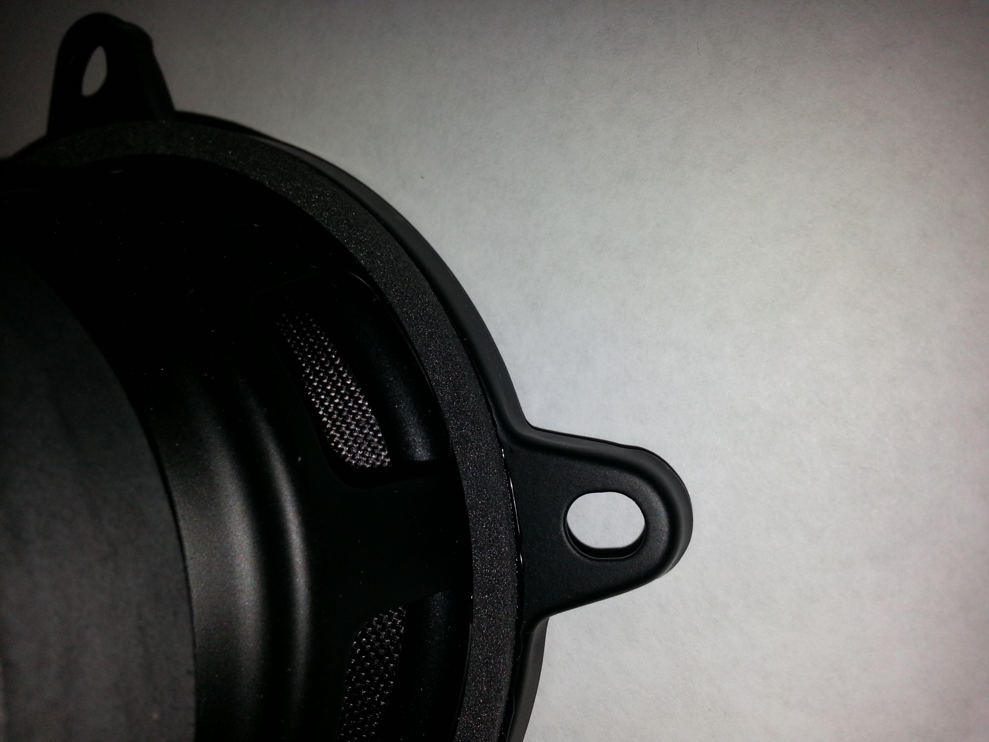

Nissep: Could you post some closeups of the Faital driver from various angles? I get the measurements from the datasheet, but some things are a bit unclear.
If you could measure the cone profile too, that would be nice, including the space between the mounting rim and the cone. At some point I might want to sim the driver using BEM. But it would also be nice to have an accurate model to design the adapter from. You also mentioned that you have a 3d model that you have worked on - is it possible to send it to me, so I can check if I have made any mistakes on my side?

4FEback detail for cup mounting
Well the PE photo tells me the 4FE is a scaled up version of the 3FE so I'll send you a 4FE shot
As you can hopefully see in the attached jpg, there is a 3/16" or so rim around the outside of the frame in back, just inside of the mounting tabs. It has a thin foam gasket on it for sealing or you could scrape off the foam and use glue.
Hope that helps,
Jack
Hope that helps,
Jack
Thanks Jack!
Yes, of course I could just buy a driver, but then I´d have to wait for it to arrive! 🙂
Anyway, I think I have been able to build a better mockup thanks to your help.
Looking at pictures earlier, I mistook the foam gasket for something else that couldn´t be removed. It should be easier now.
That foam gasket keeps the surround from hitting the plate its mounted too - I would no remove it as it forms an excellent seal when screwed down. If you don't have it you will need to make your own gaskets. Why do that? Are you guys talking about the gasket on the back of the driver bezel? The front one definitely leave alone.
